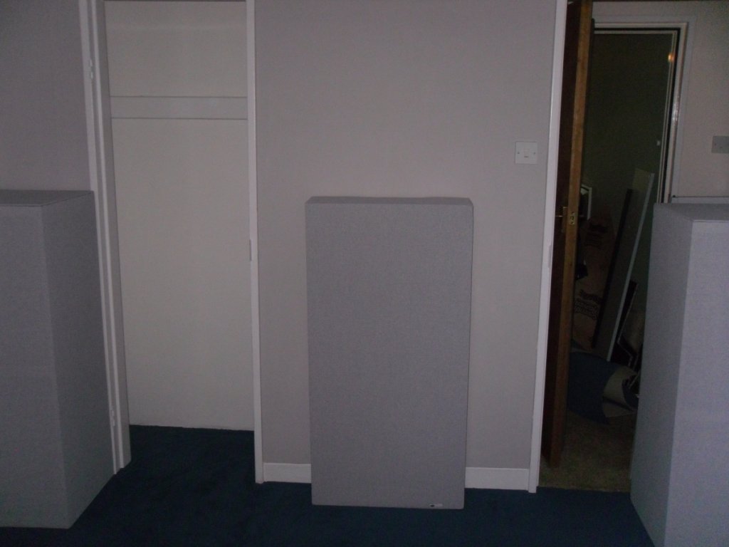

Thanks Glenn. I should have also said that the 242s are for first and second reflection points. Is that kind of gap still okay? I have a couple more questions. I have just purchased a soffit trap that is fitted with the range limiter, but I don't see that option for the soffit trap on your website. I got mine from the GIK ebay. I have a very small room. 10x10x8. Im guessing that i'm going to be okay with the range limiter in one of the back wall to wall corners, and I won't be getting interfering reflections?
I do also have another 2 full range soffits, and a full range monster. I did use to have one of each soffit's in each wall to wall corners at the back of the room, but one of them had to be moved each time I went in and out of the room because of the door. As I understand it, symmetry at the back of the room is not as important as the front. I was thinking of putting the soffit with the range limiter in the corner where I won't have to move it, and putting the 2 full range soffit's side by side to make a Monster Monster for the middle at the back.
Does that sound like a reasonable idea?
I already have Tri traps floor to ceiling at the front corners, and I'm about to put 6 244s on the ceiling to make a 6x8 area in the middle of the room. 3 244s at the front for the mixing area, and the other 3 for the recording area. I will also place some panels in the wall to ceiling areas. So far I have .........

Here's a few pics to help.
Here you can see the soffits in the corners which I am thinking of bringing into the middle side by side, and replacing one of them with the range limiter soffit.
Many thanks

Yes that gap is still fine in the early reflection. I am sure it is helping.
We do not have it listed on the website as of yet but do recommend them when possible. Yes having it in the back corner is perfect. Infact any corner is good place for them.
Everything else you have planned seems correct.. Move forward!!!!!  :D :D
