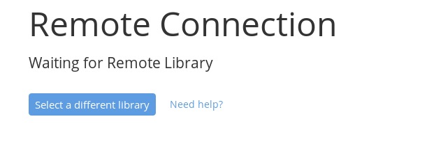

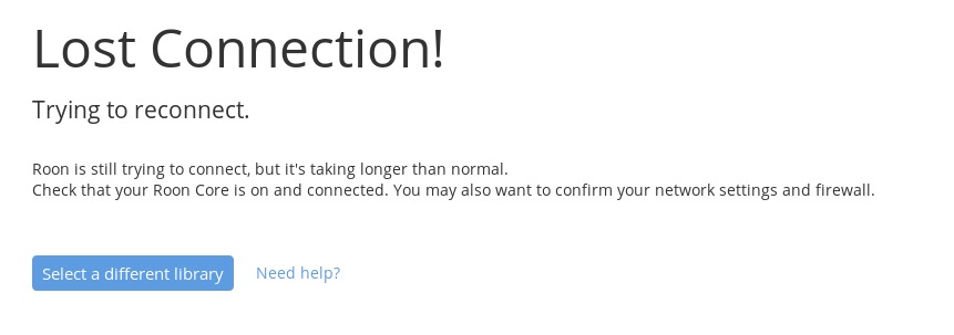

No luck today, im experiencing constant loss of connection, trying to reconnect, select another library ..
Had the BDP self-powerdown a couple of times, lockup, or just stop responding to the various controls.
Al might be related to the NAS being to under-specced having a hard time indexing the tracks. Maybe another reason, who knows.
All in all, i am beginning to think a NAS isn't such a good solution after all , a dedicated computer might be the preferable way to Roon. Which makes it even more expensive of course ;-((

No luck
Perhaps a networking issue, either between your controller and the server or between the BDP and the server?
Also if you look at roons website they recommend a pretty beefy NAS for the server
http://kb.roonlabs.com/Roon_Server_on_NAS
In the description they even state you should be prepared to spend just shy of $2k US

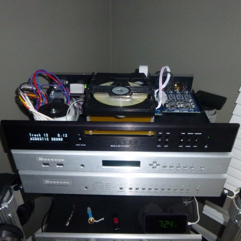

Speaking of the simplicity of CD - listening to the final prototype of our new CD Player.
Nice open design! No problems with cooling this way!
(just keep your cat away... :) )
