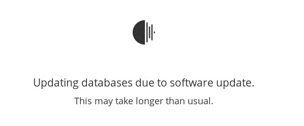

Maybe i have to wait for the Roon server to update, although i wouldn't know why, because my BDP stands idle right now, while the updating process is going on in the Roon interface and on the Nas (RoonServer)

Same NAS here, experiencing heavy gaps/dropouts in playing. 16 and 32 bit. Maybe because the RoonServer is still updating my library.
Also, i'm on 1 gb memory and external Hdd. Tomorrow an SSD arrives, and 2gb extra memory is on order.... Maybe that will help.
Maybe i need to dive into the setup, and check for special settings.
Marius

I suspect that to be the case indeed. I'll wait for the indexing to finish and my SSD and extra system memory to arrive for final judgement ;)
Roon released new updates today (officially naming Bryston btw) and the Synology/Qnap support. Maybe that helps too.
I'll check BDP system logs / memory usage also, the BDP1 might be a bit under specced ?
