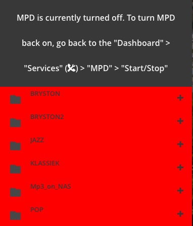

Needed to copy some files to the hdd's attached to the BDP, but the BDP keeps being thrown out in Finder. Disabling Roon Mode makes it available again for file management in Finder.
Is this expected behavior or a bug? SMB and USB mount are enabled in settings, so i thought file management might still be possible.
Enabling MPD again, for updating the database gives:
Please have a look at debugging this? Transitioning between the various services and back again isn't as robust as is should be yet.

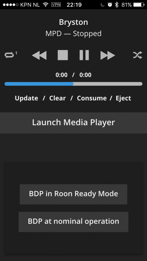

Hi Chris,
Since MPD is disabled during Roon Ready
Mode, wouldn't it be nice if the
Command button Launch Media Player weren't displayed, and MPD 'stopped' be changed in to something like MPD 'unavailable'?
Cheers ,

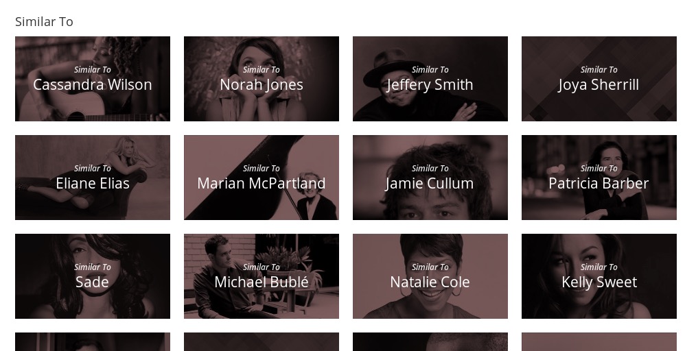

hi Grit,
You mean like this?
Roon delivers this searching for Diana Krall. It first shows whats in your own library, and scrolling down, this is what im presented with.
