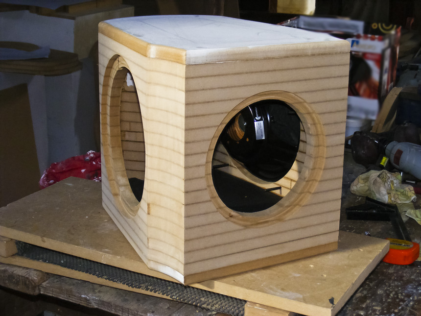

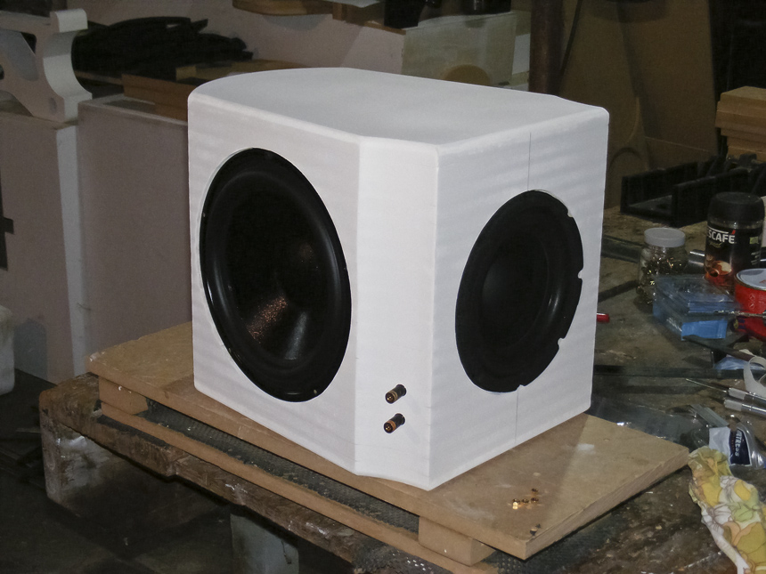

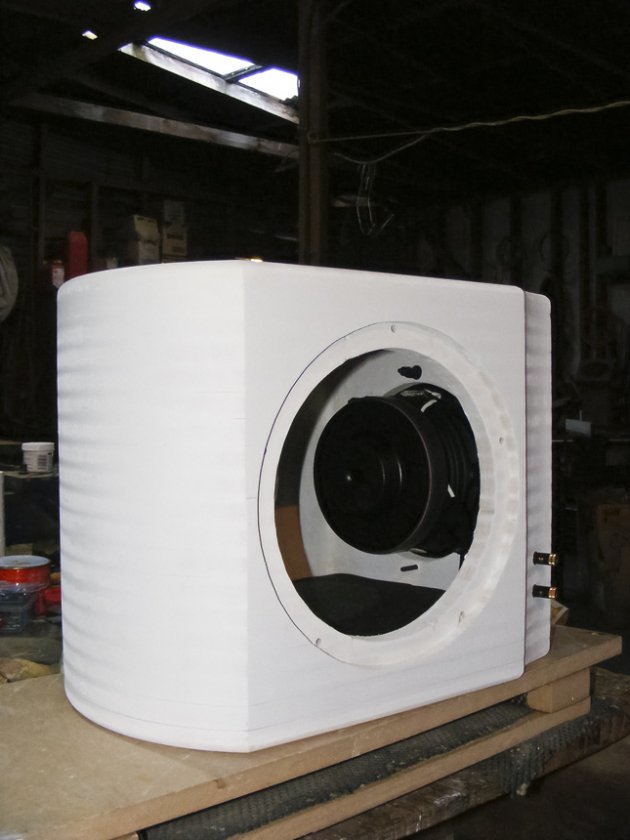

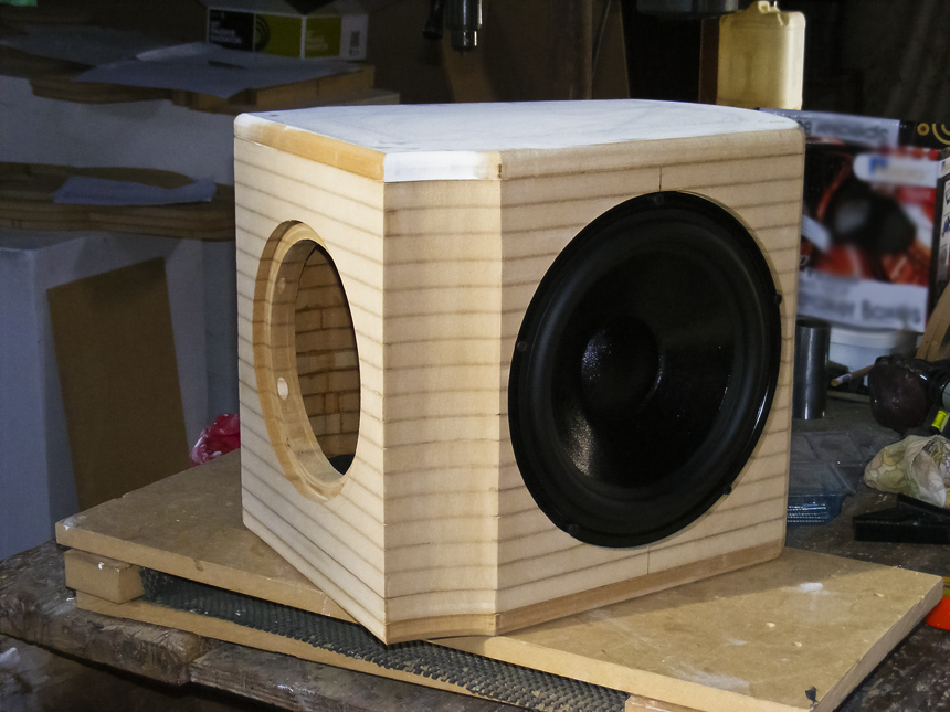

Anyway, the new G-Force sub woofer project was mainly build from MDF (Of Cuts), but the idea came to me after reading so much about this Tang Bang W8-740P 8 inch woofer and with that what people had done with it or tried doing & what different cabinet volumes had been used with it.
It is really all quiet strait forward as this was the first woofer of that type I had ordered from PE for testing in a couple of project enclosures with over 30 liter plus & this one with 21 liter, the enclosure is a little different as I wanted to try some new ideas & materials in it, and I only just received these materials after waiting for it for some month now. As for new ideas for example I’m using a new type damping material I found way back, and that the inside of this cabinet (Inside only at this stage) will be covered with some skin like product etc.
The enclosure volume which is empty 21 liter will end up to my calculations in the end with about 13.5 to 14.0 liter so not a lot of volume, but when I look at the recommended enclosure volume of 7.1 liter (.25 cuFt) for a vented, and 3.1 liter (0.11 cuFt) for a sealed my volume idea is still double that.
Accompanying this woofer are two 10 inch Passive Radiators from PE as well, and that is it but I really want to see if this woofer will perform with such small volume as predicted as it works quiet well in a larger cabinet like my Renegade project were it is presently still mounted in - to Run In.
rgs UpperCut
Images are from the last couple of days .... Only today I was doing the first undercoat and first fitting of woofer.
The very first time weighing in with woofer & 1 PR only = just over 21 Kg ....

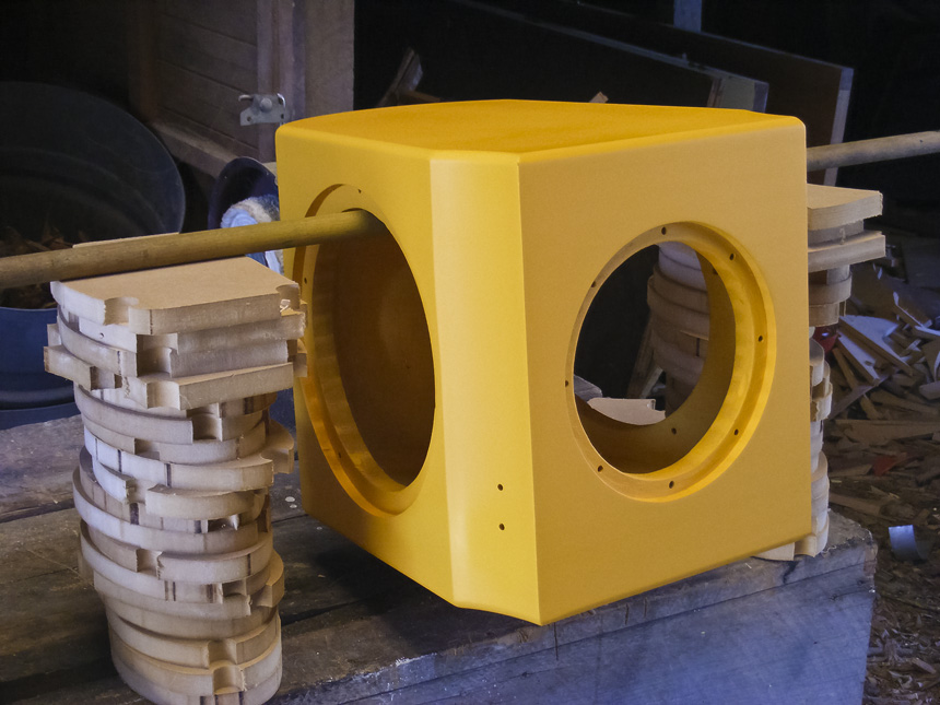

Hi there,

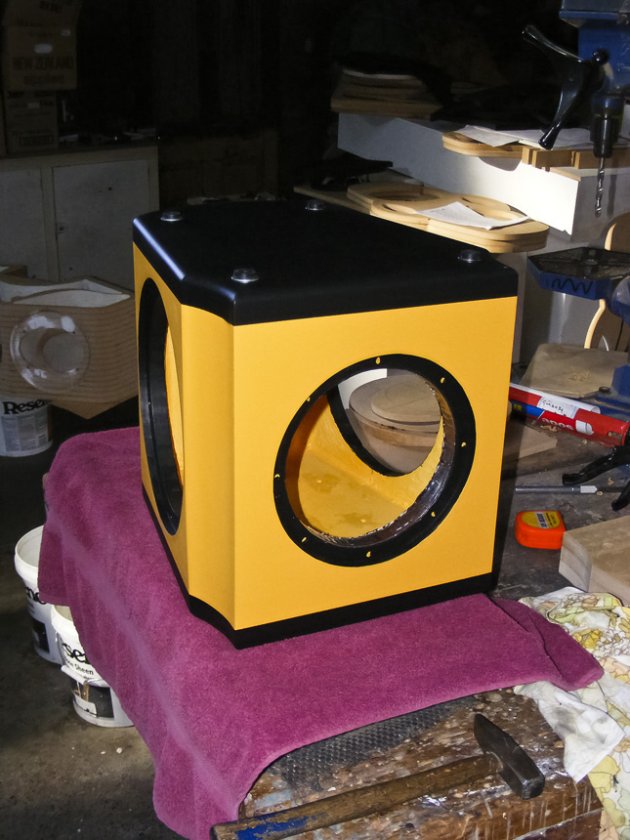

After days on end having cold & moist weather not been able to do any painting here is the last 'Melon Yellow' coat on the enclosure!

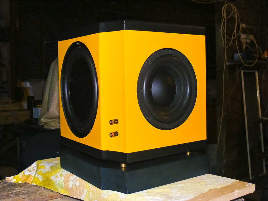

I also have started to build a set up for this enclosure a bit different to the norm (Nothing New) as I want to use that as a single item below the unit – Solid Spikes pointing towards the enclosure - as well as it is needed for the Display Platform project LINK: -
http://www.audiocircle.com/index.php?topic=143596.0 -.

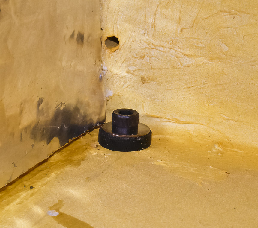

There is of course a special reason for trying this as in my projects which have spikes I make sure that I have no air leaks so I block the holes for these spikes with a rubber threaded nut which enables it to be virtually air tight. This will be handling an opposite dual nut to enable the close up as well as fitting to the spikes!
rgs UpperCut

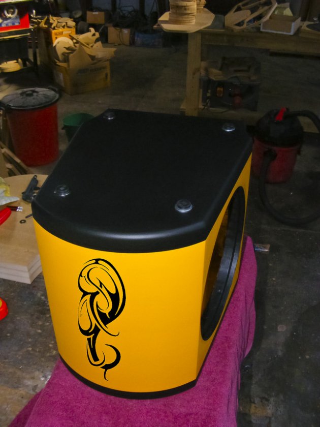

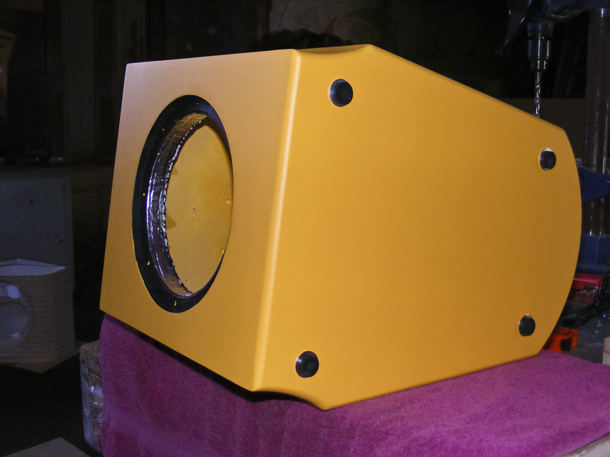

A few more Images from the work I was able to do today! Had only a couple of small mishaps so they are not of great concern & fixed soon.
Enclosures 1) Underside & 2) Upperside
rgs UpperCut
« Last Edit: 2 Jul 2016, 09:08 am by UpperCut »

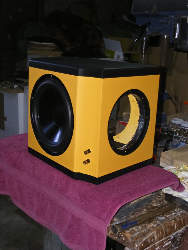

Every build eventually must come to an end & with that this one was quiet tricky and challenging, but I enjoyed all of the many stages very much.
First time fully assembled & everything does fit perfectly!
Just a shame that I have only one brand new 10 inch PR left in store & another defect one so I guess until the new ones arrived (once ordered) it could spring into action, but until then I will leave the defect one fitted and see what will happen when running it.
So presently not much more left then Artwork and waxing it nicely to avoid any marking as the charcoal colour as that is just showing up everything & I mean everything even when touched without been treated. Oh yes of course just remembered the bottom plate with the spikes is still to be done!
rgs Upperut

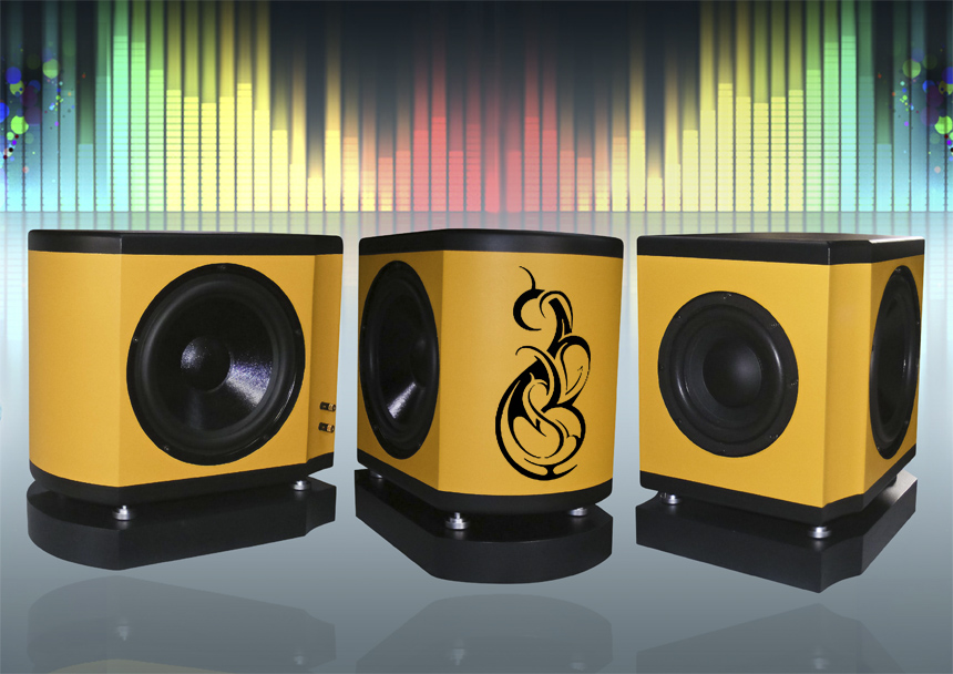

Well, the paint is dry so a first look at this first set up! By the way I like to mention that this bottom plate can be used as is in 3 to four different ways, and I will try all of them if possible over time to figure out the best one suited.
rgs UpperCut

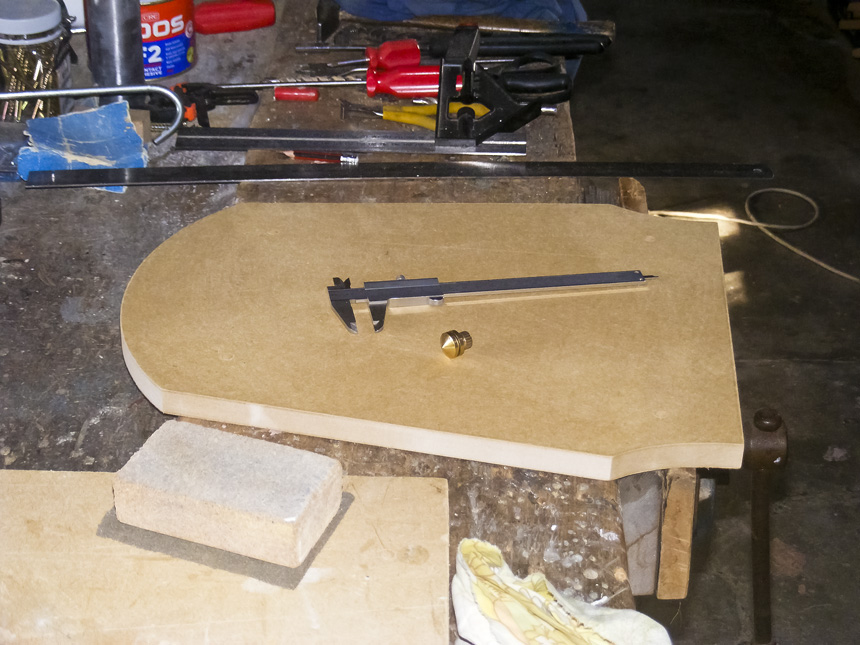

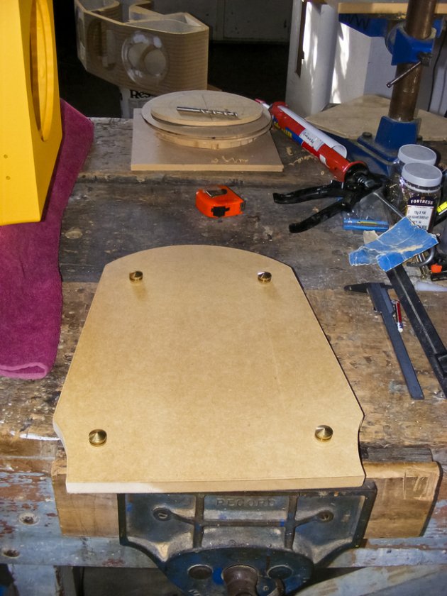

Hello, thanks for your reply!
YES these are solid Brass spikes (short & Stumpy) and not the usual larger once I like to use, but I had about 12 sets of these laying around & presently none of the larger type so I wanted to try these.
Now this how it is:
There are rubber mounts in the enclosure itself to fit the sharp end of the spikes as the spikes are mounted up side down in the bottom plate so YES you saw the right pieces - Rubber mount & spikes. The underside of the plate which I did build for testing can have a none slip material or rubber mounts again or if I wanted to turn it the larger set of Spikes so I have options to play around with.
Now these rubber mounts inside the enclosure are actually for sealing the sub woofer compartment & outside to accommodate sharp end of spikes or when removed spikes of the larger type in the normal way as the diameter for both is the same.
The rubber nuts are ‘Well Nuts’ or better I say if you not have heard of them rubber mounts with a usually brass nut insert so these are 6 mm threaded which means once you screw a cap bold with washer into it – it will spread and fasten itself (seal the hole) very tidily / securely, and the rubber has a very nice (not to hard & not to soft) rubber. I use these even with 12 inch woofer to fasten securely as these are available with 3 mm to 12 mm thread.
rgs UpperCut

Hi there once again,
Have to say that I personally & by my own opinion like these larger Spikes more!
Another idea on this one was to actually make it active and I started to look into that as the bottom plate I found could be suited for that as well.
rgs UpperCut

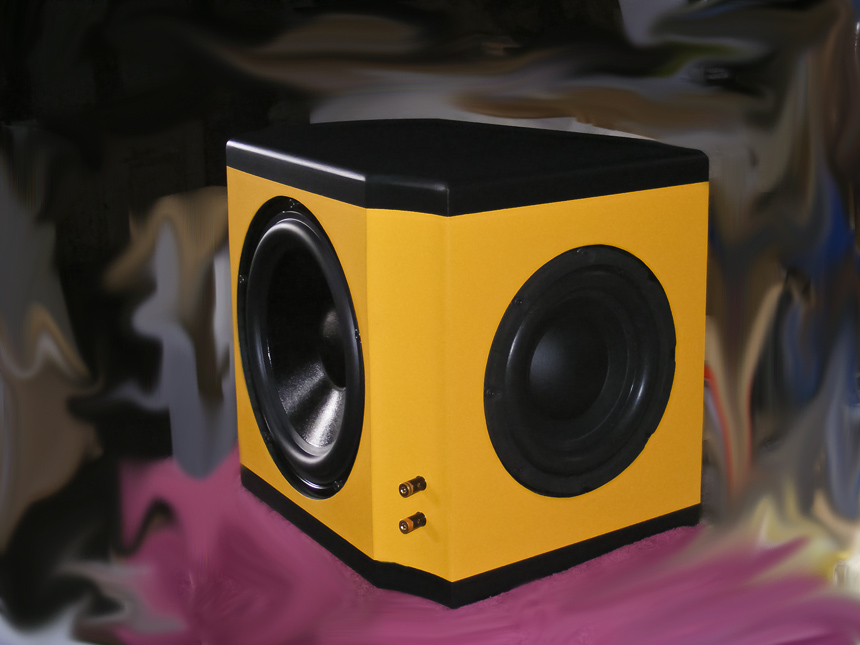

Thank you guys for the replies!
Just to clarify: this is one and the same unit! and as for myself it is always what lies in the very details when you build it yourself like using cap screws with rubber threaded nuts to ensure among other things that you get not only a good but a perfect sealed unit & decoupling if possible for breaking up such great pressure resonances, and of course as previously explained the inside fitting & sealing of the spike holes and the mounting in different ways of the spikes itself Etc. Etc.
The Tribal marking of course is presently just an Artists expression and it shows what can / could be done as I believe a project in DIY should be about what once can visualize, imagine & how somebody feels about his own work ethics, and of course his ideas of effective musical sound reproduction.
By now it has run and I’m more then happy with it! Extremely tight sound down to the low 30 Hz effective & effortless with no distortion for such small unit quiet amazing.
rgs UpperCut
