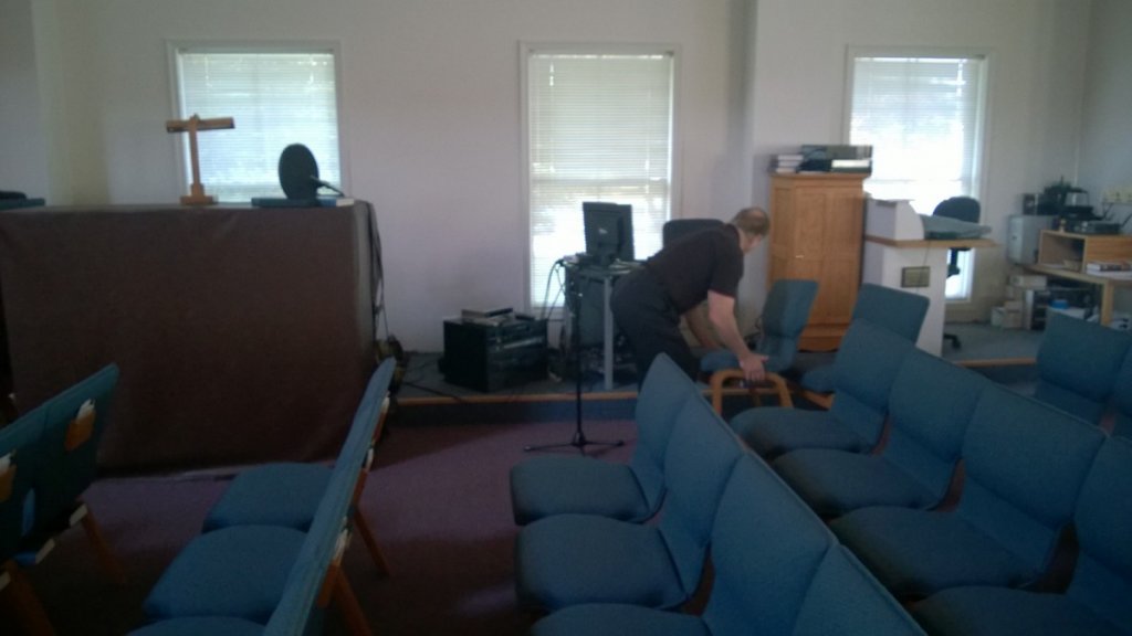

Will be recording a solo grand piano recital today with the HAL recording rig.
Using an MS-3 with an Echo Audio Echo2 ADA and Adobe Audition 1.5 as one of the recording systems.

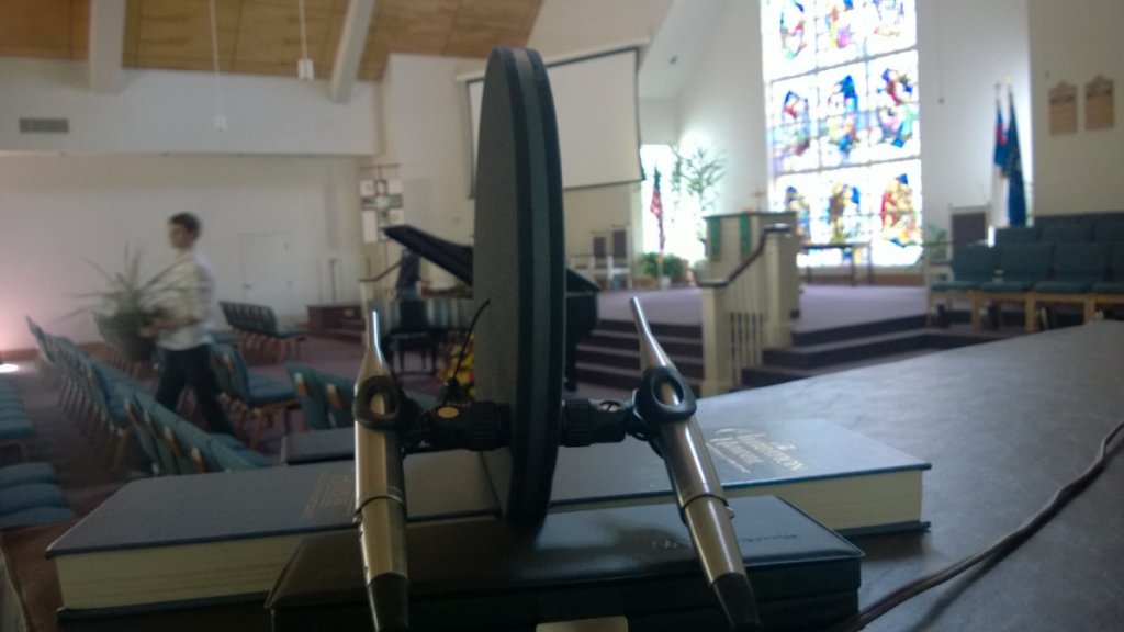

Mic will be an OSS disk with two Earthworks M550 Omni's and Earthworks 1022 mic preamp with Phantom power into the Echo2 line in.  All balanced connections.
The repertoire has been kept secret, so only get a sound check and then press the GO button.  No stress at all!  :o

Well the live recording of a Steinway and Sons Grand Piano with an excellent pianist Baron Fenwick is complete.  Avoosl accompanied me as the second recording system engineer and we did the two system setup.
Two different HiRez recording rigs with three stereo mic systems were recorded for the evening.

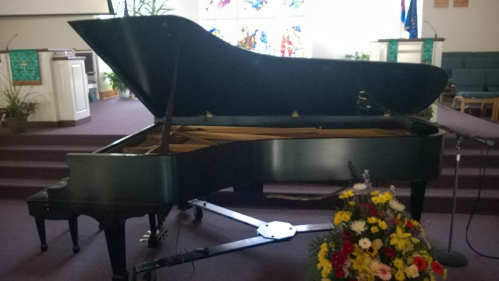

Pictures of the mic setups.  The main X-Y pair in the piano, a second at the recording position and the OSS Jeklin disc on the organ console.  Sometime you have to get creative!  :o

Just listened to some of the pieces from the OSS stereo recording on Avoosl's VMPS RM50's.  The piano tone is huge in the lower registers.  The Earthworks mics are Omni's and have response from 2Hz to 50KHz.

What I heard at Avoosl's tonight was amazing and very different to most stereo recordings, since the OSS disk is almost binaural in nature, but with very extended LF response due to the Omni's.  I would love to hear this stereo mic array record an orchestra with a pipe organ concert!  :o
