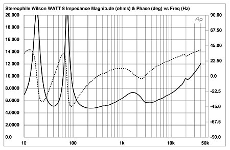

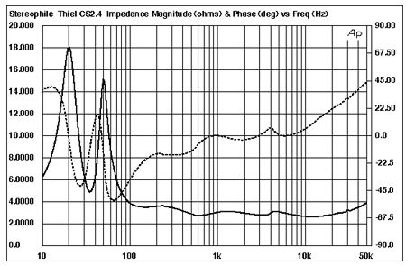

The Velocity Bridge is for loudspeakers that have an inductive rise in their impedance response in the higher frequencies. Some loudspeaker designers compensate for that with a network, others do not. So it FLATTENS the impedance in the higher frequencies. Here is an example of an impedance curve where the VB would be of benefit-> See Figure 1 or 2: http://www.stereophile.com/content/dynaudio-excite-x12-loudspeaker-measurements#tcy2Lb0ckZOXTdeE.97
and -> http://www.stereophile.com/images/archivesart/607WILFIG03.jpg
Here is one where it would NOT be of benefit -> http://www.stereophile.com/images/archivesart/theC24FIG1.jpg
And-> http://www.soundstagenetwork.com/index.php?option=com_content&view=article&id=1238:nrc-measurements-revel-performa3-f206-loudspeakers&catid=77&Itemid=153
Or even -> http://www.soundstagenetwork.com/index.php?option=com_content&view=article&id=941:nrc-measurements-kef-ls50-loudspeakers&catid=77&Itemid=153
So unless you have made an impedance measurement of your loudspeaker or have published measurements, you have no idea. Yes, you can measure this right at home.
As you can see the cost of the loudspeaker is immaterial. Some include this network and some don't.
Amplifiers that have HIGH output impedances (like greater than 1 ohm) will benefit more. An example would be a SET 300B design and perhaps the Pass F2 or F3. An amplifier like the NCore 400 for example would probably not benefit as its output impedance is about 1 milliohm from 20-20khz. That's 0.001 ohm. Your speaker cable will influence it more than anything else in that scenario!
Best,
Anand.
