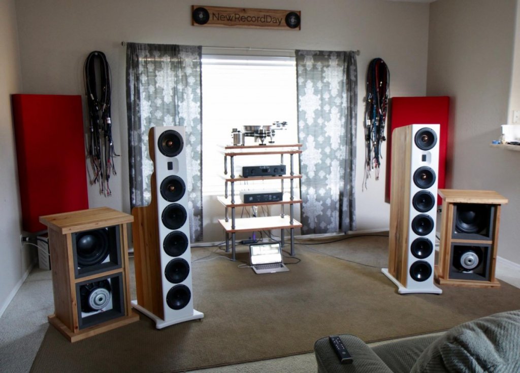

Looking at Vedder's subs and Jay's subs, I didn't know there were two (or more) variations of them. What are the differences?
The Rythmik A370PEQ amps that drive the subs can handle a 4 ohm load. Danny's 12" OB drivers come in 8 ohm and 16 ohm versions. So you can build the sub with either two 8 ohm or three 16 ohm drivers. A third option would be two 16 ohm drivers if you thought you might want to add the third driver to each side down the road. You would give up some output vs two 8 ohm drivers but if you wanted to add that third driver later on you would only need to buy two more drivers instead of six.
Another option is driver orientation. Usually one of the drivers is oriented opposite the other(s) and wired out of phase. However you could orient all the drivers in the same direction and wire them in phase.
Ron (Vedder323) built a two driver version with opposite driver orientations while Jay built a three driver version with all the drivers oriented in the same direction.

Re: Early impressions of the NX-Oticas and H-frames
« Reply #47 on: 19 Jun 2016, 11:08 pm »
yest another option is to use the NX800 amps (2 x 400 watt mono blocks) adn drive either 4 , or 6  12 drivers.
I haven't done any  4 or 6 driver flat packs  to date..... that  MAY change
Note, if anyone buying flat packs  is thinking of orientating  all the drivers in once direction,  pleaes let me know when we're talking so I can cut the roundover on the baffle accordindly and also  forgo the wiring  pass through on the baffle
« Reply #48 on: 19 Jun 2016, 11:17 pm »
What is the difference between driver orientation -- same direction vs. opposite, out of phase?? Any sonic differences? Pros and cons?
« Reply #49 on: 20 Jun 2016, 02:29 am »
The Rythmik Audio HX800XLR3 works well with either a 4 or 6 stack of H-frames with the GR- Research servo subs.  Split the wiring in half and you are good to go.
« Reply #50 on: 20 Jun 2016, 04:40 am »
Well,  with  the one driver facing rearwards in either a  2 or 3 driver setup, yo uget a more even distribution of the weight.   That last pair I built, I  faced them all forwards  out of curiosity.   They  are not going tip over on you unless someone plows into one, and in that case, the  tower with the one reversed drive may also go over  :cry:
Now, I wouldn't have expected any sonic difference  but, using the  same  amps and the same drivers that were in another pair of triples I had been using, I've had to reduce the  gain onthe amps by 3 or 4 clicks and the bass seems to be even cleaner/tighter with more  ooomph behind it. I  am pretty surprised at this and was not the only one to notice the change.
I've mentioned it to Danny and beleive he will try his next set like this to see if he gets similar results
jay

I have been mentioning the reverse directions and saying this was "not" the thing to do.  You have drivers with their acoustic centers not together and facing different directions......always seemed silly to me.....just to get weight distribution centered.  I am glad someone finally actually listened.  My thoughts are confirmed.  When I used two of them they were on an open baffle both the same way.  My friend in Oregon has 3 on an open baffle all facing forward with great results.  See here:  http://www.audiocircle.com/index.php?topic=142235.0   This way you can align the voice coils with your main speakers if you like as well.  This is more important the higher you xover (like with wedgies, etc.).
