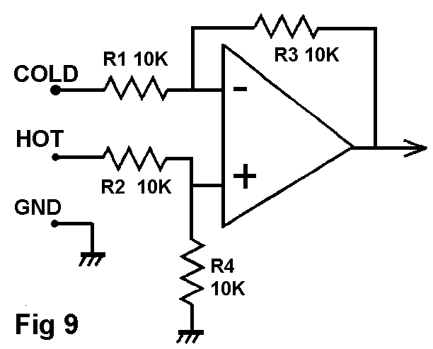

A balanced Tortuga will be connected to the balanced input stage of typically a power amp.  Just about all of these use a simple balanced input looking like this
This actually has different loading for V+ and V-. Conventional wisdom is that the V+ sees 2R, but the V- sees only R (which is bad enough!), so as far as loading is concerned the simple balanced input is not balanced at all. But it is even worse than that.
The V+ impedance is 2R that is expected, but the V- is 2/3R, not R. This happens because of a sort of negative bootstrap. The + input of the opamp receives half the + input voltage. The difference between the + and - opamp inputs has to be zero, so the - opamp input has to be also 1/2V+, and hence the voltage across the V- input resistor is 1.5 what one would expect, reducing the effective input resistance to R/1.5 = 2/3R.
The typical balanced input will use 10k resistors, with the + input seeing 20k.  But the - input only sees 6.67k.  This difference in loading has a significant impact on any balanced passive pre, and the Tortuga is no different in that regard.  It will manifest itself as a balance shift as volume is adjusted, because the output resistance changes with volume setting.
Also just about all the "conventional" balanced input stages generate considerable noise as compared with a single ended input - as a result of the relatively high values of resistor used.  This is why just about all high end manufacturers quote power amplifier noise with the single ended input only and remain pretty much silent about the balanced input noise, which is usually worse by a good 10-15dB.
There are various balanced input stages which mitigate the impedance imbalance (but with noise problems too), but since you don't know what design philosophy has been used, and with amp manufacturers being pretty much silent on the topic,  you cannot assume anything.

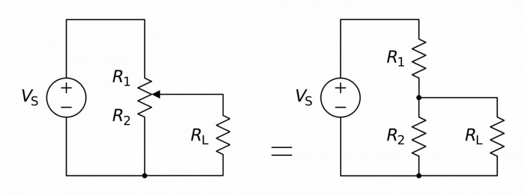

The Tortuga LDR control works like a regular volume control, or any passive pre that uses switched resistors.  So you have something that looks like this
R1 and R2 are the LDR's, and are both adjusted to change the volume.  The sum of the two, R1 + R2 is equal to the resistance setting (20k by default).  The load presented by the power amp (for example) is shown by RL.  That is in parallel with R2.  If RL not sufficiently high, the volume control "law" that is in the manual (and spreadsheet) will be different.  If the amp has input resistance RL of around 100k the loading of the LDR at 20k setting the loading will be minimal.
The real problem that *could* arise is with a balanced passive pre where there are two of the above, one for positive and one for negative signals (V+ and V-), which are the same amplitude but one is inverted with respect to the other.  If the simple balanced input is used, as in the picture in the first post, the load resistance is very different for V+ and V- (by a factor of 3), which adds another layer of modification to the volume law.

You have to put this into perspective. It's really not issue or even a potential issue except perhaps in some extreme case with really really bad balanced audio gear.
A balanced audio source sends supposedly identical signals down 2 wires except those 2 signals are 180 degrees out of phase with respect to the other. Our balanced attenuators attenuate (i.e. control the volume of) each signal separately and reasonably close to identically. When those balanced signals arrive at the amplifier's balanced differential input stage there's a presumption that each phase will "see" the same impedance. That may not always true as it depends greatly on the detail design of the amplifiers differential input.
To the extent an amp's differential input has significantly different impedance levels between the 2 phases it could somewhat defeat the effectiveness of balanced signal transmission (noise immunity) and the stereo imaging could be skewed slightly left or right depending on the degree of the impedance imbalance.
As a practical matter this has not proven itself to be a big issue, a small issue or an issue at all with our balanced LDR attenuator. To the extent it were to occur, a simple tweak in the left/right channel balance using the remote would correct for it.
In short, we're not going to work on providing a solution to a problem that hasn't presented itself as a problem. There's nothing different in the V3 vs. the V2 in this regard so you can check this concern off your list.   :thumb:
