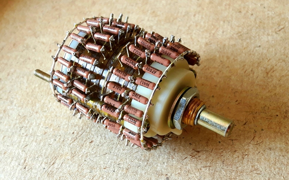

Here's the inside picture of our stepped attenuator we offer as an optional upgrade for all of our amplifiers.
These are 24-step, ladder-type attenuators. Ladder types are by far the best performing type of attenuators and are made with no audio compromises, unlike shunt and series type attenuators.
The downside is that they require twice as many resistors to build because each step is its own volume control circuit with only one resistor in series with the signal path.
Our attenuators are hand made in house with 92 Vishay/ Dale Military grade, ultra-low noise and a rugged, silver plated 24-step attenuator switch.

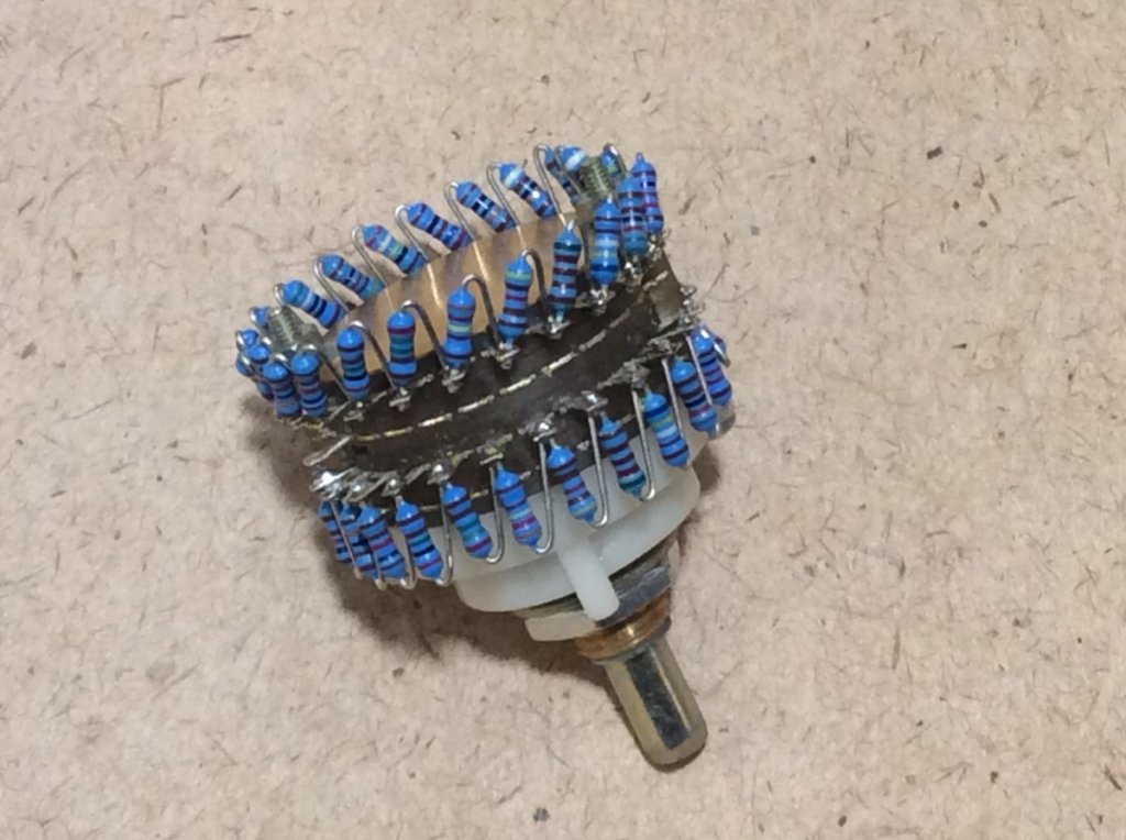

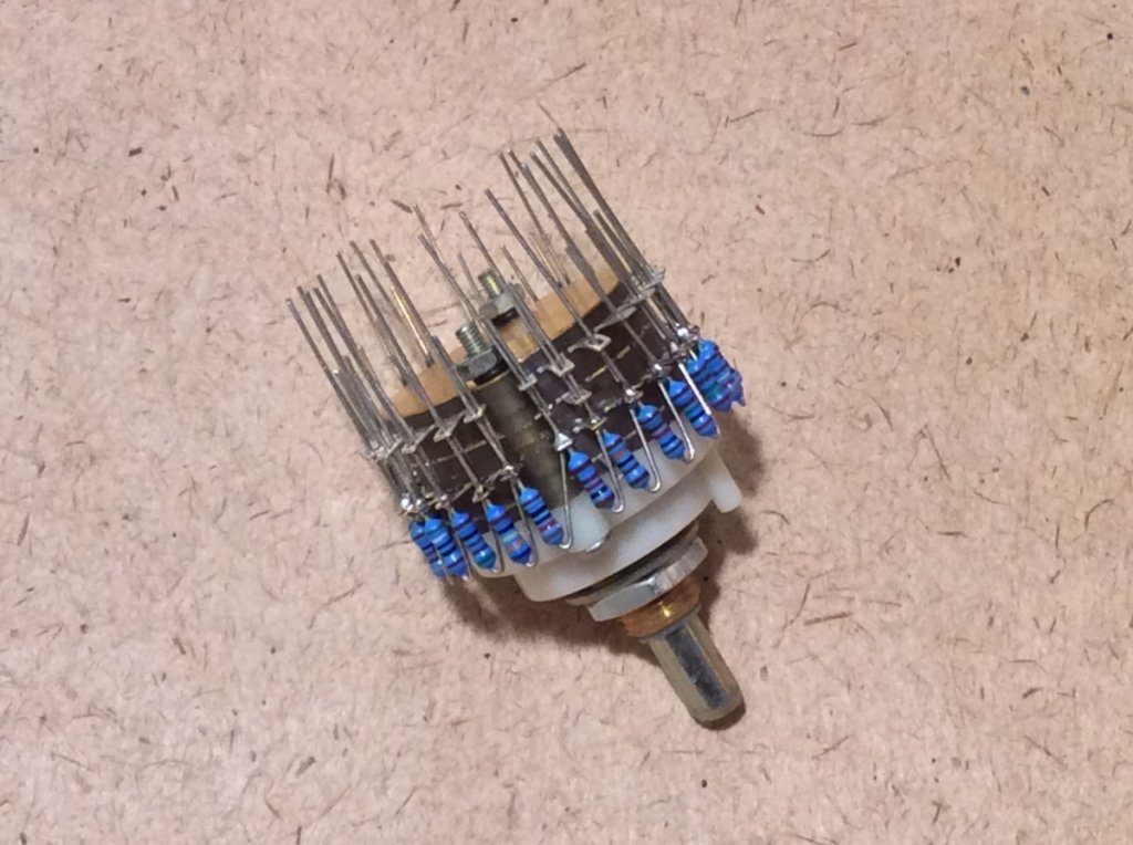

EDIT Feb 27, 2018:
We got a bit better at making our attenuators over time, so I included some pictures on how our new 24 step attenuator is made (this one comes stock with all amps)  8)
This is just a bare switch
This one has its first row of resistors soldered in. We clip the leads and then do the other side.
This is a completed attenuator, tested and working perfectly!  :wink:

Had grey hill ones like the bottom picture on an arc sp6a,
Mike B.
Re: An Inside Look at Our Stepped Attenuator
« Reply #5 on: 19 Jul 2017, 02:08 pm »
I have purchased two of the top example of ebay in the past. Nice attenuator.
Probably not mine though ;)
I designed the attenuation curve on these and build them myself with RN Vishay resistors. Most you can find on eBay are made in China/ Thailand with fake name brand resistors and uneven attenuation between steps.
I actually changed the way I build those ones now to be a bit more compact so the resistors don't stick out so much anymore.
I'll upload a new pic sometime :)

« Reply #11 on: 27 Feb 2018, 11:25 pm »
I updated the build for our standard attenuators and included new pictures for anyone interested  :)
