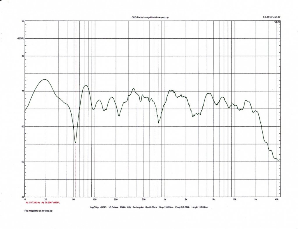

Had a day to make some measurements on The Megaliths and do some response tweaking.
The is the Audiomatica Pocket CLIO frequency response of the left speaker at my listening location 8' from the array.  Still have some room interaction to work on, but very nice without any room correction system running at all.  The measurement has 1/3 Octave smoothing, 100mSec time window and 48KHz scale for reference.
