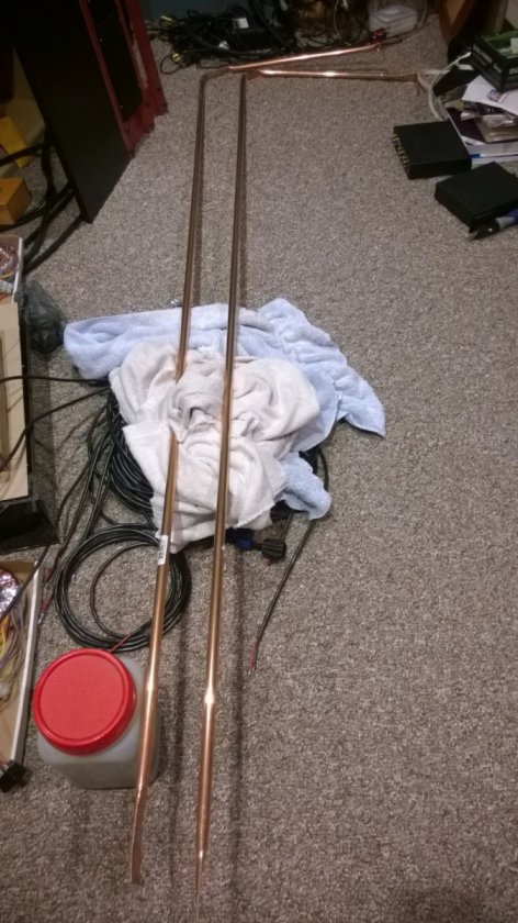

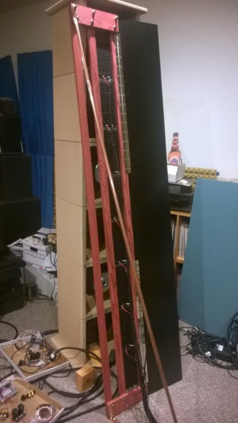

Hauled the bottle of lead shot down to the Lab to fill the copper pipes for counterweight.
Then will be time to hammer the end shut, bend the angle and drill the mounting holes.
HAL
Re: The Megaliths open baffle line array speakers
« Reply #81 on: 6 Jun 2016, 09:33 pm »

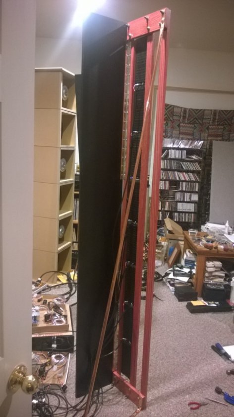

The baffle stabilizer and counterweight with the lead shot added and other end closed.
Next is drilling the mounting holes and connecting them to the baffles.

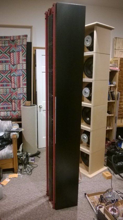

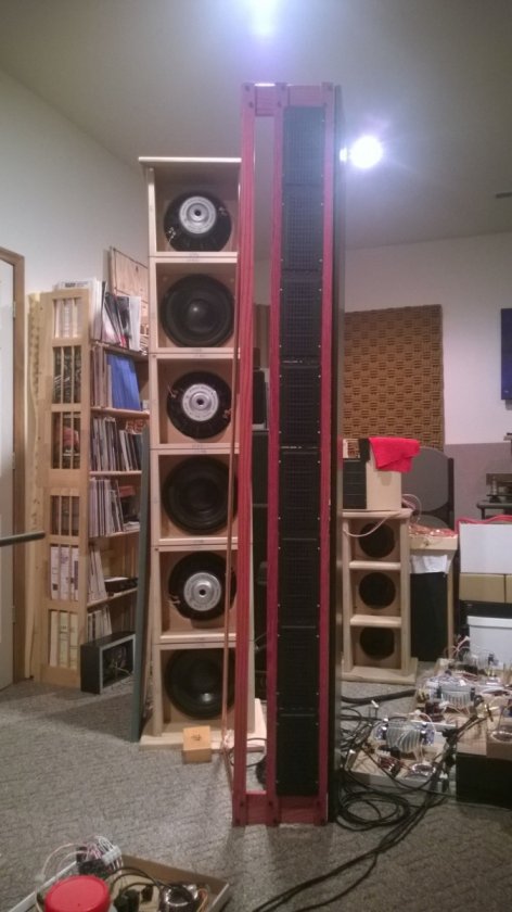

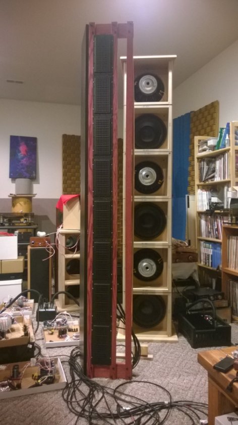

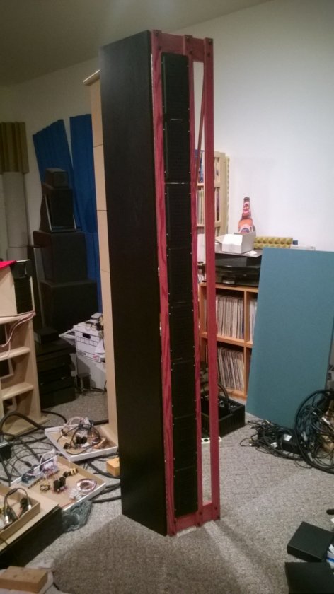

Baffles completed and standing.
Next to wire up the Neo10 drivers and see how they measure.

Wiring to the amp modules is ongoing.  Will complete wiring to the amps tomorrow.
Baffles and servo subs setup for trials.

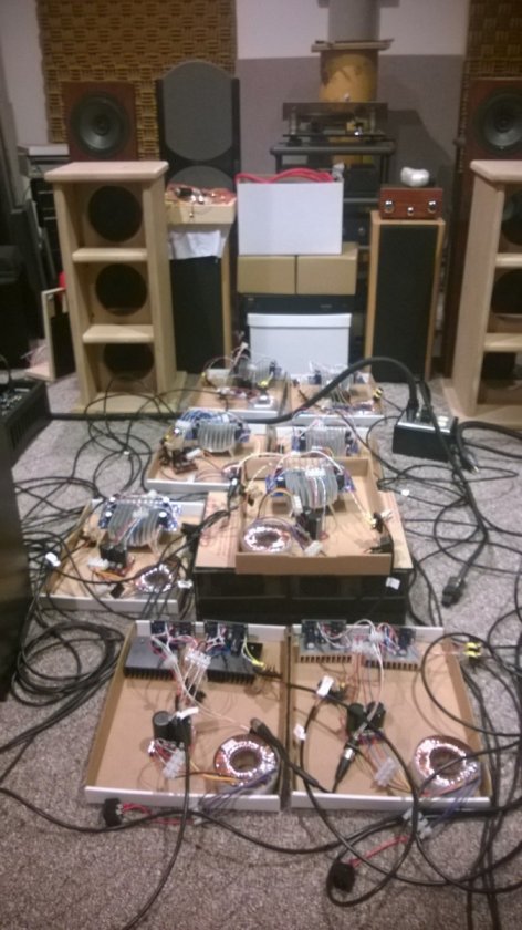

All 16 amp modules are now wired to the Neo10 drivers.
Wiring layout designed to catch those pesky mp3 listeners and hold them down while listening to HiRez music.  :D
Next is to connect the balanced XLR cables from the dspMusik to amp modules and start the testing.

The final XLR balanced connections from dspMusik to amp modules are complete.
Tomorrow is power up, measurements and Room EQ.

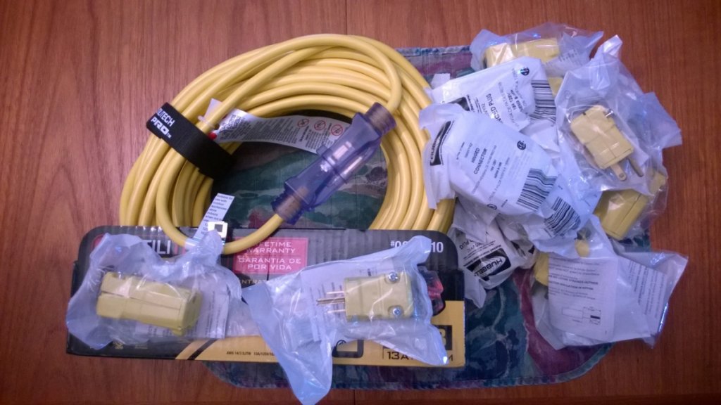

Nothing is thwarting todays startup of the speakers.
Trip to Lowes.  100' power cable on sale and all the Hubble connectors to build 8 - 10' extension cords.
The audio mad scientist is not letting the lack of AC power stop this!  :o
