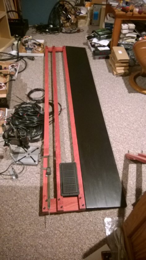

Meet The Megaliths baffles in my favorite color scheme.  Built by a local Amish wood craftsman.
Next up installing the BG Neo10 drivers and wiring them to the amp modules.

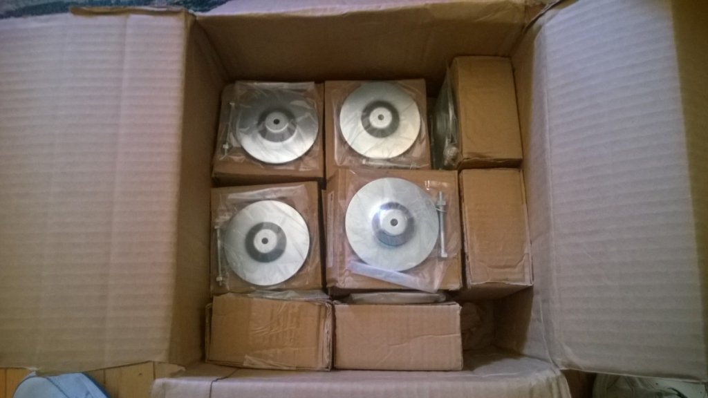

Test fit of the 8 - BG Neo10 drivers in The Megaliths baffle.  Just have to modify the gasket to fit on the rear of the drivers to mount on the baffles.

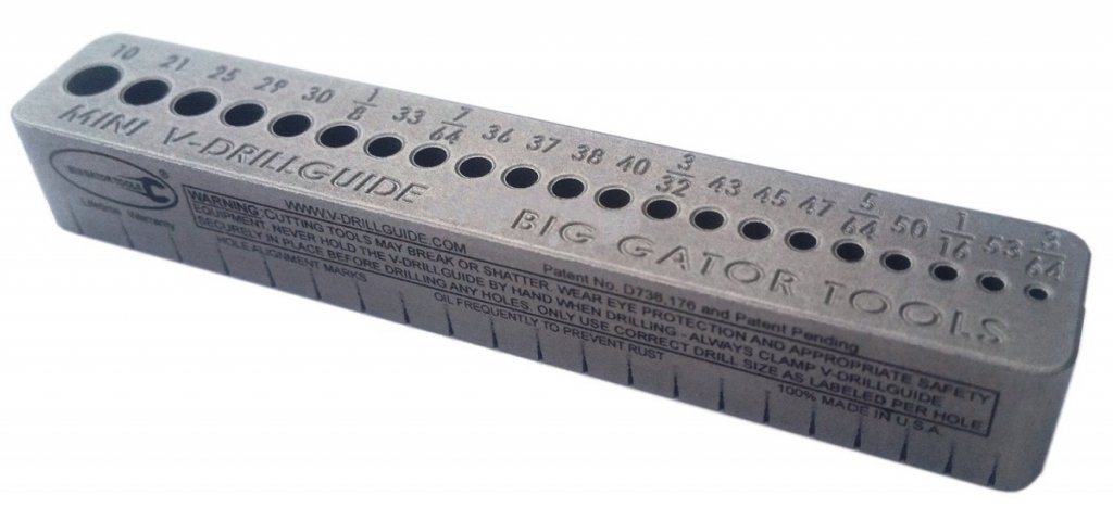

Will try a Big Gator Tools Mini V-Drilling guide with the angled drill guide to drill the 240 pilot holes for the BG planars in the baffles.

I thought of an observation/question for you:
The front baffles look to be fairly lightweight and not capable of supporting much weight. Will they securely hold all the drivers, and will they not tend to flex (or vibrate) during play? [I have no idea how heavy the PDR drivers are.]
Michael
P.S. The speakers are beginning to look pretty interesting.  :thumb:
HAL
Re: The Megaliths open baffle line array speakers
« Reply #49 on: 14 May 2016, 03:31 pm »
Michael,
The weight of the drivers total is 28.6lbs.  Since there are 16 screws for the Neo10's and 44 screws for the Neo3-PDR's per side, the hope is that the steel planar housings will add the stiffness needed for the baffles to be rigid.
I also plan to use a 10' piece of 0.5" copper pipe bent into a angle to attach to the frame to act like a foot and stiffener.  This should add to the stability of the baffle and add stiffening to the outside edge that does not have the wing and hinge for stiffening.
I like the look.  Glad you find it interesting.

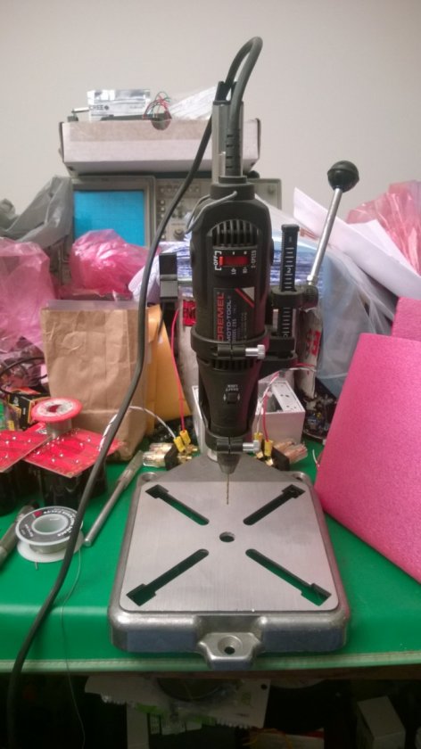

« Reply #55 on: 18 May 2016, 01:18 pm »
Took this out of the model building equipment.  Dremel Tool drill press.  This should work very well with the V-Mini drilling guide.
Everything should be here today and will see if I can start the Neo10 installs.

The mini drilling guide arrived today.  Got to get my digital calipers back and should be ready for some pilot hole drilling with the drill press.

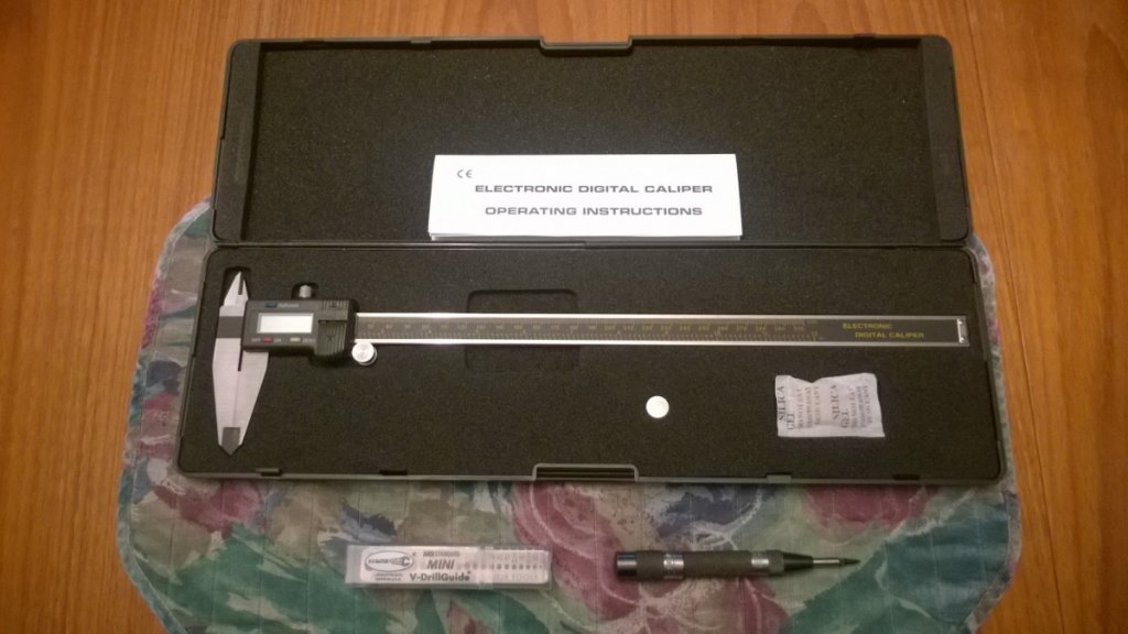

Digital calipers located.  Also the V mini drilling guide and nail set.
Calipers need a new battery and then off to the measurements!
