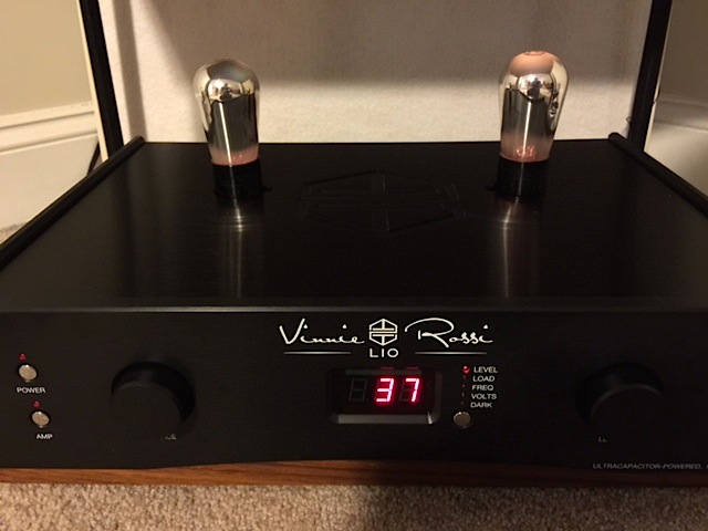

Here are a few pics of the LIO DHT without the cover and with the SV811 tubes.  Sorry for the so-so image quality - these were taken with my phone instead of my DSLR.
These were taken when Vinnie brought over the DHT for a listen a few weeks ago.
Can't wait to get my DHT!!
George
