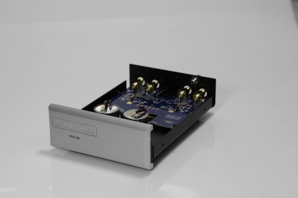

SUBJECT: Bryston TF-2 Moving-Coil Step-Up Transformer
December 2015
Most Moving-Magnet phono stages expect to receive a signal between 3-6 mV at their input from the cartridge.
A step-up Moving-Coil transformer is designed to accept the lower voltage output from the MC cartridge and increase the voltage to a point which is acceptable to the input stage of the standard MM phono section.
The Bryston TF-2 Moving-Coil step-up transformer is available in two versions...with a 20dB or a 30dB gain option.
Your choice on which unit is most appropriate will be determined by the voltage output of your chosen cartridge.
• From .1 to .2 mV we would recommend the 30dB version
• At .3 mV we would say either version would work fine
• From .4 to .5 mV or more we would recommend the 20dB version
An important point to consider when choosing which Step-up to use is you do not want to over-power or under-power the MM phono stage.
Under-powering results in not having enough GAIN in the system and over-powering can result in voltage overload and the resultant distortion.
« Last Edit: 17 Apr 2016, 03:27 pm by James Tanner »
