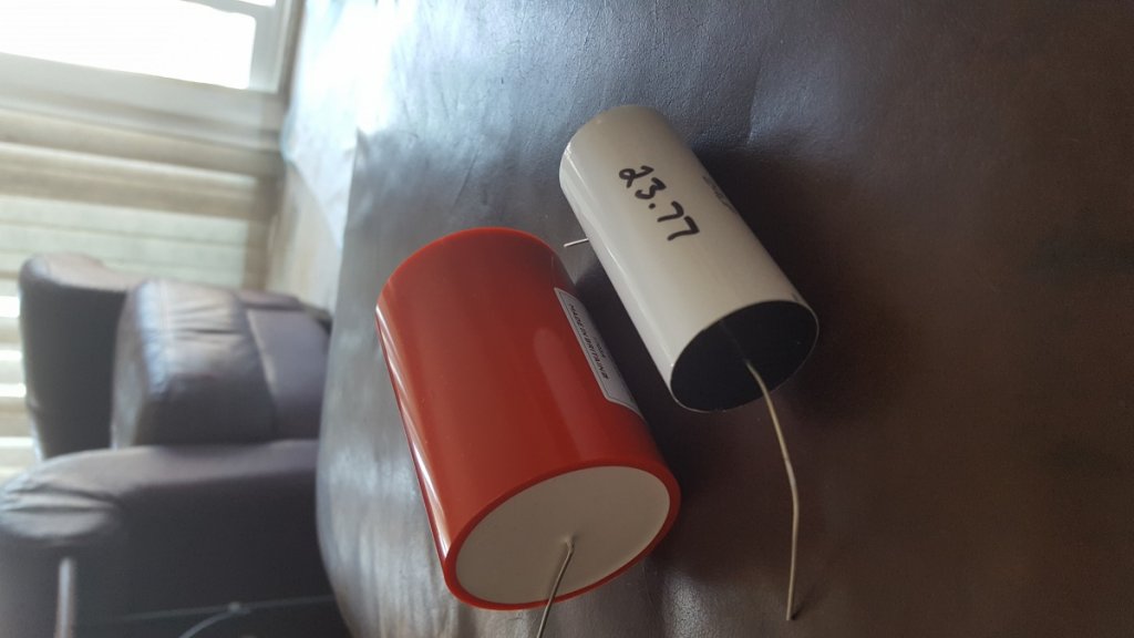

« Reply #25 on: 1 Feb 2017, 09:12 pm »
A 33.3 uF CMR beside a 25 uF Sonicap Gen 1.
