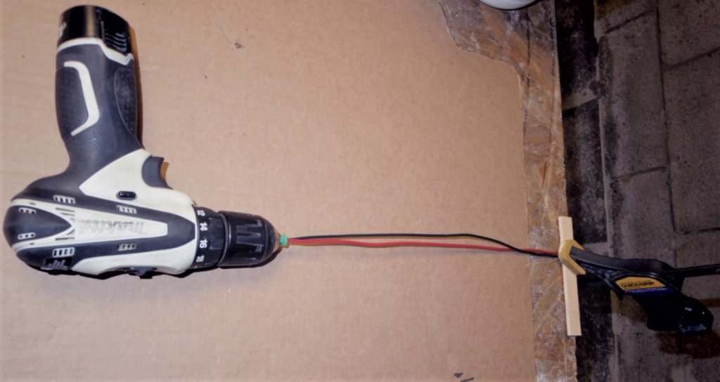

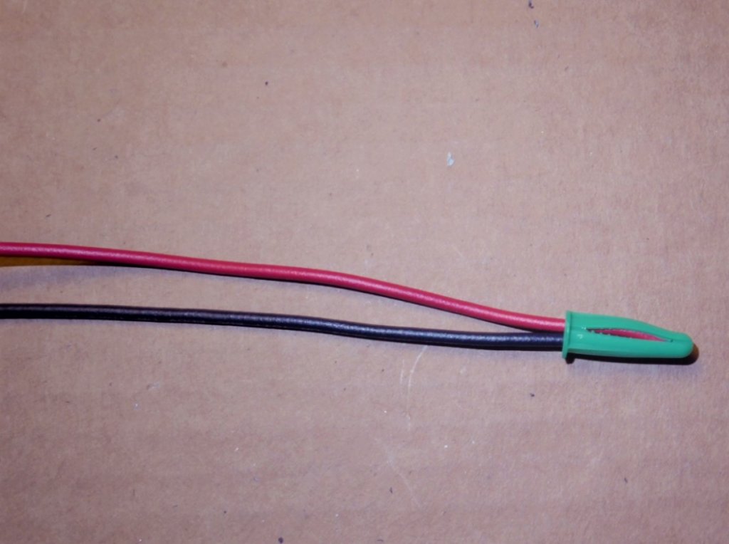

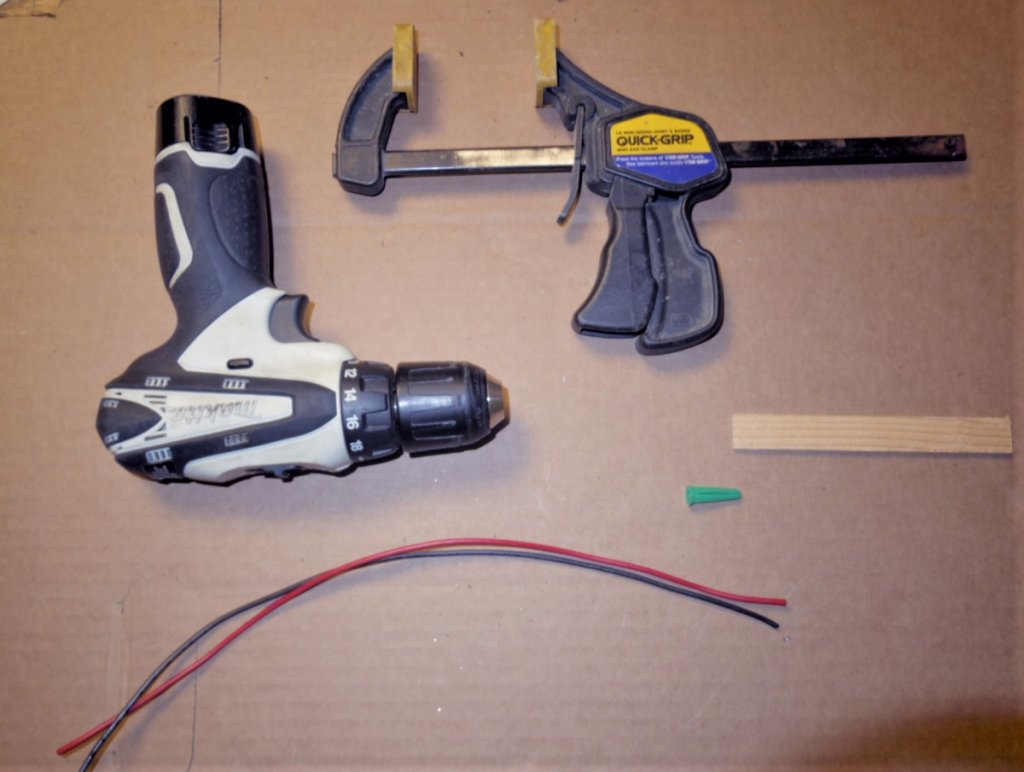

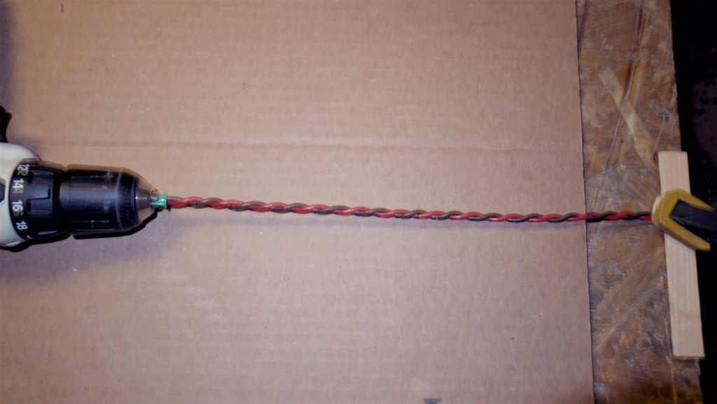

Yeah - it is sad it didn't take off with a bunch of great ideas. Anyway to answer your wire twisting tip request. Here is how I do it.
