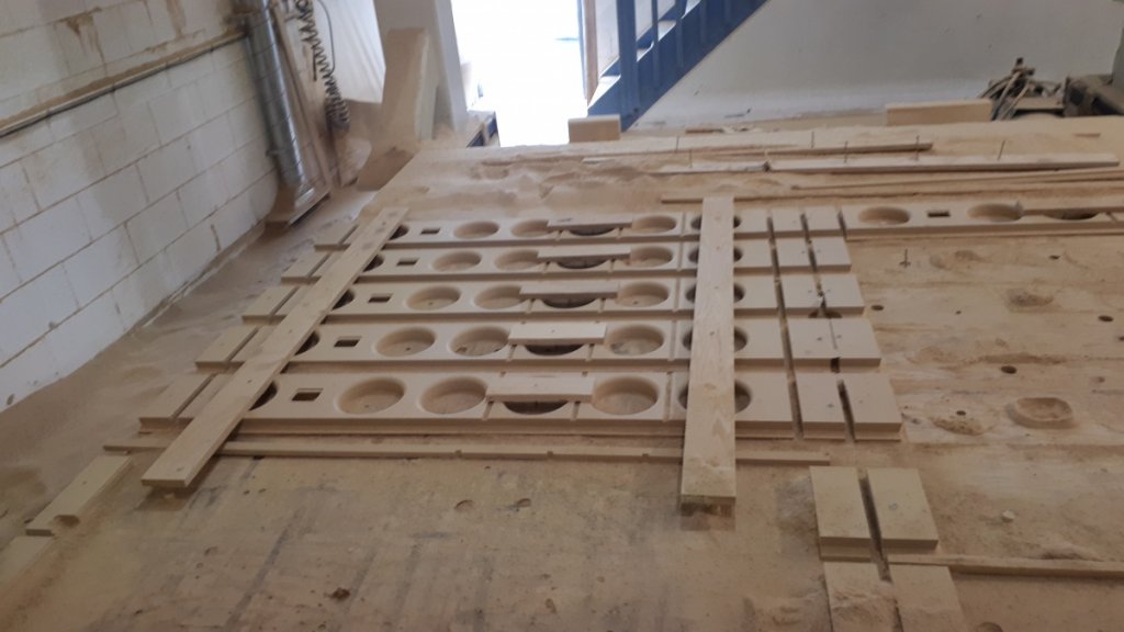

Hey folks
Just a  heads up,  we've got NX-Otica's back in stock.   here's a  shot of  a sheet of baffles on the 5 axis  machine
jay
