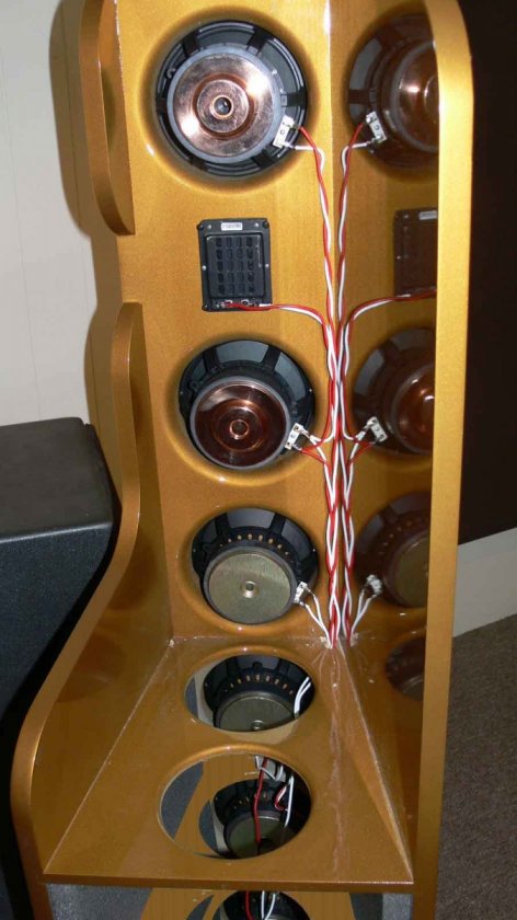

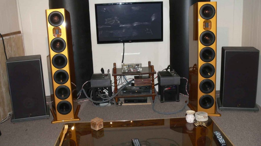

Well, the day has arrived
Used  a bundle  of Sonicaps  for the 100 uF  group in the mid filter along with a  Alpha Core Foil Inductor, an extra .1 uF Gen Ii bypass cap on the  shunt cap  in the mids,  and platinums on the  high pass.  Also   wired  to  bi-amp  with the 4 ch Dood/Richie prototype amp. The other little change  with these is we used the M165X -16's in the lower section (already had these on hand) and the standard Neo 3 PDR tweeter (no resistor needed to pad  slightly)
Perma grin  :green:
jay

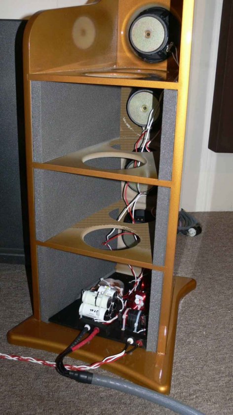

Jay,
Do you have the NoRez installed on these? If so can you put up a picture from the back with NoRez installed.
TIA,
Steve
Guy 13
Re: NX-Otica kits are ready to ship.
« Reply #24 on: 26 Mar 2016, 11:30 am »
Jay, those are really nice looking.
Of course picture(s) of the back would be interesting to see.
Thanks.
Guy 13
By the way, you drive those with what ????

Steve, I've only installed the no-rez in the lower section so far.
My cabinets used early prototype braces so  there were a couple issues that have been fixed for the  production runs (braces now have 2  larger holes, one on each side for wiring).  I only had 1 small hole in the corner to pass the wiring through, it was not adaquate. The spacing of the braces makes it pretty much impossible to drill an additional holes at this point so I had to run  the  woofer and mid woofer leads through the  large brace cutouts. I did  drill a second hole in the top brace so was able to pass the  tweeter and mid  woofer wiring through those .
Once  the  inside wall at the top is  covered in no rez,  the wiring will all but disappear aside  form the leads running across to the terminals.
The included cross over boards fit  perfect between the no rez, they can be  secured with just one or two  screws, the no rez keeps them in place and they are sitting on small  rubber feet.
Guy,  these are being driven  by a Dodd/Richie protype amp, abouit 8  extremely linear wpc  (4 ch) with a Dodd variable gain pre  (both battery)  :thumb:
jay

Edit:  No one caught the major error above huh (it can be seen in the last pic) ?   What a difference now that it's been  corrected !!

« Reply #28 on: 30 Mar 2016, 02:20 am »
I take it you are talking about the two negative wires on the top M165? Phase shift?
Mike
« Reply #29 on: 30 Mar 2016, 03:18 am »
Mike
Nope, those are  right  (one runs to the + on the  next woofer down to connect them in series, I could have used red but then there'd be 2 reds on the  next woofer).
Actually,  I had a buddy help me soder up the double connections (lower NQ and 2 lower woofers) . I had the wiring  just sitting there coming down from the top NQ and up from the c/o, I guess he goofed and  wired the lower NQ   "out of phase".
I knew something was wrong, the right channel semed thin and also seemed to have less output.  After some investigating, I discovered   the error
What a difference  now... and we thought they sounded good   before  LOL !!
jay
Danny Richie
« Reply #30 on: 30 Mar 2016, 03:28 am »
I see that in your picture now.  :nono:
« Reply #31 on: 30 Mar 2016, 03:33 am »
Yup, it is a game changer
In an Arnie voice  " Don't  Do That" !
jay
