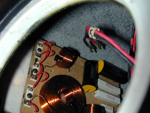

Marble 9.0 crossover - rewiring for Bi-amplification

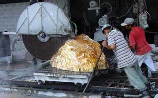

My center channel Rose Marble 9.0 being manufactured (not really mine, but maybe?) Did they really do this?
