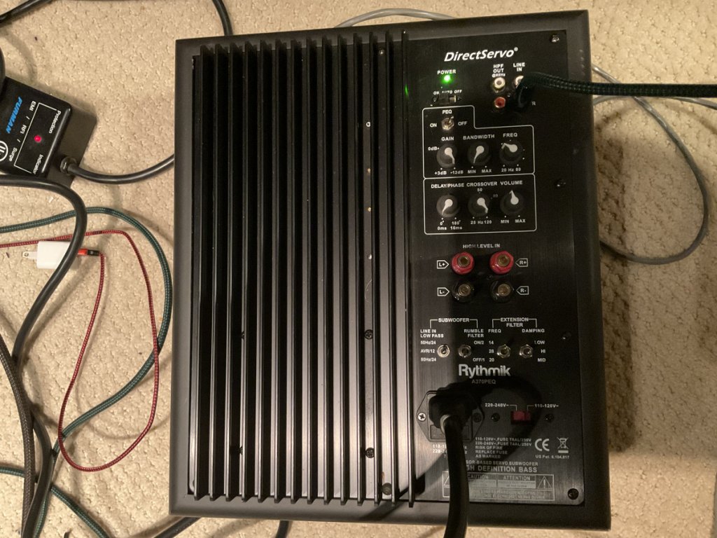

Re: The OFFICIAL Super-7 thread
« Reply #993 on: 3 Sep 2024, 06:40 pm »
It might be helpful to snap a pic of one of the sub amps and post it here so we can see how you got it hooked up and the settings you're using.

« Reply #995 on: 3 Sep 2024, 07:16 pm »
Here you go.
