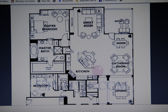

(also part of my acoustical issues - the volume of space I am trying to fill is enormous - not all of it is listening area. Speakers are about 8 feet apart and 10 feet from the primary listening position, but I have a 20' x 30' space behind [with 10' ceilings])
**forgive the image quality - had to improvise**
In the image above, the space I use is described as the "Great Room". You can see that there is a "Media Niche" along the left wall. The original plan was to put all the equipment in that space with speakers to either side. It sounded like cr@p! I got to rotate everything 90 degrees and the speakers and TV are along the wall at the top of the image. The "Great Room" is about 15 1/2 feet across (plus the "Media Niche" - almost 2 feet deep), but the open space behind my chair is very large. Many problems, but ones that I can deal with better, just does mot lend itself to a projector.
  • Posts: 11609

Mmmmmmm.....no can do. The "rear wall" is 35+ feet from the location the screen would likely be, and is the kitchen which is a wall of cupboards - no shelves.
Tough room.  If it were me I'd put the projector on the ceiling, even if i had to pay someone to do it.  Getting rid of the TV would be a bigger upgrade, acoustically, than a new DAC or Power amp or very nice cable would be.  Of course the WAF on that might be very low, although that's something I personally no longer have to worry about (#silverlinigs).

I would want to try putting the speakers on the south end of the great room where the two chairs are.
