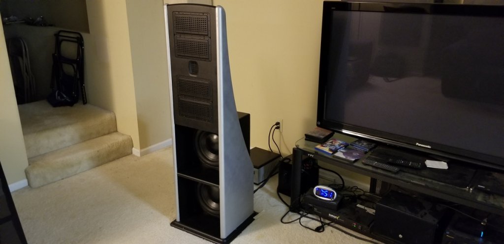

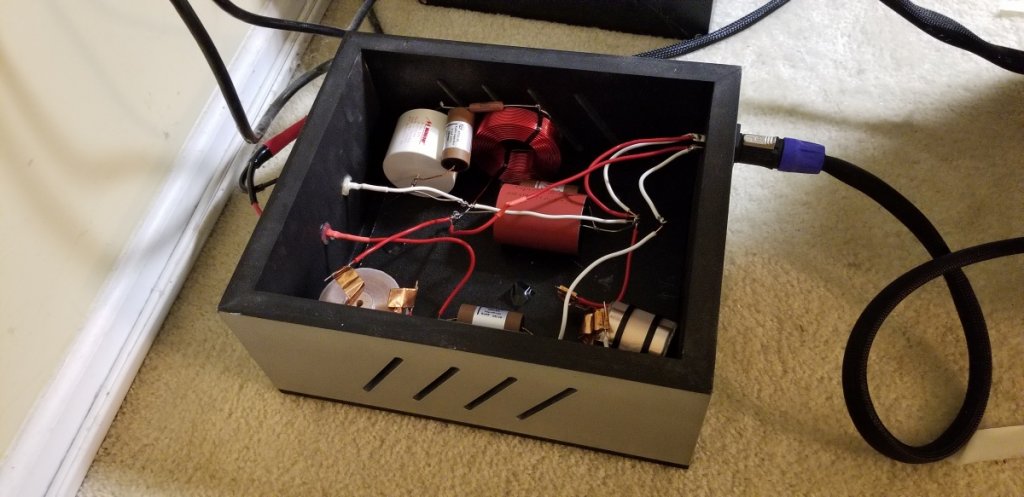

I finally got these wired up.  They are not complete as I still need to finish the grills and install no rez.  For the crossovers I replaced the two smaller inductors with Mundorf foil inductors.  The midrange has a Jantzen Superior-Z bypassed with MiFlex KPCU.  The tweeter has Jantzen Silver-Z again bypassed with MiFlex.
Quick impressions on imaging and soundstage since they are the first things I listen for. More detail and pics to follow later on:
Imaging: I thought the Super 7 would be a step behind the NX-Ottica in this department because of the baffle size but they are not. The Super 7s midrange is extraordinarily clear and I think the clarity allows it to image just as well as the NX-Ottica despite its increased baffle width.
Soundstaging: It was immediately apparent to me that soundstage depth is better with the Super 7s - probably due to the increased midrange clarity. I'm not talking about depth as in how far back it seems the sound is being generated from, but also layering - I'll post more about this as the crossovers settle in and I spend more time with the speakers.  Height and width will require more listening for me too but I didn't notice anything lacking on immediate comparison with the NX-Ottica.  The NX-Otticas have been amazing for me in this regard - soundstage width from side wall to side wall and height not just floor to ceiling but seeming as if it curves above you over head on a few recordings of mine.
This is my fourth open baffle speaker designed by Danny.  I built a pair of V2s with 8 inch servo H-Frames about 6 years ago right when Danny first introduced the smaller 8 inch servos.  They replaced a pair of Volent CL2 Monitors.  I was so impressed by them that I built a pair of Super Vs the next year.  Then I built my NX-Ottica monitors almost 3 years ago.

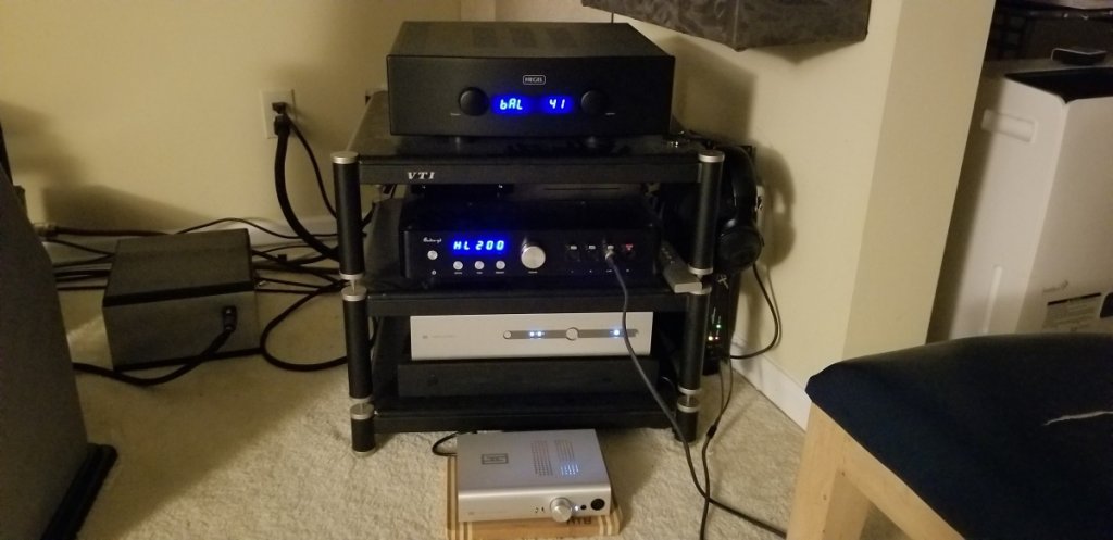

My audio chain:
J-River Media Center -->Digigram VX222e -->Schitt Yggdrasil (2nd Gen) -->Hegel H360
I can't remember the exact diminesions of my room but the setup is along the long wall and my room is heavily treated with bass traps and absorption panels at all first reflection points including the ceiling.

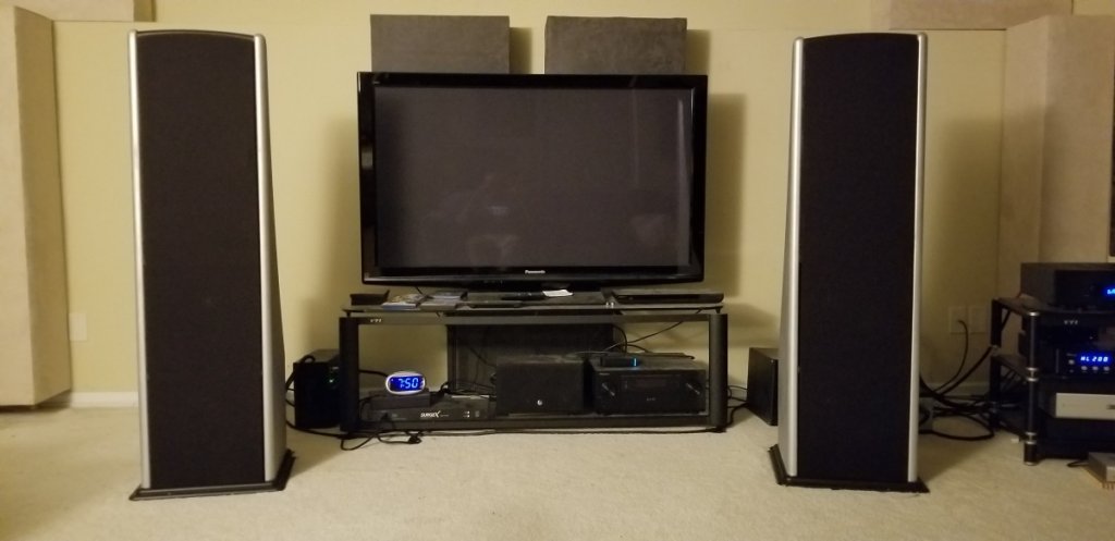

Small update.  These things are amazing.  I think the only thing they don't do better than the NX-Otica monitors is disappear into the room.  If the NX-Otticas get you 100% of the way there, the Super 7s get you about 95%.  The Super 7s soundstage depth more than make up for this.
Any type of woodwind instrument - sax, trumpet, harmonica, bagpipes sound like god's voice on these things.
These are the first speakers I have ever owned that have made my headphones sound like crap in comparison.  Seriously, if I want to listen to headphones I make an effort to not listen to the Super 7s immediately before.
Initially I had issues with drums sounding weak on the Super 7 so its been about a week and a half long process to dial them in.   My subs were tuned to match the NX-Otticas, which are marverlous with drums, so I had my subs crossover a bit lower since I didn't need them to play as high.  The Super 7 subs need to be crossover a little higher I think and its been a little bit of work finding that perfect setting that gives me that drum "pop" without causing other bass issues in my room.
My room has corner bass traps and absorption behind my tv.  The speakers are about 4 feet off the front wall.  My next project will be building some diffusers to put behind the speakers.

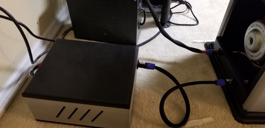

I already had amp boxes so I re-purposed the two in the flat pack to be crossover boxes.
Current System.  Top to bottom. Hegel H360; Audio GD Master 9 (headphone amp); Schiit Yggdrasil; Media PC; Schiit Jotunheim.
Headphones - since I mentioned them sounding like crap: Focal Elex; Sennheiser HD650 (modded); Foster TR-X00
