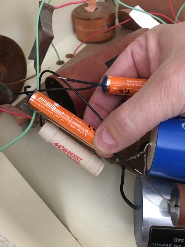

Bringing things back on topic.  In my quest to remove ALL non-copper parts from the signal path and replace them with better quality copper parts, I've gotten one of the last major pieces removed and replaced - the RESISTORS in the crossover.
Buh-bye Mills M-Resist Supreme (a nice resistor, actually) and HELLO Path Audio copper resistor:

OK, so you got to tell us if you're hearing any sonic differences after installing these resistors.

Of course!  Although I have to say I'm still in awe of the improvements I got a few days ago from simply tightening down my midrange panel screws (and tweeter screws).  Thank you to whoever suggested that initially, it made a SUBSTANTIAL improvement in focus, microdynamics and image precision.  I've actually had to re-adjust my subwoofer settings to match up with the new sound I'm getting from the mid panels.
Anyway, give me a couple days to run a signal through the speakers to run in the new resistor and I'll report back.

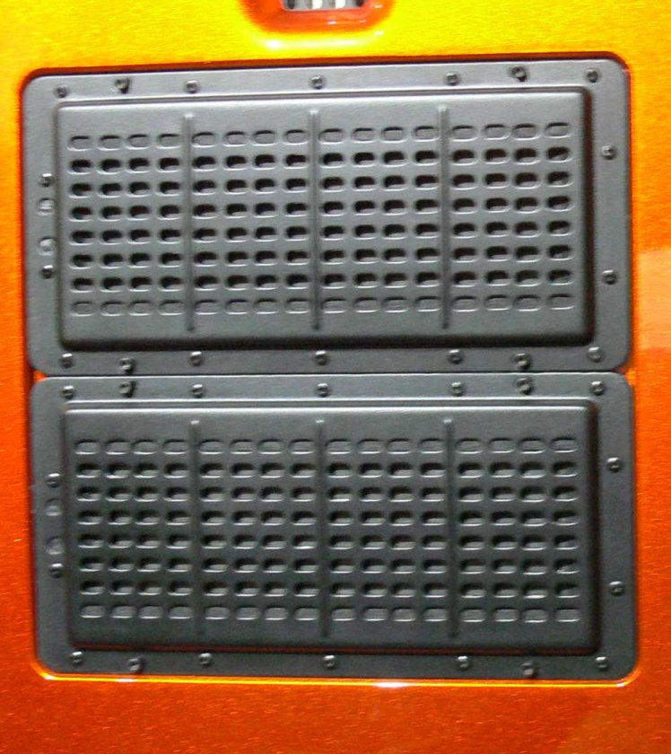

Thanks for posting about the improvement made by tightening the Neo mounting screws. One or two mentioned tightening them but did not state whether it resulted in the same kind of improvement I got. I did not tighten any screw more than maybe 1/8 of a turn. Wondered if anyone else had the same experience.
Since the tightness of the mounting screws makes so much difference and since MDF doesn’t stand up to repetitive loosening and tightening, would installing threaded inserts for mounting the drivers be appropriate?
Mike
I thought of that, but on my pair of Super 7's I feel like there's just not enough room on the mdf to mount an anchor or any kind of insert, really.  The drivers are just too close together and the MDF is too skinny.

  You might look into using super glue added to pre drilled then dried holes.   Works well

Also, the new design is made from Medex which is actually denser than MDF by a substantial margin. Tyson, i'm a big fan of the Path's myself and run them in my big purples, extremely neutral in my opinion, I'm sure you'll like them.

Do we just put superglue over the holes or try to somehow force it down into the holes (which are really small).

I think to consolidate MDF fibers in threaded screw holes in finished speakers it would be best to lay on back and apply with a toothpick,  a small artist's brush or similar. Don't want to fill hole, but sort of line the interior wall. A little goes a long way.
Medex is MDF, albeit a more highly refined variant. I suspect nearly all MDF and HDF is NAUF (no additional urea-formaldehyde) rated now. That ship sailed some years ago in the US.

How about just applying some glue (superglue? Wood Glue? Gorilla Glue?) to the threads of the screw and allowing it to "Drip" down the threads, then screwing it back in?

This would seem to me a workable plan. Wood glue or even Elmer's glue would be my preference, maybe even thin it a bit with water. I'd view this as light duty thread locker, but one really doesn't want to solidly glue screw in place as it would likely bring threads with it should it ever need removal. Then you'd have an even bigger problem.

When I originally tightened down the screws on the S7's after they arrived, I thought about using glue to keep them from loosening again, but that was my concern - if I ever needed to remove/replace a Driver in the future, how much damage would that cause?
Locktite?

Yes, Medix is a   more refined form of  MDF.  It  is slightly  more dense than  "standard"  MDF  and it  is  far more  resistant  to  edge chipping/breakage  etc.  It  machines    cleaner (better finish)  and  is moisture  resistant  which  makes it more  dimensionally  stable.
Once  characteristic  I've   put to the test is  it's ability to hold  a thread ( not pull).   All the  mounting holes for Neo's in  my S7's    have been tapped  and  then  we used M4  machine screws (IIRC  they were M4... I'd have to pull one and  grab the calipers).  No  additional   glue  etc   was used and so far,  no issues.
From  info page:
No added formaldehyde resin system
Especially suitable in interior applications where moisture is a concern, Medex does succeed in the 6 cycle accelerated aging test
Superior physical properties to standard MDF. Truly high performance screwholding and MOR capabilities, among others
Locktite?
You  can get  some  Loctite's that  don't   harden, they  just  go  "gummy"  to prevent the  fastners  from loossening up.
If you  want to use something   tougher,   I'd  tap the holes,  then   run a thin line of  CA  on the   screw  or drip a bit into the  hole...  run the screw in  quickly  and then remove it and  let the    CA  dry  in the  threads.  doing tis will let it soak into the   wood somewhat  and   toughen it up.   You'll need to work  fairly  quickly... keep the screw moving   so  the CA doesn't  harden with the  screw in place.    A nut driver  with  the proper  bit  works well.
