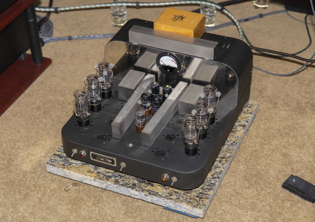

I finally checked mine and found the '10s' screws required about one full turn and the '3's maybe a quarter turn.. I turned each screw NOT tight, fearing I'd strip the 'threads' in the MDF panel.
FWIW, I've decided to keep my 135-Watts-into-4 Atma-Sphere MA-1s and sell the 45-Watts-into-4 M60s*.. The M60s are current versions (3.3s) while the MA-1s are 'only' 3.1s, but I feel the MA-1s are more flexible with that higher power..  And since A-S OTL amps can operate well on fewer output tubes (OTs), in pairs of course, I removed all the Chinese OTs and then (for at least summers in the desert) installed and balanced each amp with only three pairs of Russian Winged-Cs.. Got to use all the stainless-steel damping blocks I've ordered for various amps.   :)
Am still using Tung-Sol oval-plate 'N7s in the V1 pair and BRIMAR CV-1988/6SN7GTY curved-plates in the other three positions.. The amps again sound glorious with the Super-7s.
BTW, the 3.3 versions of the MA-1** with the MOSFET-based Constant-Current Source adds that no-longer-used-as-a-CCS tube V3 to the pairs of V1s to make three 'N7s in parallel for the first Voltage-gain stage.
* As much as I LOVE the Super-7s, I still fantazize about having a pair of Revel Ultima2 Salon2s.. That fantasy was renewed by my reading Larry Greenhill's rereview of them in the current issue of 'Stereophile'.. Oh well...I suppose if my pairs of Quad 2905s, Atma-Sphere M60s, and Vienna Acoustics Mahlers, and a Butler TDB 5150 poweramp and BPT balanced-power p-con were SOLD, I could afford them.   :)   :(   :|   :(   :)
** and any other A-S OTL amps with five frontend tubes, I suppose, but I'm not familiar with the MA-2 and -3.

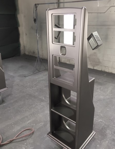

I just had mine painted. Not sure when I will get to assembling them.
  • Posts: 11651
Re: The OFFICIAL Super-7 thread
« Reply #638 on: 20 Jun 2019, 03:18 pm »
Beautiful!  Trust me, assembly is a snap.  Just make sure to install your woofers before you put on the NoRez.  And you might want to drill some holes in the top platform to route your hookup wire through, from the bottom of the speaker up to the top platform.  Use short screws for the midpanels, if they are too long they can punch through the back of the baffle which you don't want.
Other than that, they just sort of snap together, super easy.
