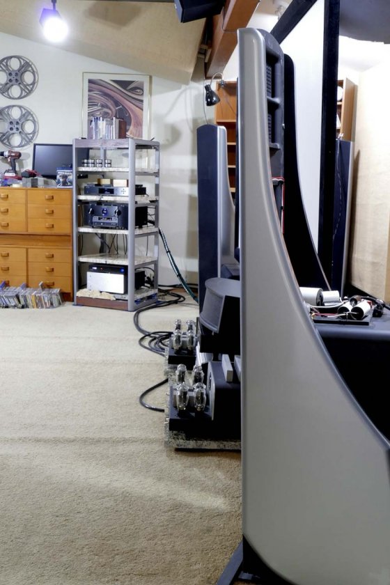

The '7s have always had a tad more treble energy than I and my tonally-way-off ears liked, especially when the tweeters are pointed at my face.. When I had sited them recently, I had adjusted the rake to about 2-1/2 degrees (top closer to my face).. Last nite I decreased that to about 1-1/2 degrees* and the treble decreased a bit, to the about-just-right amount.. More tweaking will be needed, as the air-conditioning tech moved my couch and I think it ended up about an inch not centered.  The speakers' distances are measured to be within about an eighth-inch from my nose, but sitting in the sweetspot, I feel a little uncentered in the room.. We'll see where the furnidents are.   :?
In this pic the speakers' 1-1/2-degree rake is barely visible.
(Still waiting for those new powercords.)
* Measured, but it's still an approximation.
BTW, I use a Bosch DLR130 laser-based Distance Measurer for these measurements.. Its claimed accuracy is, IIRC, to 1/16", and my shaky measurements, when repeated, are within about an eigth-inch. (I measure with the base of the unit against my chin.). Even its successor, the DLR130K, is discontinued, but one can get them on eBay, which I did for my 2nd and 3rd.

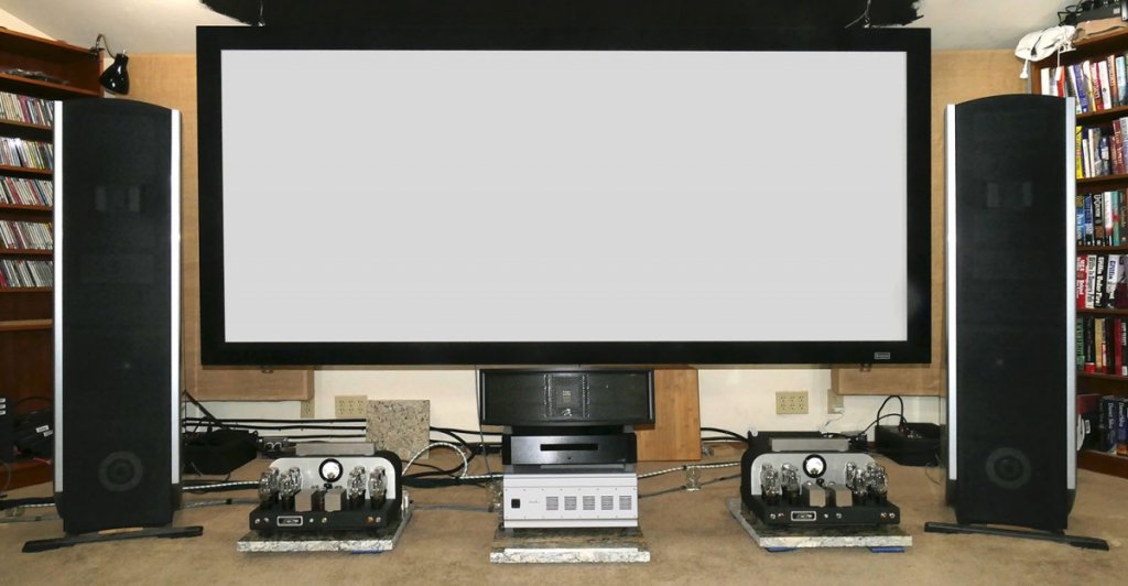

Got the new powercord installed and the room mostly picked up.. Looks not half bad, huh!?!?
Powercords, 18 and 22 feet long, are a new cable custom designed by Jeff Glowacki of Sonic Craft.. It's composed of six 11g. conductors and can be wired as 8g. times 3 (mine) or c. 6g. times 2, that is, without an earth conductor*..  It's not shielded.. Each conductor is assembled with 6-9s-pure OFHC copper in several different strand sizes, litz insulated; then the bundle is insulated with generic 'teflon'.. It's all wrapped in an attractive black braided cover.. I sent them two pairs of AQ NRG 1000 ends to use; they're made with red copper and are heavily plated with silver.
https://www.audioquest.com/ac-power/ac-power-plugs/nrg-1000-wall-plug
* That's not nearly as weird as it may seem; some of our equipment has only TWO pins in its IEC power inlet.
 :thumb: :thumb:
Bet is sounds  great

Jeff,
Look a lot neater/cleaner.  Very nice!  BTW, your toe in matches mine exactly.  When the 7s are dialed in, I've never heard another speaker as capable of transporting you to a venue/space as them.  Spooky realism.  Have you done any upgrades to the crossover components on yours?

Jeff, Look a lot neater/cleaner.  Very nice!  BTW, your toe in matches mine exactly.  When the 7s are dialed in, I've never heard another speaker as capable of transporting you to a venue/space as them.  Spooky realism.
TYVM.
Yes; details are in prior posts, but it's a LONG thread, huh!?!?!?
Tweeter: 10uf series cap is 9.9uF of Sonic Craft's Platinum (Teflon-alloy-film/tin-foil) caps.. The shunt 0.39mH inductor is original.
MR: series inductor is a 1.0mH Bridgeport copper-foil.. Shunt 15uF cap is a 13uF SoniCap Gen1 (metallized-'propylene) plus 2 1uF Platinums.
Tuning network: resistor is a 12W. noninductive Mills MRA-12.. 54- (or 56)uF cap is now 54uF of SoniCap Gen1s plus a 0.33uF Platinum.. Inductor is original.
Wiring is original.  I'm likely to replace the MR wiring with 18g. Mundorf Silver/Gold-in-Teflon and the tweeter wiring with 23g. Neotec UP-OCC silver-in-Teflon.
I have four thick, heavy granite tiles to (hot?)glue the components to.
They'll be isolated from the bassbox with Herbies large BabyBooties.
The hardwired speakercable is AQ's GO-4, a 15g., all-best-copper cable with DBS.
I think the crossover rebuild/speaker-rewire will be a summer project; I need to spend more time this spring SELLING things.   :?
Quad '2905s, anyone?  Butler TDB-5150 5-channel, hybrid powamps, anyone?...etc....  :roll:
