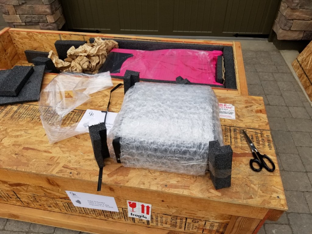

I have finally joined the Owners club! Super excited! Bought the pair Danny has been talking about in this thread. They arrived on Monday and I was in a hurry to try to get them up & running.
First of all, they were packed extremely well and showed up in perfect condition. Managed to get the tops off and some of the extra goodies out of the boxes, then move them inside by myself.
At that point, I decided I needed to wait for another pair of hands to help get them out of their crates, so I had to wait.....grrrrrrr.
It was worth the wait....
(Ignore all the extra wires - still experimenting )

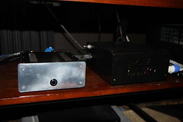

Danny also sent along the custom Folsom Chip Amp for me to try out.
It took a bit to get everything up and running, mostly due to operator error.

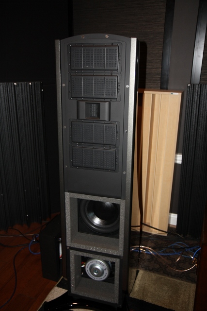

Tyson, I have read your praise of the Spatial X2s which I own.  Wonder how you would compare them to the Super-7s.  I think the AMT wide range driver is really good in the X2s, and after making some position changes I'm getting better bass, and overall they sound amazing to me.  Best sound I've had so far.  But still think bass impact could be better.  Have been thinking of getting some flat packs and associated parts for a couple of GR dual OB subs.  But maybe the Super-7 instead?
Jeff
  • Posts: 11630
Re: The OFFICIAL Super-7 thread
« Reply #491 on: 18 Aug 2018, 03:06 am »
Jeff
IMO the AMT is the best tweeter in the world (or that I've ever heard), and the waveguided OB Neo3 in the Super 7 is the 2nd best tweeter in the world :P  On the other hand, I think the Neo 10 might just be the best midrange driver in the world.  However the X2 mid driver is no slouch!!  And Clayton did an amazing job integrating them.  Bass, well no question the Super 7 bass is just in a higher class.
Put another way, everything that the AMT driver covers is better than the Super 7.  Everything that the AMT does not cover, the Super 7 is better.  IMO and IME and all that.....
Does that help?
