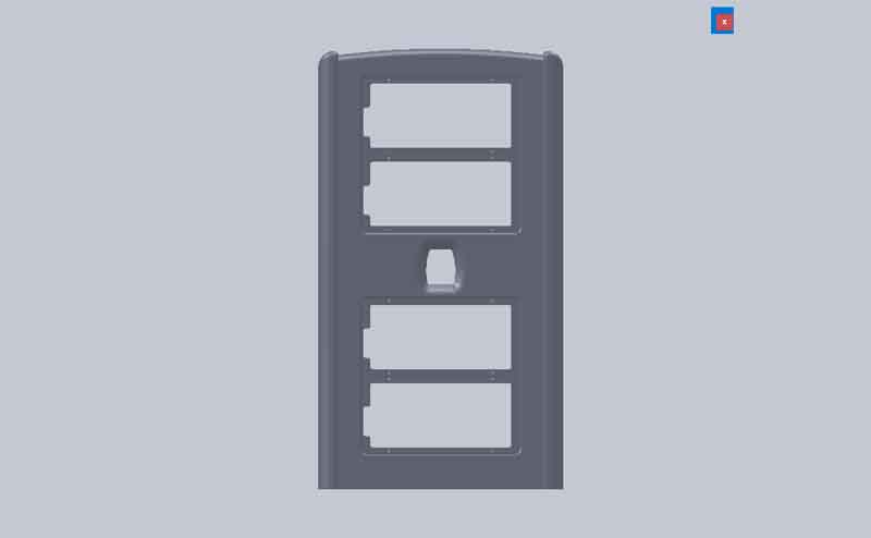

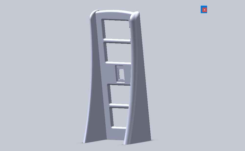

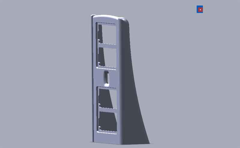

A few  pics  of the  anticipated results with  side panels.  Panels are  modeled after the original S7
s at the same   position....
« Last Edit: 28 Jul 2018, 02:37 pm by Captainhemo »

I have been working with new Super-7 baffles for the last few days and I finally have a version that produces a nice response and can be CNC milled from a single baffle with no protruding wave guide for the tweeter. So it will be a lot easier to make and will look cleaner.
I think this is going to work fellows. I can at some point release this design as a kit if the CNC flat packs from Jay are used.
Next Jay will have to replicate what I have here and I'll have to measure and test the baffle to confirm everything.
Without asking you to lay all your cards on the table for no reason other than to satisfy my curiosity, any hints as to what it took to solve the tweeter baffle problem without the protruding wave guide?  Unless I'm looking at the latest renders and missing something, it looks like the tweeter waveguide is asymmetrical?

So roughly 27-1/2" x 13" . I take it 27-1/2" is the height. What's the height at the center of the tweeter?
Mike
Wouldn't it be ~27.5" / 2?  Looks like its right in the center, vertically and horizontally.
-Jim
Looks offset toward the top by an inch or so (at least to these eyes).
The wave guide  has been a continuous evolution, the  hardest partis tht it  is a bit different for each design depending on  baffle  dimensions.
When  we did the  single Neo 3 single  Neo 10  in waveguides, the results were exellent,with both drivers  mounted on the rear and each in their own  waveguide.  Unfortunately, as  Danny  posted earlier in this thread, when   we did the same with   the drivers of the S7, it had  some very  negative effects on the Neo3.
Now we've got the  Neo10's on the front sunk to a depth that works  with the  Neo3   in the  waveguide.  We've been able to  keep the  wave guide shallow enough  to allow for a  deep  tweeter mount on the rear but  still  deep enough to allow for a   low  cross over point .
Mike
Mike,
 14.2 " to  tweeter  center
jay
