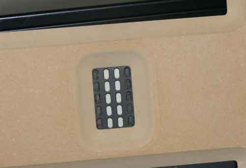

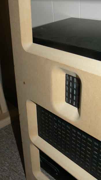

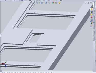

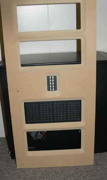

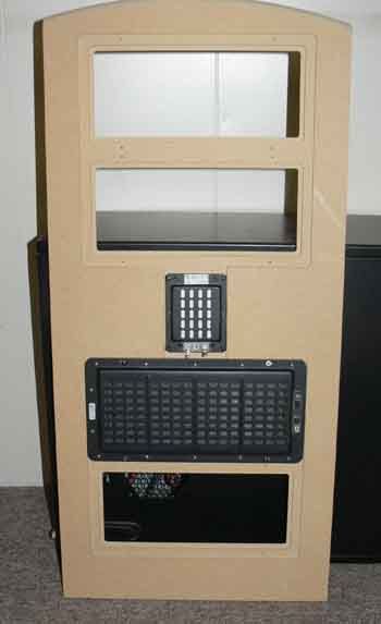

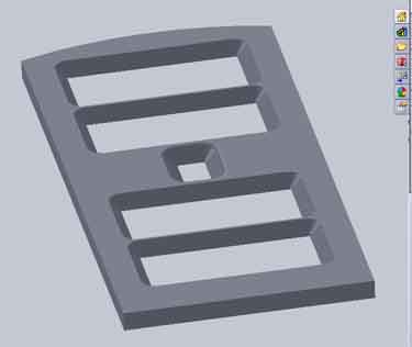

Reworked the   Neo3 waveguide a bit with these and put all the Neo 10's in waveguides as well.  Should  hopefully smoothen out he  Neo3 even more  and  extend the  low end of the Neo10's  by a bit
All drivers are flush mounted in recess's on rear  side of baffle, inner driver  pockets are cut so  drivers  sit up tight to the rear face of the  waveguides.   Driver  mounting screw holes are all pre-drilled for easy assembly.
A couple of the  drawing/rendering as well
the drawings look a bit skewed, it's  just the perspective

Thanks Ed.  There is a basic   shape idea for the wings already and I actually added .5" to each side of the  baffles so they can fit into dado's in the wings.  The inner  dimension between the wings will be  13", same as the inner dimension of the  subs.
I've actually been   working on a way  to have these   bolt onto  the  upper module of  our modular sub towers instead of the  normal top panel.   the  top section wigns would also be  1.25"  Medex to match the   subs    the baffle would be inset into the  wide wings the  same as the top/bottom module  panels so a grill  could be  straight up from  sub  bottom to    top of top section.
IIRC,  the baffle is  just under  29",  I'll open the   file up this eve  to be sure  (watching  the  games right now)
jay
Edit:  yes Ed, they are  713 mm   ( just  over  28 " ) right now.  there  may need to be an adjustment   still depending on how we implemnet the wings.
