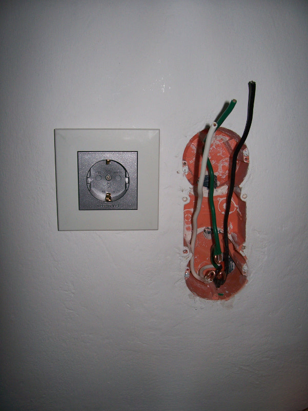

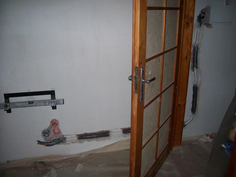

I startet with optimizing the electric supply line,  that is cricial as all our signals are electricity of course
i made two seperate lines, one with two plugs and one with only one plug, this way i can experiment with differen setups when i connect the devices.
Also worth the work imo, bending the cables instead of cutting them when connecting the "double" wallplug.

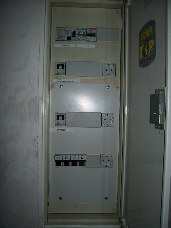

The restruktured fusebox
The lower half is new as it was unused before and so i can have an extra row for each phase now.
I added plugs to the phase one and two to experiment with noise killer devices.
The plug on phase three is not connected but you can see the so called audiophile melting fuses which are used instead of the normal automatons.

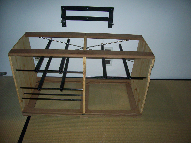

And my selfmade Rack offcourse
I used carbon tubes for modelairplanes for the wallmounts.
The rack is decoubled from the floor with rubber elements.

Wow, that is just beautiful.
And yes, it is always a good idea to make cut outs in panels to avoid resonance and reduce the area which picks up energie from soundwaves from the air.
To suppress resonance I stuffed foam from packages into the carbon tubes and used different thicknes of the panels to avoid having multiple panels with the same resonance.

Thanks phoner.  I have to confess to being a skilled Carpenter so not such a difficult task for me.
Your rack is an interesting design. It would be great to compare how our racks sound wouldn't it? Alas geography negates the opportunity. Keep us posted.

Make sure to read your Home Owner's/Renter's insurance policy.  Some have exclusions for electrical work done by non-licensed electricians.  Not sure where the line on that gets drawn, but just a heads up.
phoner
  • Posts: 32
Re: DIY not buy
« Reply #7 on: 18 Feb 2016, 11:48 am »
youre absolutely right, in my case the fusebox had to be done by an electrician.
i wouldnt have done it myself anyway because i have to much respect from electricity, i would not touch it even if it is not so complicated to wire some fuses .

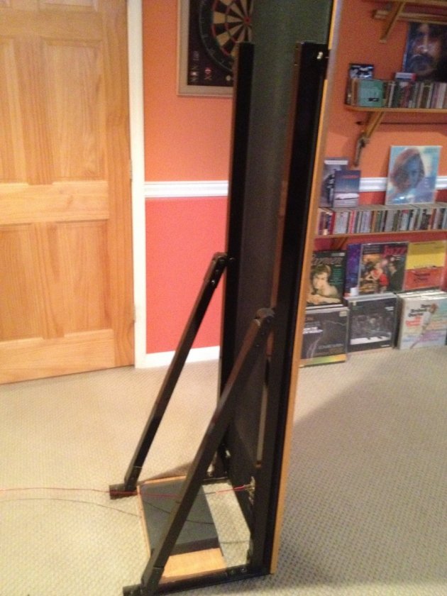

Made these frames for my 2.7's. Used 2" square, aluminum tubing, sand filled and finished with an automotive grade paint and clear coat.

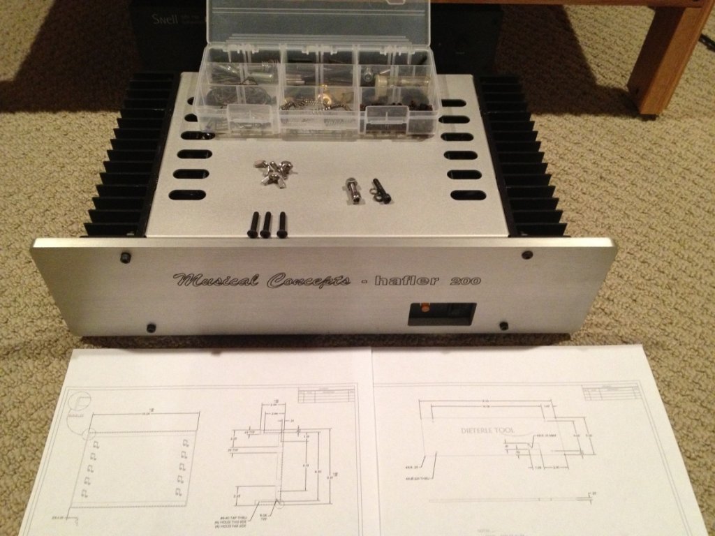

Designed and procured a vendor to manufacture this face plate and cover for my Hafler 200.

I like your speaker frame, however,
would it be too much to ask for more picture to see more of your work.
I like your idea for the Hafler amplifier's front plate.

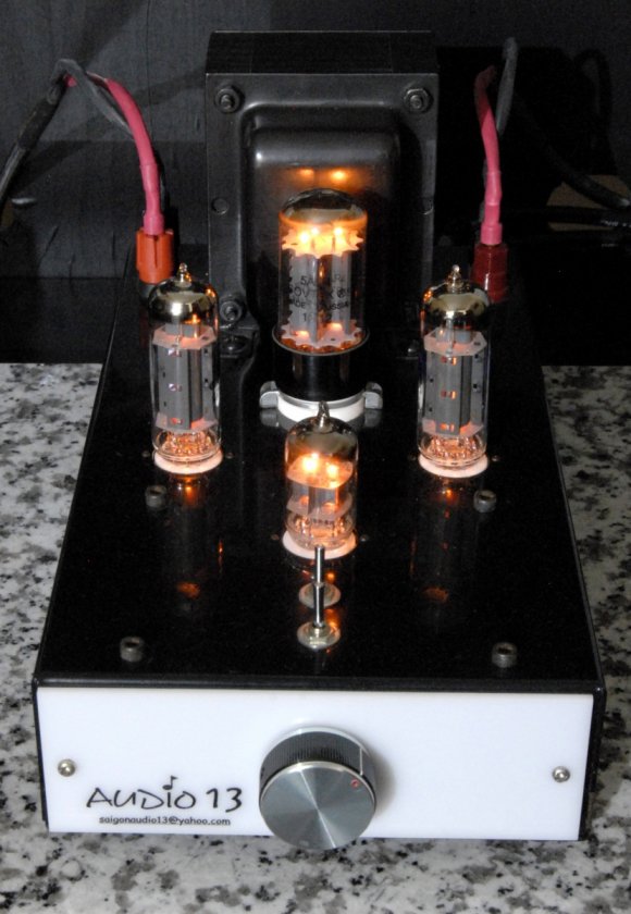

I did the same thing ofr my Decware SE84C+ but on a much smaller scale.
I like to modify the look of some things I have...

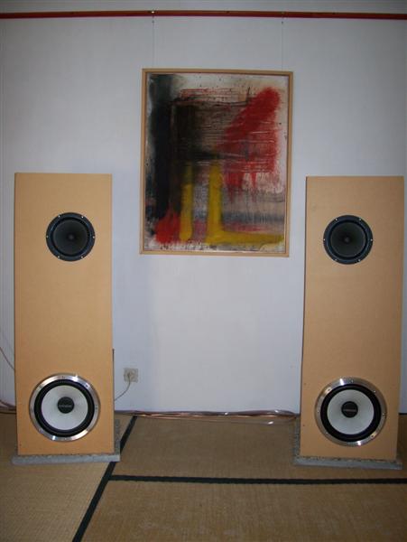

great stuff
i like the magnepans, my first true hifi speaker, bought them secondhand and loved it...
inspired me to build an open baffle
in the end i used a closed box design for the subs in combinadion with the broadband speakers
i still use the bassspeakers for bassreflex woofers, very strong and deep ;)

I like the face plate Guy, very clean look. Is it UHMW or delrin?
These are from my gallery. Probably the best pics I have of the finished frames.

I like the open baffles phoner. I bet they provide the dynamic slam missing from the planars?
How about the painting, is that DIY too?  :D
