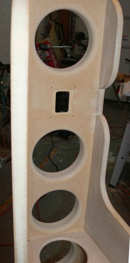

Excited by the development of your new planar tweeter.  Does the new waveguide mean that it will be possible to just fit the tweeter + waveguide to a flat baffle instead of having to carve out the waveguide from  a 1.5" baffle ?
Naw man, I've going to make it real easy. All you have to do is cut a round through hole with a recess just like mounting any other tweeter.

Will it work with the LGK drivers for the Wedgie? It seems like it would be too wide and possibly too deep compared to the LGK drivers. This would then require a wider baffle for the Wedgies. How would that effect imaging?
A rectangular opening is not all that difficult to cut with a router. You would outline the opening with scrap MDF then use a pattern bit to make the cut. The corners would be rounded rather than square but could be squared off with a chisel if necessary. With this method you would cut the through hole first then the recess.
A little more work than just using a circle jig but not much.
Mike
The new wave guide will be too big and to deep for the Wedgie's but the new drivers will allow me to continue to offer that kit. The small wave guide needed will have to be milled into the baffles again though.

I just figured Danny wold  make a 1.5"  waveguide for the  deeper, more rear ward set  boice coils and a samller  .75"   option for  the LGK drivers.
Maybe I'm missing the  way this  wave guide will  work, I  figured it would  be a faceplate on the front   with a  wave guide  and a tweeter mounting flange at the rear just like I  did the  backside of the  NX-Ottica/ NX-Treme baffles. If that's case, why not just make a shallower option as well , basically different faceplate/waveguide options with the same flange on  the rear.

Probably one issue would be the overall width. If the faceplate is to be round so the opening is easy to cut with a circle jig than the diameter would be based on the length of the waveguide plus room for a mounting flange. Looking at my Wedgies, that would end up with the tweeter opening 5/8"-1" wider than the LKG driver openings.
That would probably mean making the baffle wider for the tweeter to fit. Don't know what that would do to the performance. With a rectangular faceplate the baffle width could be kept the same. You couldn't cut the opening with a circle jig but, like I mentioned, you could easily cut it with a pattern bit.
Another issue could be the amount of time, effort and money that would need to go into developing a second waveguide vs the expected number to be sold. The 1-1/2" waveguide will probably work with any design (OB or box) that uses the M165 woofer family and possibly the M130 also while a 3/4" waveguide would probably be limited to designs using the LGK drivers.

I just figured Danny wold  make a 1.5"  waveguide for the  deeper, more rear ward set  boice coils and a samller  .75"   option for  the LGK drivers. Maybe I'm missing the  way this  wave guide will  work, I  figured it would  be a faceplate on the front   with a  wave guide  and a tweeter mounting flange at the rear just like I  did the  backside of the  NX-Ottica/ NX-Treme baffles. If that's case, why not just make a shallower option as well , basically different faceplate/waveguide options with the same flange on  the rear.
It will cost thousands of dollars in tooling and molds to make these things. So for now only one larger size will be made.
For the Wedgies the smaller wave guide can be milled into the baffles just as before.
