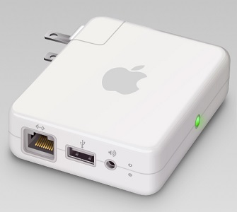

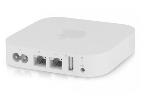

Several on Craigslist for what seems reasonable $$. What model should I be looking for? How do I identify?
1st choice:  3rd Generation A1392 (Latest model)
                   similar form factor to Apple TV with detachable power cord
2nd choice:  2nd Generation A1264 Wireless N (Older model)
                     integral right angle power plug
Avoid:       1st Generation A1084 Wireless G (First model)
                  integral right angle power plug (looks exactly like 2nd Generation A1264)
Steve
