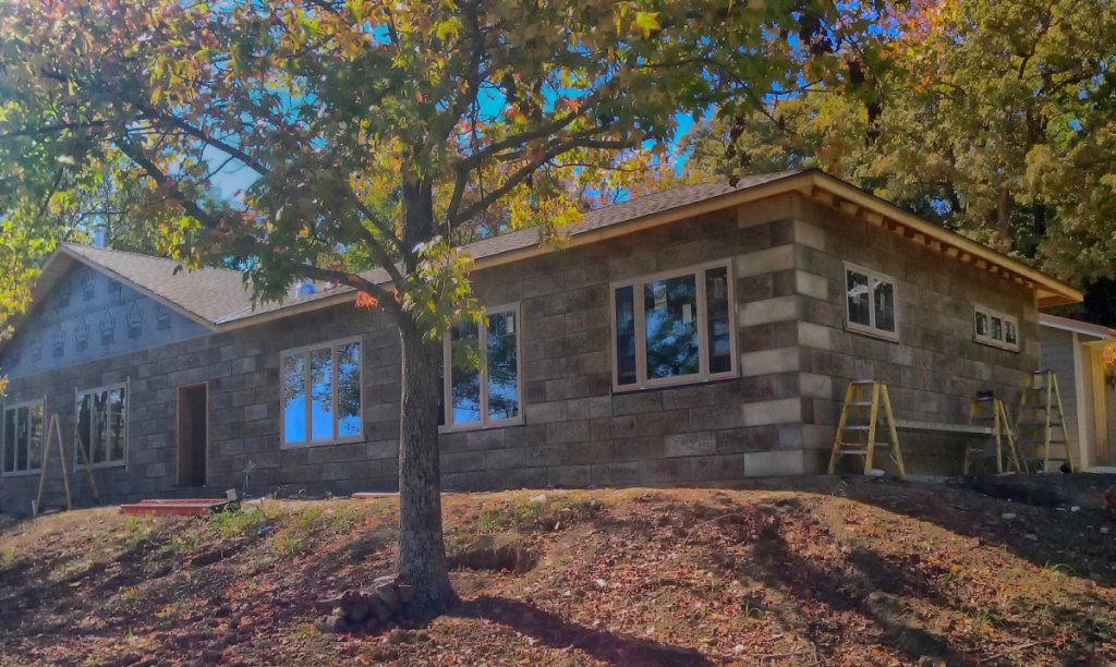

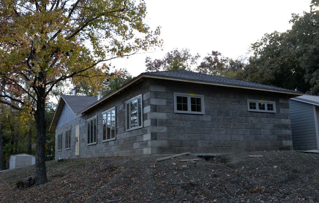

Couple of construction shots from early 2015 showing 16" exterior walls (8' concrete /8" foam)and close cell insulation.
HIS and HER kitchens. We both love to cook!
Tortuga / Channel Islands and LS-6 room
Due to 16" sills all trim had to be hand ripped and routed. Native stone from property used  as well.
New concrete walkway I poured this week covered with 30" of straw due to cold weather.  I finished this pour at midnight Saturday morning.
