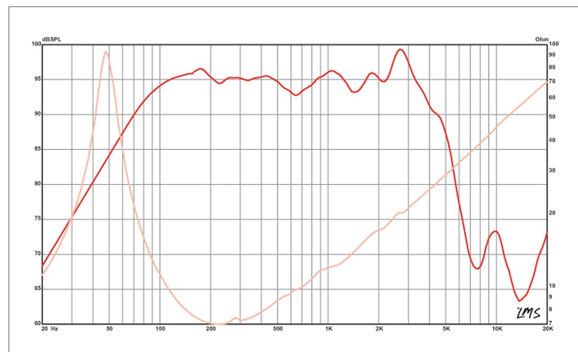

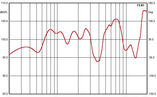

Yup, I get it...  Here is my project, do as you will with it.. My 12 year old likes them... Here are the woofer comparisons... Zu to Stock 10 inch
Stock Em Driver no change
Zu driver with modifications - document in two different periodicals.. Same graph

I have worked with the Alpha 8 woofer too. Here is something I tested them with.
And that woofer does sound pretty good. But it has a lot of break up and can't really be used very high. I had to use an elliptical filter to control the break up and had to do the same for the tweeter to allow it to play down low enough to reach it without destroying the tweeter. For this one I used our GR-T6 high sensitivity tweeter.
It is really hard to get a tweeter to play low enough to reach the Alpha 8. If you let it play up any higher though the break up is pretty bad.
I also tried it with the Neo 3 pdr as it is capable of playing down low enough to reach it. Not much else will though. Here is is with the Neo 3 pdr.
This last one was NOT a 1 watt/1 meter measurement. The actual sensitivity was about 91db.

You will also never get 96db worth of sensitivity out on a design using a single Eminence Alpha 8 woofer as the baffle step loss will drop it down into the 91db range. 91.5db is about it. And rating it above the step loss is deceptive.
