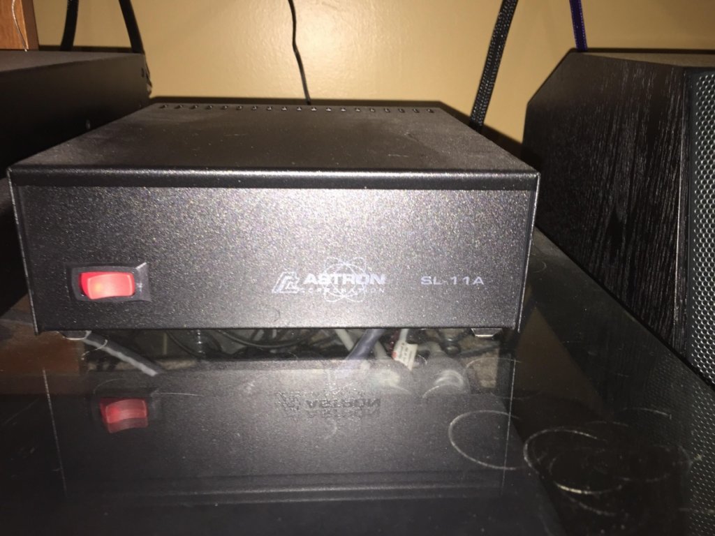

1 - Where to I buy a USB A to Mini B cable? I would like to try the anti-mode as DAC / Preamp, so that I can also test its crossover capabilities on the speakers AND subs.
2 - Can you recommend a 12 volt linear power supply? I love LPS-1 from Uptone (I have three of them in my systems), but they don't do 12 volts.
Thanks!
https://www.dxengineering.com/parts/asr-sl-11a-xtr

And here is a pic of the power supply I am using FWIW...
