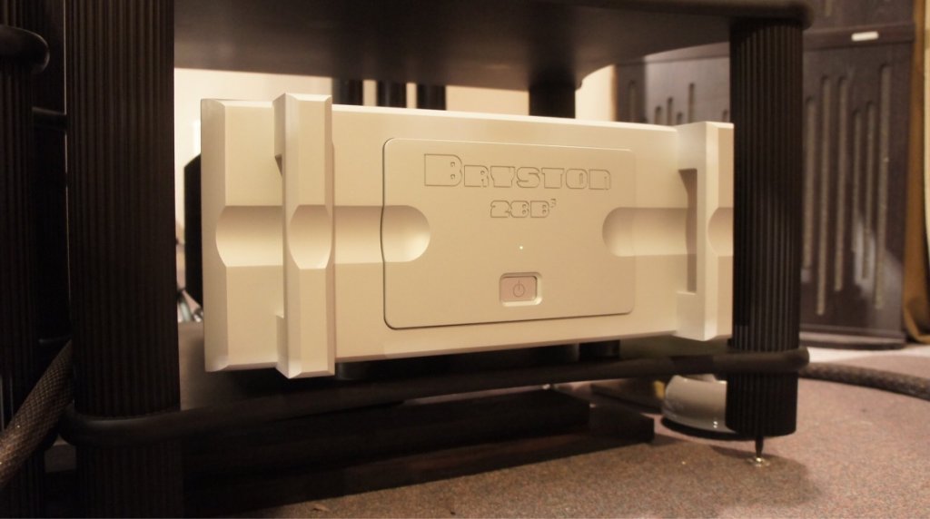

SUBJECT: 28B Mono Cubed – Customer Feedback
May, 2017
Hi Folks,
Got my Bryston 28B Cubed Mono Amps today.
I have owned several SS amps and heard thousands and I always found something was missing regardless of price. If you are tube fan boy you will know exactly what I mean  please don't get me wrong my tube amps won't go anywhere. I love both of them for different reasons.
Luckily I have one super dealer and he was kind enough for me to do a home demo of 4B3 Cubed amp and I had a zero hope until I plugged it  in .. ( comparing $5,600 amp vs my $23 k amp I know I know the price is not everything but usually what you pay is what you get )
I played few albums that I familiar with over the years and I was shaking my head and saying " What the heck ! This can't be right. It's a SS amp ! how come sounds so beautiful so neutral and not missing anything? "
It just blew me away with its performance with super tight bass ( my 15" driver finally found nice partner who can control her completely) and dead quiet. Also the vocal was very close to tube and wondering what 28B3 can do and I was done. I had to get them.
So far I played last 10 hours and just couldn't be happier. I had a very high end amp ($60k amp ) and I'm much more satisfied with Bryston 28B3.
It's also big step up from 4B3. Much more defined details and vocal has more weigh in to it (well I will review them more when break in is done ) thanks to James for making this wonderful amp that can compete with double or triple priced amps out there. It's a keeper
Way to go Bryston. I'm a very happy camper.
Paul

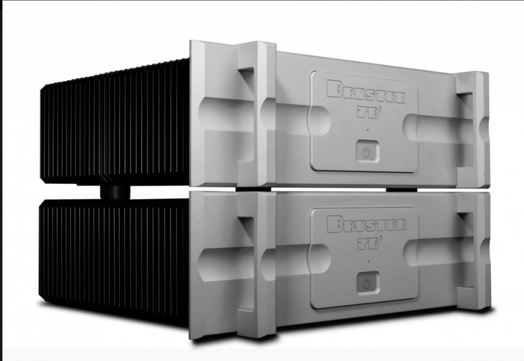

Hi Folks,
We have a review coming on the new 7B Cubed Amplifiers and they asked us a number of detailed questions which I thought might be helpful.
SUBJECT: Bryston 7B Q & A
June 2017
Technical Questions: Bryston 7B³
1.Bryston was founded in 1976 in Peterborough, right? Who was the founder? What was the first product – do you have a picture for me?
2.What are mainly the technical improvements to the predecessor?
3.Regarding the low distortion input buffer - what is so new/special?
4.What are the improvements concerning the output stage?
5.The bandwidth up to 100 kHz is larger than the bandwidth of the predecessor but compared to other amps in the same class it isn’t very high. What is the reason for the moderate bandwidth Bryston prefers obviously?
6.The 7B³ has the lowest damping factor/highest output impedance among the Bryston power amps. What is the reason for this? And do you think the sound of the 7B³ is as the result of this a little bit “special” compared to the other amps?
7.Do you have further information of the sense and the function of the Master Circuit Breaker? It seems like a unorthodox solution ...
8.How much is the VA of the toroidal transformer and the capacity of the filter capacitors?
9.What does “Energy storage power transformers“ mean?
10.How many output transistors work per channel and which type?
11.The circuit of the 7B³ is designed fully symmetrical?
ANSWERS:
Thanks for your inquiry. I shall answer your questions in order below:
1. Bryston was founded in 1962 in Toronto, by 3 people named Tony Bauer, Stan Rybb, and John Stoneborough.  John Russell, ex-NASA engineer and the father of Brian Russell and Chris Russell, bought the company in 1968. Among Bryston's first products was an electronic blood-testing unit called the 'Aggregometer'. Bryston made its first audio amplifiers in 1973.
2. The technical differences between the 7B Squared and the 7B³ lie in the input buffer. It is a new, patented design by Dr. Alexandru Salomie, who worked with Bryston for several years. The input buffer has very low THD and noise, and it also is extremely good at rejecting power-supply artifacts, noise and RF on the input cables. The result seems to be better imaging, depth and silent background on the musical presentation.
3. The input buffer's patent refers to new compensation methods to stabilize the high-gain, extremely linear amplification circuit, as well as a novel input filtering system to reject common-mode noise and RF before they get into the amplification circuitry.
4. The output stages of the Cubed Series amps are not changed from the Squared Series. We are happy with how they perform.
5. No musical instrument produces tones or harmonics substantially above 20KHz. Thus, Bryston feels that allowing an audio product to produce full power to RF frequencies does not improve the musical presentation and can only potentially lead to 'trouble' in the reproduction. That is why we use an effective RF filter at the input.
6. The damping factor of the 7B³ is very similar to the 4B³ even though the 7B³ is a balanced output amplifier and the 4B³ is a single-ended output amplifier. This is because the output inductors on the 7B³ are a lower value. In fact, the effective damping factor on the 7B³ is normally higher than single-ended amplifiers because it can be placed very close to each speaker, with very short speaker cables.
7. The Master Circuit Breaker on Bryston amplifiers takes the place of a power fuse. It means the user does not have to find and purchase a replacement fuse if it fails, and it cannot be defeated or replaced with a potentially unsafe value.
8. The toridal transformer in each 7B³ is conservatively rated at 850W continuous, but has enormous excess capacity.
9. An energy storage transformer has a heavier-than-normal core to deliver a large internal magnetic field. This allows the transformer to deliver very high spikes of current from its energy storage when recharging the filter capacitors, instead of drawing directly from the wall through the power cord. That means much less Voltage 'sag' when delivering high power on crescendos, and maintains a much more stable sonic 'image'.
10. The 16 output transistors in each 7B³ are Bipolar types and use both NPN and PNP polarities on each half of the waveform for maximum linearity. Each transistor is rated at 230W and 16 Amps of current for a huge reserve of power handling capacity.
11. Yes, the 7B³ is completely symmetrical from input to output.
James

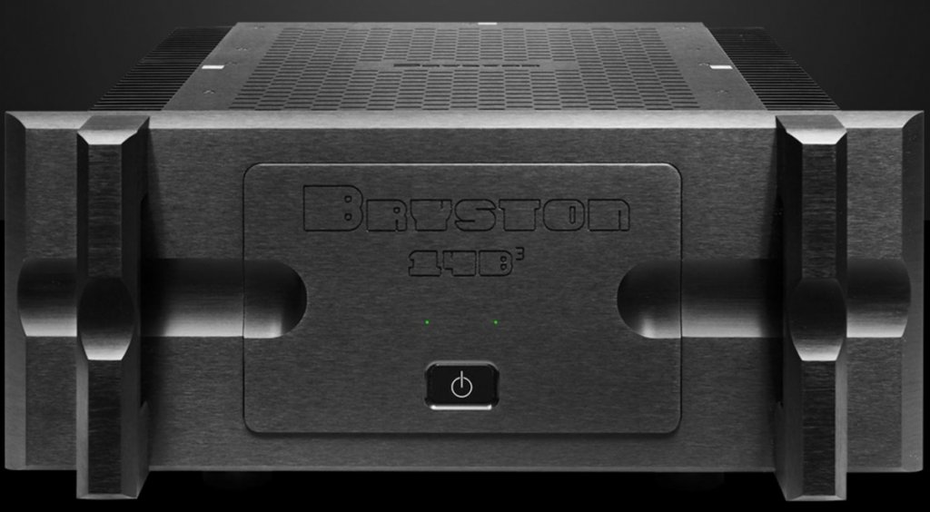

SUBJECT:  Bryston 14B Cubed Amplifier Review
July 2017
The Verdict:
"I did not believe that the older Bryston 14B SST2 amplifier could be improved upon!
A bastion of neutrality, gobs of power and bipolar output, bass quickness that squeezed out the last ounce of low extension.
However, the new 14B has got that power slam and more, plus relays a sense of detail refinement in smoothness, imaging and upper-end "air" over the old one. Dare I say, it is even better than the old amp with hi-res music, such as DSD 5.6, and 24/352 PCM. And I thought the old 14B was already a good hi-res capable, high power amp.
The new Bryston 14B3 Cube is certainly an Everything Audio Network Stellar Sound Award winner and a candidate for amp of the year."
John Gatski
Everything Audio
