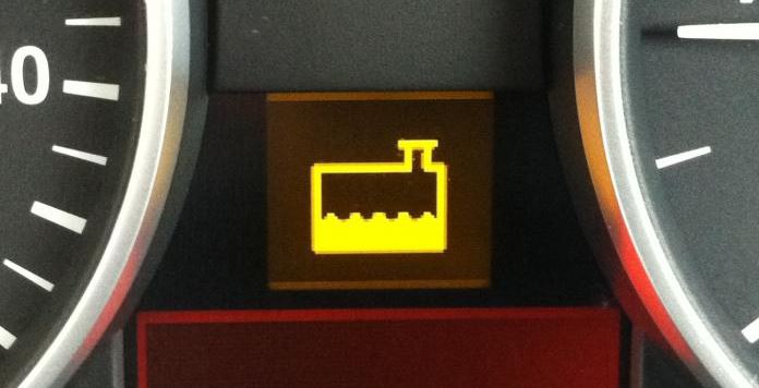

  Big yellow symbol showing up , looks like a half full reservoir . I looked in manual can't find that symbol.

If it's this dash indicator light, that would be the radiator coolant level.

Thanks Gentleman !! I will check the oil level , and I think that is the indicator coming up so I will check the radiator coolant as well .

The symbol in your Check Control Message is "coolant level too low." If it went away when you topped up the coolant then it may not be related to the rough running. I have to top the coolant fairly often compared to my other cars.

Thanks very much guys. The light was for the radiator fluid which I added.
