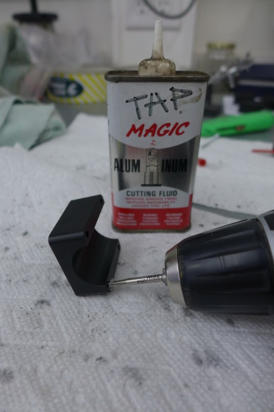

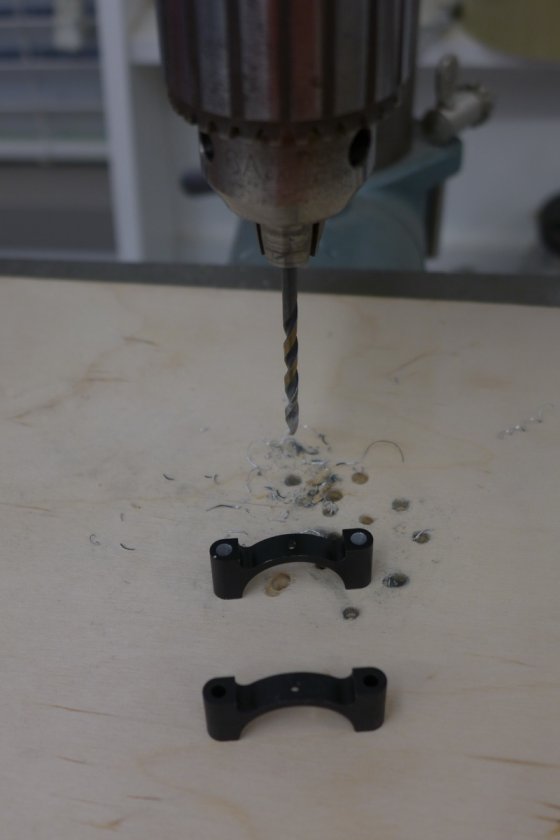

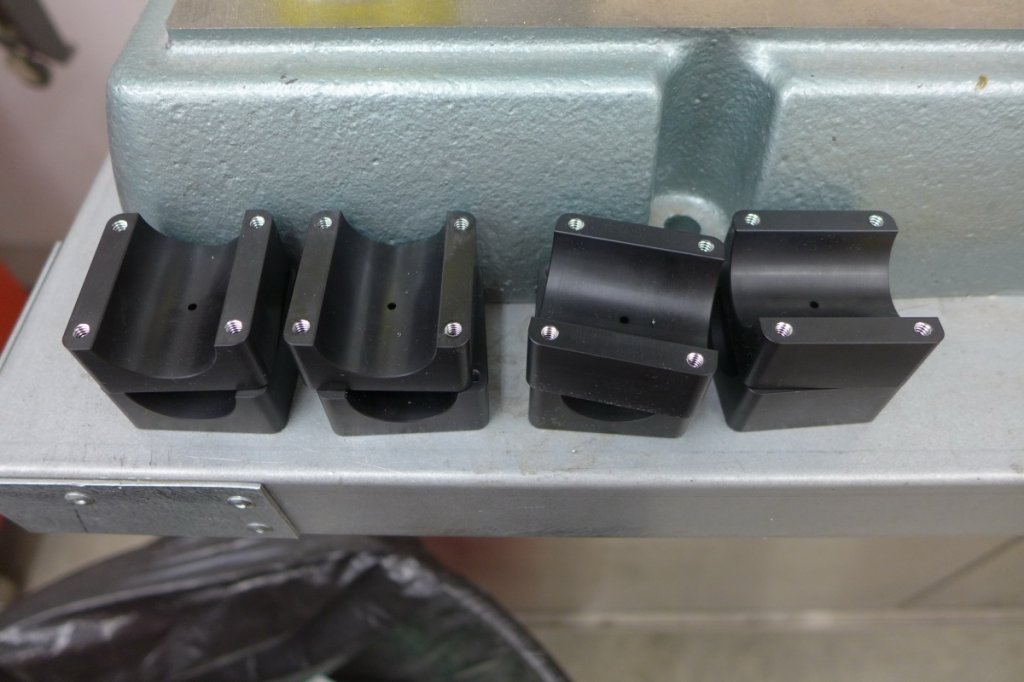

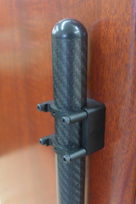

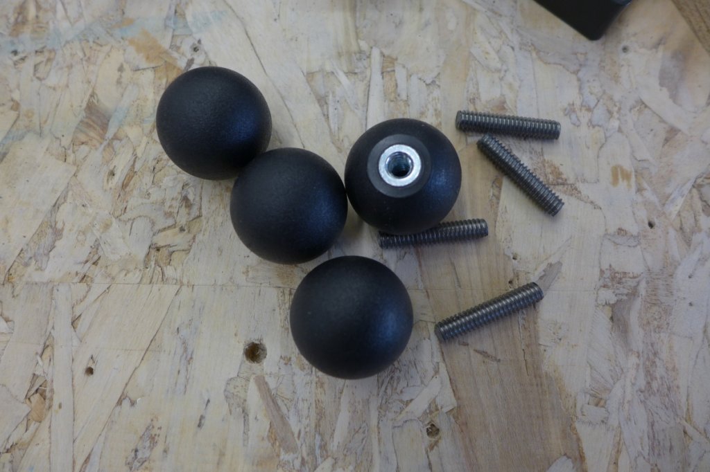

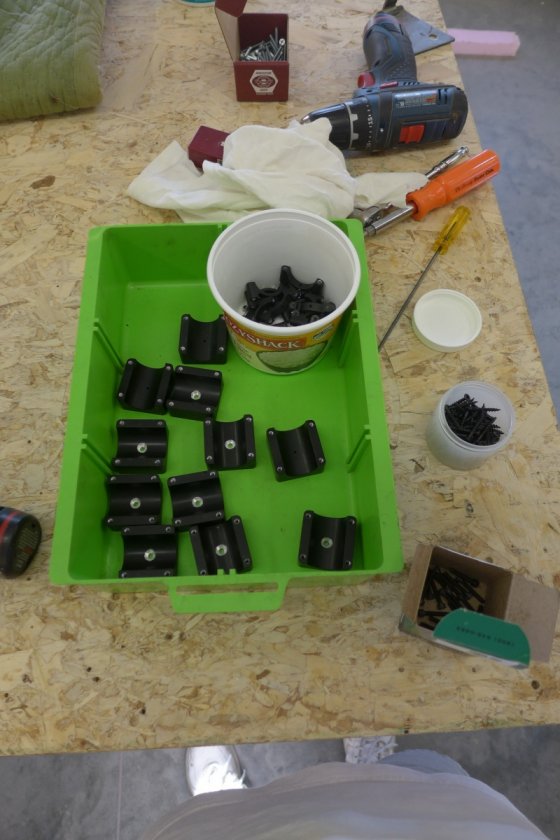

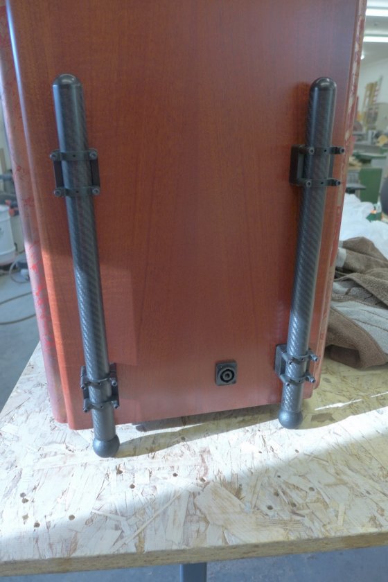

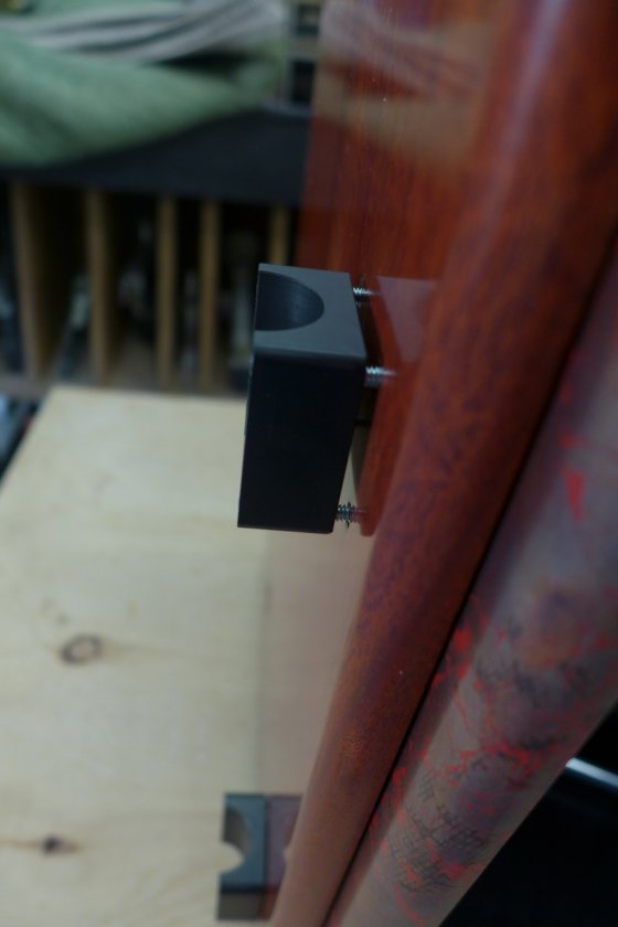

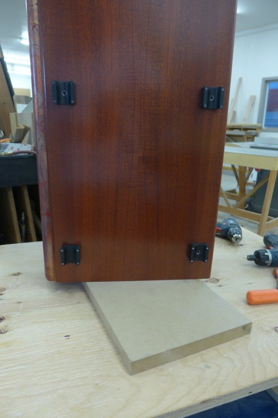

Beginning assembly. Paying work has been gettin' in the way of my speaker building! Grrrrr. While I'm thinking of it, I'll finish subs before mains and may put in existing system 'cuz I'm anxious to hear them. I know it's been discussed before, but for my benefit do y'all have some beginning settings for the sub amps so I'm not completely wingin' it? Would be appreciated.
The strap bases I had made needed to be set up for 6/32 machine screws coming from both sides so I drilled the straps for clearance and tapped the bases through
Needed to do a little customizing on screw length so they don't interfere with each other in the middle of base
Then
 Balls and studs
And the end result...woo-hoo!

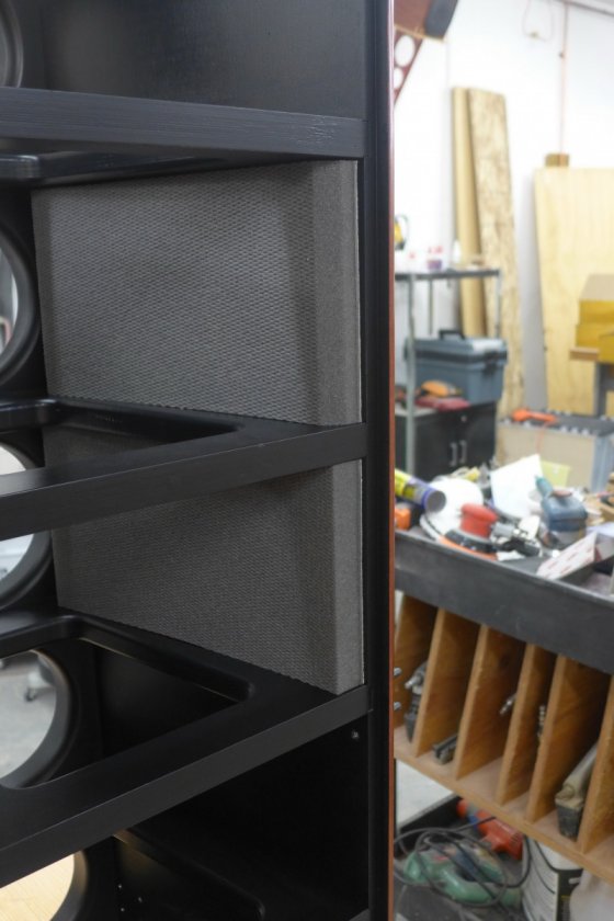

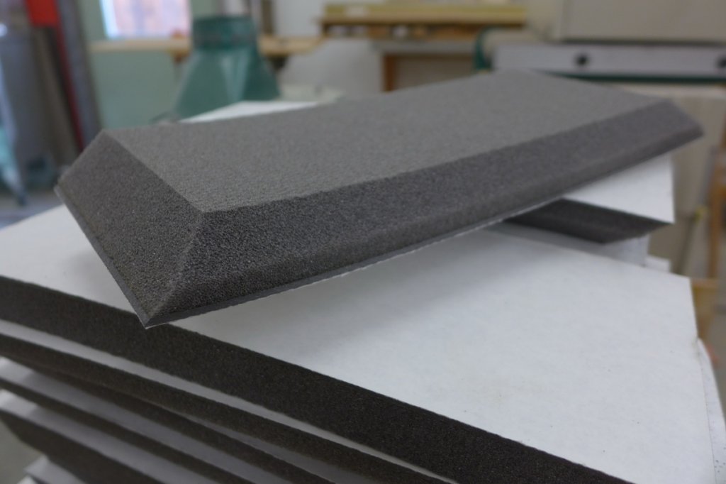

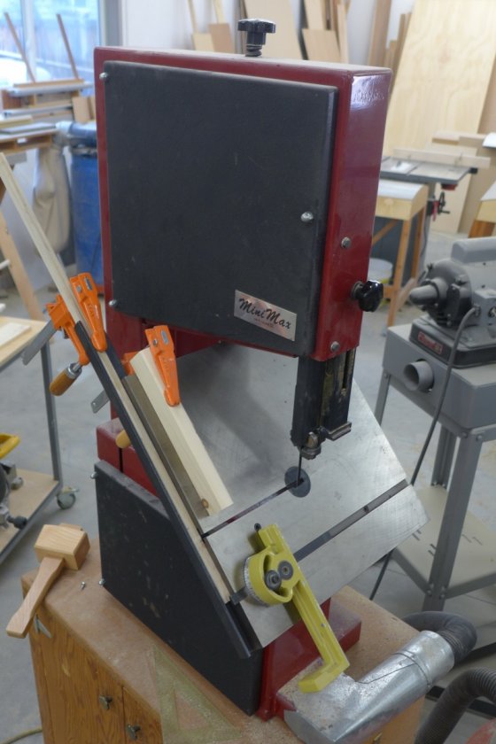

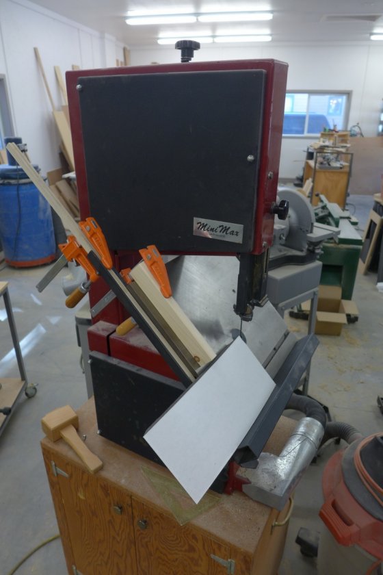

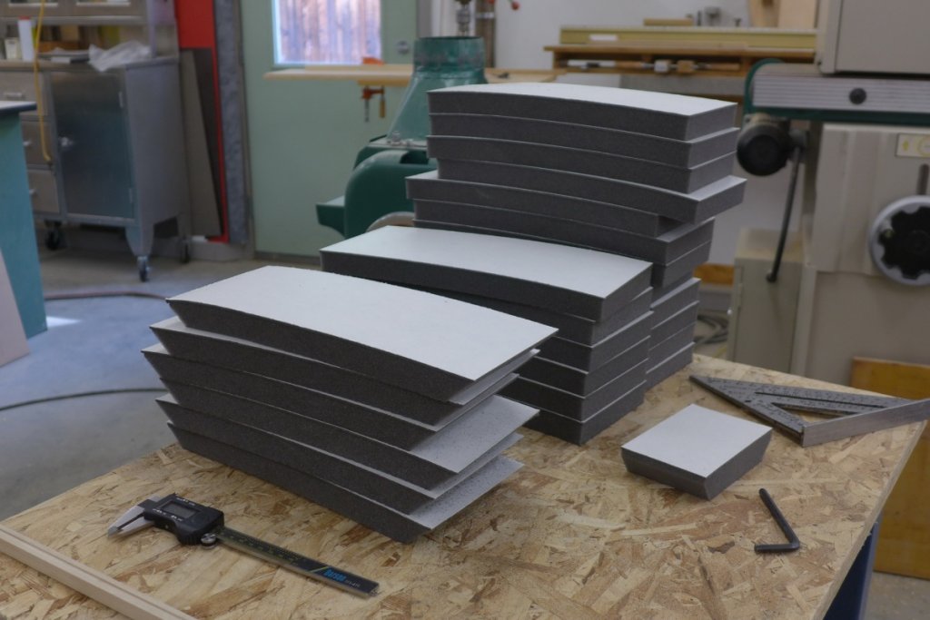

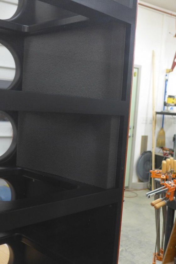

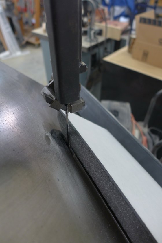

Because I am who I am and this build is about minutia, I can't just cut the No-Rez square ended and be done....so I mitered the ends.
Setup on bandsaw. As an interesting aside, I'm thinkin' that backing on No-Rez has some significant mineral content. I could see little sparks come off as I cut. I was willing to sacrifice the blade though so I pressed on...

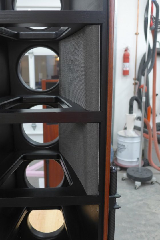

Midstream in the miters I thought it might look cool to bevel the front edge of foam
Final result

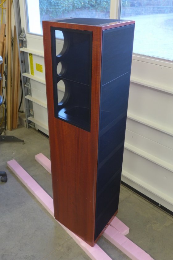

Moving on to box lining. Some knuckle rapping on box before and after the No-Rez makes the difference really apparent. I submit that No-Rez probably has Fairy Dust on it. How cool is that?

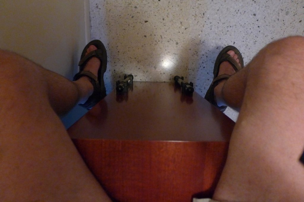

And just in case you're wondering about the holding ability of the strap bases and shear strength of those little #6 screws I sat on it. Speaker must weight around 80#, plus me at about 175#....I think we're good, not a hint of movement. No jokes about my bird legs, it was an impromptu test...

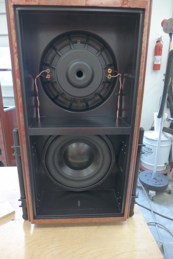

« Reply #216 on: 3 Oct 2016, 02:52 am »
Progressing slowly right now, in the midst of a to-the-studs bathroom remodel for client and just seems like there's lot's of things demanding my attention. Did get some licks in today and nearing the home stretch.

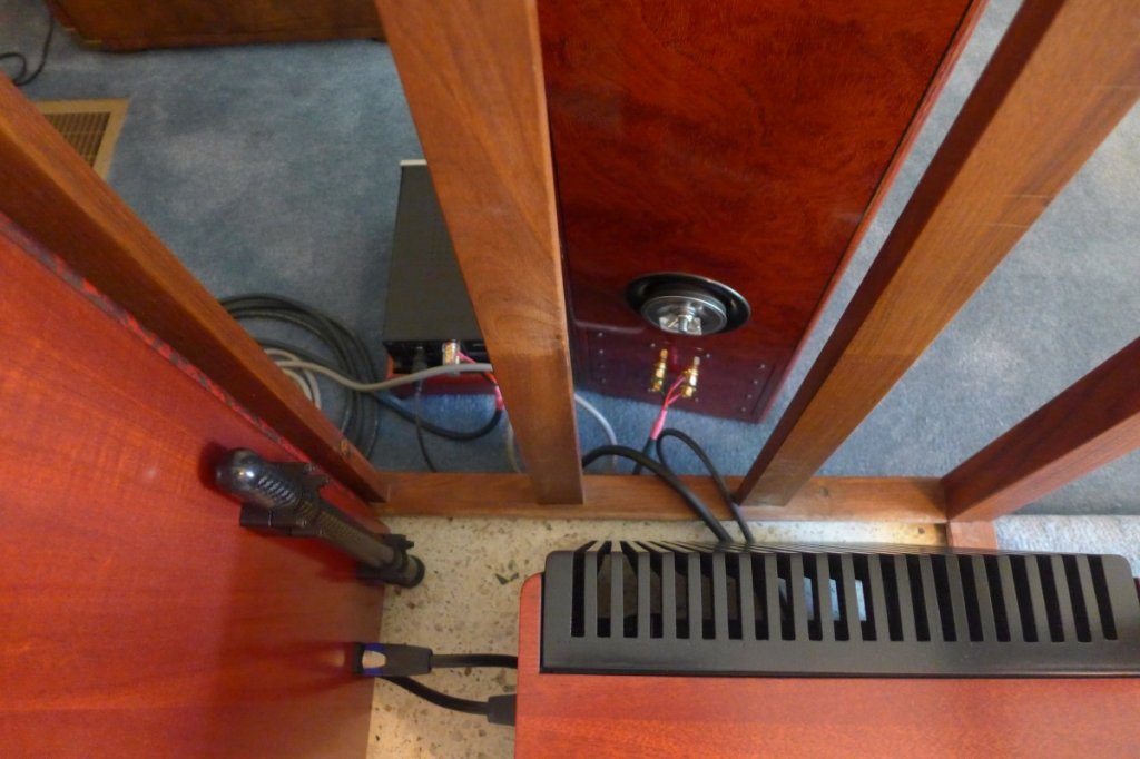

I had to get the subs in the house after getting them completed and installing dedicated outlets for sub amps and Ncores... just couldn't wait to hear the open baffle bass I see talked about so much.

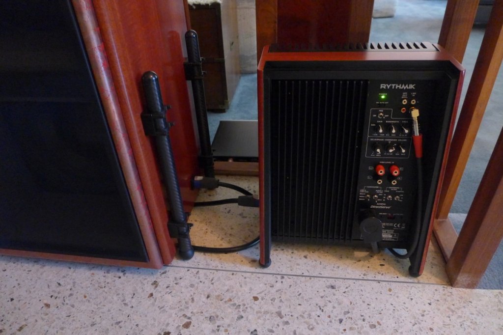

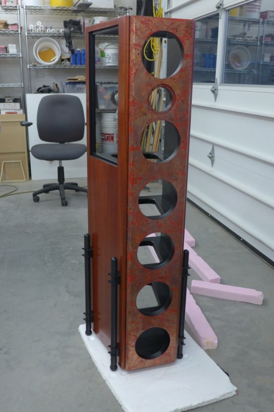

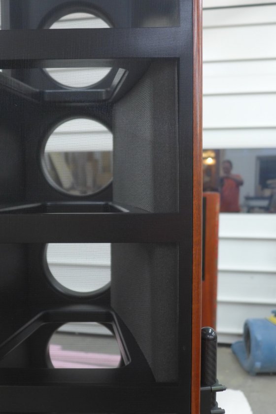

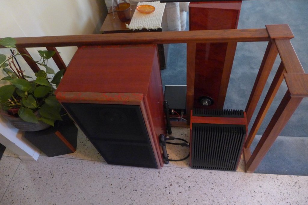

Here's a pic with and without sheer and sexy grills. The earlier post about the terminals had me wondering. I can live with it, in fact, I like that it ties it with the somewhat industrial vibe of the legs. Also had an idea to have amp house live on top, but that'll have to wait for another time...would require some forethought on wiring.
Placed in their home and hooked up

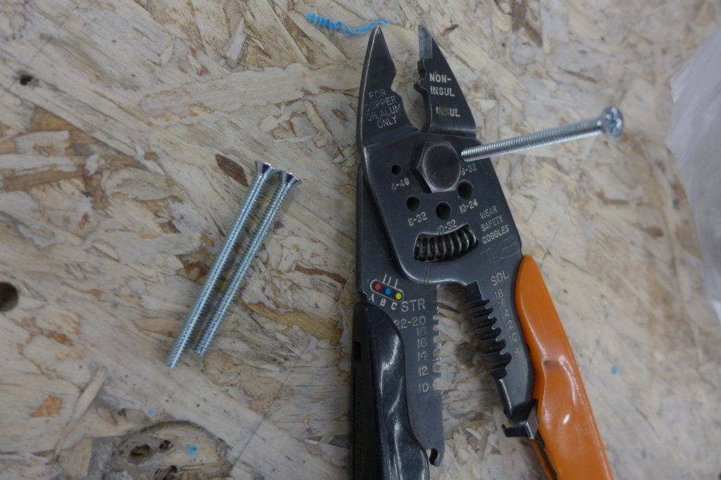

Right angle AC and RCAs to accommodate grill. I've never used the Speakons before. They are elegantly made little connectors. If you should use them, I'd suggest investing in a #1 Posidrive screwdriver or tip which is what the jamb screws are.

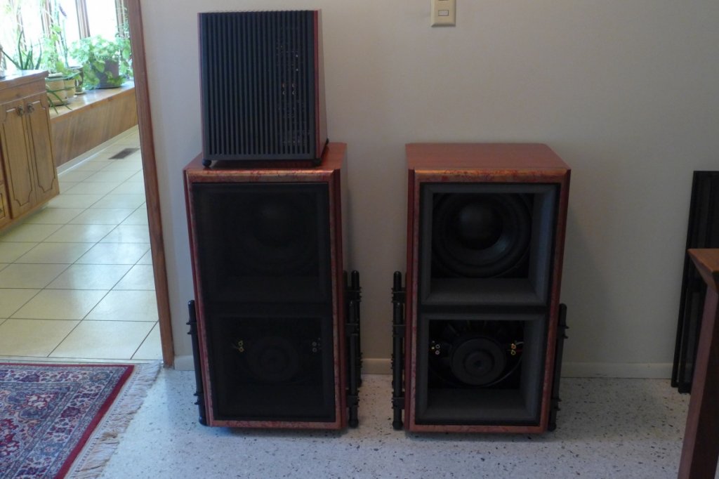

A view from the other side. Mains will replace what you see. I plugged the ports temporarily, the subs just do a better job down low
Got all the grills covered and had one crossover yet to solder. I'm really liking the No-See-Um netting for grills...I'm sure I'll use again.
The bases on the mains attach a little differently than subs because of shelf brace and other obstructions
Wiring and No-Rez on the horizon...probably next weekend. I'm almost giddy!
