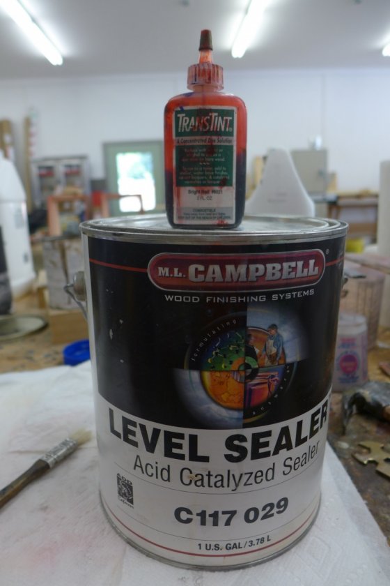

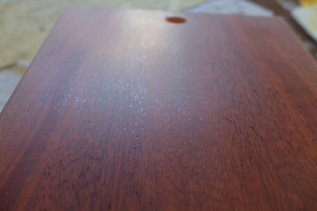

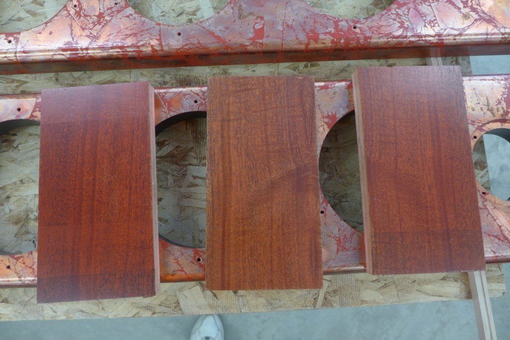

Started on finishing today.
Yet more samples to make sure I'm headed where I want to go.
Dye and sealer. After futzing around some I found that straight bright red Transtint got the tone I wanted. Surprised me a little, but with the color of the mahogany +straight red dye the base color is just what I envisioned. It will shift a little more towards red as the finishing progresses...you'll see as I move along...trust me! This will be a "fully filled" finish, meaning the open grain of the mahogany will filled so the final lacquer coats will be close to glass smooth...very little if any texture. Imagine dining room table or high end furniture.

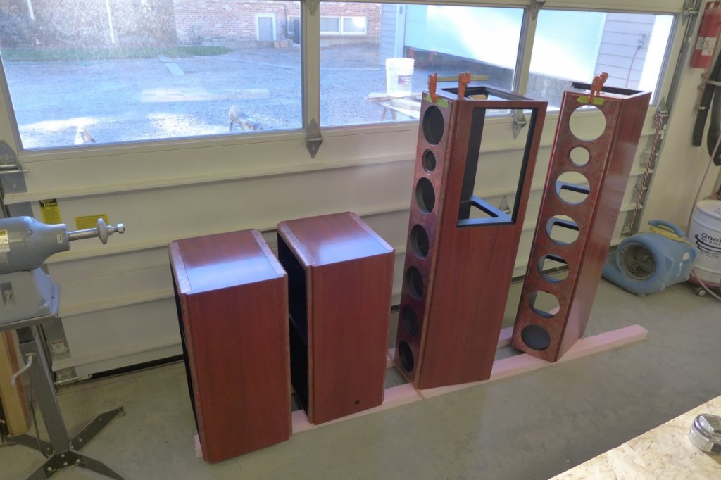

Here's the amp boxes after spraying dye and two coats of Level sealer
And here's a close-up. You can see the red dye on the non-veneered parts (those will all be black), and the open grain structure of the wood. This will change as I progress

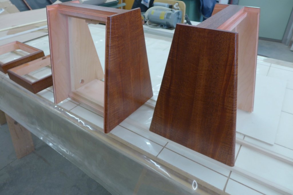

Subs and mains after sealer

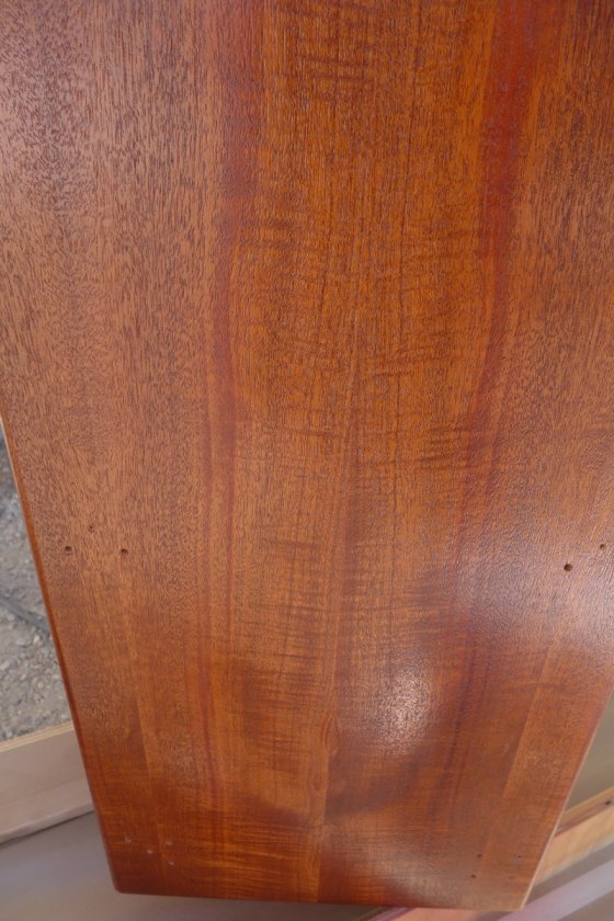

And here's the bonus fiddleback figure after the dye "pops" it.
Next on agenda: sand, fill, sand, spray more dye, spray Level, sand, spray Level, sand, spray Level, sand and on & on till it's glass. Then the topcoats.

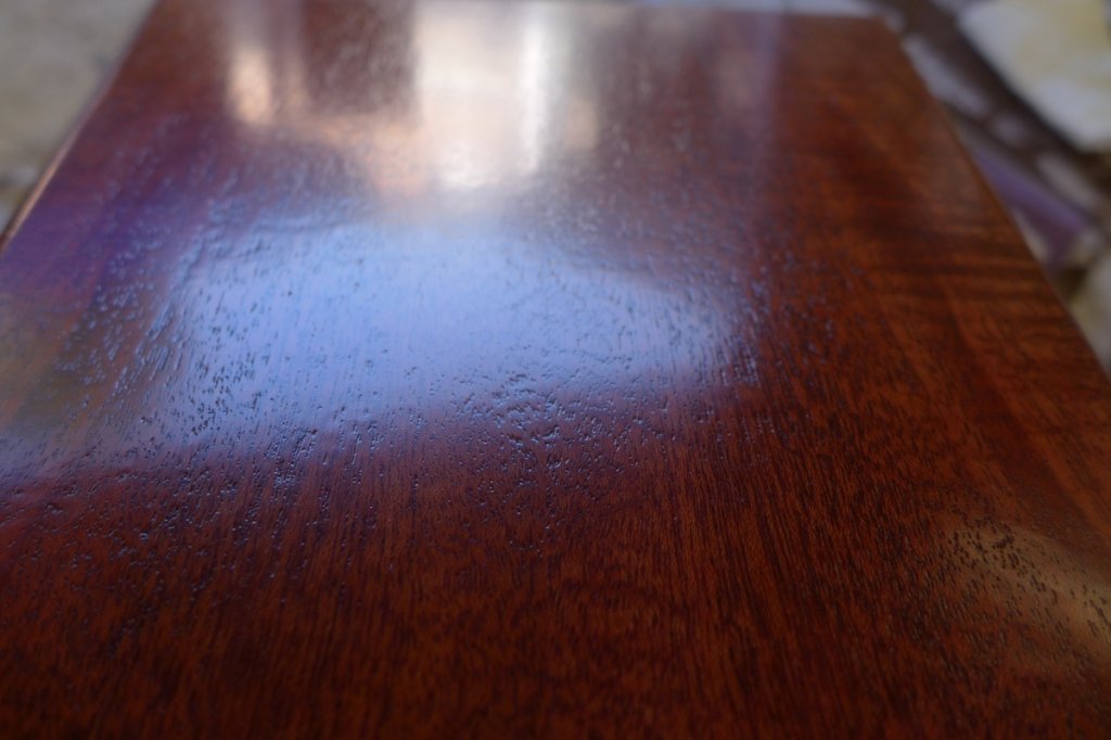

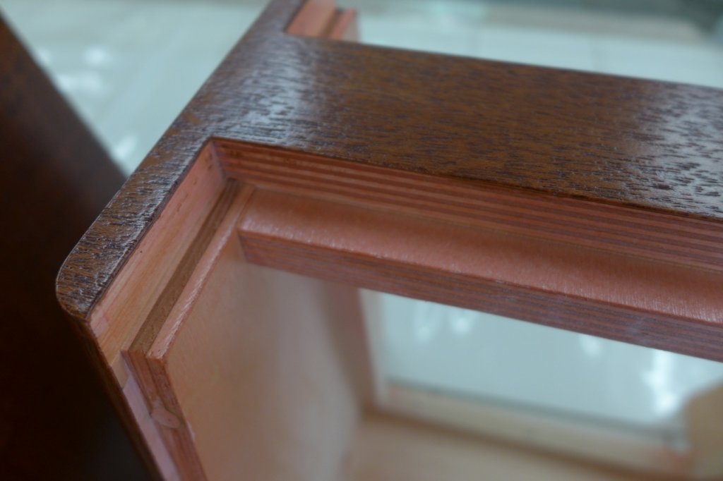

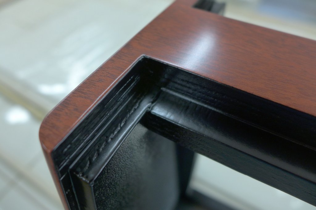

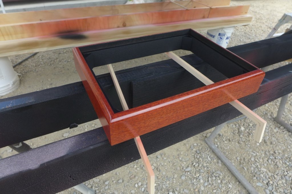

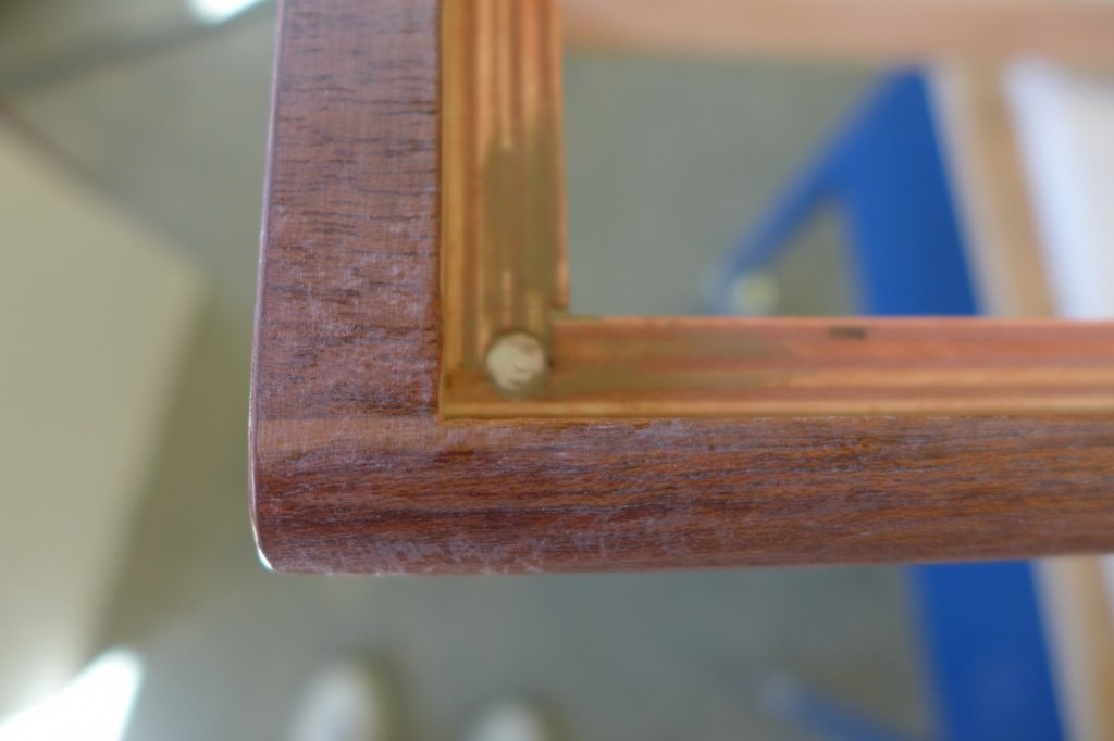

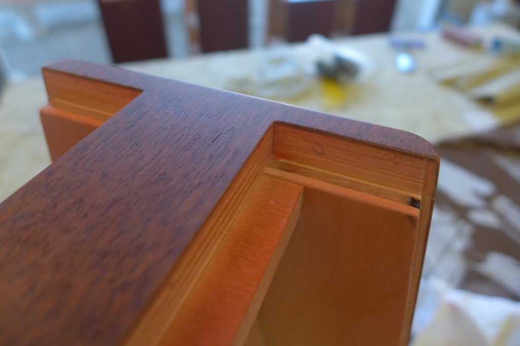

A delayed job gives me some time to work on these. I thought I might detail the finishing a little more because, truth be told,  because I like this part a lot! I'm using some products that might be a little hard to come by in the DIY world but the finish is some of the best I've ever done.

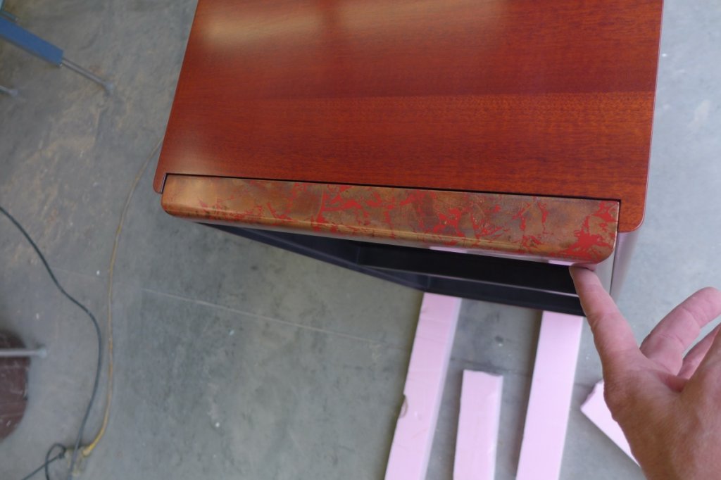

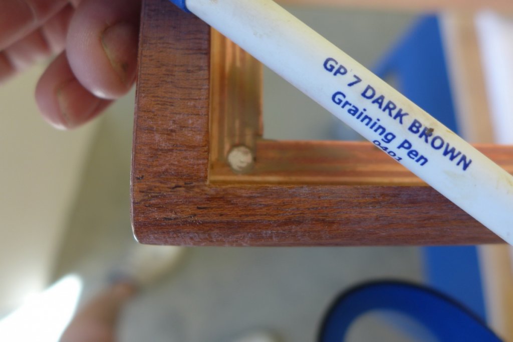

As I was sanding the sealer I noticed that I'd sanded through the veneer where I seamed it so I applied a little camouflage
Hopefully this comes through like I'm intending. Here's what the grain looks like after shooting 2 heavy coats of Level Sealer
And this is after I sand it back...way back. After this two more fat coats and sand back again and it has all but completely filled the grain. I didn't take any photos at that juncture...oops.
Once I got the second coats of Level sanded, I masked off the mahogany and shot black on interior. Then unmasked and put down three coats of pre-cat lacquer, sanding between 2nd & 3rd coat.
Close-up of the same area that I was showing grain in prior photo, for comparison

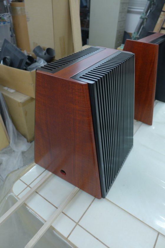

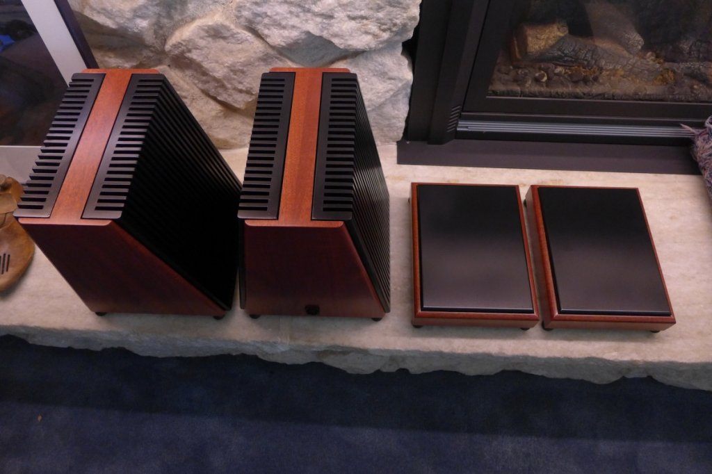

Had to stick the grills on to get a taste

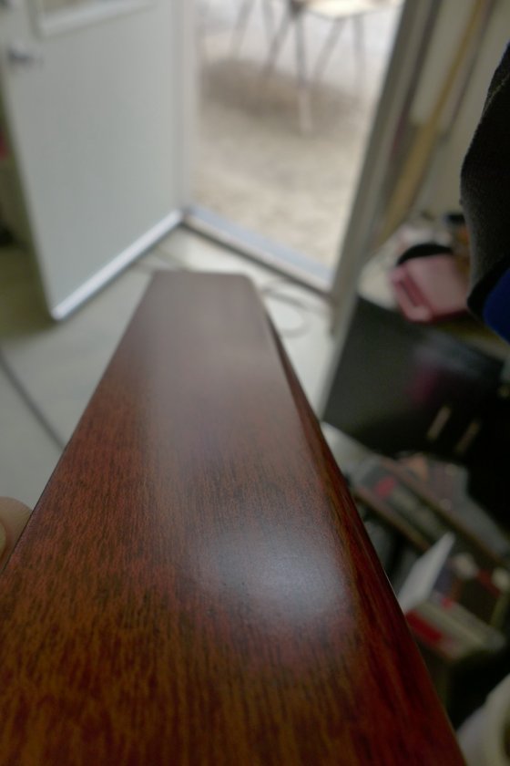

Some shots showing finish on amp base, it's kinda hard to photograph, but while you can see the grain and still get the wood vibe, the surface is dead flat and smooth. I once heard this type of finish described  as something like "makes you want to touch it" and that's apt, I think.  The most impressive thing to me is that this is the finish off the gun, no cutting and buffing. I'm pretty stoked!
Next up will be same treatment on mains and sub boxes. If there's something specific y'all would like to see, let me know and I'll take photos.

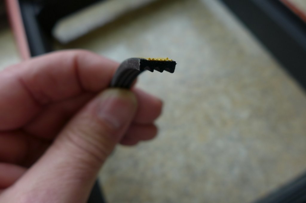

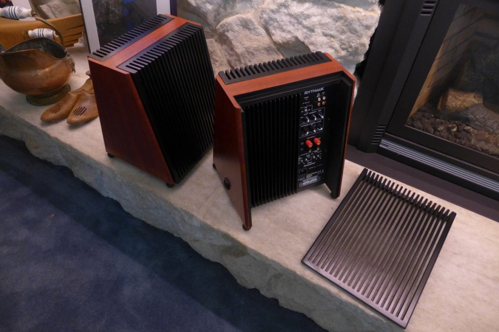

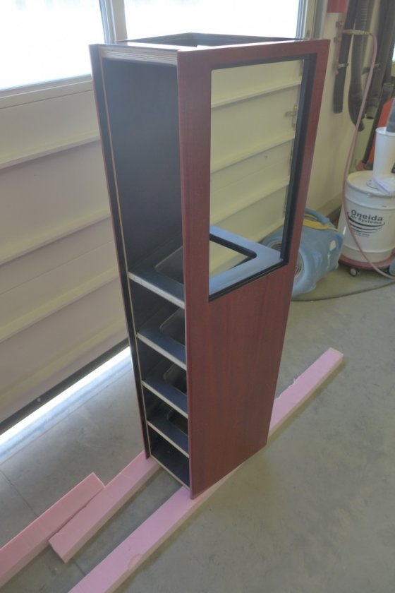

The next chapter. Still finishing, some assembly.

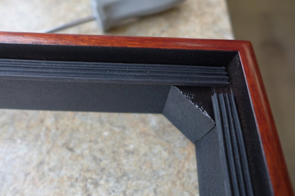

This is silicone rubber glazing seal...seemed just the thing for this application. I sprinkled fairy dust on it before installation and should probably name it something more elegant for audio use.

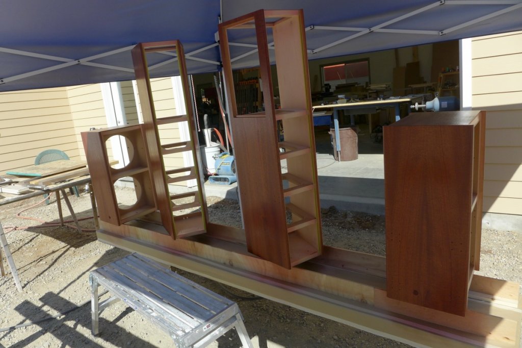

Got amp stands and cages done

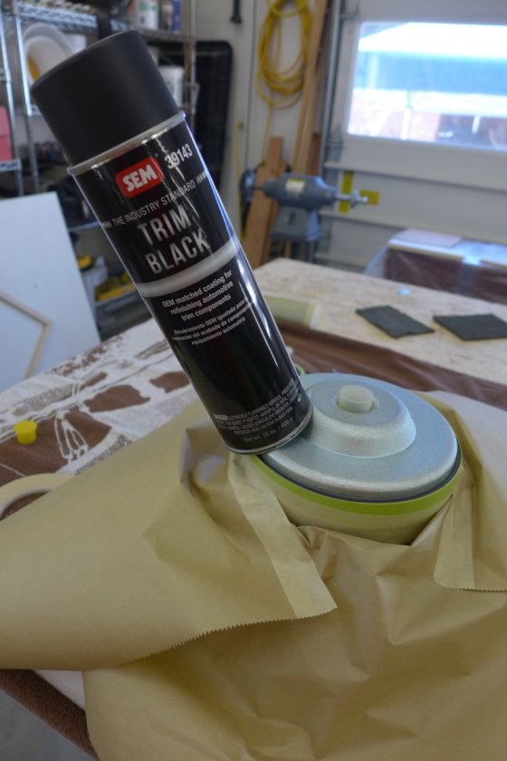

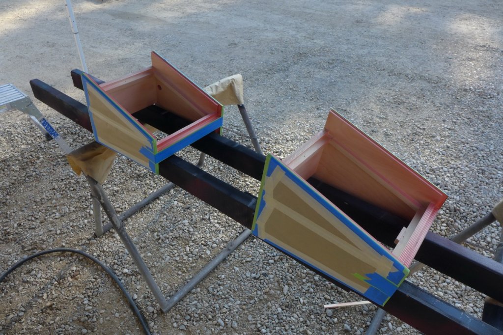

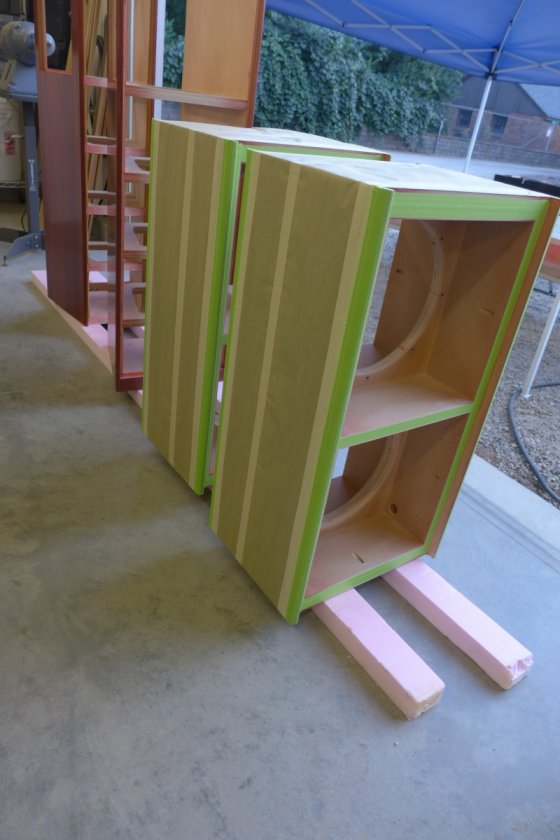

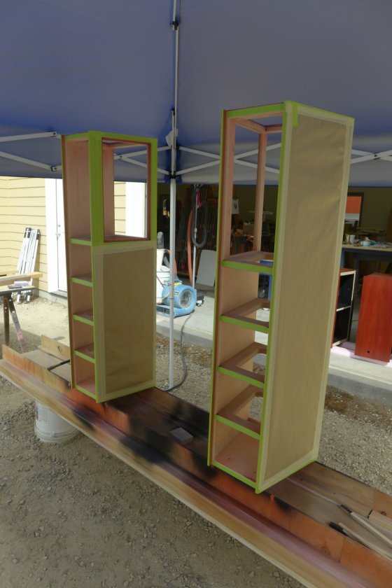

Masked off mahogany to spray interiors. Was going to do mains but the extra can of Clawlock I got just so I had it on hand was...........white! Shit! I had just enough black to do subs. Can't get more until Tuesday.

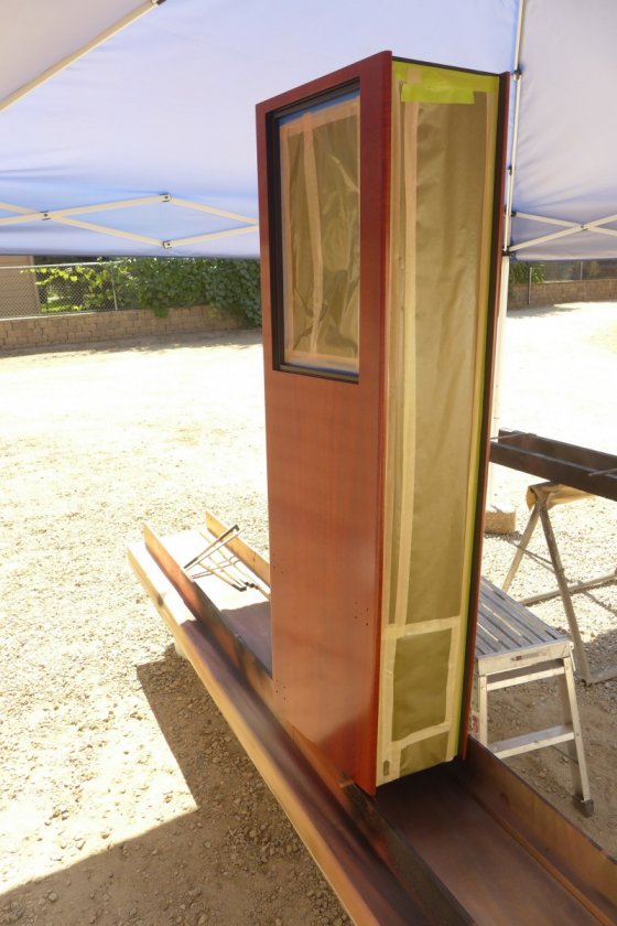

Once interiors on subs were done, I masked them to shoot final lacquer coats on sub. Lots of masking....not my fave. I had to do a mockup afterward to satisfy curiosity.
« Last Edit: 5 Sep 2016, 01:30 pm by Peter J »

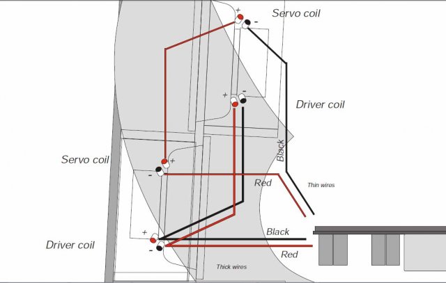

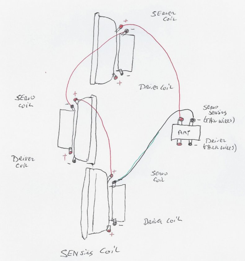

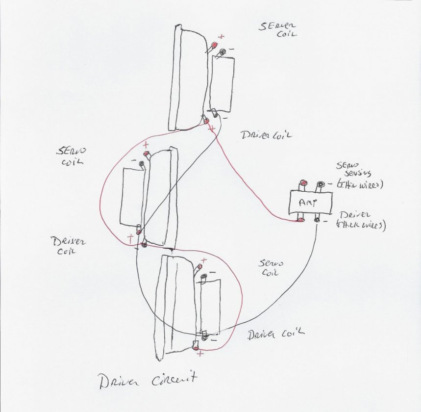

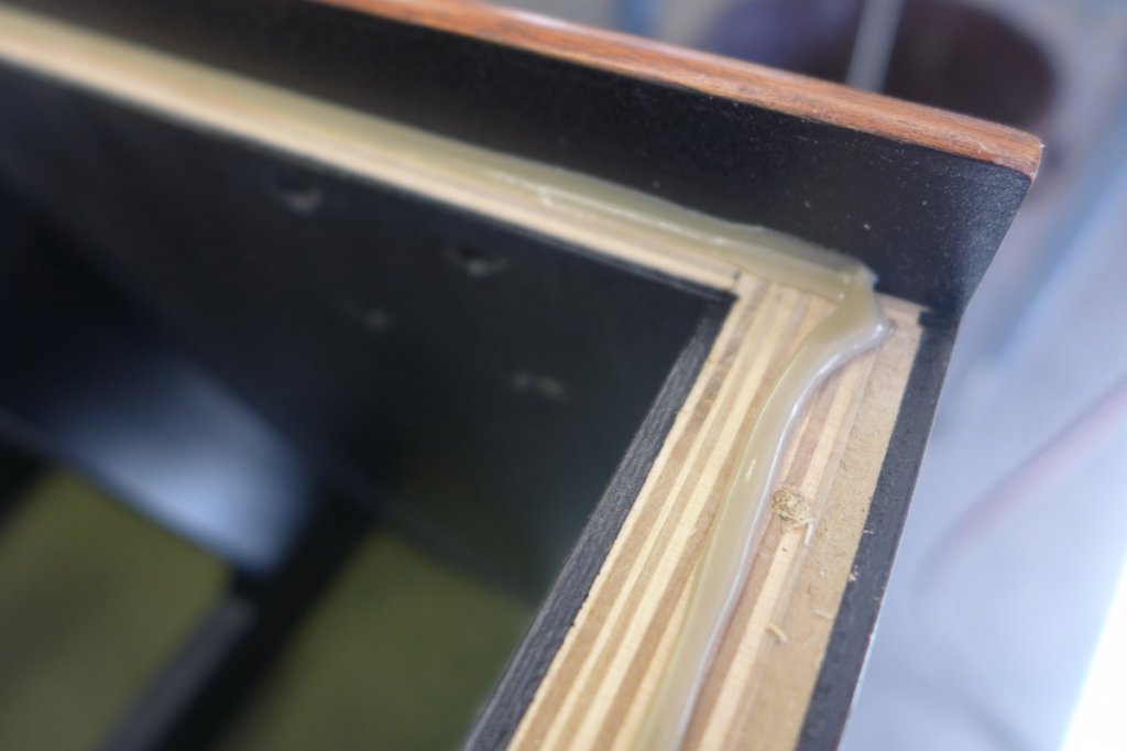

More progress and I need some help. I know I've seen but can't seem to find the diagram showing sub wiring. Drivers in parallel and sensors in series or maybe the other way around. Direction appreciated or just post here. Thanks.

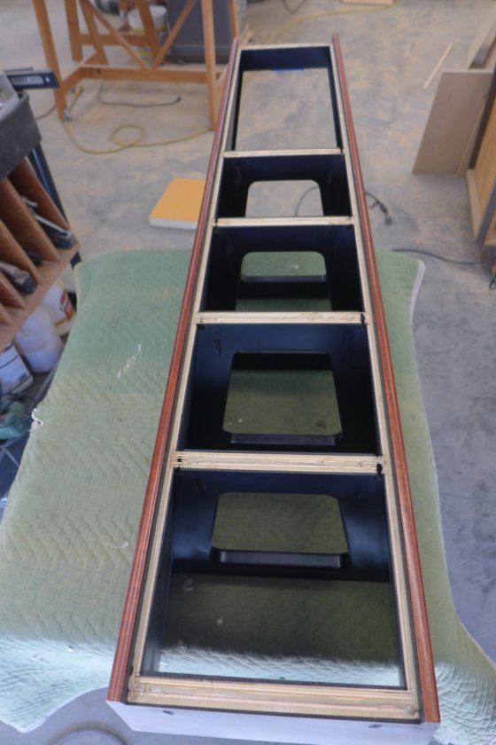

Finishing up the mains
Then glue and screw the baffles using PL Premium. Small bead all around...don't want it oozing out all over...inside's got to be pretty too!
Couldn't live with those big silver eyeballs staring out at me. Apologies Danny for taking your stickers off, they just don't jibe with my vision!

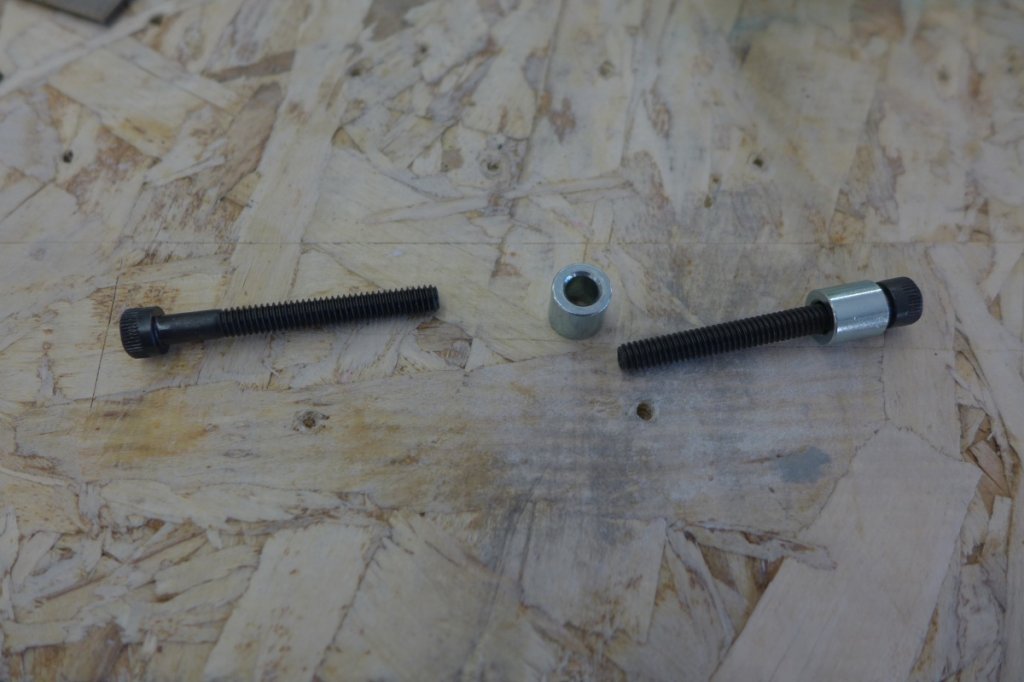

And y'all know how fussy I am about driver installation hardware so I put spacers on the mounting screws so they didn't disappear into the holes

mlundy57
  • Posts: 3643
Re: ***X-Otica Main & Sub Build***
« Reply #195 on: 11 Sep 2016, 06:09 am »
Peter,
Here you go
Mike
Peter J
  • Posts: 1964
  • Hmmmm
« Reply #196 on: 11 Sep 2016, 01:41 pm »
Peter,
Here you go
Mike
Thanks Mike, I don't think I've seen these before. The one I was remembering was a Super V silhouette.
In my case using two drivers rather than three, I would just eliminate the bottom driver and wire bottom driver in subs as if they were middle driver in drawings? Does that make sense?
HAL
  • Industry Contributor
  • Posts: 5584
« Reply #197 on: 11 Sep 2016, 02:18 pm »
This one is for 2 subs:
Peter J
  • Posts: 1964
  • Hmmmm
« Reply #198 on: 11 Sep 2016, 03:20 pm »
That's the one I remember. Thanks Rich. Danny, maybe these could be stickys here or available on your site? Seems like it's brought up from time to time.
mlundy57
  • Posts: 3643
« Reply #199 on: 11 Sep 2016, 03:26 pm »
Sorry about that. I drew these out when I was wiring up my 3x8" H-Frames then accidentally saved them in the wrong place (a folder for dual drivers). When I posted these I didn't look close enough to realize they were for a triple hook-up.
