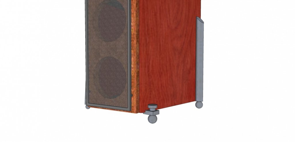

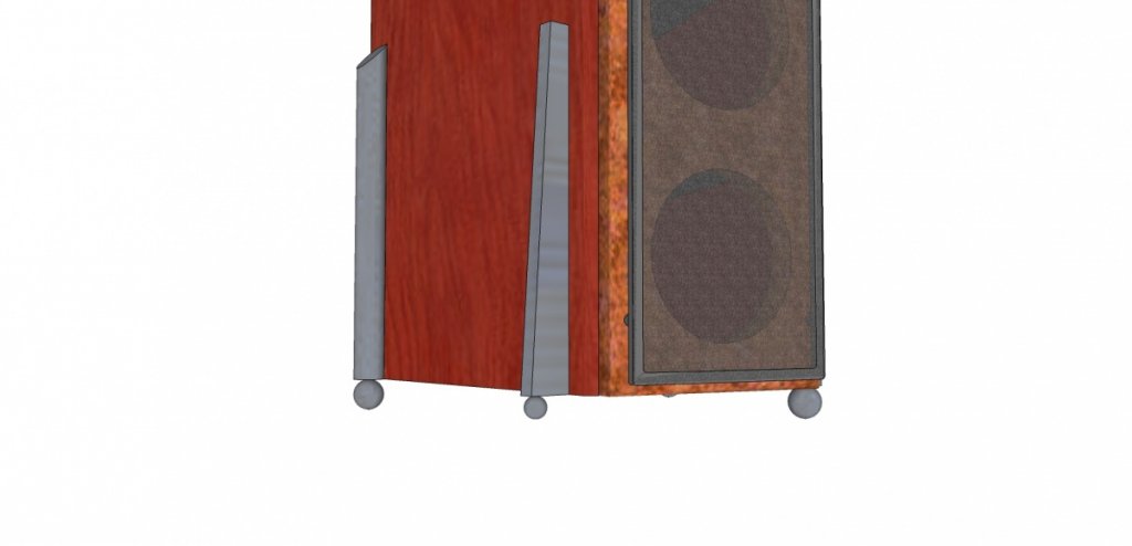

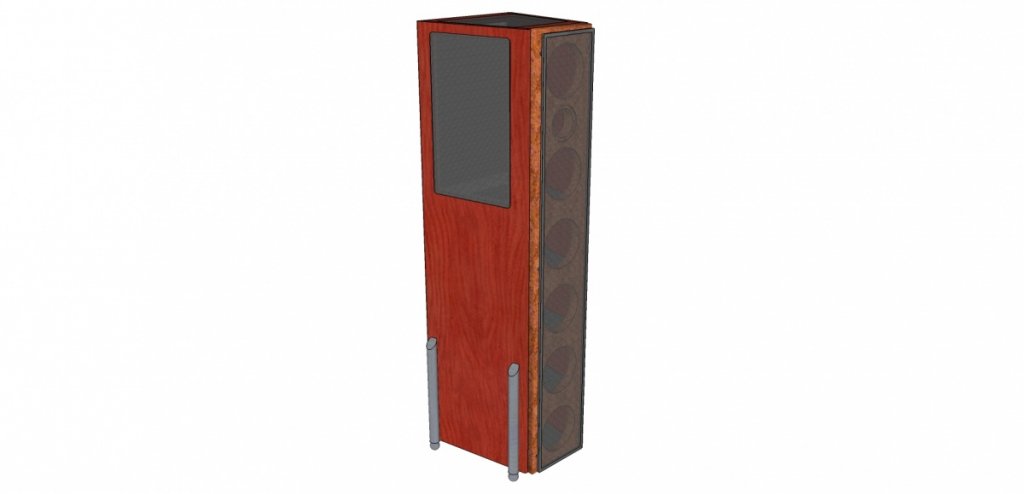

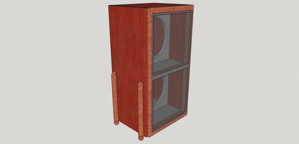

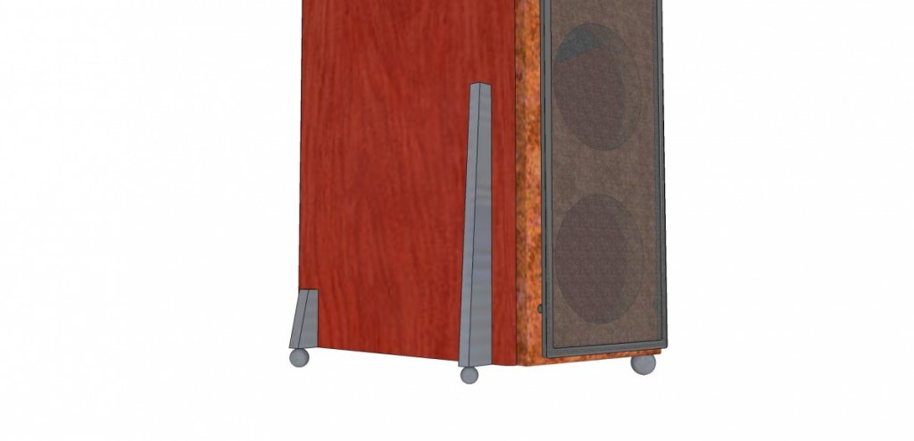

I've been pondering some, messing with the leg/footer design... just not loving the totally tubular look. I thought I'd throw it out to the group and see what y'all think. Ideas and comments encouraged.
Some considerations:
   In some cases feet could be wood or at least wood encased.
   I'm not a huge fan of cones or spikes, hence the spheres
   There's a limit to what I'll spend for someone else to machine metal stuff for me. There's 16 of 'em after all!
   I tend towards the unconventional (just in case you haven't noticed)
Here's some brain food

Peter,
 Of the ones you show, I like the long round leg. How about using carbon fiber tubing for the leg?
Another leg style I like is this:

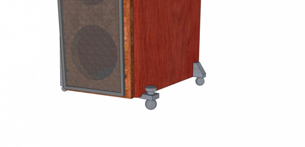

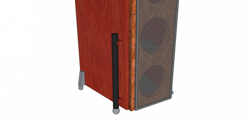

Hmmmm, carbon fiber...tubing rather than rod...gets the wheels cranking.
Here's next go. Wood standoffs, CF tube (sorta), not really fleshed out, still in concept stage. I think I like the standoffs.
Carbon Fiber really looks nice with wood. You could also make the stand-offs full length. Angle the top of the CF tube and insert a nice wooden cap (plug).
Or- you could make a wooden leg like one of your other pics, and cover it with twill weave CF cloth/epoxy. I always wanted to do a front baffle in twill weave CF.

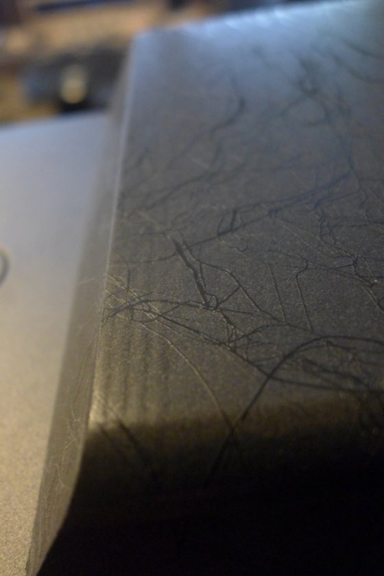

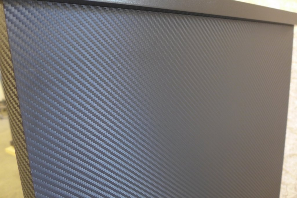

Pete, although I haven't' seen them used a lot, wraps seem like a really viable way to rapidly finish a variety of things. It works for the most part like old fashioned contact paper, but with the ability to reposition and heat to fit. And by the way, not much heat is needed if you use heat at all...trust me on that. A quick swipe with a hair dryer is all I've found to be necessary.
The adhesive on the wraps I've used seems more than adequate for speakers. I had to remove some after a couple of hours on primed wood and the primer came with it. Which leads me to your next question. The smoothness of the surface that you're applying to is important. I'd seal and sand raw wood...primer, sanding sealer, shellac. It probably doesn't matter much which as long as it's well adhered. The film is thin enough to telegraph irregularities in substrate.
Here's a photo of a Baltic Birch cover I made and wrapped for my computer. I think I probably sealed it with lacquer or shellac. I hope shows up with photo but you can see the plies on the end cap telegraphing through...suffice to say surface prep is important. It would probably be less so with a textured finish like CF. BTW, I think the 3M DiNoc wraps are most realistic I've seen.
These folks have lots of choices:
https://www.fellers.com/
Here's a photo of a sub I wrapped the sides on with Di Noc

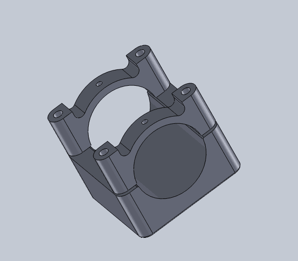

Question for y'all.
I'm considering having these made for supporting the CF legs. Only one problem, I need to order a BIG quantity to make it happen at reasonable cost. They'll fit 25mm (1") tubing and be anodized black. Only difference from drawing will be a 2mm hole centered on base portion.
 If I get a bunch of these, is there any interest out there for your own projects? I'll have extras...lots and lots of extras.

I'd possibly be interested; they'd be a great way to build height adjustments into some projects.

Possibly me as well. Any idea about what type if weight they would support and what type of cost are we talking about?

Hey Peter...
Instead of have the brackets made, maybe you could re-work 25mm rifle scope mounts that are pretty cheap.
Lot of choices: http://www.aliexpress.com/af/rifle%252Bscope%252Bmounts%252B25mm.html?site=glo&g=y&SearchText=rifle+scope+mounts+25mm&isAffiliate=y&initiative_id=SB_20160106061716&shipCountry=US&needQuery=n
How about this one? It fits a 20mm weaver scope rail that could be attached to the speaker cabinet.
http://www.aliexpress.com/item-img/Free-shipping-1-25mm-Ring-Tactical-Laser-Scope-Sight-Weaver-Picatinny-20mm-Rail-Rifle-Mount-S/1914130494.html?spm=2114.10010108.100005.12.ev2Hqq

Mike, I think weight capacity would be considerable. I added the center hole in base to accommodate either a roll pin driven into captured rod/tube or drill it out for a machine screw. The thru holes will accommodate M3 screws, so assuming all three go through base material and center pin is used, I'll bet shear strength would be upwards of 100 lbs per unit. That coming from my seat-of-my-pants engineering degree :o
Larry, I saw those and similar. I just couldn't find what I envisioned, hence the "make it" mentality. I have a penchant for making the simple complex so this fits right in!
