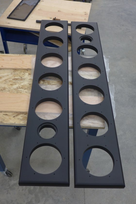

Got the frames filled, primed and lacquered.
 I didn't say it but I agree nothing is best, you have enough going on with the look without adding things that make the speakers too busy...
And the baffles sealed and ready for gilding

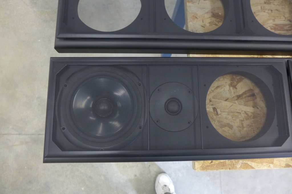

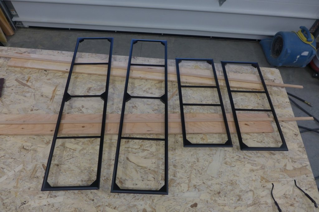

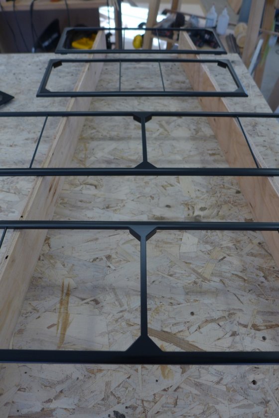

Going backwards to go forward....arrghhhhh!

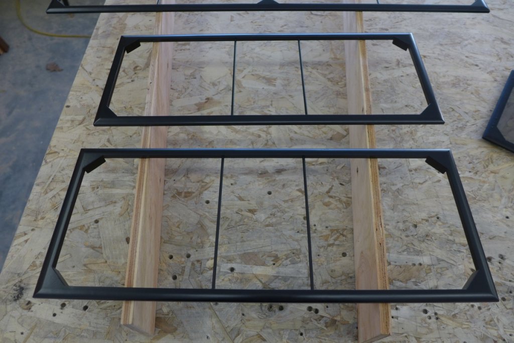

Haven't been able to work on these much lately but decided to get the grills done and out of the way.  Shortest staples I had were 3/16" and the grills were 1/4". Subtract the depth of the staple groove and a margin for ohshit and I knew it was close. Shot a few staples and looked at the front...good to go. As I was installing the screen, I somehow broke the cross braces loose.
I thought, "I can fix it", so finished stapling and trimming the first one...face down, of course. Flipped it over and heart sank, staple tips barely poking through my nice grills!
So I went back to drawing board and redesigned to avoid previous boondoggles. Ordered shorter staples, thickened  up the grill frames by 1/16", drilled and epoxied steel left over from wire grill experiment. Also took the opportunity to make the bottom grill mid rail corner blocks a little smaller since they don't need to house magnets and looked kinda bulky. I had misplaced the top grill cross braces so I fixed too. Mo betta the second time around! So I'm back to where I was 2 or 3 weeks ago.
I was finally able to upload photos by using Internet Explorer instead of Edge. Can anybody shed some light there? I've been using Edge since I switched computers a few weeks ago without issue until now.

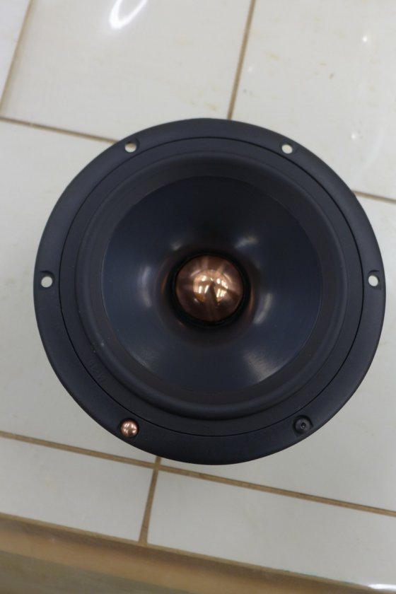

FWIW, you did spark another idea, though. I was planning on black fasteners for drivers, but then got to wondering what copper might look like. Yeah, yeah, I know that's a rivet, just imagine it's a screw and tell me what you think.
I'd be tempted to try those copper fasteners... they sure go well with the center cone.

I think I'll forgo the copper screws for this one because the front baffle will be plenty if it goes like my minds eye sees it. Hope to get a little more experimenting in today. The copper screw idea led me to an interesting copper plating resource though. They were quick to respond to my queries...I hope to use their kit someday.

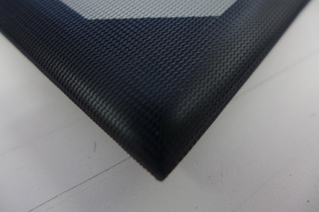

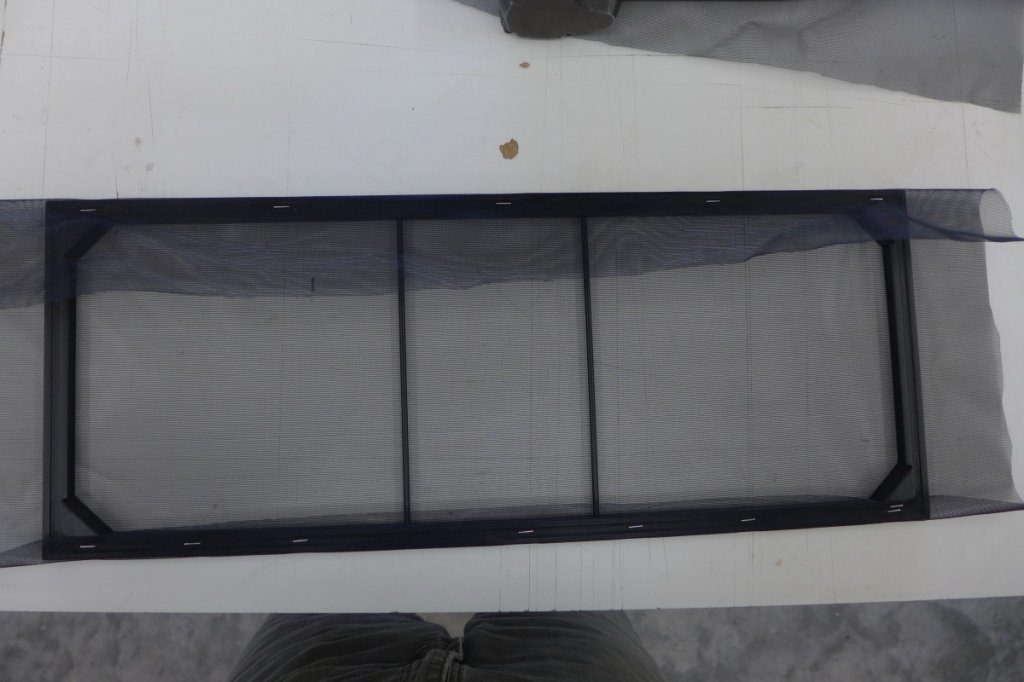

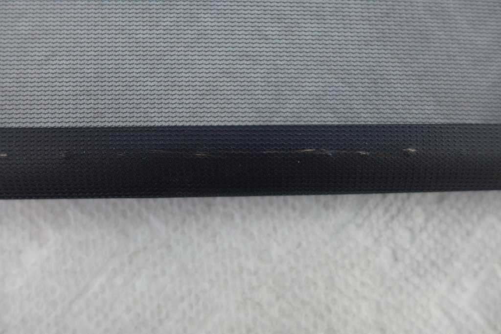

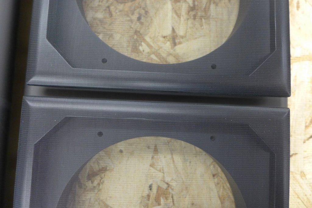

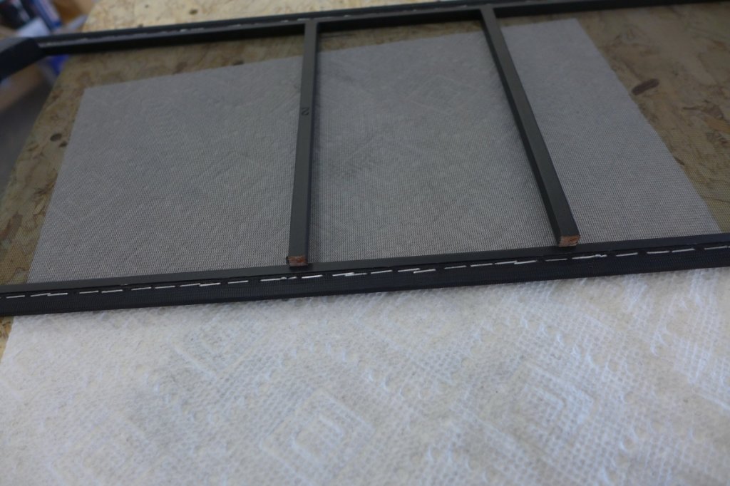

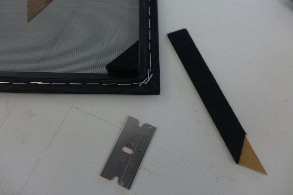

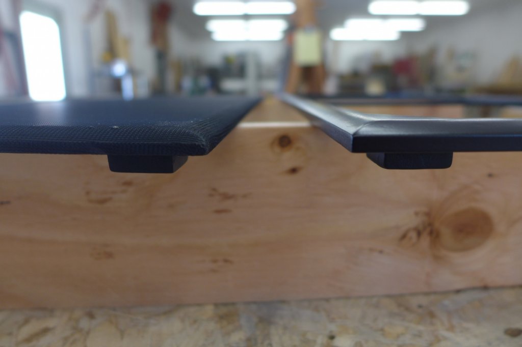

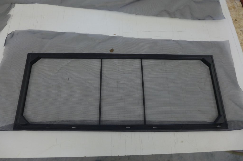

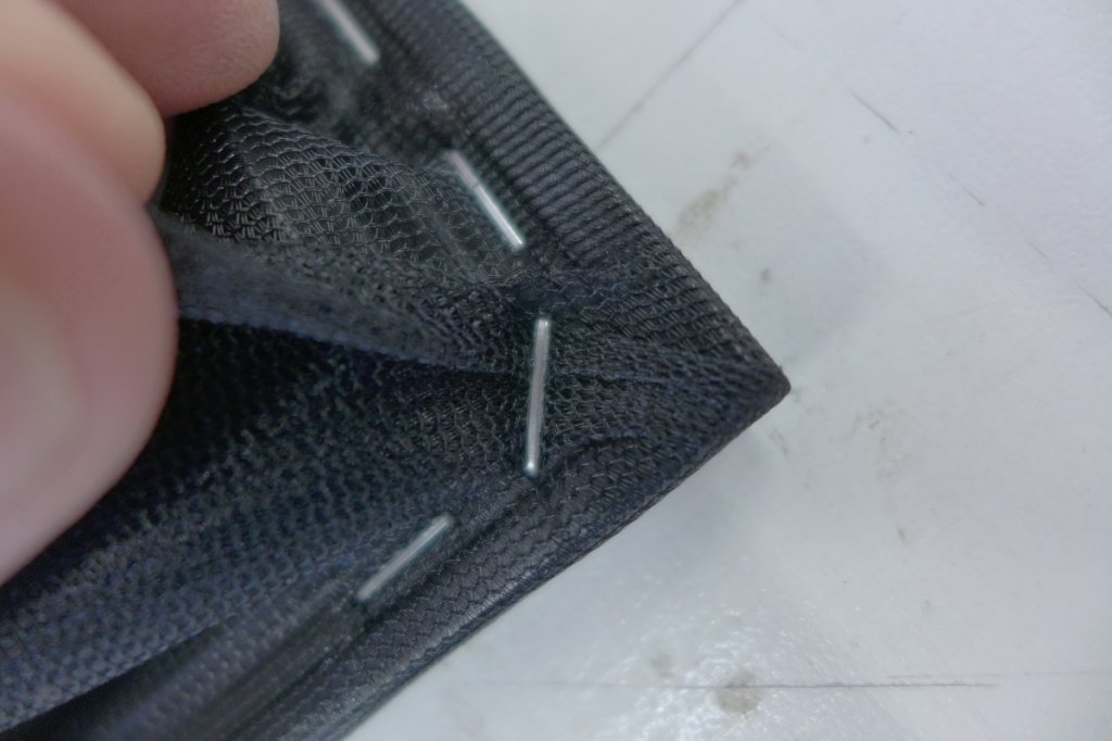

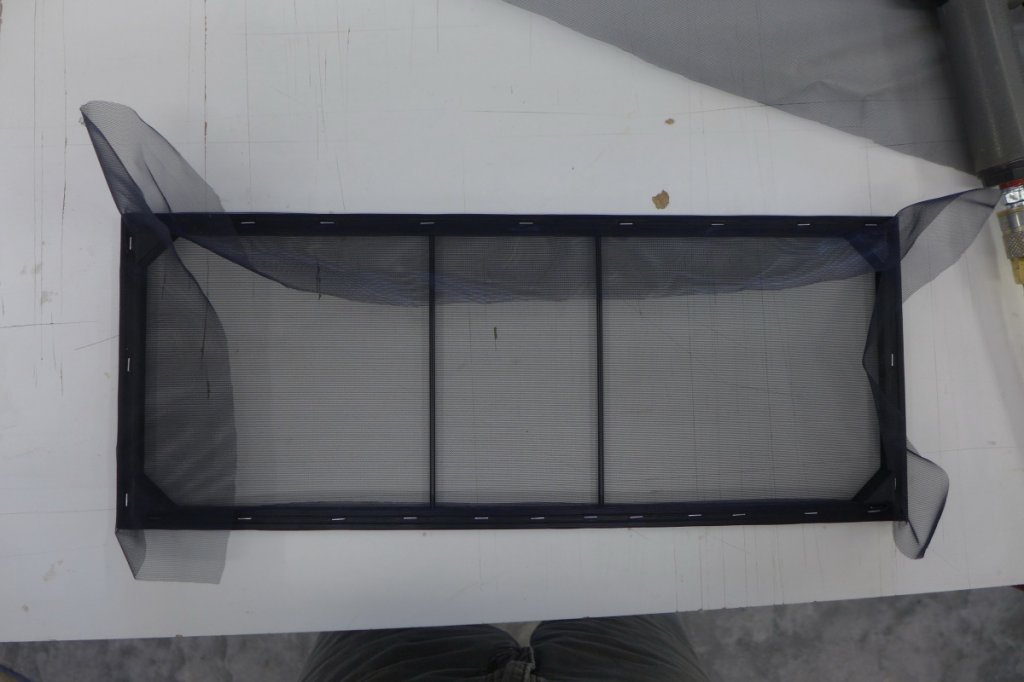

Off we go on the grill saga
First I put a few staples along one side pulling just a smidgen of tension end to end.
Switch to other side, again pulling just enough tension to  pull wrinkles out. This screen is a little different than cloth, but principle is the same.
Do same on ends

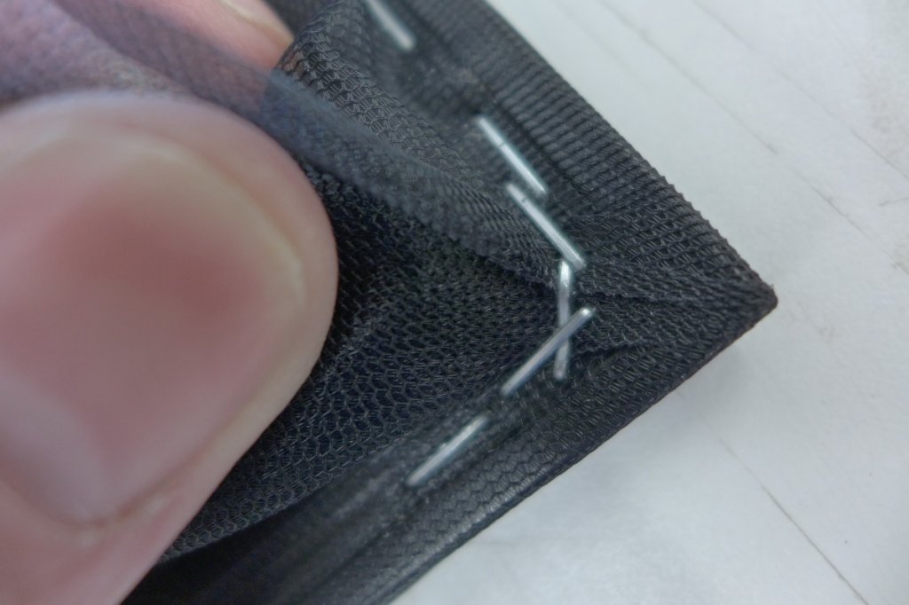

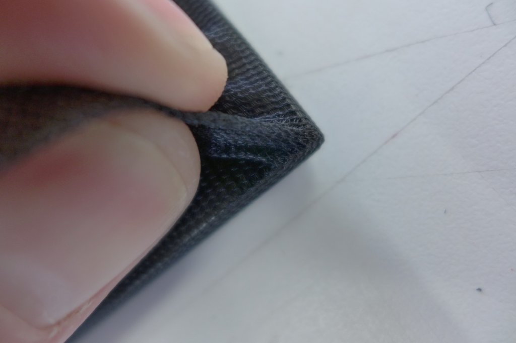

Then to corners. I kind of peak the fabric in my fingers. These close ups could have been better if I'd set the camera for more depth of field but...
I sort of slide stapler down the ridge and towards center and shoot 1 staple diagonally
Then a couple more at right angles and perhaps another diagonal. I'm trying to squash and flatten all those folds,

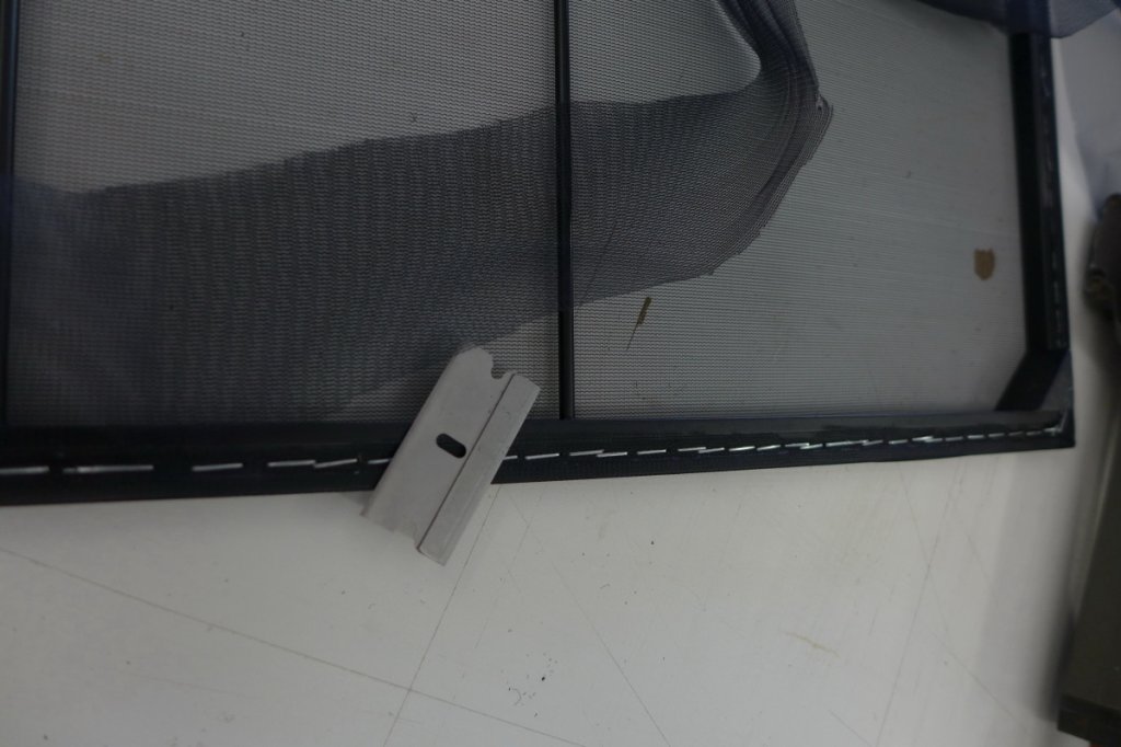

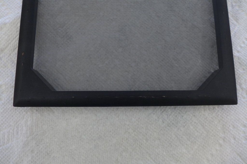

I didn't get a specific photo but after I do the corners I staple around the perimeter coming as close as I can to a continuous line of staples. This step seems particularly needed for this screen...its stiff compared to fabric. The staple slot has a convenient by product as it pulls a little more tension into fabric when pushing stapler into groove. I leave fabric so I can get a handle on it then trim with new razor blade. I skate it along parallel to surface
This moves right along with sharp blade

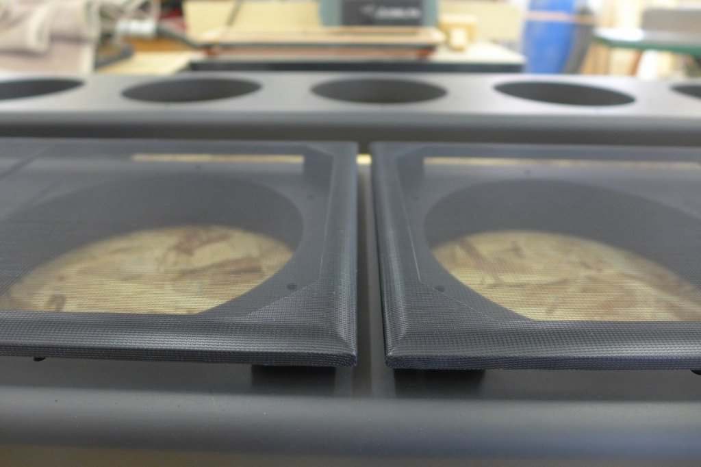

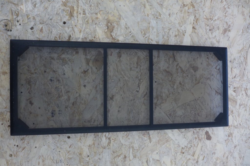

Flip it over and NO STAPLES pokin' through...woo-hoo!
Add some felt on the standoffs
And we have liftoff!...or something. Success anyway, glad to have this behind me.

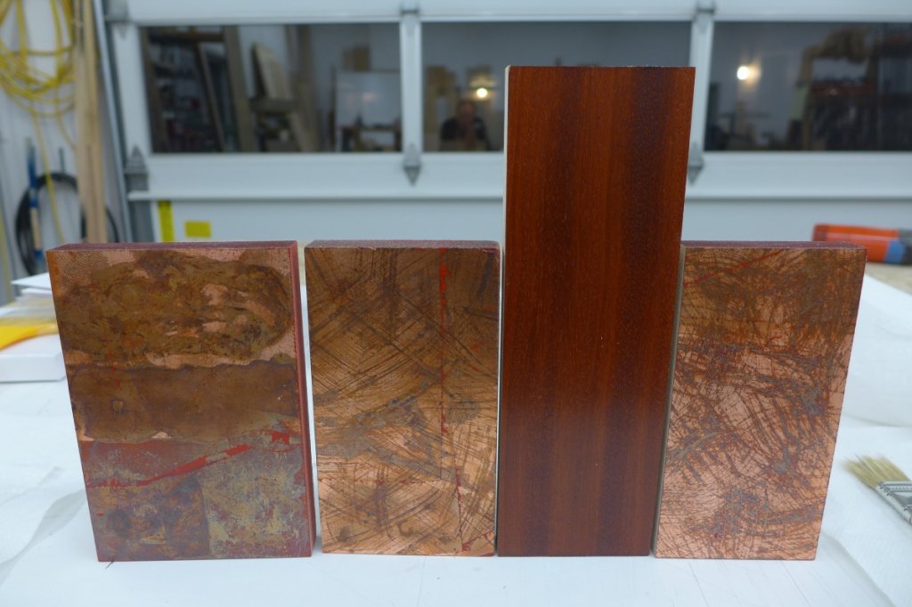

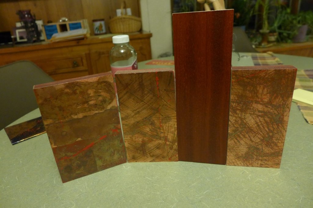

I futzed around with some more patinas on the copper leaf for the baffles. I'm pretty set for color on the mahogany, so it's finding something to go with it while keeping the complexity to a minimum.  If you look closely, there's at least a couple subtle variations on each panel. I always feel a little like a mad scientist when I mess with this stuff...probably kindles some childhood memory...
I'll think I'll be finishing these in a low sheen like you see on samples. Same samples with different lighting. See any you like?
gregfisk
  • Posts: 1349
Re: ***X-Otica Main & Sub Build***
« Reply #79 on: 23 Feb 2016, 04:07 am »
O.K. Peter, you asked.
I like both of the pieces next to the wood, I like the pattern on the left piece the best (not sure about the long red line, maybe a few shorter red lines going in different directions) I think the color on the right piece matches the wood better, at least on my screen.
The second picture makes everything more green, again on my screen.
Hope I'm helping and not making it harder.
