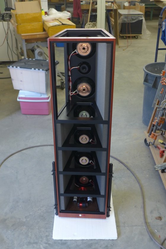

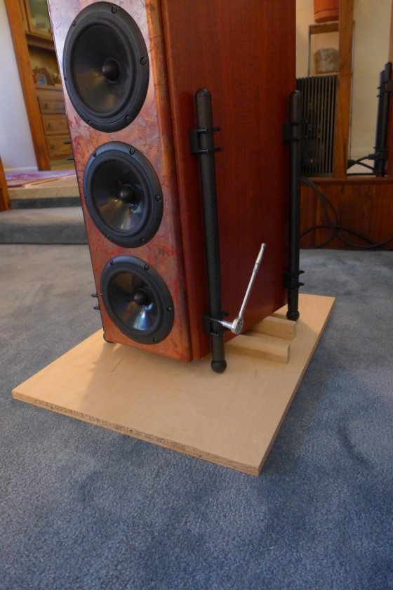

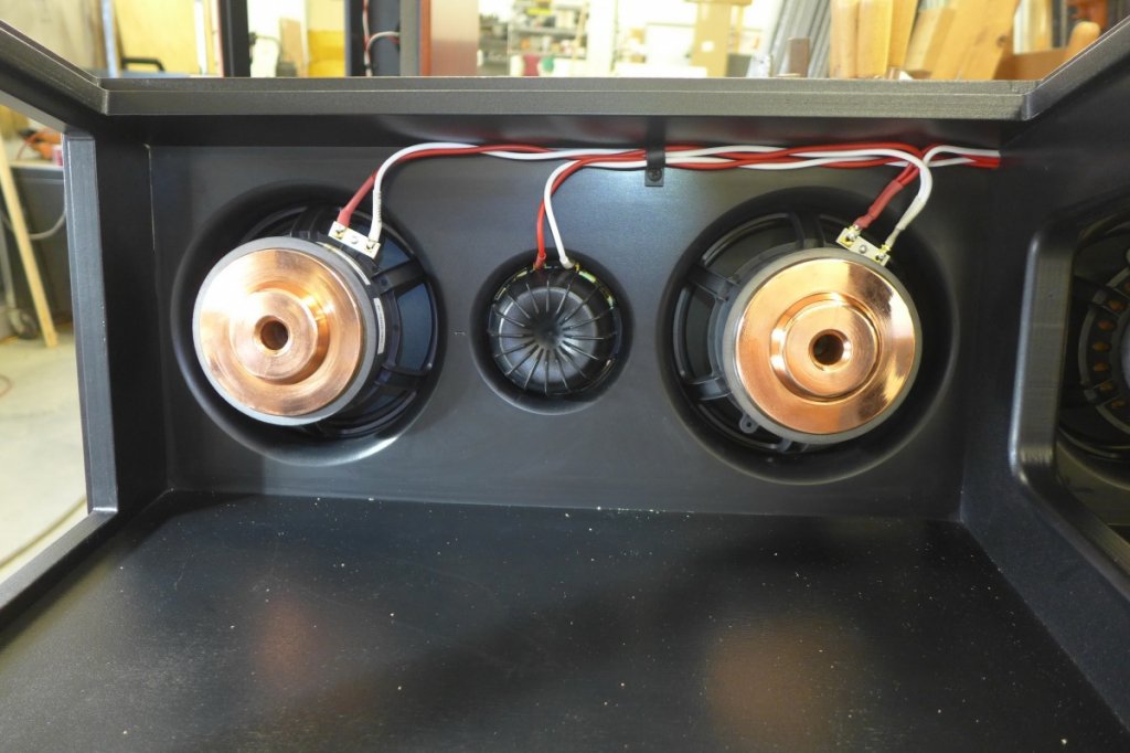

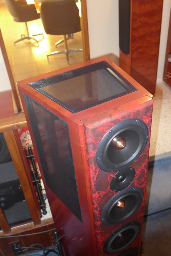

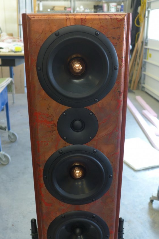

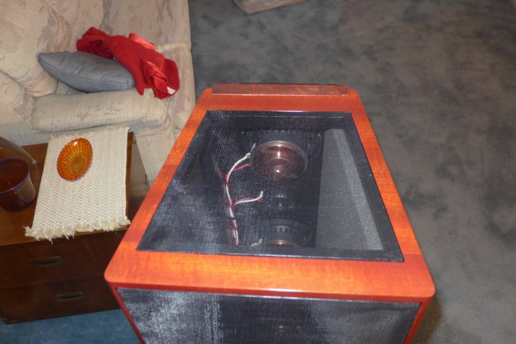

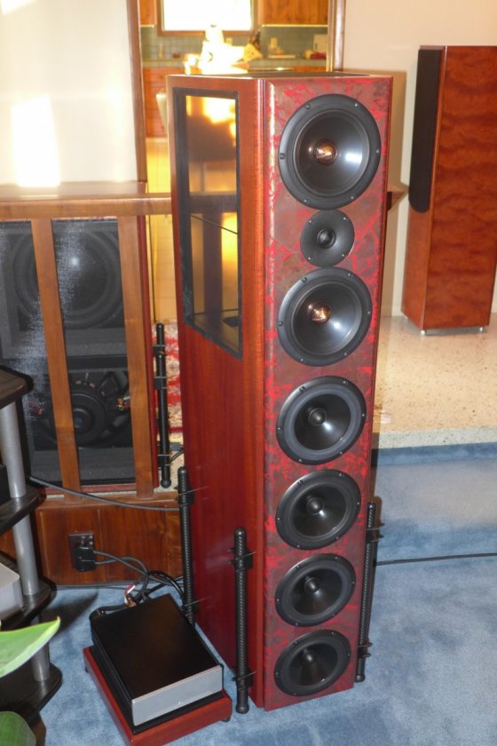

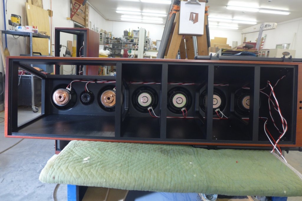

This build thread is nearing it's end because....well, because they're done and breaking in!
Doing the wiring. I'd make the holes for the MTM section a little bigger next time. It was tight but I was determined...
No-Rez installed
Close up of MTM section
Adjusted the "landing gear" to accommodate the sink-into-carpet effect
Grills on, then off, then stored
Now I get to clean the shop...

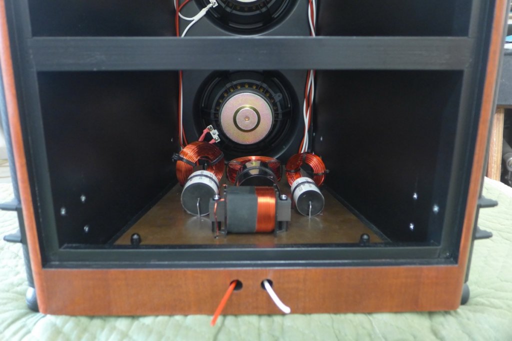

WOW Peter, not much more to say.  The choices you made throughout the build along with your execution, really amazing.  Fantastic final product.  Love the magnetic grill holder on the side, very clever.
Looking forward to your thoughts on the sound.
Question regarding the crossover, I assumed the lower M165s to the M165NQs crossover would be the same as the NX Ottica, however I don't see a bank of caps that I believe are in the NQ portion of the crossover, do the two speakers differ or did you use a higher value cap?
Congrats on a great build,
Ed
Ed,
It looks like Peter used the single 100uF cap (big black cap between the Sonicaps) that is standard. The four 25uF Sonicaps is an upgrade.

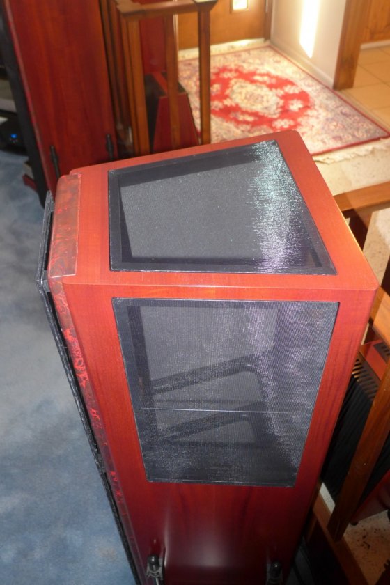

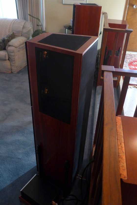

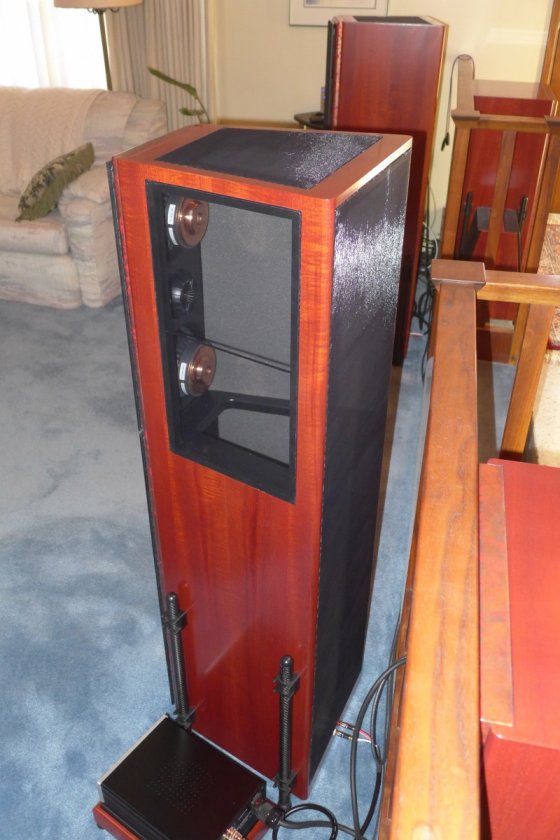

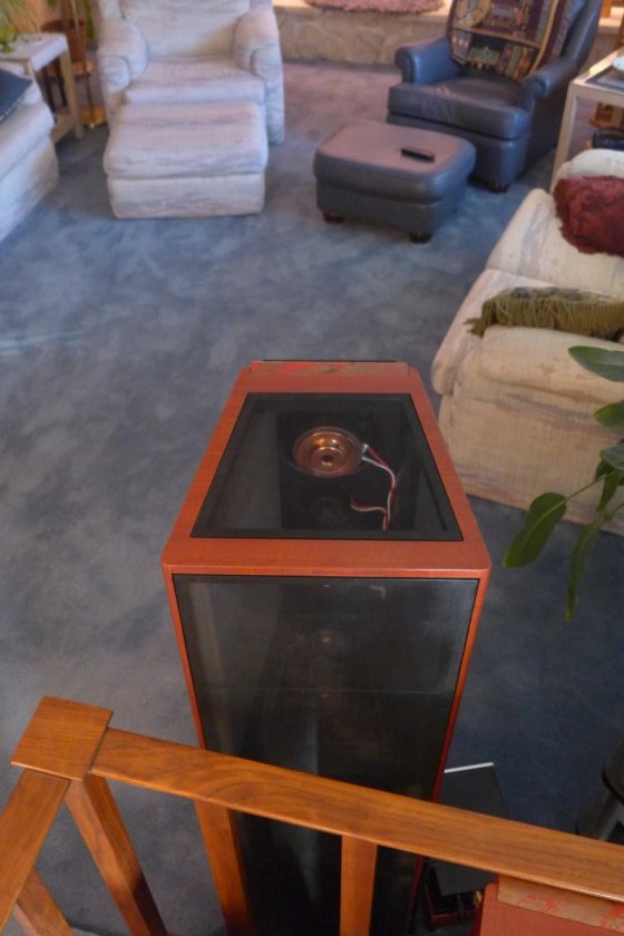

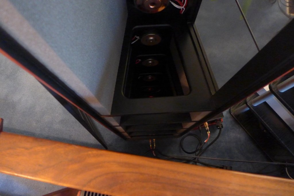

nik.d
Re: ***X-Otica Main & Sub Build***
« Reply #237 on: 11 Oct 2016, 10:49 am »

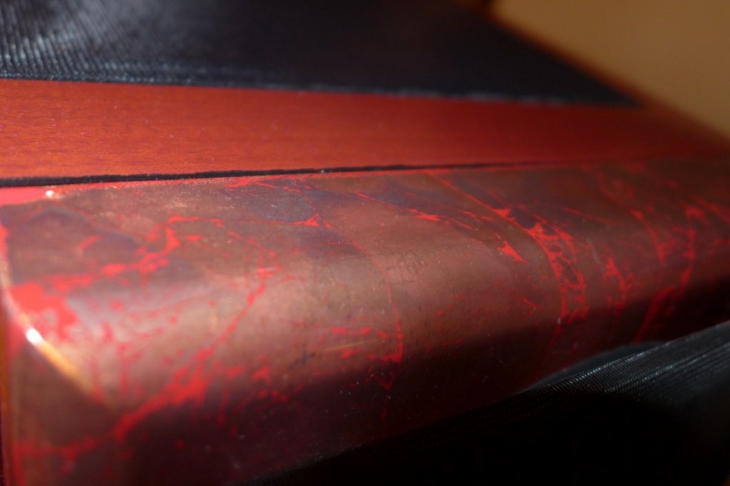

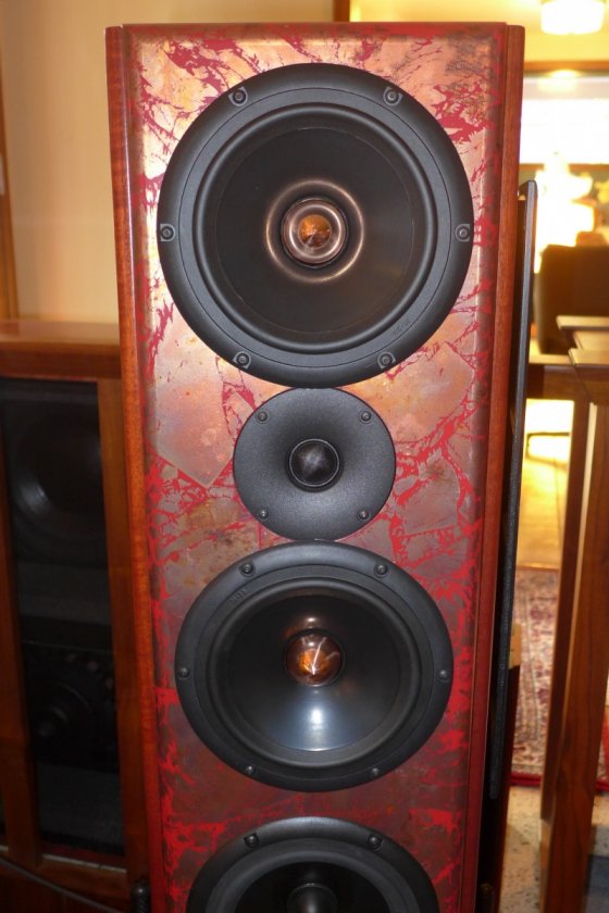

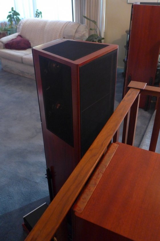

Hey Peter,
Few more close-up photos with grills on would be nice. You took a lot of effort (& thinking) in constructing them, they should be seen to.
Perhaps top and side view fm outside and front, top poar. Close-up of NoRes at back (to point out the 10deg. angle) etc.
Thanks in adv!

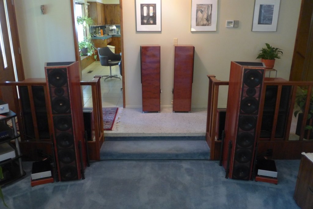

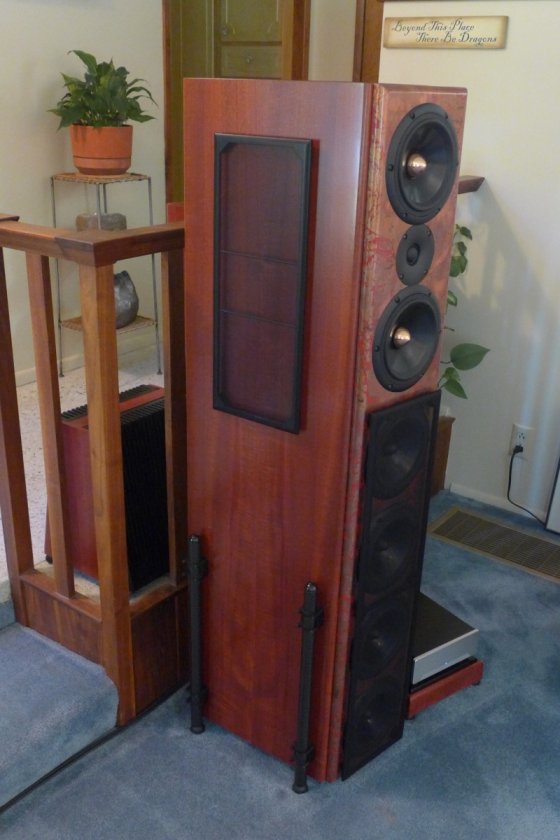

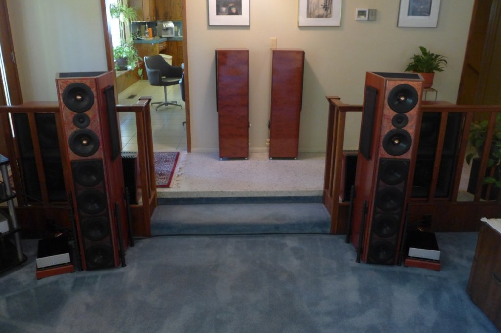

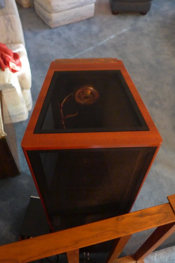

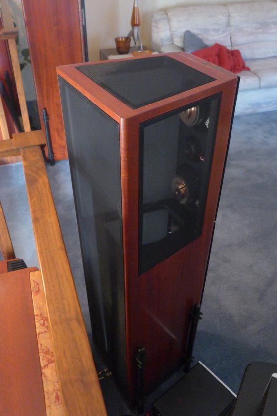

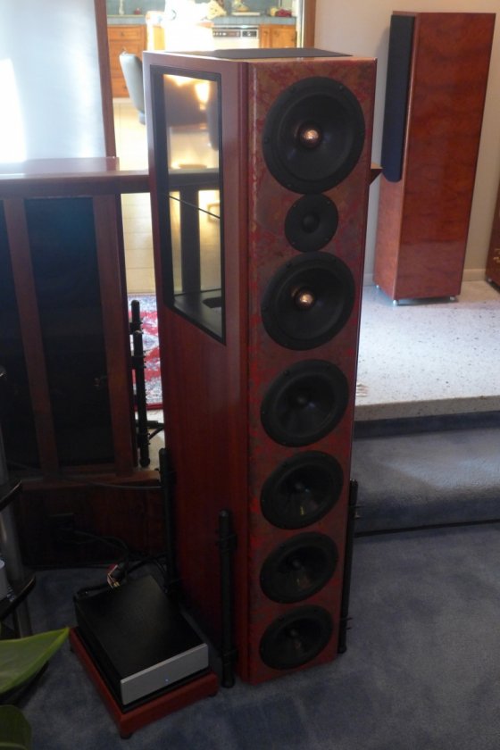

Here ya go, Nik. Some with flash, some without. Flash tends to wash out what eyeballs actually see but highlights other things. I imagine bounce flash would be best, but don't have the capability.
In real life and ambient light the grills came out just like I envisioned. You can glimpse the inside but it's not upstaging the exterior. Another interesting thing is it's got some sheen which mimics wood finish sheen...a happy accident I didn't really anticipate.
Better photographer could net better photos, I suppose, but I try!
