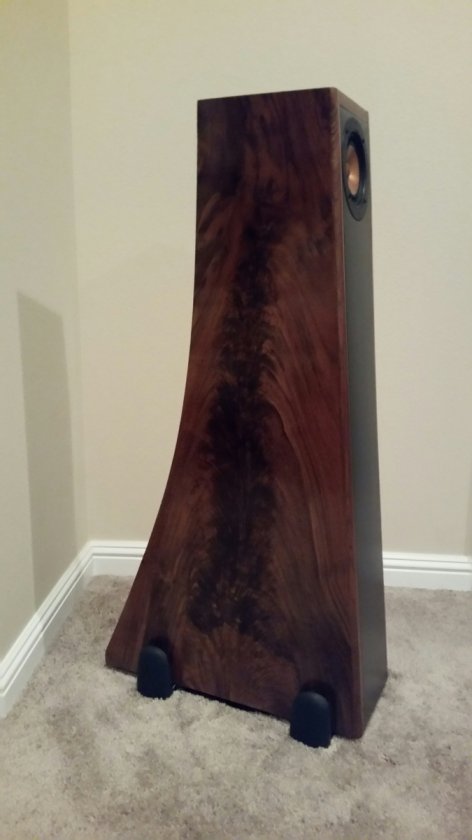

Hi Peter,
Suggestion if I may. No need for front 'legs', at least not for X-Otica Main's. Much more elegant look would be with something like 'Q Acoustics 3050' speakers.
Here's a few photo's and some of my 'editing' (thought it will be quicker on photo but now I see I could easy draw it in SketchUp..)
From back, original & my quick editing:
Leg's inner sides front to back must be angled following X-Otica's trapezoidal shape. Spheres instead spikes, if that's your preference. Hope you like it.

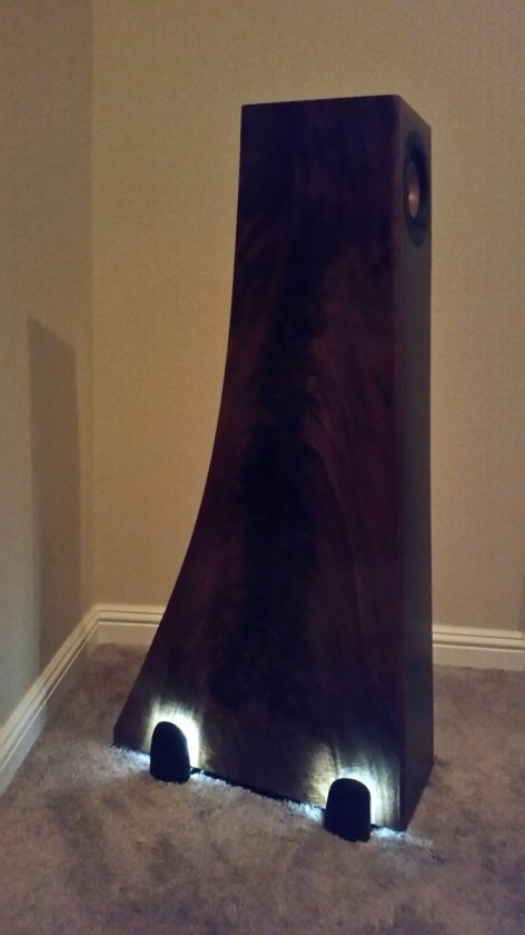

Ok, I created a little mock-up of what a "sconce" with LED's COULD look like built-in to your outriggers. Of course, the sconces could be square'ish instead of the rounded ones in my mock-up, if desired.   Oh blast, I just remembered I was going to add spheres to the outrigger mock-up for legs, but forgot!
Here is how it might look during the day...
And might look like this in the evening...
Hmmmm...I think it would look better with a bit more focused beam aimed vertically up the side.

Hi Peter,
George
Thanks for taking the time to draw that. I considered similar but I'm kinda hung up on symmetry front to back and pretty sure I'm going with the kinda industrial look of the tube leg and clamp arrangement. Who knows though, I may change my mind! Wouldn't be the first time.
Pete
I'm thinkin...
Probably won't be on these, but some day I'm gonna get LEDs on a speaker.

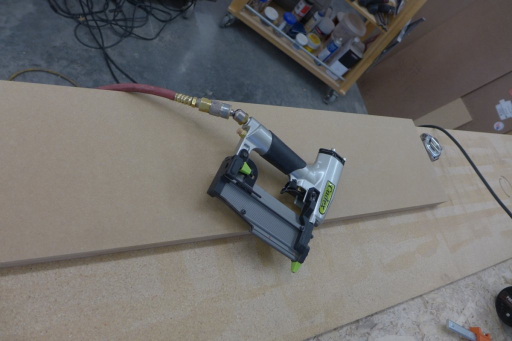

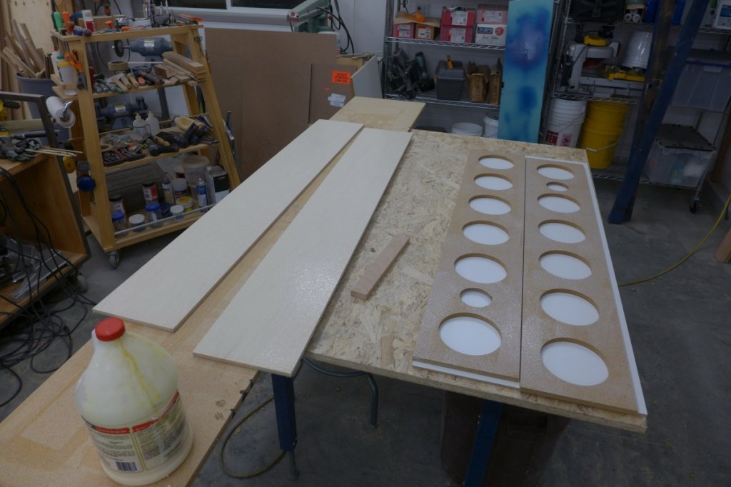

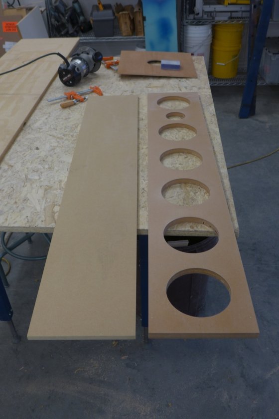

I'm gettin' going on the main baffles. Some of this will be rehash of prior projects, but some will be unique to this project or perhaps new technique.
When I built the protos, I made a "master baffle". Sounds almost sinister, huh?  Anyway it's a template I could use later if things worked out on Danny's end. And they did!
Here's baffle pattern and first victim
I pinned them together

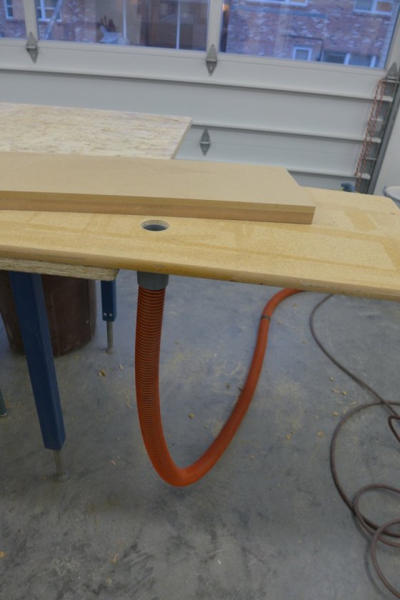

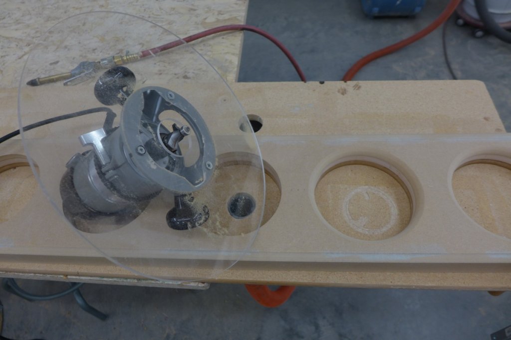

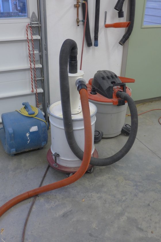

It's winter and cold outside. I strongly dislike, possibly hate, the dust MDF makes when machining, so I rigged this up
Other end
So I could do this mostly dust free...woo-hoo!

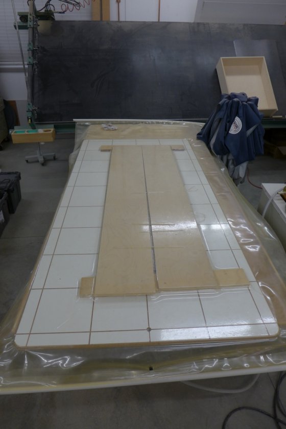

 I decided to make speakers like layer cake :o

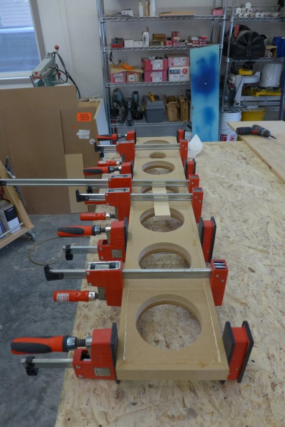

Gluing up the "cake"
Flush trimmed second and third layer individually using the Dust Deputy same as before
Some holes next, but I'm going to post in case the sky falls on the internet

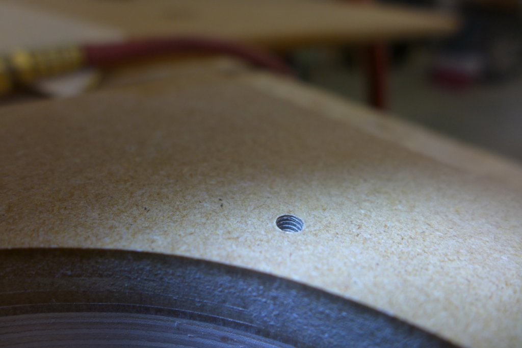

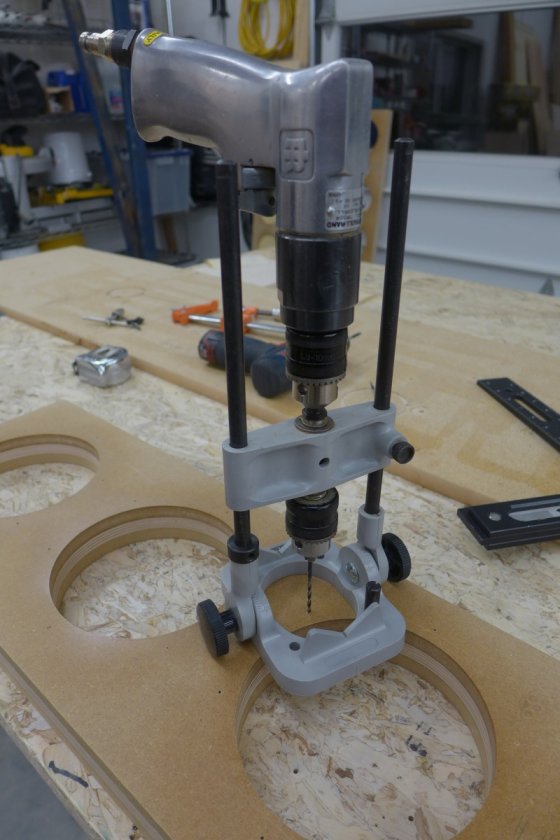

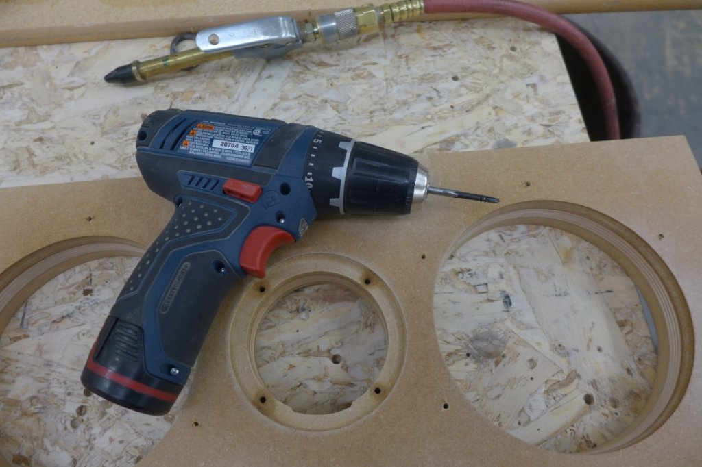

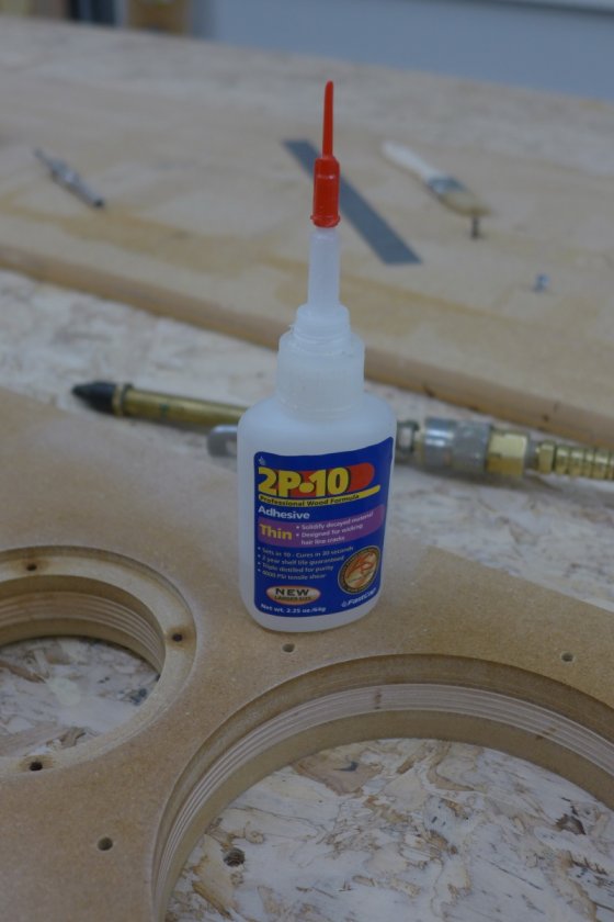

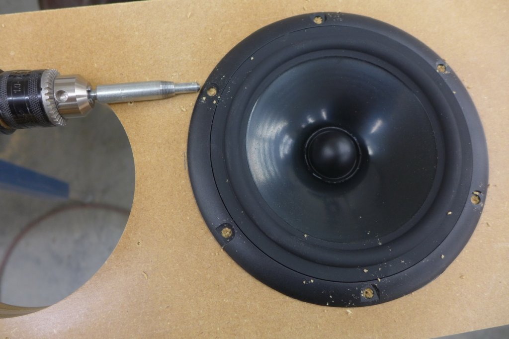

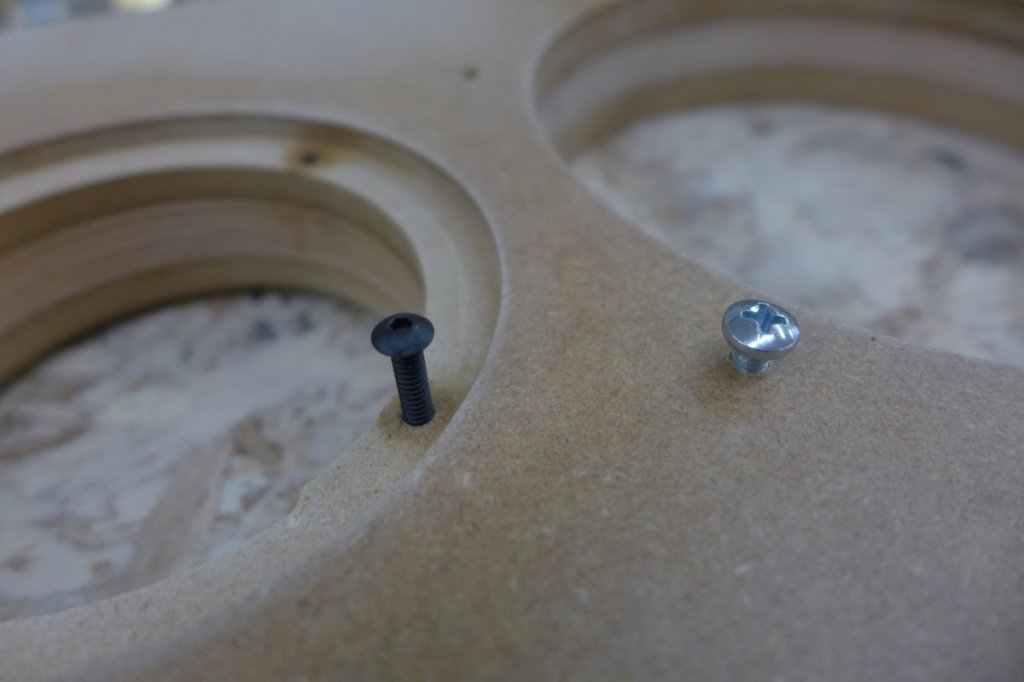

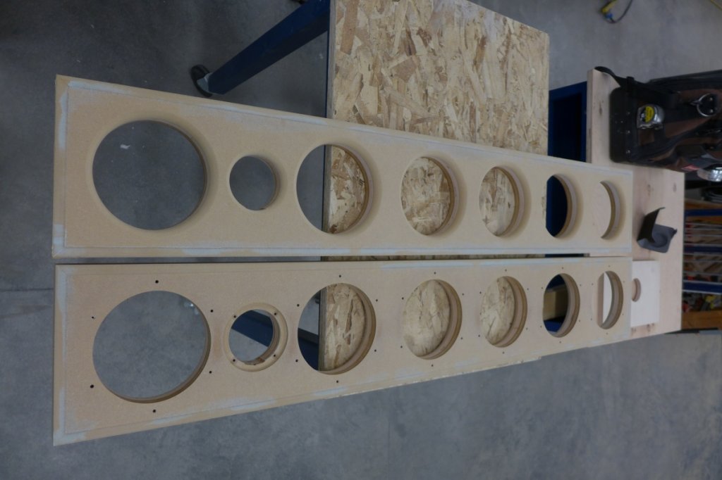

I'm pretty fussy about how I mount drivers, (some would say anal). I've tried t-nuts, wood screws into MDF, nut and bolt and I'm sure some others. Like the look of button head machine screws, but really don't like t-nuts so I've used this several times now with success.
Centering bit for hole location
Gettin' holes perpendicular

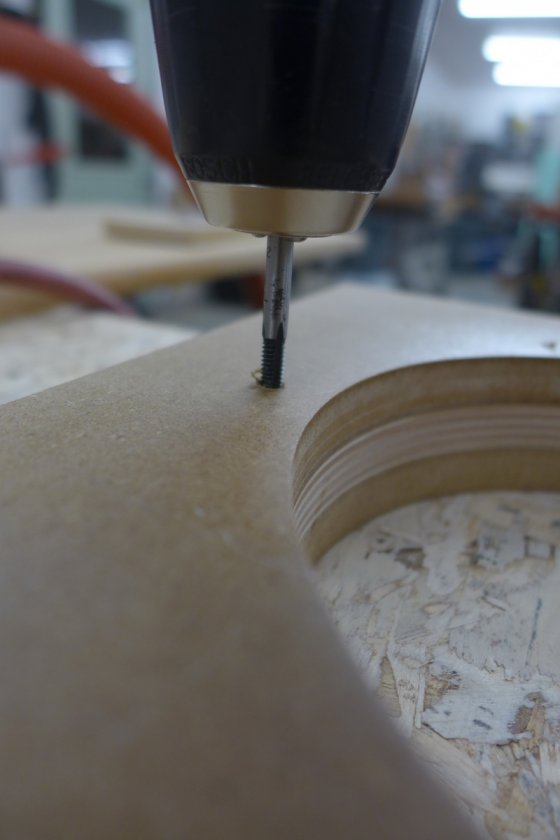

Here comes the crazy part. Who knew you could tap MDF? ( also part of the reason for layer cake)
Drip in some Cyanoacrylate (how's that for ostentation?). It's super glue
Let it dry overnight, run tap again to clean up. Slow and gentle.
Baffles were cut oversize so they were easier to work, but didn't want the BB core on the edge so I trimmed and banded perimeter
Round over on the backs using my "mega base" and the vacuum setup from earlier
Here's where we stand now
Next puzzle will be grill frames, stay tuned!
« Last Edit: 20 Jan 2016, 02:06 pm by Peter J »

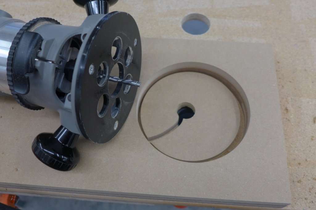

Studying your picture using Dust Deputy to see how you're pulling in the dust when using the router to cut circles. Can't quite see how you're doing it... are you locating the pick-up port directly under the router when you're cutting circles?
You got it. I didn't really want to hack my bench, so I cut hole in the particle board big enough for vac hose, and clamped it all to bench. I had to cut each hole individually but it was worth the time...very little dust...amazingly little. Dust deputy is a jewel.
Here's the before pic, just before routing

I'm not big on T-nuts either. But that looks like a lot of work...  :scratch:
Have you tried Hurricane or Barbed?
Peter J
  • Posts: 1964
  • Hmmmm
Re: ***X-Otica Main & Sub Build***
« Reply #38 on: 20 Jan 2016, 12:27 pm »
Is there any concern over the different woods expanding/contracting at different rates ?  I suppose if everything is sealed up perfectly it shouldn't be an issue but it seems to me this  same issue has been disucssed  previously  :scratch:
jay
If there was solid lumber in the mix, I'd be more concerned. The Rhythms are about 15 years old and if the light is just right, I can sometimes glimpse the glue line under the veneer. So From a structural standpoint, I really don't have concerns. Visually, I wanted the glue line on face rather than edge. It will be harder to see close to the baffle roundover and behind grill the majority of the time.
Peter J
  • Posts: 1964
  • Hmmmm
« Reply #39 on: 20 Jan 2016, 12:54 pm »
I have used various inserts over the years. My concern in this case would be visibility because they would have to be face mounted and the driver flange doesn't cover a lot.
I imagine I spent a couple of hours additional time on driver mounting holes over just using tapping screws. Speed is why I chucked the tap into drill. I suppose the time spent on this project doesn't concern me much because it's for me and I enjoy it. I also like exploring new techniques. Trust me, my OCD hasn't really surfaced yet! It all started with me wanting a particular look on mounting screw heads and then figuring out how to make that work.
FWIW, I've used the Superglue technique on holes for self tapping screws as well. What I like is how it consolidates and hardens MDF fibers. Two or three in and outs on raw MDF and there's just not much grab left.  Try it!
