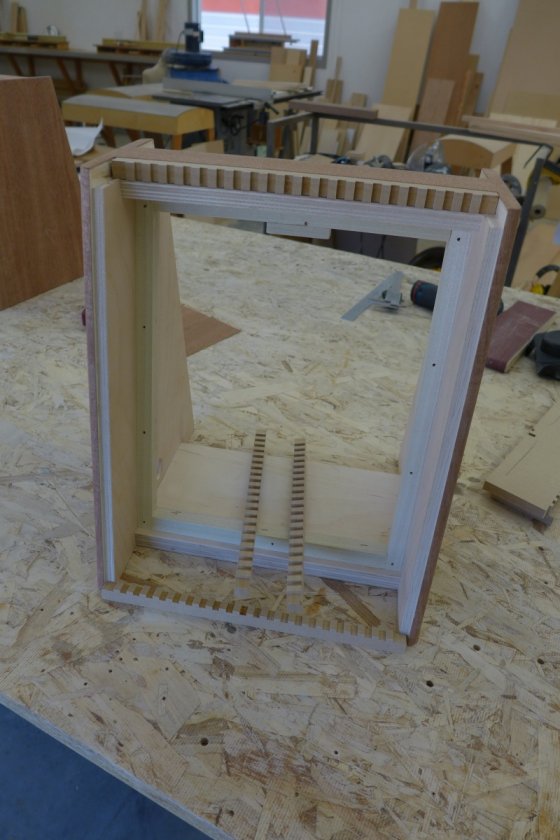

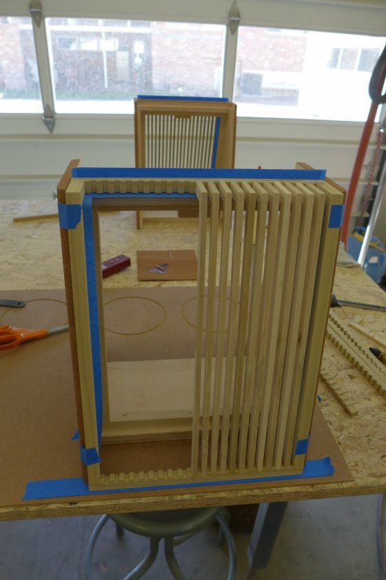

This week's installment is about the age old dilemma of designers vs. builders. But I'm both in this case, so I'll go stare in the mirror and swear at the designer for his apparent callousness in not considering how this will get built. Problem is, I liked the looks so I didn't bring it up to him earlier and just pressed on...

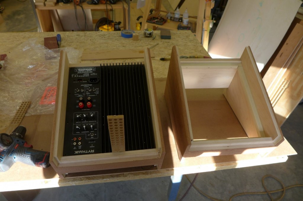

Amp boxes went as planned mostly...
Then came the grills. I wrestled with how to do this and even started down one path only to stop midstream and hatch another game plan.

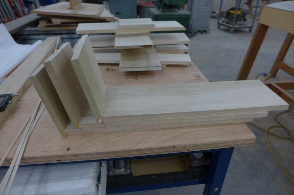

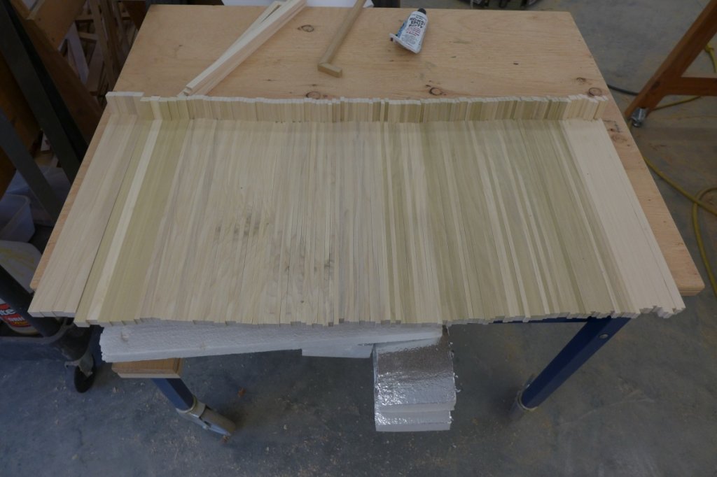

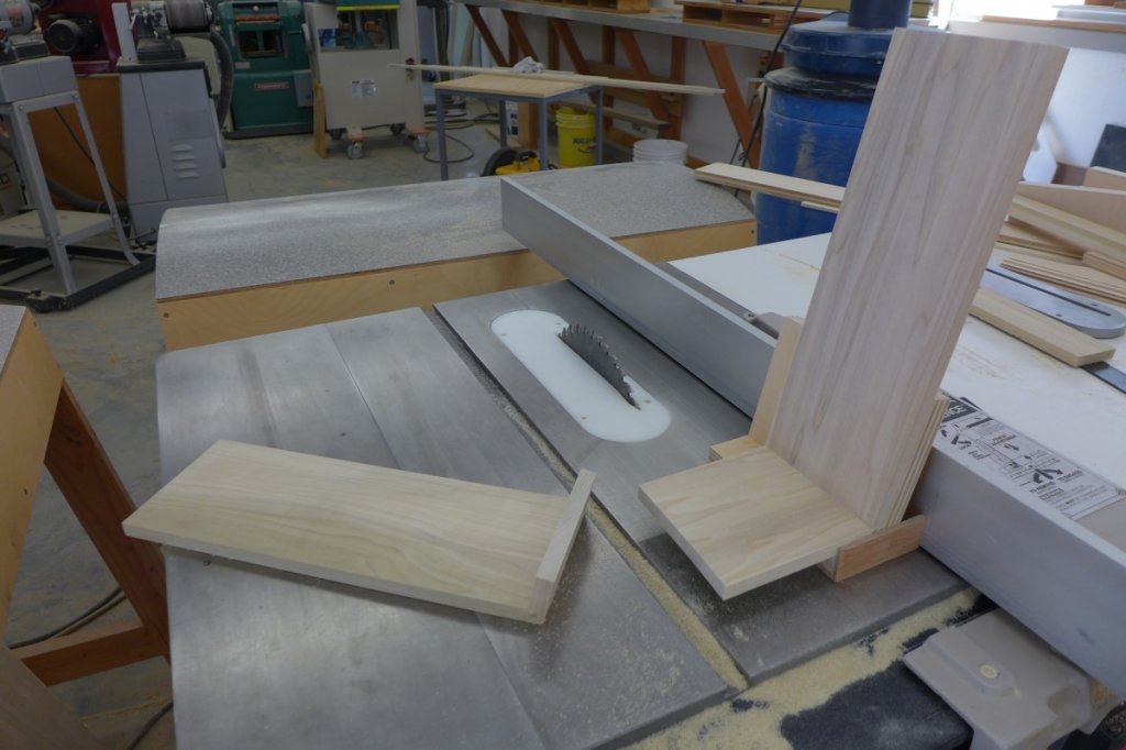

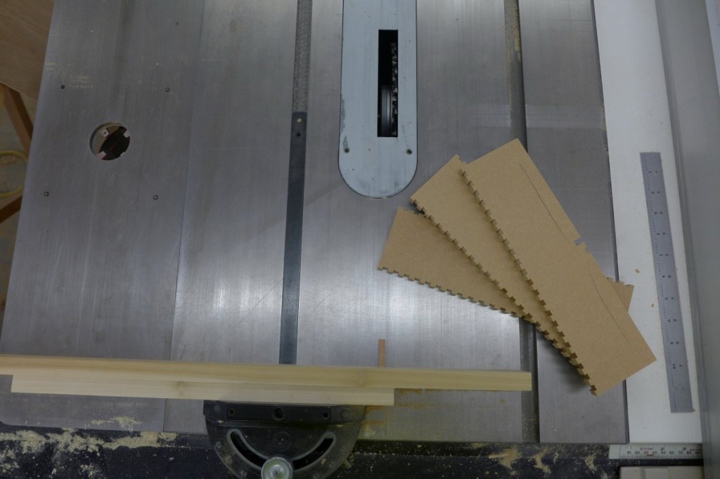

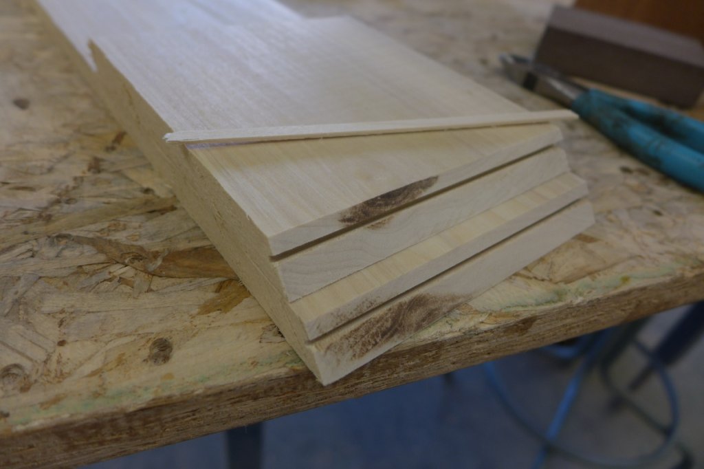

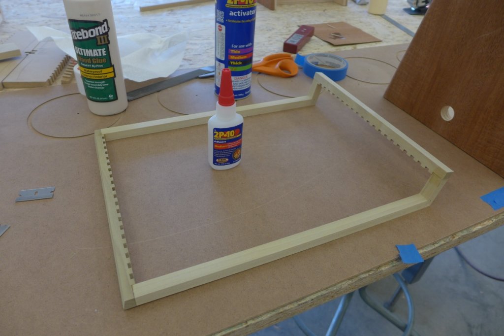

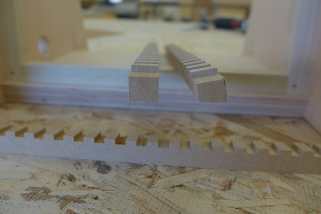

Dados...,many dados. Easier to cut them in bigger blanks and cut down later. Look closely at miter gauge fence and you'll spot my jig for getting consistent spacing

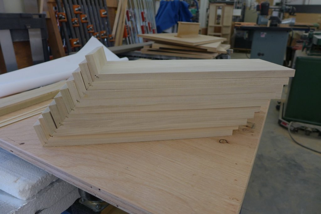

Was gonna do the whole thing in MDF. Thought I'd make a pattern and rout all eighty :o, yes, 80 bars/slats. Then the winds of change blew in and I nixed the MDF in favor of Poplar. At least I had the setup figured out so not too bad in the overall scope of the forever build.

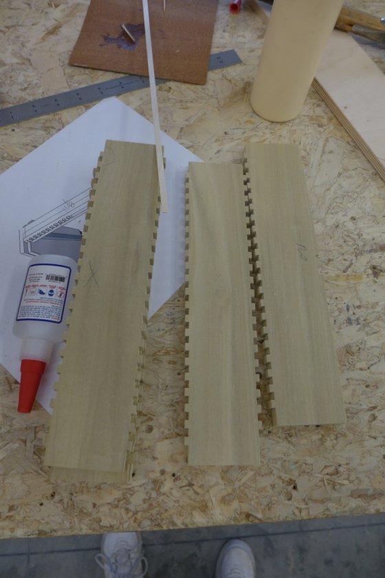

Glued up some blanks
To end up with these
Then trimmed to dimension
To end up with these...is there an echo in here?

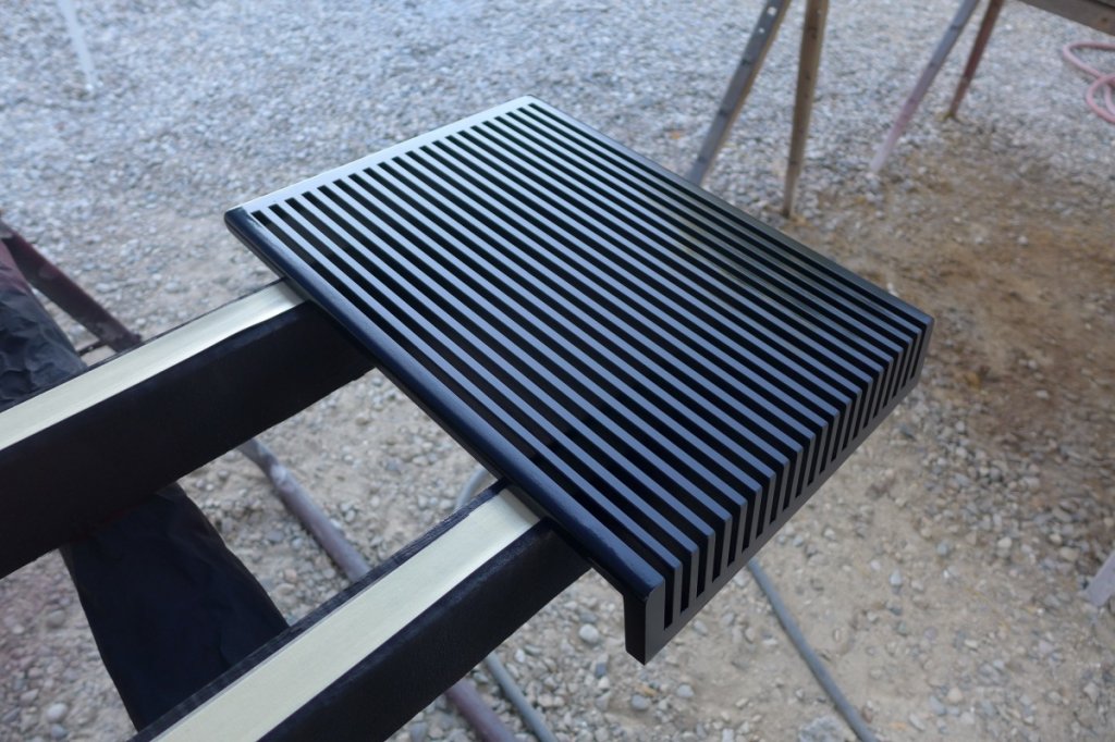

Then lots of slicing to finish with these. Well over 100 figuring some would be wonky...and they were
Then comes the tedium, but I gotta say I'm jazzed with the result, even did a little dance. Is that TMI?

Inching closer to the finish line. If I were competing in a speaker build-off, I think I can safely say I'd win the DLBF award. (Dead Last But Finished)

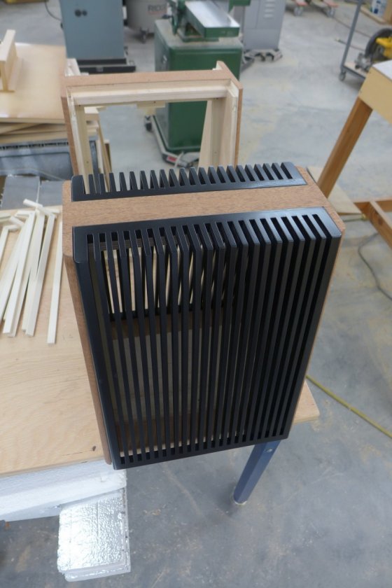

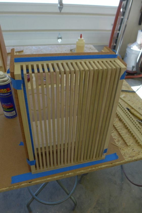

Got the amp cage grills finished
Magnets retain them, gotta love those Neo magnets

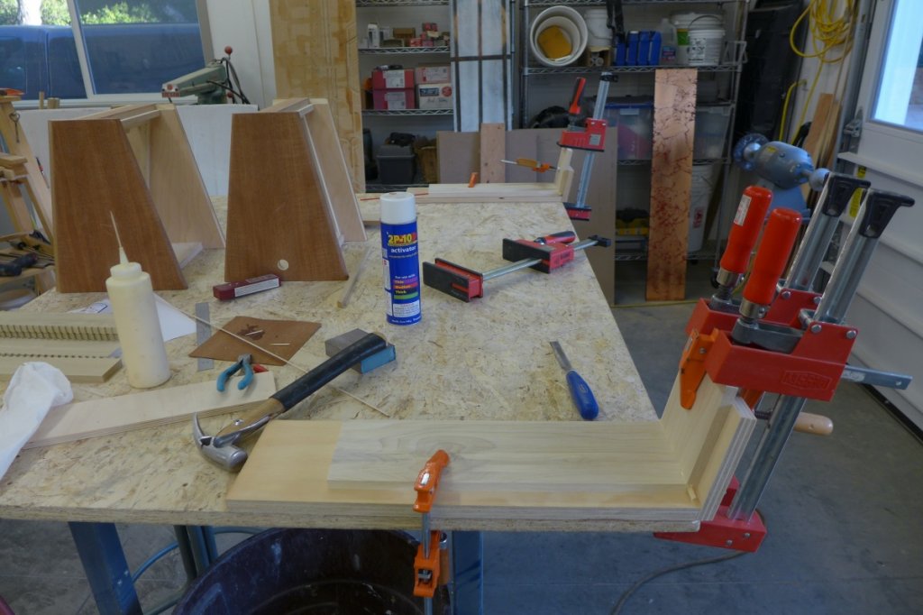

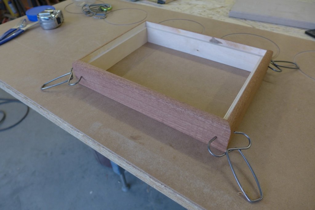

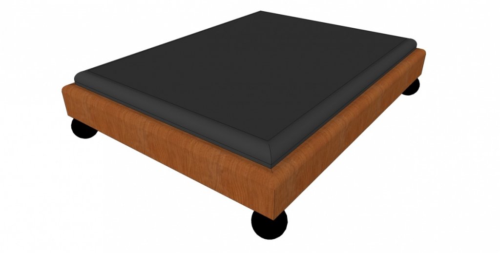

Moving on to amp bases. Want to get all the mahogany stuff done so I can finish at same time

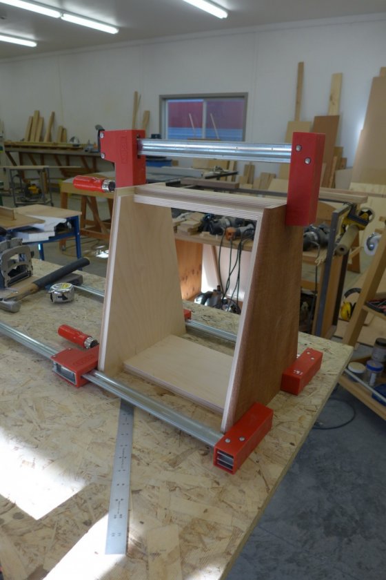

My initial idea

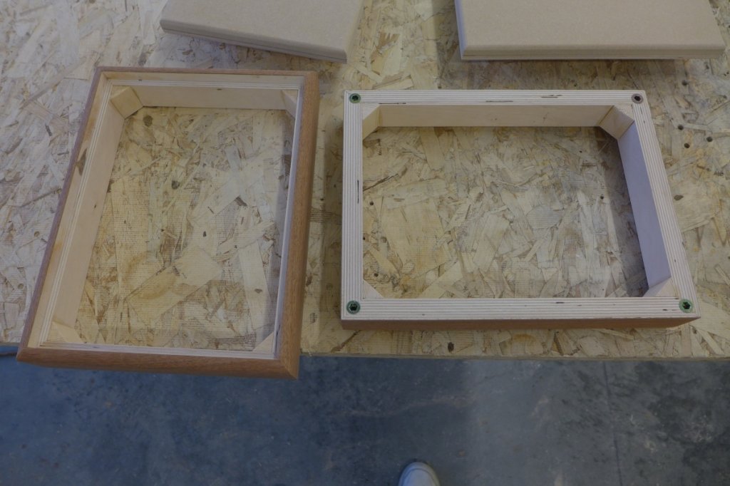

Changed things just a little. I Heatlocked some veneer onto Baltic birch for perimeter frame.
 Gluing up

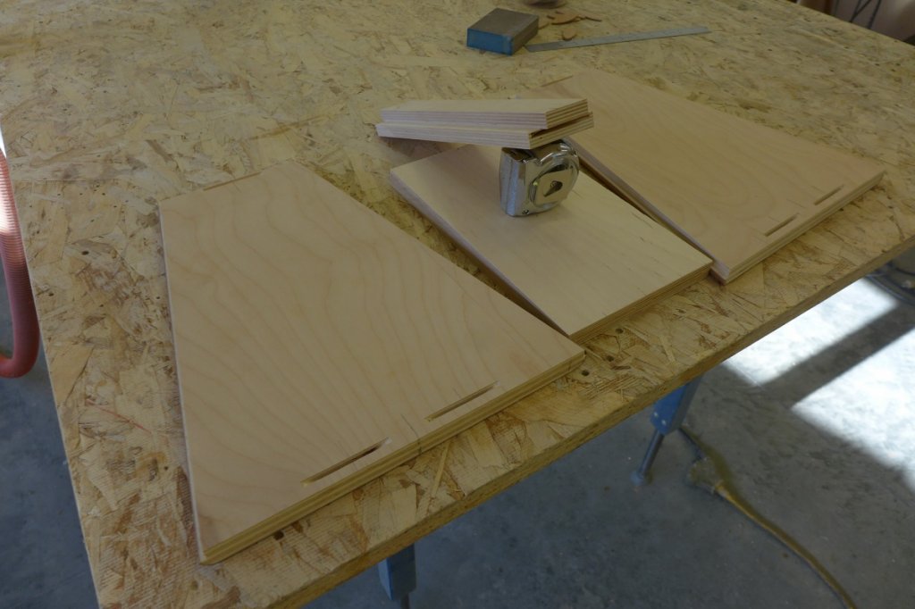

Installed threaded inserts for balls

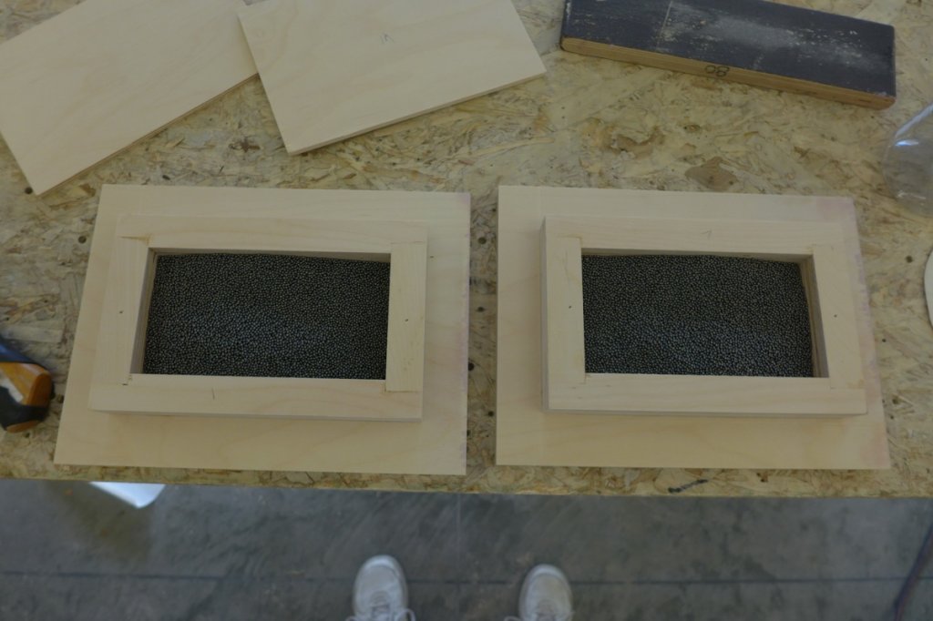

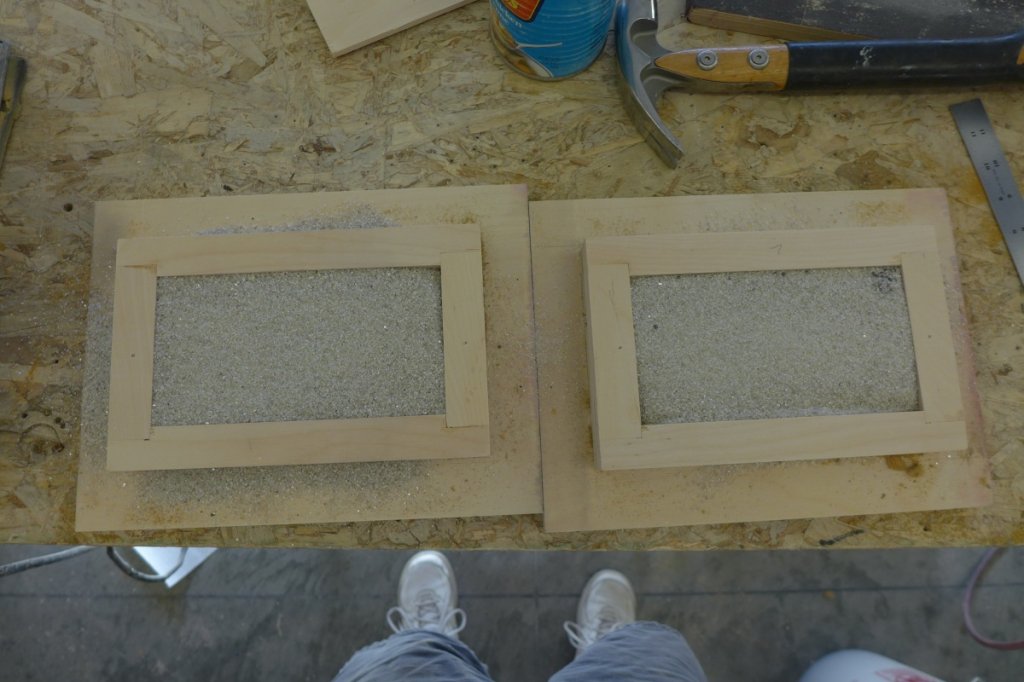

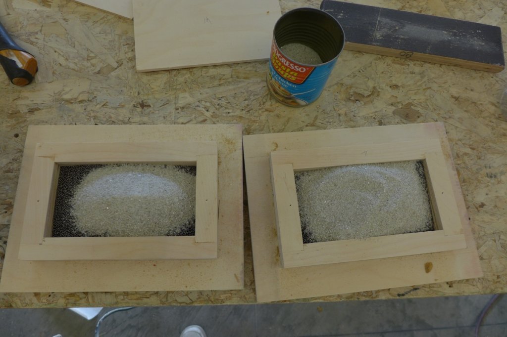

Now for the inserts. I laminated 1/4" Baltic Birch to 1/2" MDF so it's like the rest of the madness. But then I thought " hmmm, needs some fairy dust to give it that high-end cachet".
Glued up fairy dust boxes to attach to bottom of inserts
After gluing onto bottom of insert, I dumped two different sizes of lead shot into them. This will provide differential spherical damping effect
Then a careful dose of potent white sand collected from the beaches of western New Zealand. This stuff is spendy but worth it. It will drain away the stresses of the lamination and enhance spatial perception
Look closely at the above photo. See that brown fluffy looking stuff? That's the actual fairy dust. It's a special plant that I grow and dry right here in the basement and crush with a magic mortar and pestle. This is what it looks like before drying

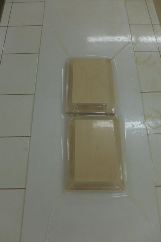

Once filled with the special ingredients, I entombed it with the vacuum press

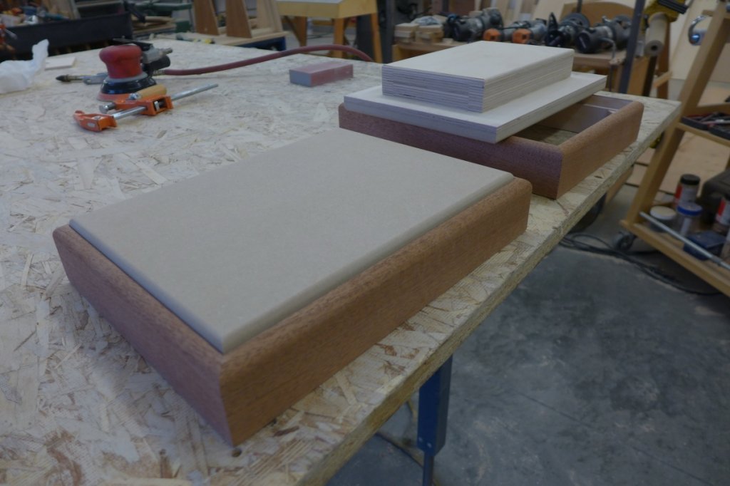

Flushed trimmed and sanded the "dust box". The inserts will be finished like the grills and be supported on silicone rubber glazing tape attached to ledge on frame. Amps will be happy.

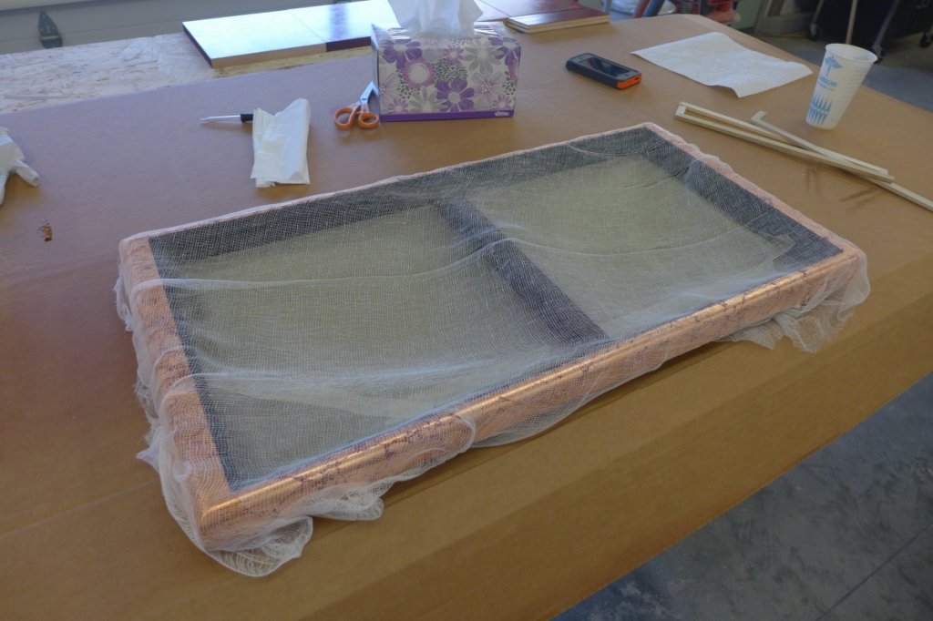

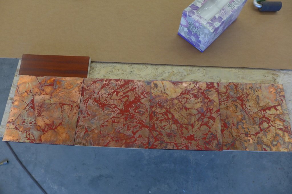

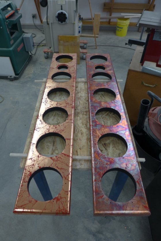

I ignored work I should have been doing today, and did this 'cuz I was excited about it. Probably my favorite part of the build, although listening will be pretty cool, too.
 I'll pay my penance tomorrow.

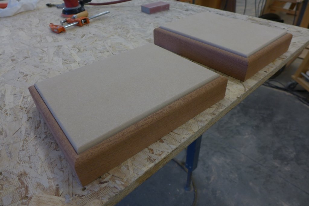

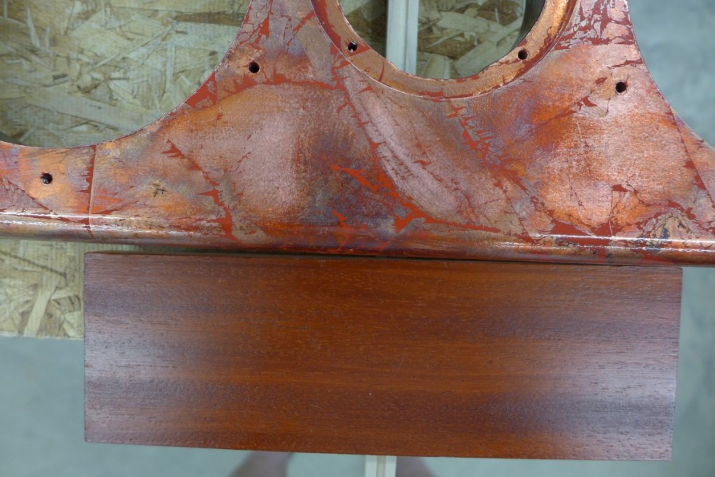

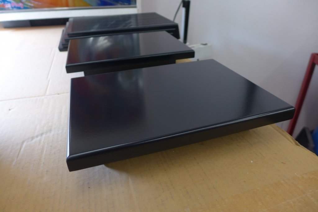

I sprayed the amp base inserts

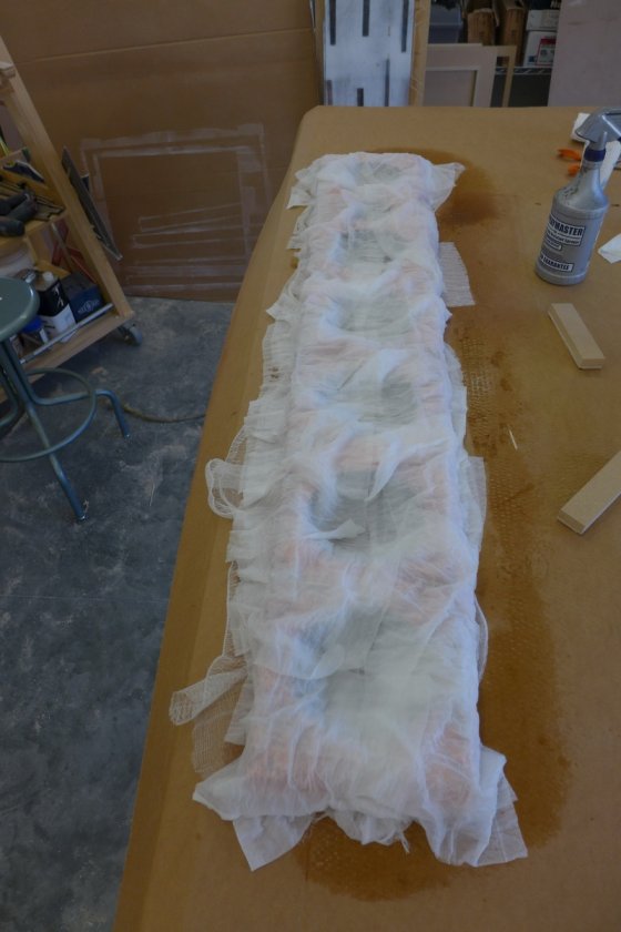

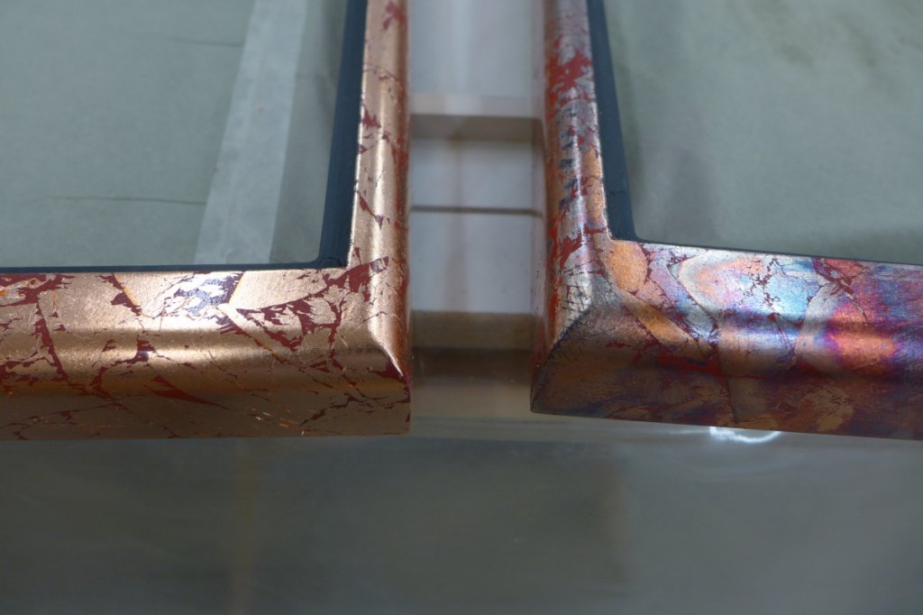

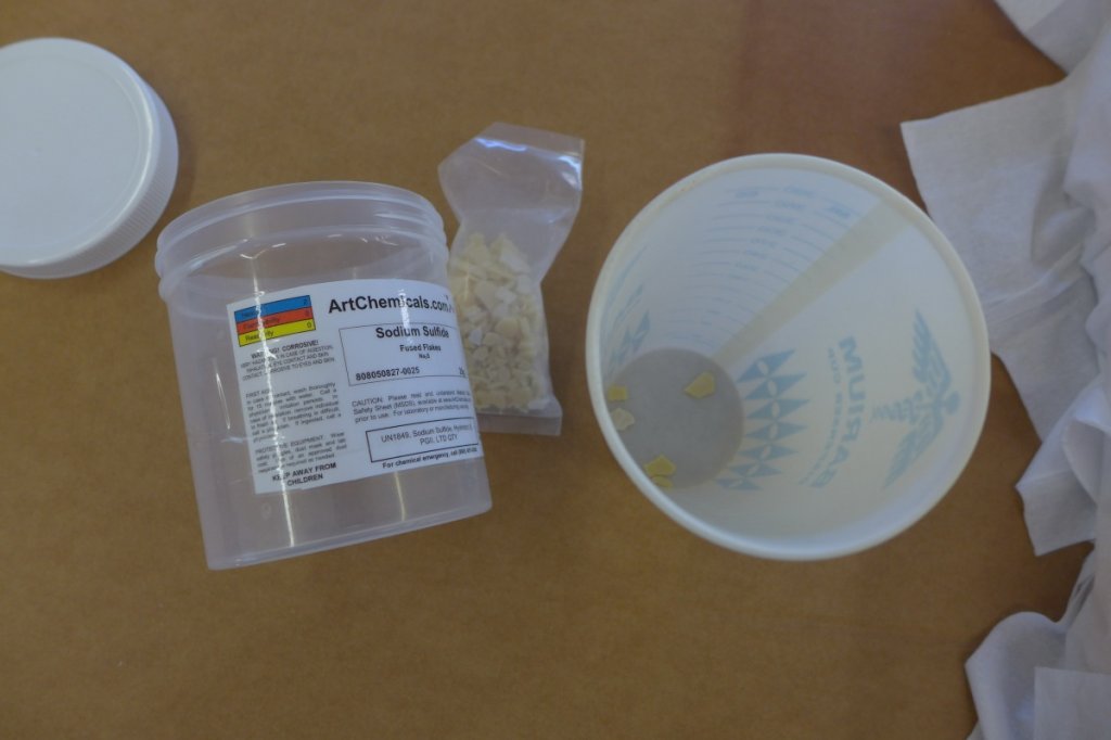

And then the chemist in me got to come out and play

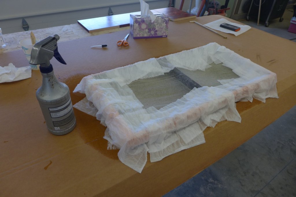

Made yet more samples.  I suppose I've been all over with this part, but landed on something that would stand out.

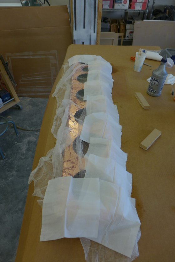

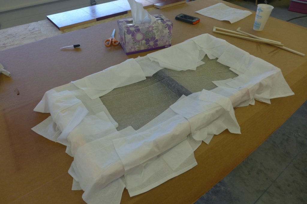

Cheesecloth first
Then tissue

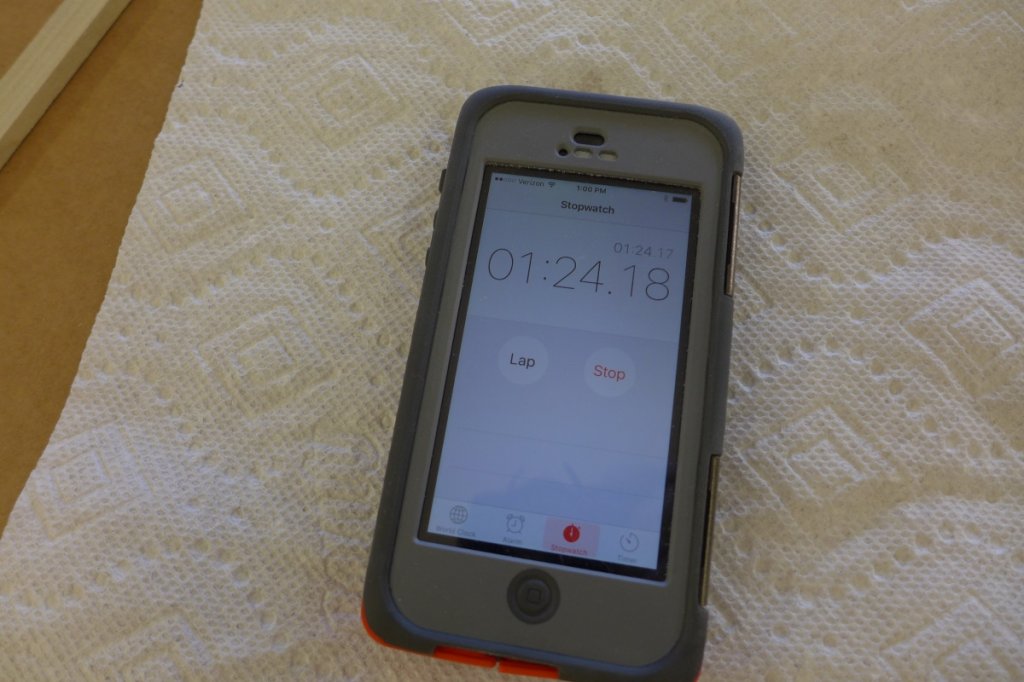

Wet down with Sodium Sulfate solution
Four minutes go by
Comes out looking a little different, no? Before and after

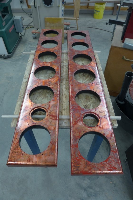

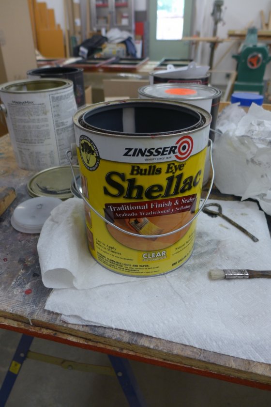

After the sub frames I did the mains baffle

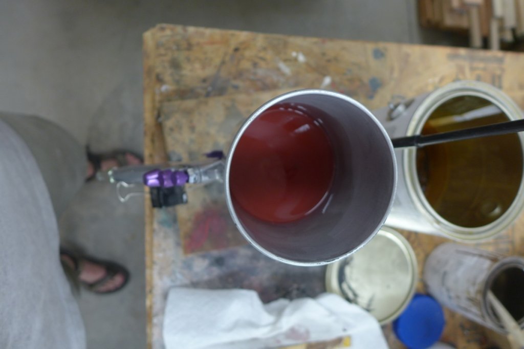

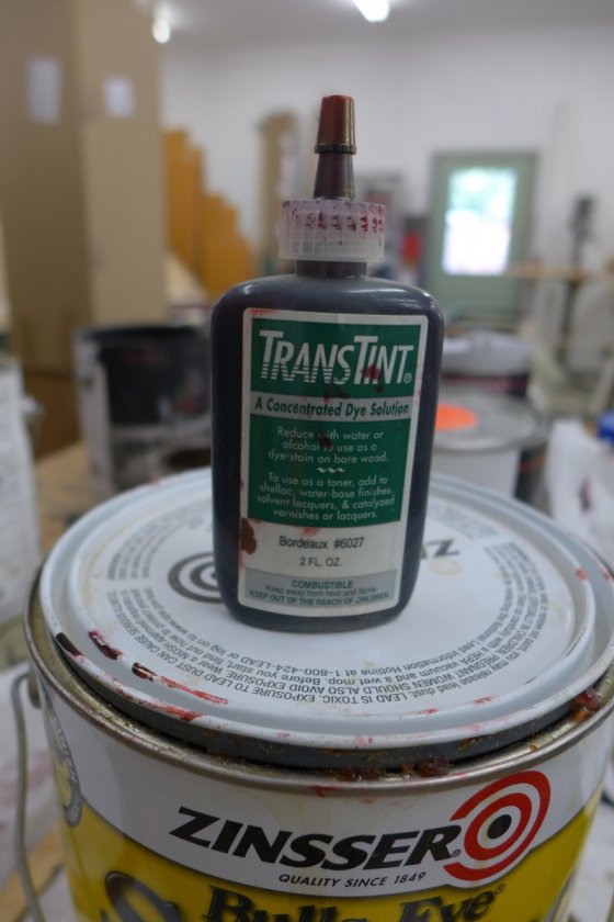

I use shellac as a barrier coat. The gilding size doesn't always play well with solvent based stuff I'll be finishing with
Added some Transtint
Tone coat in cup. It looks like a lot, but when sprayed out, the effect is subtle
Here's where they stand now. The overall effect will be toned down somewhat by drivers, grills and subsequent finishing steps. All in good time...
« Last Edit: 14 Aug 2016, 12:50 am by Peter J »
