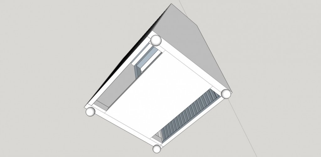

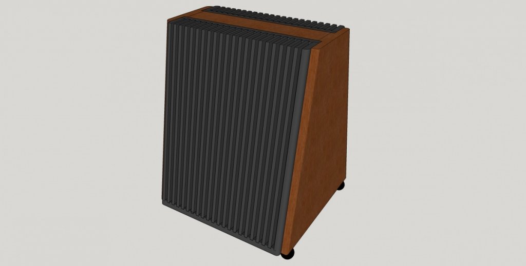

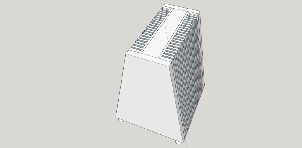

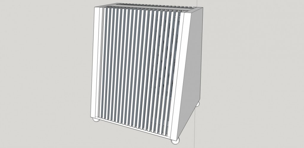

Soooooo, ideas and pictures you say?
Today I made not one single particle of sawdust, but did spend some of the day forking around with ideas for amp boxes. For whatever reason, I have a hard time loving the mental image of the plate amps on their backs with wires sticking up sitting next to the Magnum Opuses (Opusi?) in all their imagined glory. I'm thinkin' something more refined, but am limited by the amp itself.
This is where I'm currently headed, perhaps with some changes, but generally kinda the same...how's that for vague? Input and power wiring would enter/exit bottom, output and sensing wires will exit side via female Speakon connectors much like the subs themselves. Grills would be magnetic at least on front for access, amp would screw to flange you see inside.
Easier to draw than make me thinks....something more to ponder.

I like it. Would there be sufficient clearance for a really thick power cord to run underneath?
I would definitely be interested in purchasing better amp boxes. Mine are lying flat on the floor behind the speakers with power and input cables sticking upwards. That's not pretty.

« Reply #144 on: 27 Jun 2016, 07:09 am »
I'm not sure about that, only about 1 1/2" of space from front of amp to back of grill as drawn. I'm figuring on making my own cords for this very reason. Will use right angle plugs.
https://www.parts-express.com/marinco-320iec15-iec-power-connector-15a-120v--110-400
http://www.soniccraft.com/product_info.php/marinco-15ra-right-angle-adapter-p-1626?osCsid=67b35cee24fa6969204d2b83cc1e48b2

LOVE it! Looks like the Wavestream Kinetics V8 amplifier that George Cardas has in his home system. Each mono amp has a line of four tubes sticking out horizontally from either side, looking like a V-8 engine, hence it's name.

Love it!
Using Pangea 9awg cable with my HX800 amps and they are big!   :o

Really cool idea Peter, I like them a lot. I guess I don't mind my amps in the boxes Ruben built, definitely a conversation piece.
Your grills look great and I like the idea of them standing up, kind of like my ipad mini in its stand up case.

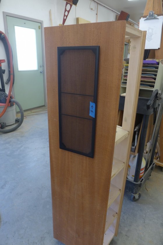

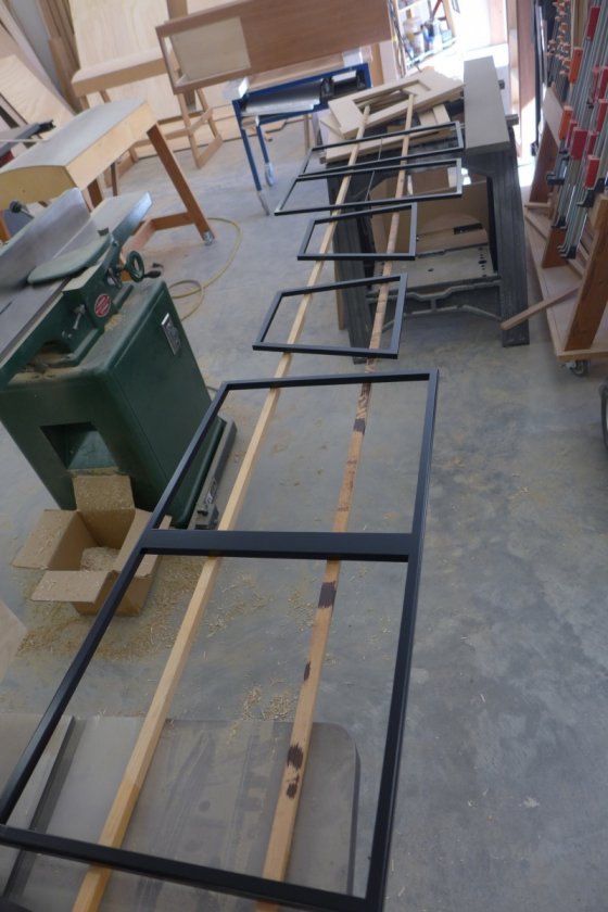

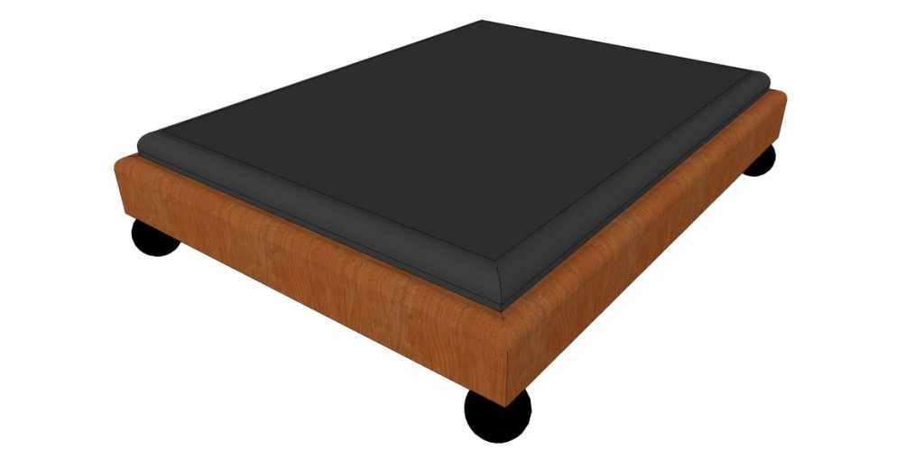

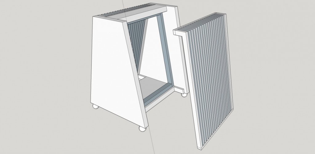

Futzed around with the details and think I got where I want to be on the amp house
And to complete the ensemble, matching amp bases

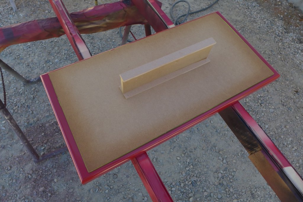

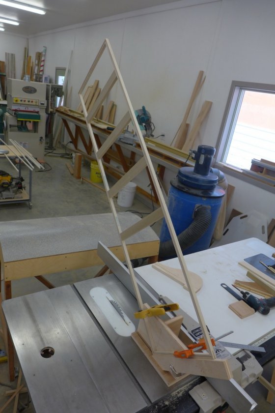

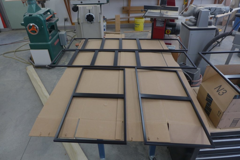

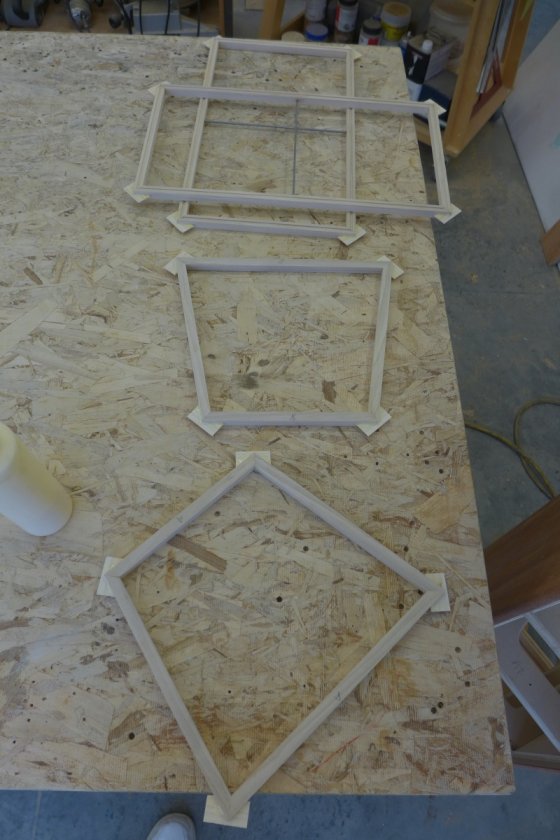

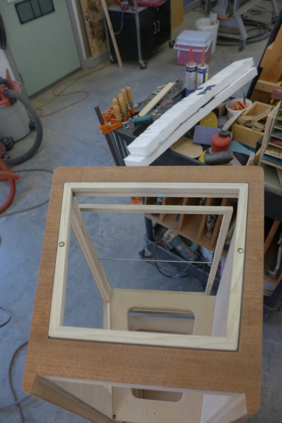

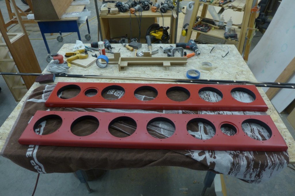

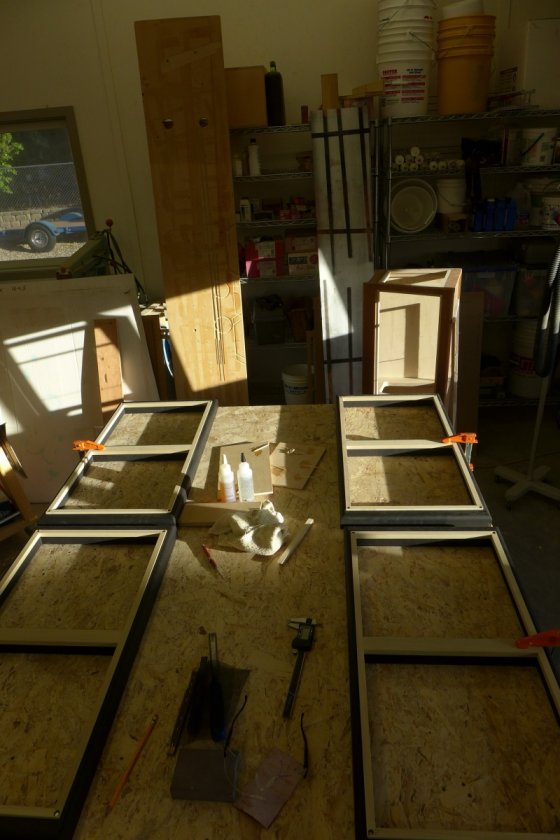

Got some more grillin' done, but then had to take time out and go to Michigan and play Monopoly with the grandsons...I schooled 'em.
Gees, who designed this grill laden thing? Didn't Motley Crue do a song about this...Grills, Grills, Grills. Or something like that...

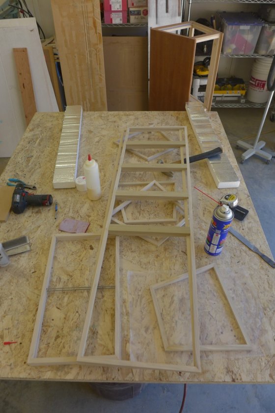

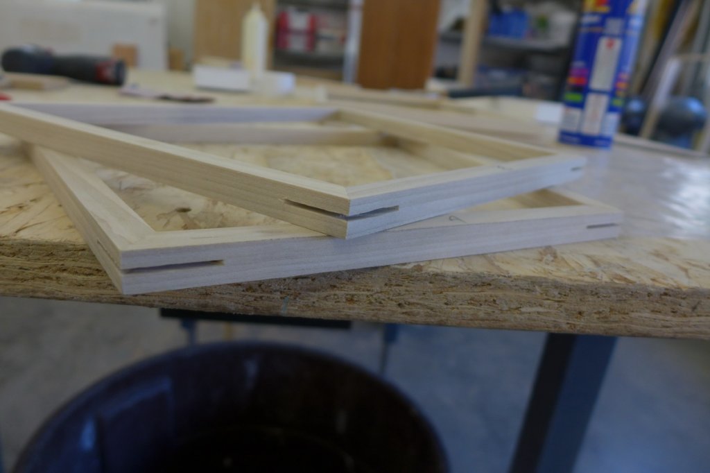

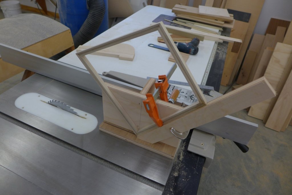

Not putting corner gussets in like the front so I reinforced corners with a spline. Routed them flush after glue dried

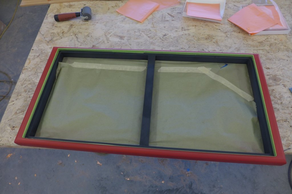

More magnets. I bought 200 magnets and haven't counted but have used a good chunk of 'em. Of course there was that front grill snafu...
Primed and cleared. Glad that's behind me. What was I thinkin'?

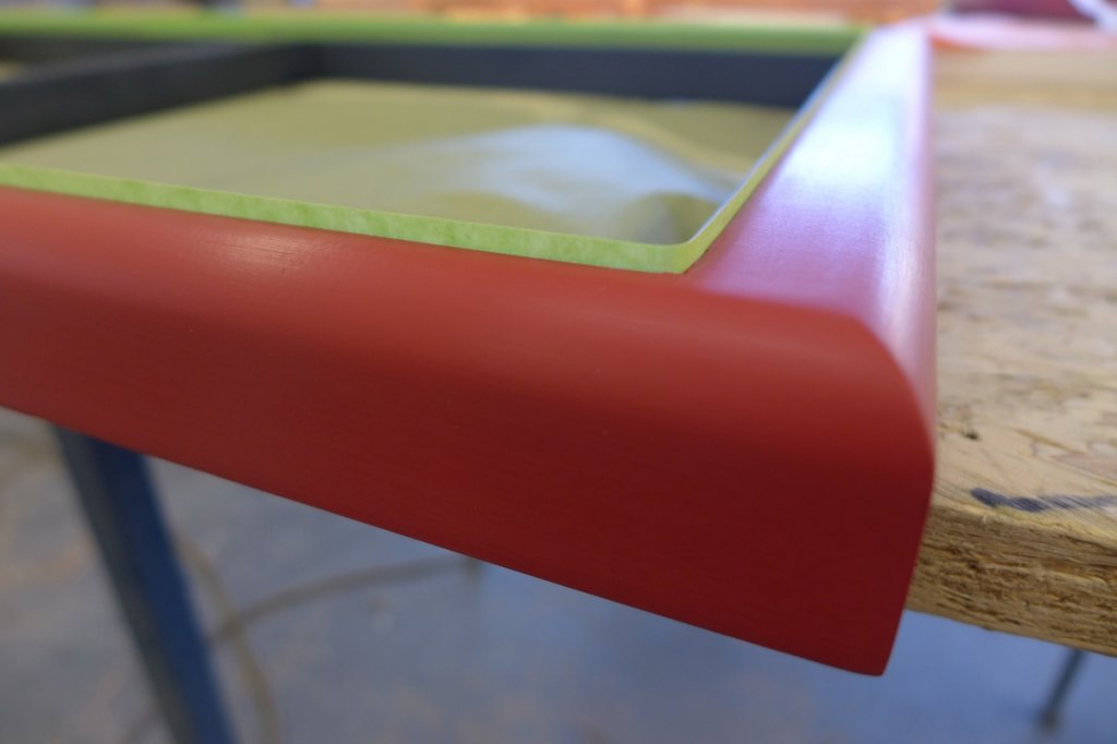

Moving on to prepping for copper gilding. What's up with the red, you're asking. This is the undercoat color. It'll peek through copper here and there after gilding...you'll see when we get there. Sub fronts will get the same treatment
Before and after scuffing so gild size has some tooth

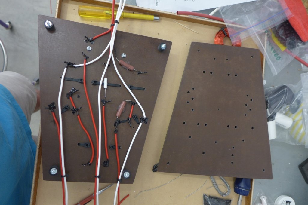

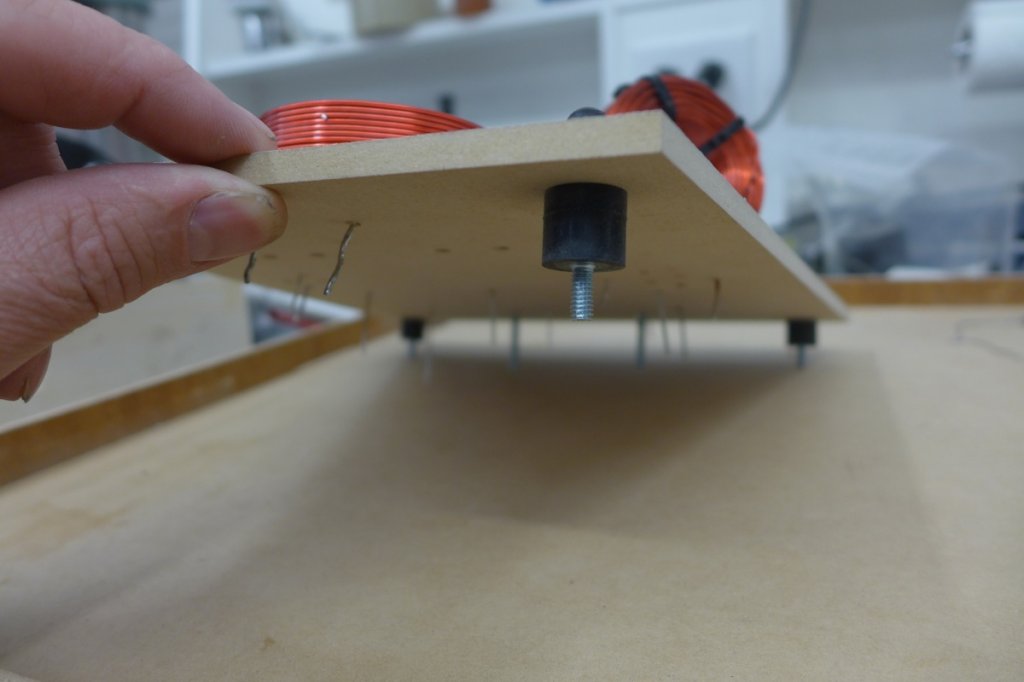

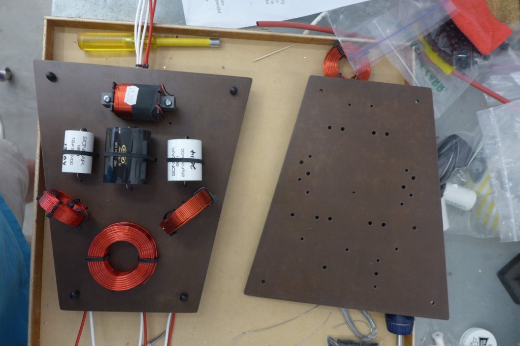

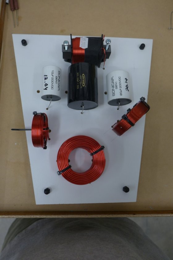

I get a little nervous when it's time to build crossovers, so before I build the actual boards I wanted to post a photo and make sure I'm not committing some electronic sin I'll regret later. I'm particularly concerned about inductor orientation and proximity. This will be mounted on the rubber standoffs you see and resistors, bypass cap and wiring will be underneath.  Does it look copacetic?
Danny Richie
Re: ***X-Otica Main & Sub Build***
« Reply #157 on: 18 Jul 2016, 02:42 pm »
That doesn't look too bad, but I'd twist the one on the left a little so that if it were to roll it would roll into or away from the large inductor that is mounted flat.
« Reply #158 on: 18 Jul 2016, 11:55 pm »
Thanks Danny, that was my biggest concern. For whatever reason it only came into focus after I laid it all out and drilled the holes. Fortunately I can modify my template and then get it right on the final boards.

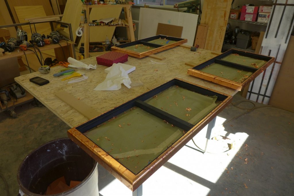

It was a dark and stormy night...no, wait....lost myself for a second.

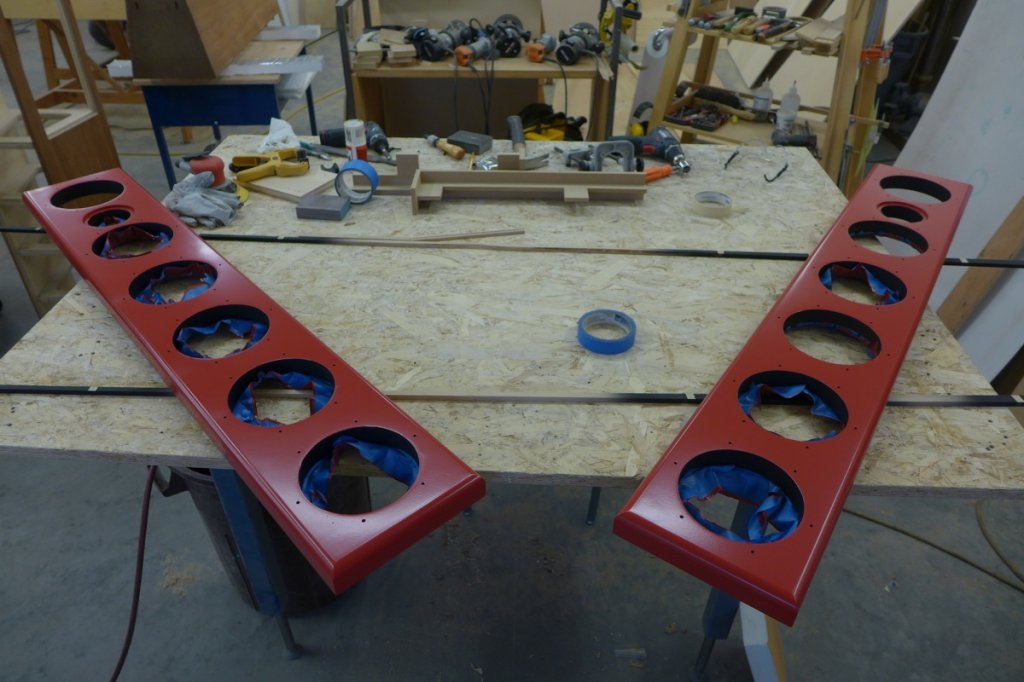

The Magnum Opus saga continues. You sure can't say I hurried through this one. I can hear them in my head, but then I hear lots of things in my head...perhaps fodder for another thread.
I almost forgot about to grill storage on the side of cabinet, soooo
Final assembly on crossovers

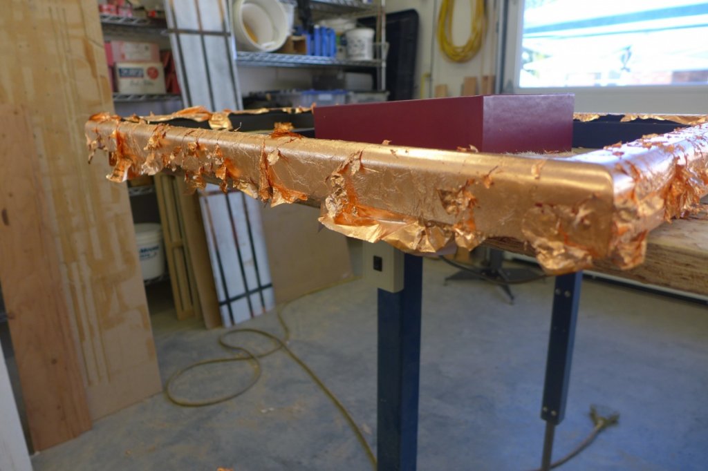

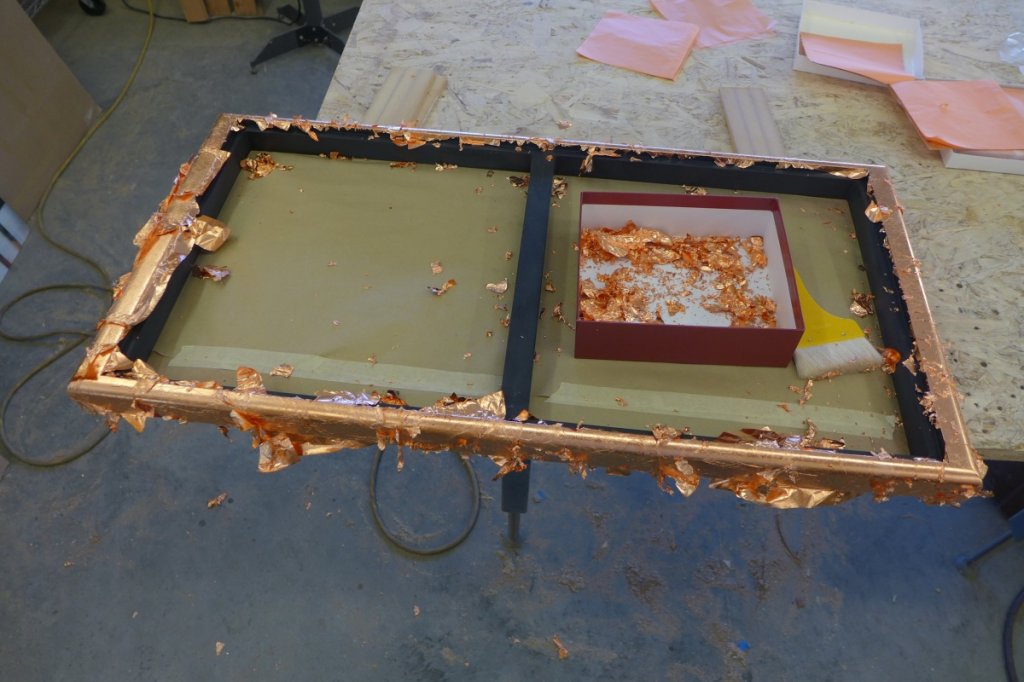

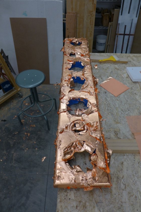

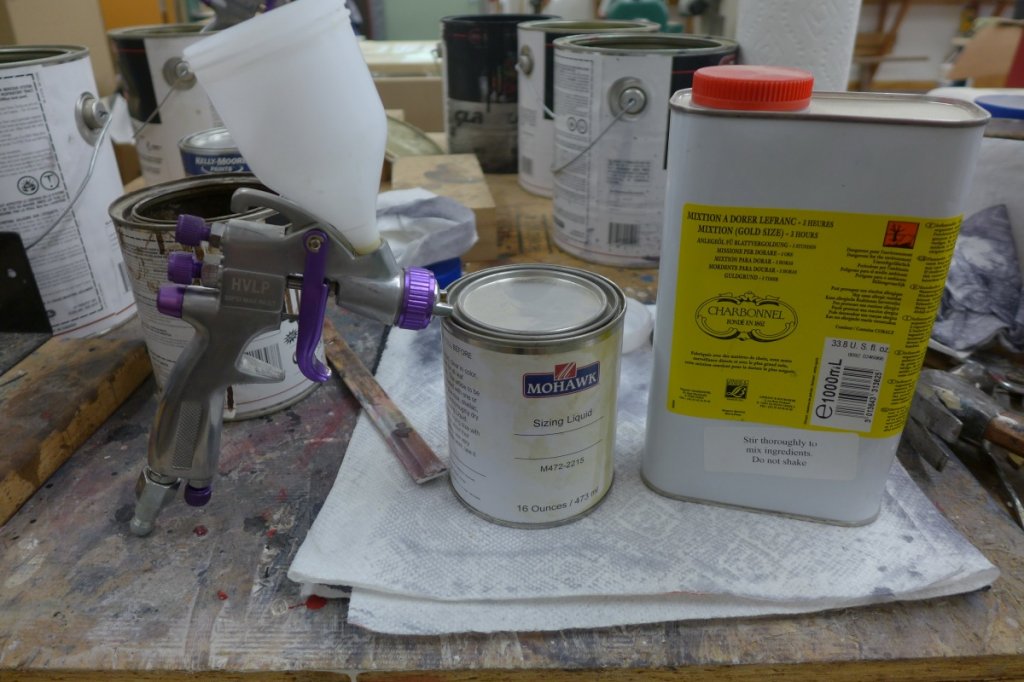

And now what you've all been waiting for...or not. Gilding, Peter J style. Not quite like the masters.

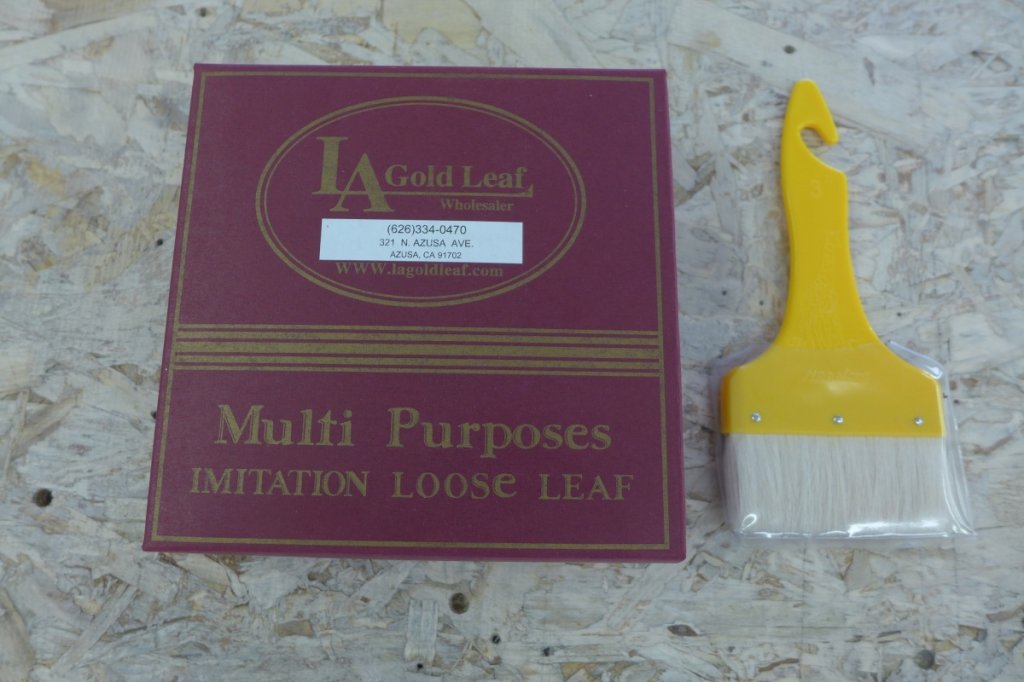

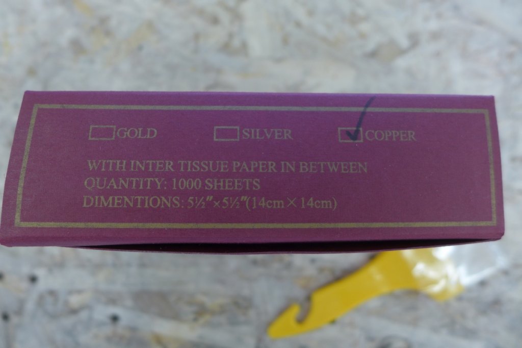

Here's the size and what I used to spray it. Mohawk is the cheap stuff, fine for this gig. Other stuff is for special occasions...

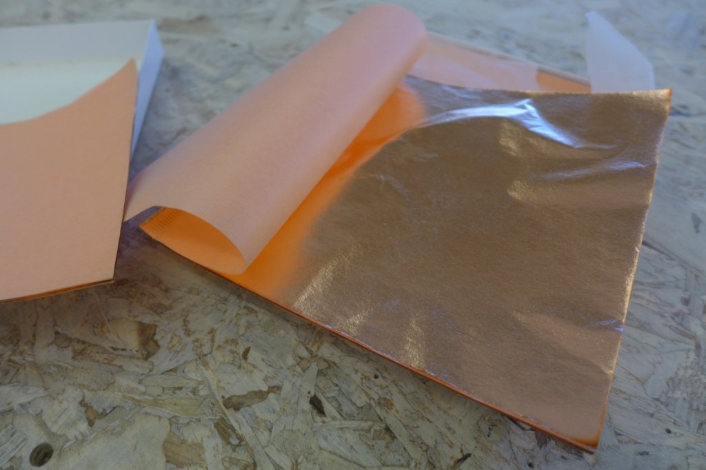

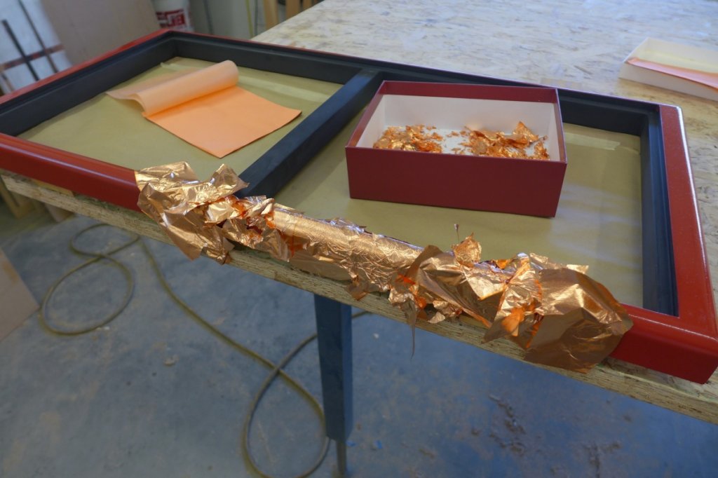

Best place I've found for copper leaf, they sell on eBay. Got that cheapo gilder's brush from them too.

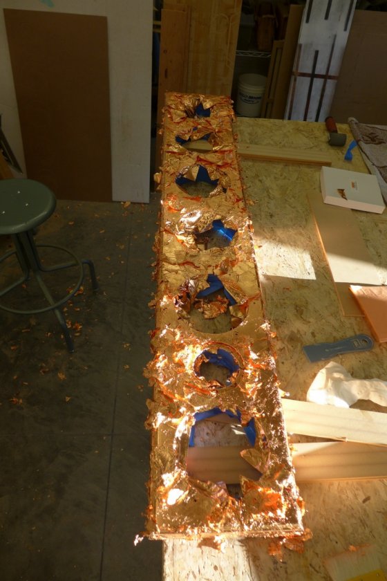

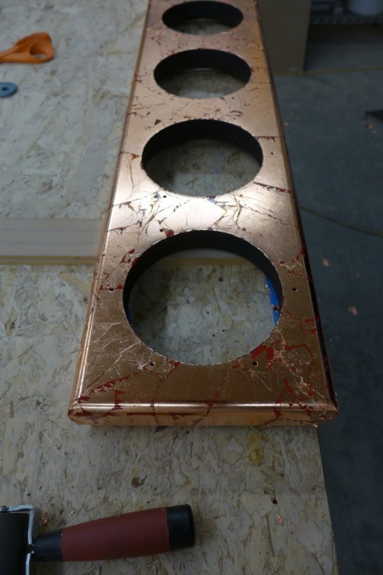

Masked off where I didn't want to spray the size. plug made it easier. Gilding sticks wherever size is
Sprayed size. Size is, as near as I can tell, varnish. Maybe other things in it, but primarily quick drying varnish. If you're trying this, you gotta wait until the size gets just the right tackiness. Too soon and the gilding will become saturated and consequently won't be affected by chemical patina-ing. Wait too long and, well, it won't stick. And by the way this is quick size, the not quick stuff stays tacky for looooong time, like days.

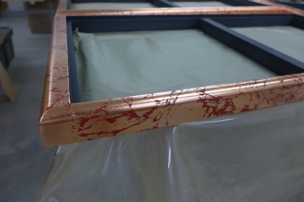

Gilding progress. I'm purposely being semi careless and tearing sheets and applying in a haphazard way. You'll see why
Kinda  aggressively brushed excess off to expose the red in a random way.
The hairy baffle
After pouncing with brush
After brushing like before

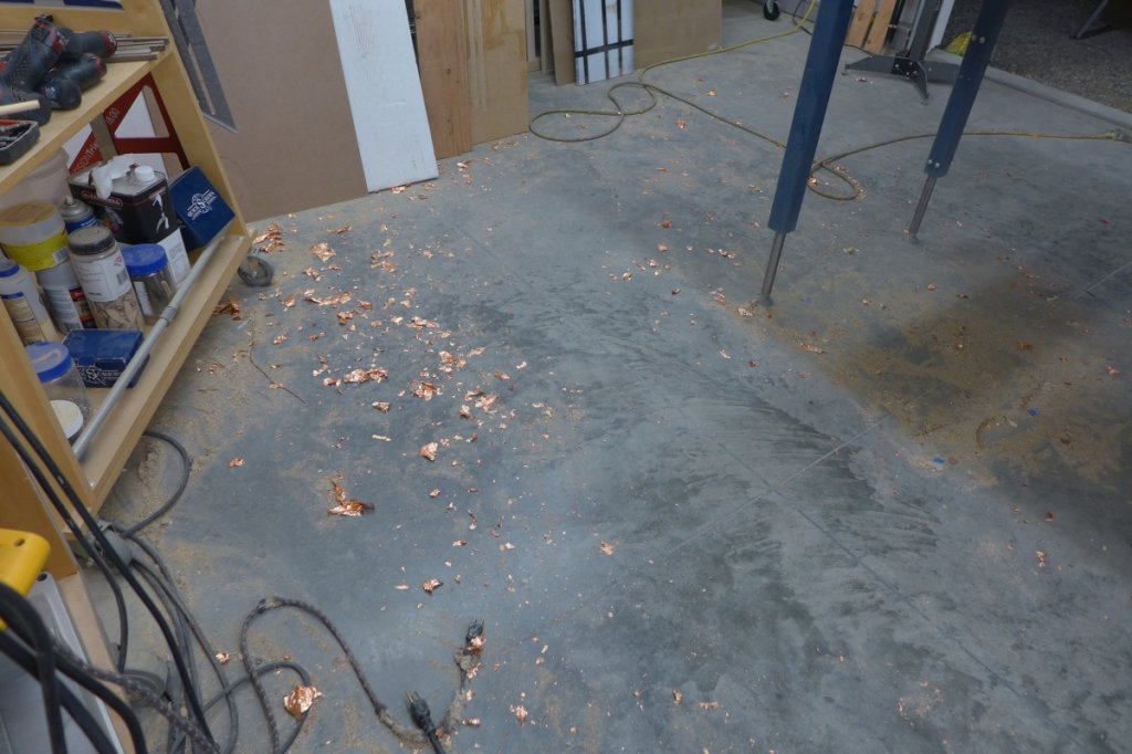

Some of the carnage...it's messy. Oh, and can't be breezy either, I sometimes hold my breath so I don't mess things up, but on this kind of thing, it's specifically not fussy.
