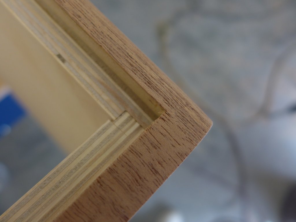

« Reply #128 on: 13 Jun 2016, 05:49 am »

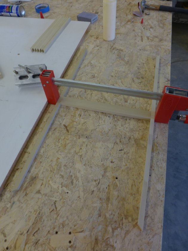

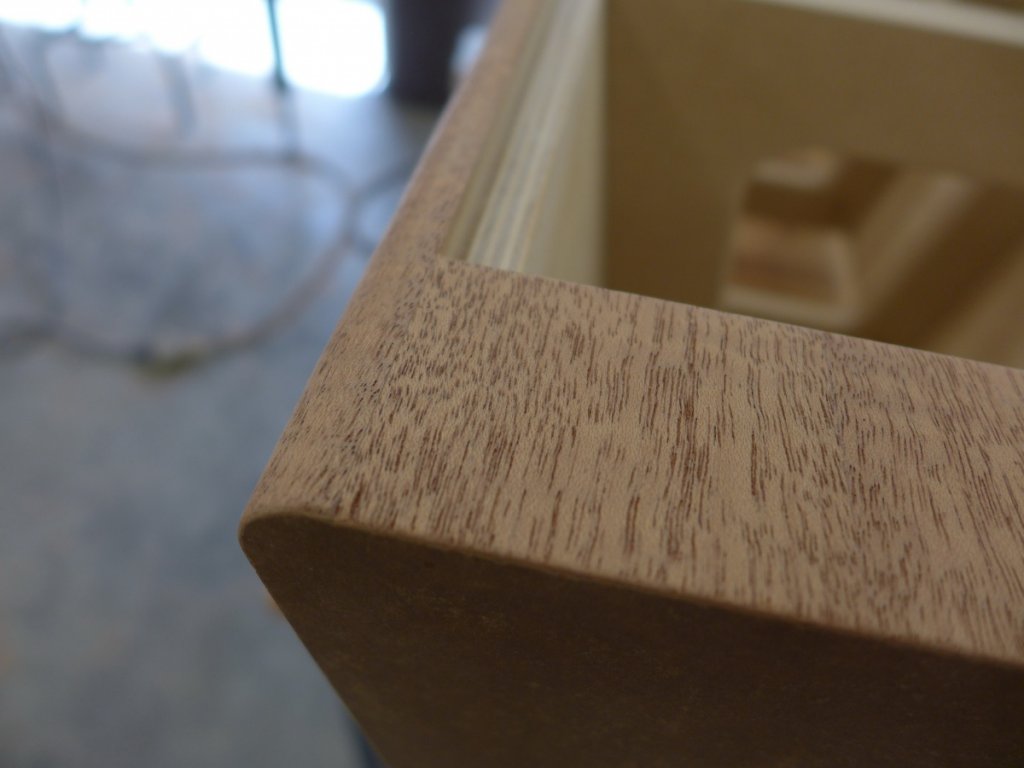

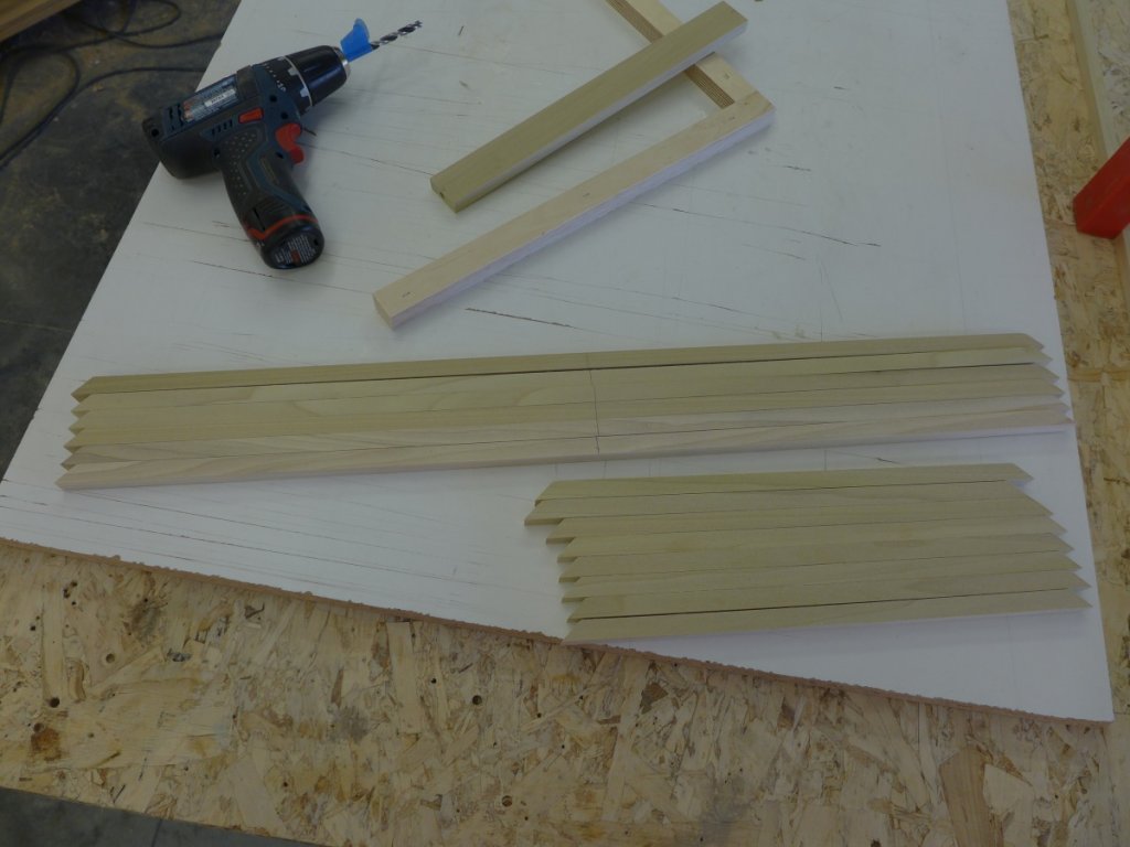

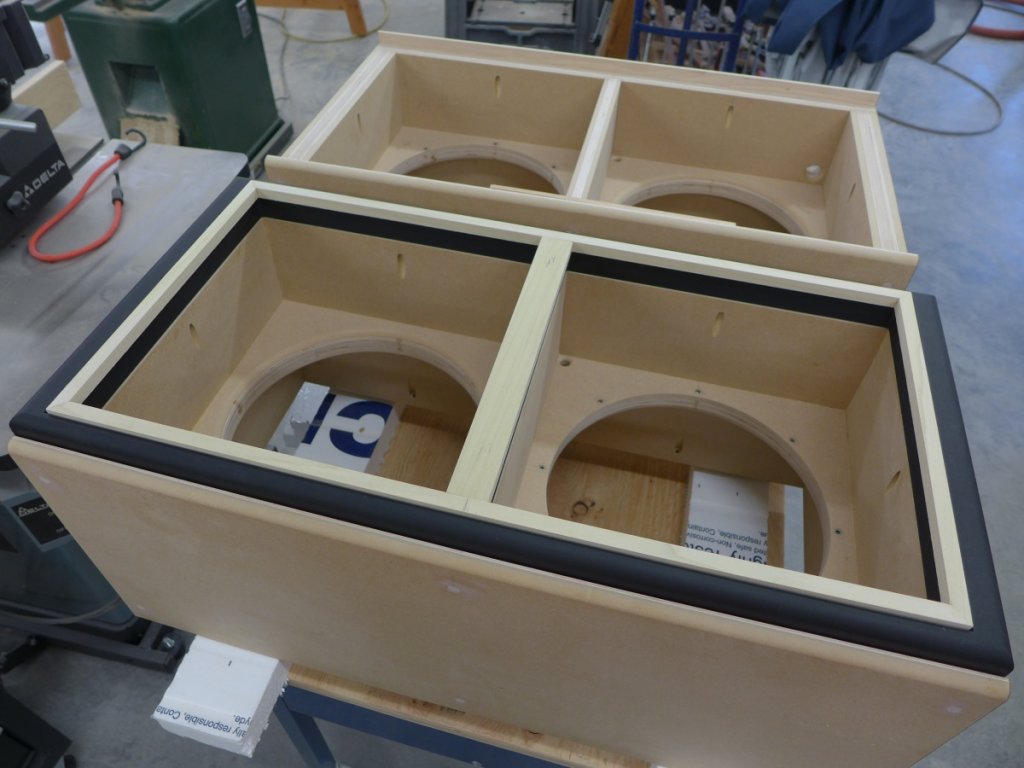

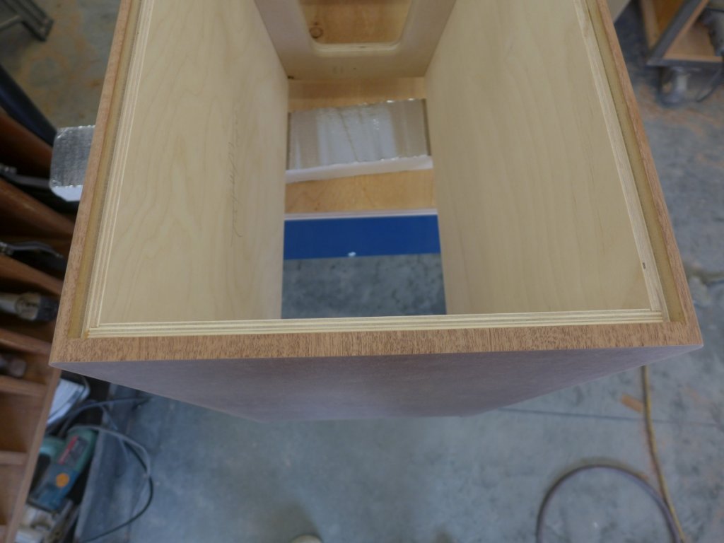

This installment  is a double header....grill frames and veneer. Wonders never cease, eh?
These grills are a little different than the front of mains because they inset into box. The side, top and back grills will all be similar.
Raw material
Because it's a beefier frame, I can add a dowel to locate center bar...
Starting to take shape...
And it all fits!
Grills got set aside for now. There's more to do, but I'll wait until I have all the other grills made to finish.

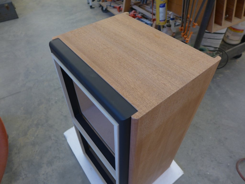

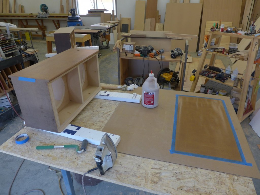

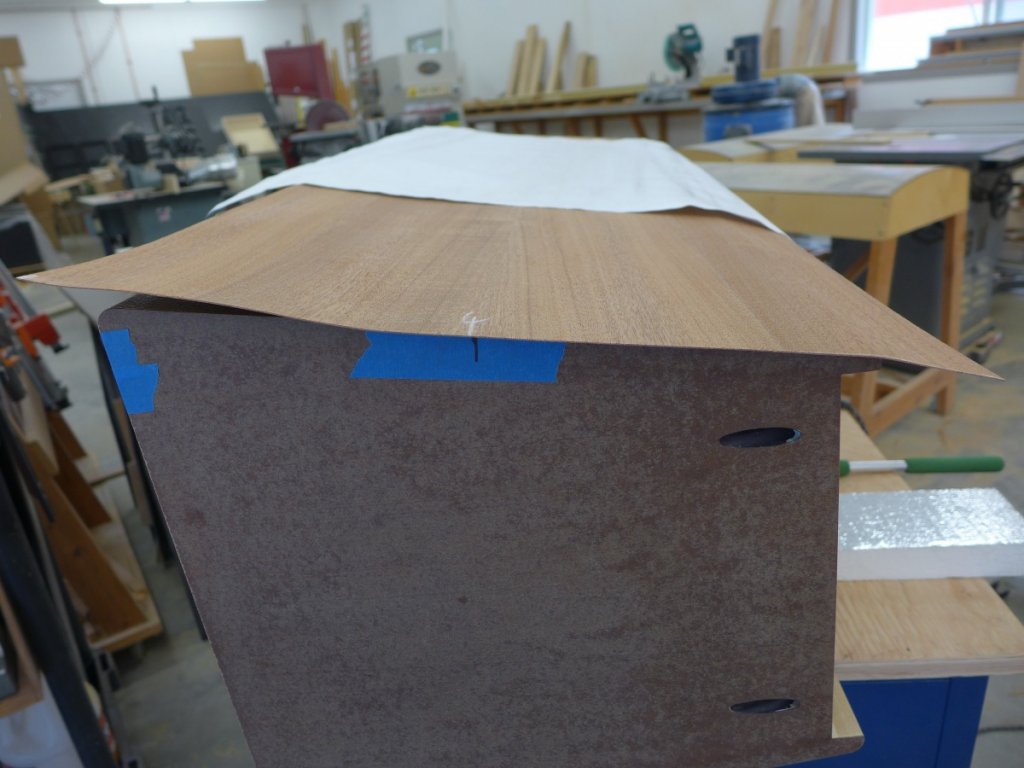

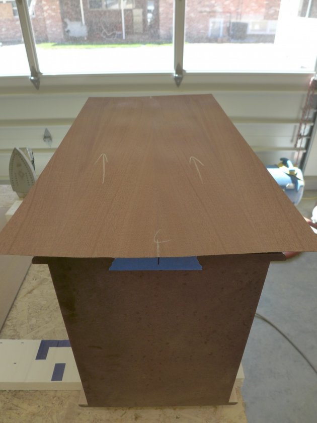

 I tried Heat Lock a some years ago, but since having vacuum bag, what little veneer I needed to do outside the bag, I did with good ol' Titebond I. This would be doable but I think almost harder in bag...it's not good for everything.
Using sheets of paper backed veneer because I didn't want to mess with all the bookmatching if I used raw. So I let someone else do it and I'll live with the veneer line. It'll mostly disappear in the stain. Lined up bookmatch with center of cabinet so it looks pretty
After ironing and before trimming
I drilled Speakon holes earlier so just had to trim holes and drill pilots for mounting
Looking more and more like drawing...which it should, I guess

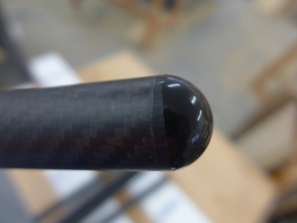

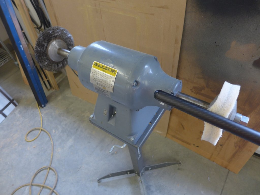

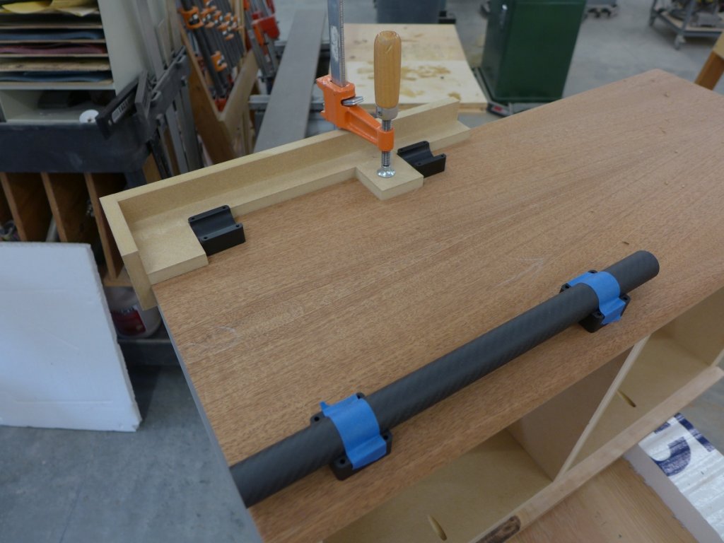

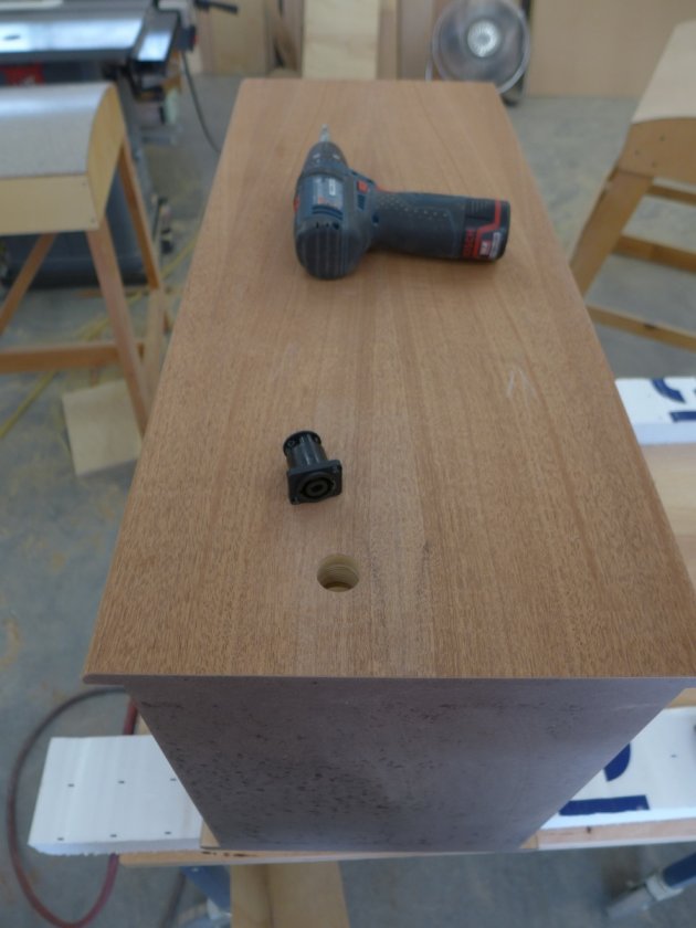

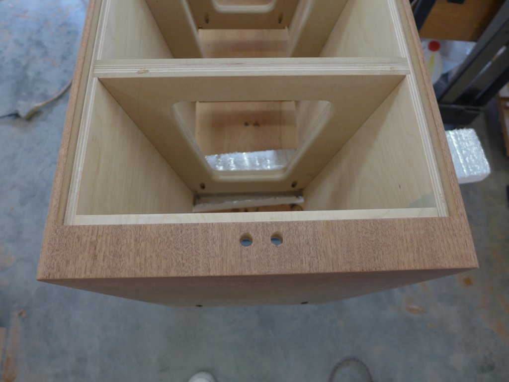

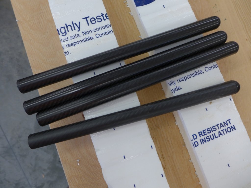

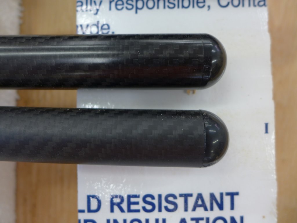

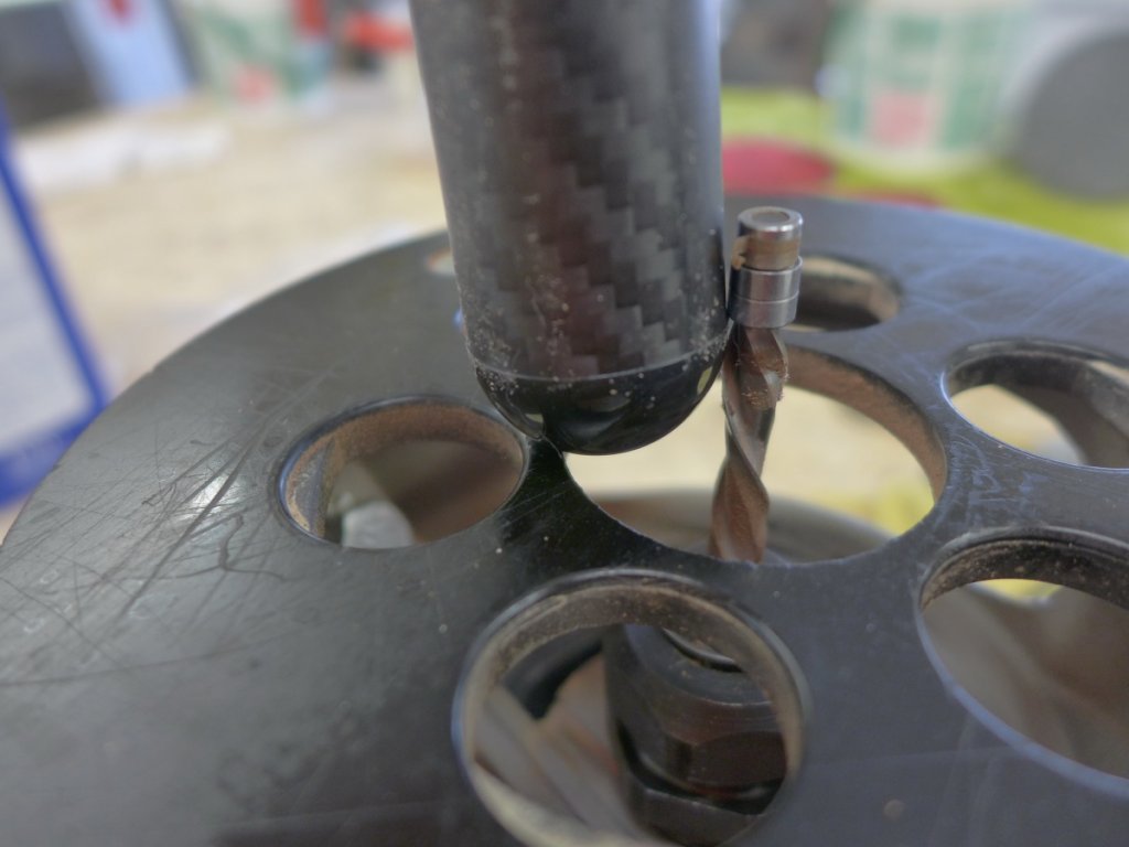

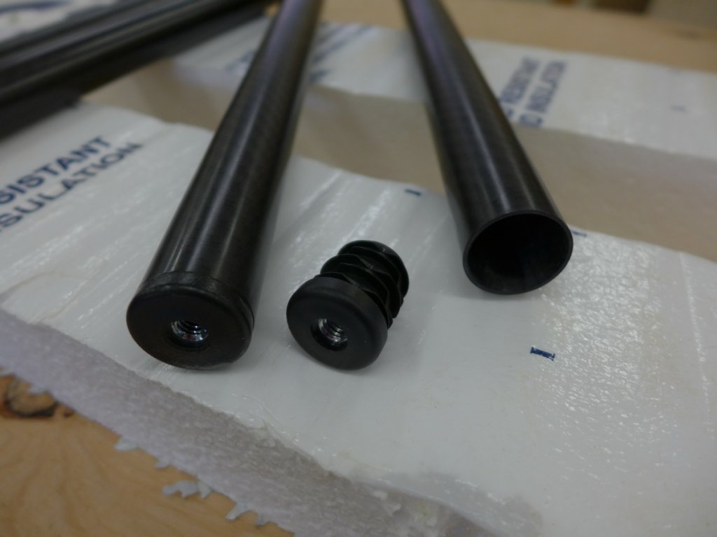

The latest chapter in the Magnum Opus forever build along. The end's in sight!...well, not really but it's incrementally closer. Should be listening by Christmas...
My placement jig for leg standoffs on subs. Using unthreaded base for drill guide
Now they're holey

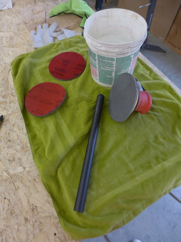

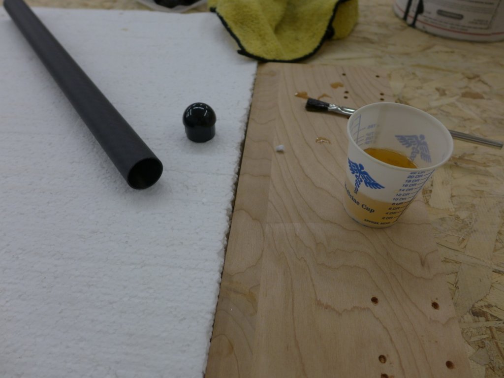

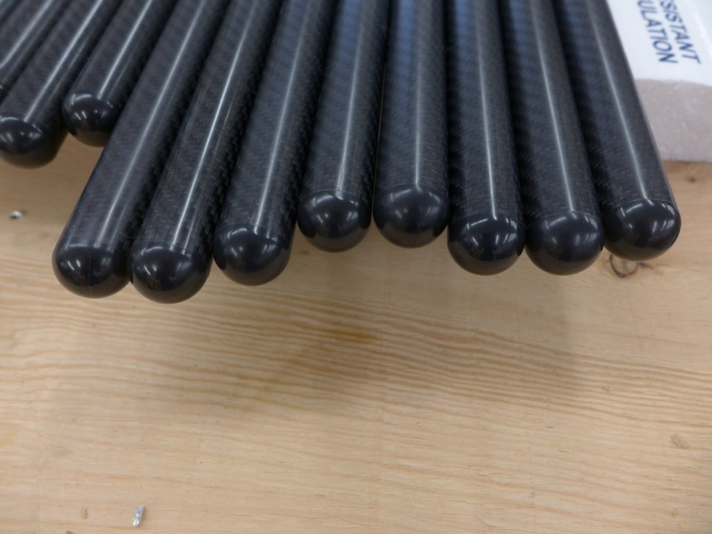

Epoxying in ABS leg caps
By their nature, the caps are not exactly the same size as tubing, nor are they precisely centered. Can't have that, so I fixed it. Before and after
Used this to get 'em flush
Then some sanding and buffing
Stuff in a threaded insert
Before and after buffing
They're ready when I get to assembly...someday...

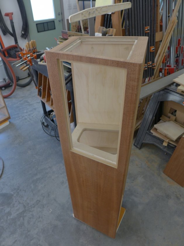

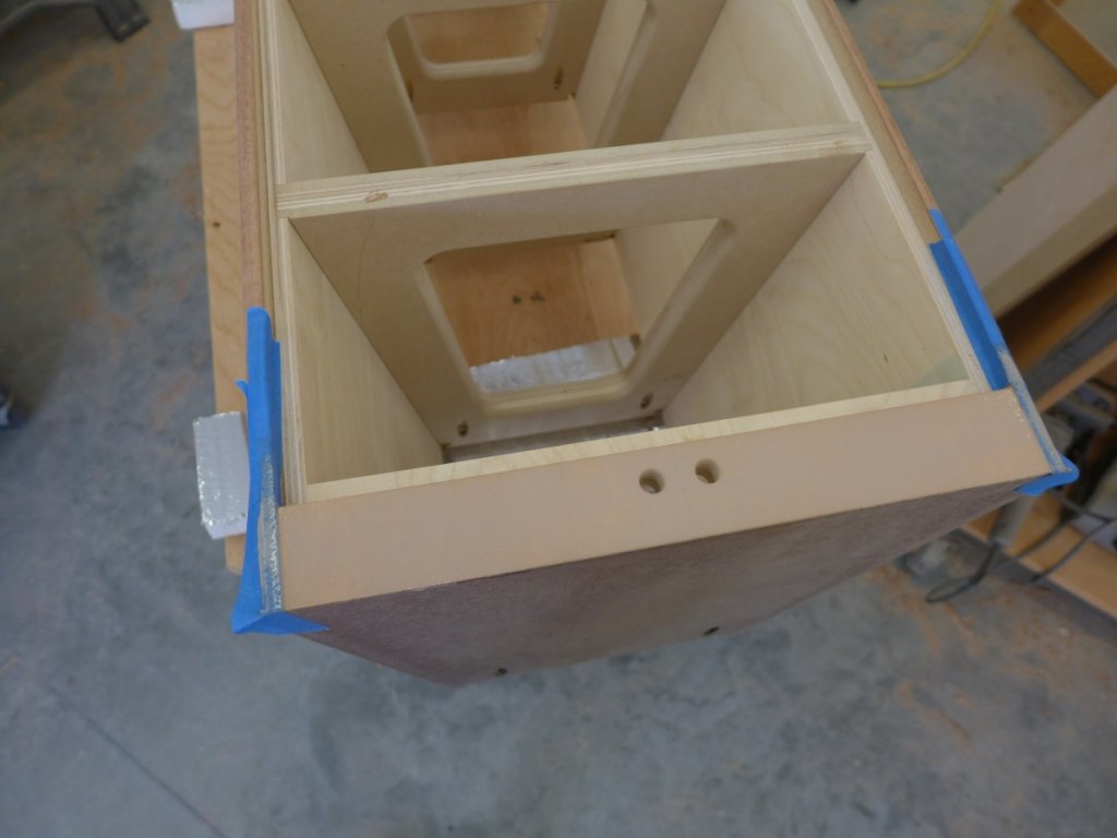

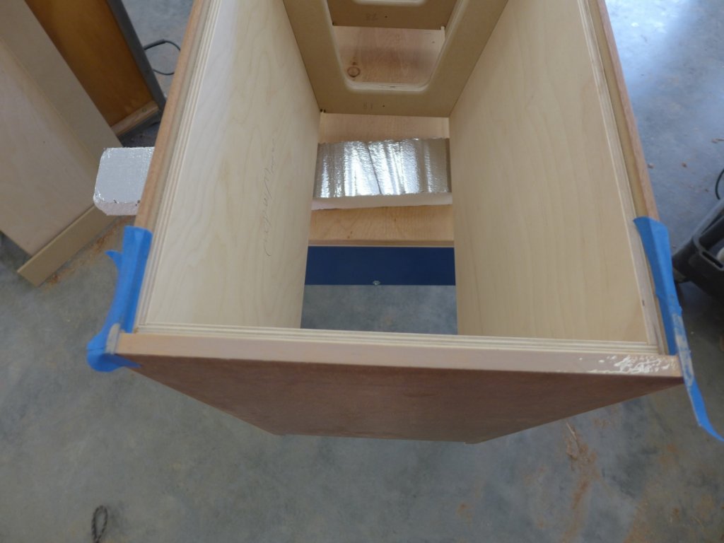

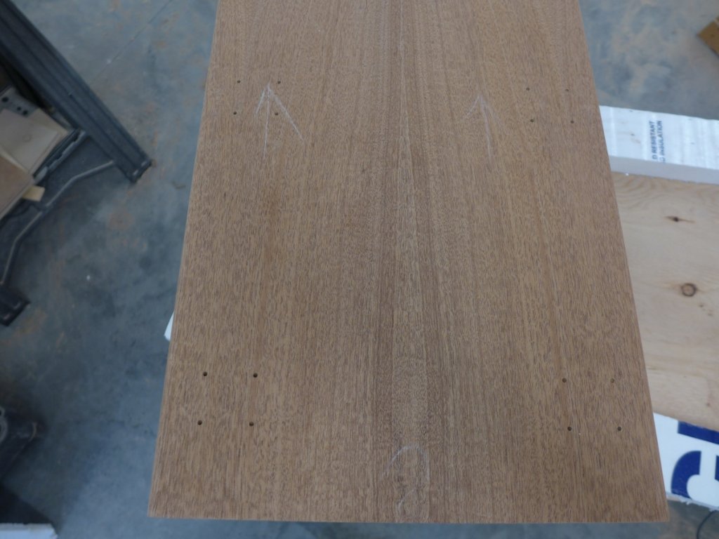

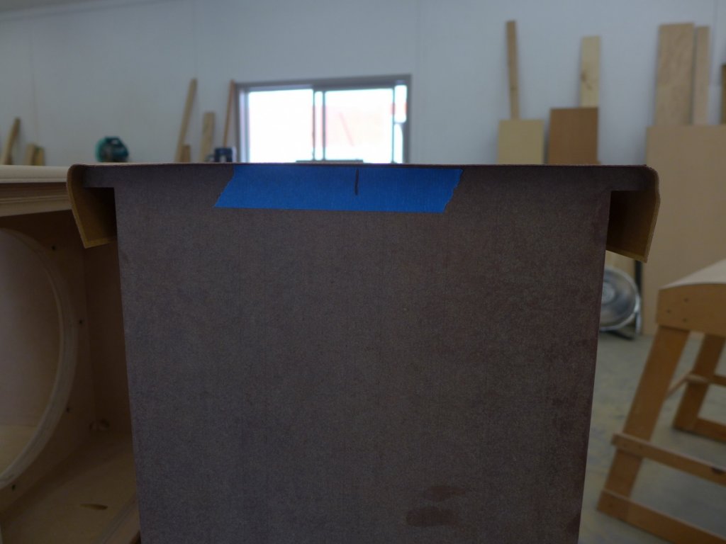

Veneering the mains
Once sides were done, I needed to fill in across the back. Masked and spread some Heat Lock
And ironed on the wee pieces

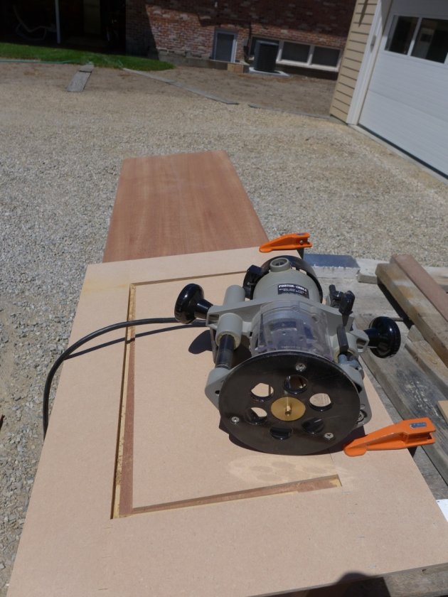

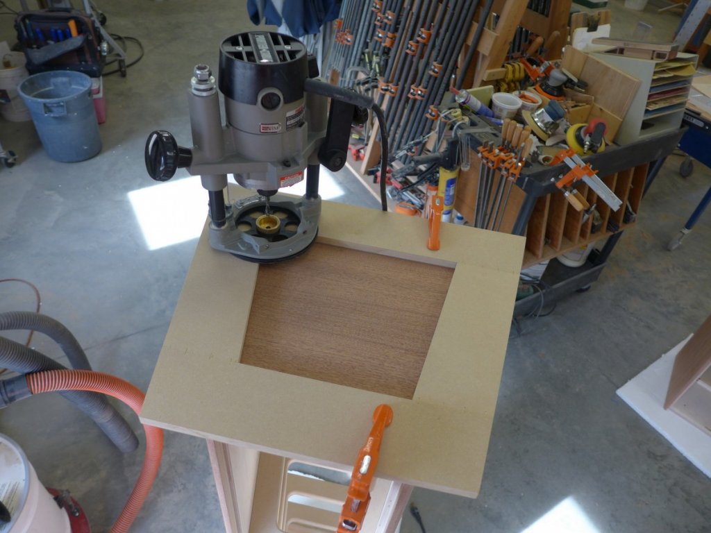

Here's my cutout templates for top and side windows
And now these sides are holey, too

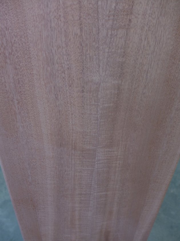

Here's an unexpected bonus. Sides have a little fiddleback figure at the bookmatch...this should highlight when I get to finishing...around Halloween...
