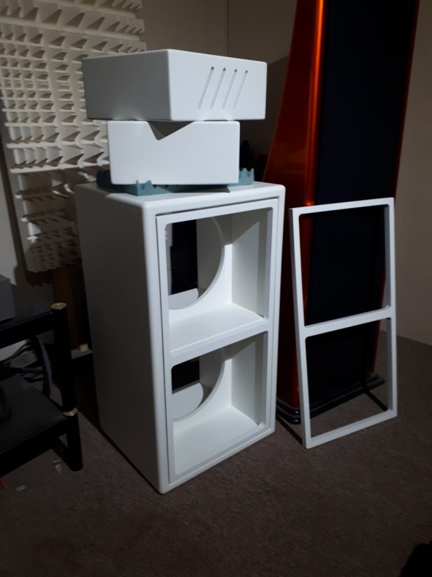

Satin white (20 degree sheen)   duals with  amp boxes/ grill frames.
Big .5"  radius on all outer edges and  a smaller,  .25"  radius on inner edge of grill recess and   on allouter  edges of amp boxes
3/8 x 3/8 N52  cylinder magnets were pre-installed from   rear of braces.
 We were going to wrap  the grills in  white  but the customer   is stillundecided on color  so   he'll be wrapping them himself.

I don't imagine I get a vote, but the black drivers with some black no-see-um grill net would be really striking. But then I'm all about no-see-um grills since using it. Sheer and sexy, ya know!
Re: OB H-Frame / A370PEQ / HX800 amp Box Flat Packs
« Reply #509 on: 4 Dec 2019, 11:54 pm »
Well,  I think you  just  volted    :lol:
Hopefully  when he gets them all fisnished up  and playing he'll   share  some pics  here or send me some to post
jay

Jay,
What type of paint and topcoat did you use on those?
Mike
« Reply #511 on: 5 Dec 2019, 06:13 am »
It's Valspar Cloud White  and a   Valspar 20 degree Clear Lacquer on tp.
jay

Is that a latex paint?
Mike
Peter J
  • Posts: 1966
  • Hmmmm
« Reply #513 on: 5 Dec 2019, 03:24 pm »
Mike
I doubt it under top coat, Mike, assuming solvent based lacquer. Most lacquer can be tinted enough to be opaque, which the method most often used by cabinet manufacturers for a "painted" finish. In the furniture and car finishing worlds, acrylics (latex is an acrylic resin) have almost no place where they perform well. Better on walls.

That’s what I thought but when I looked up Valspar Cloud White I only got results foe Lowes latex paint
Peter J
  • Posts: 1966
  • Hmmmm
« Reply #515 on: 5 Dec 2019, 04:36 pm »
It's just a color name. Places that provide finishes to industry can tint to any color in my ginormous color fan sourced from a paint supplier with all the funny names.  They also run under the radar of the general population, being targeted mostly at industry for a variety of reasons. Nasty solvents being one of them.
And FWIW, although sheen is often expressed in "degrees", it's actually referring to a percentage. It's  the percentage of reflected light from a given surface measured with a Glossmeter. No kidding, there is such a tool! A glossy surface reflects a higher % than matte, for example. "Matte" or "dull" typically around 15-25% sheen although the "matte"  part is largely at the discretion of manufacturer. There is no real standard for terms like "gloss", "semi-gloss" "satin" etc.

No, it's lacquer
jay
« Reply #517 on: 6 Dec 2019, 04:13 am »
Peter summed it right up  :)
This customer  wanted    a finish closer to dull as opposed to   gloos or even "satin" .  The  Valspar  20 degree ( ort so it is called) fit the bill  nicely...  it     gives  just  a  bit of   sheen  but  without  being overly  relfective.
