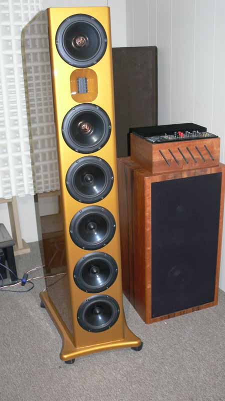

Dang David, your setup looks nice. Nice diffusors too.
Thanks Danny! One nice thing is that I can easily move the ones in the middle when occasionally watching movies. I can store them away and the process takes about 30 seconds. I treated the left wall with 4 absorption panels as per your suggestion.

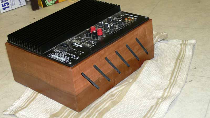

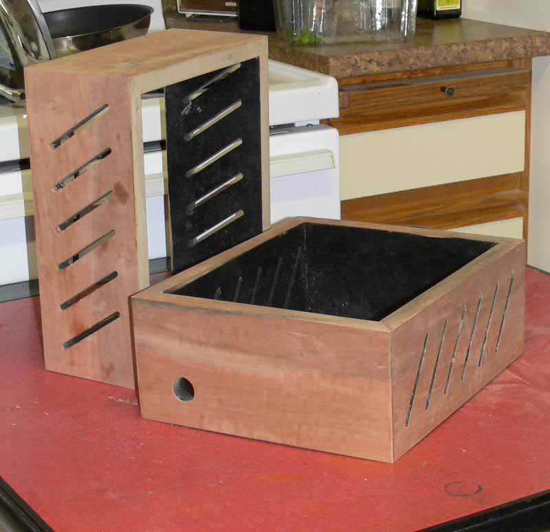

Finally got busy and glued up another set of amp boxes.    Wrapped them in   the leftover  Applewood (Tineo)
these will be sprayed in flat  lacquer to match  another set of Applewood subs we have here..

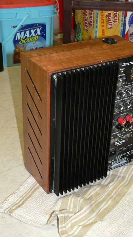

Here's a few  pics  after  some  low sheen lacquer ( I like the look of  this on wood) and fitting  an amp.
Now this pair of Applewood  "demo" fianlly have their matching   amp boxes
