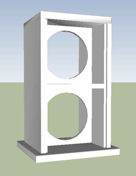

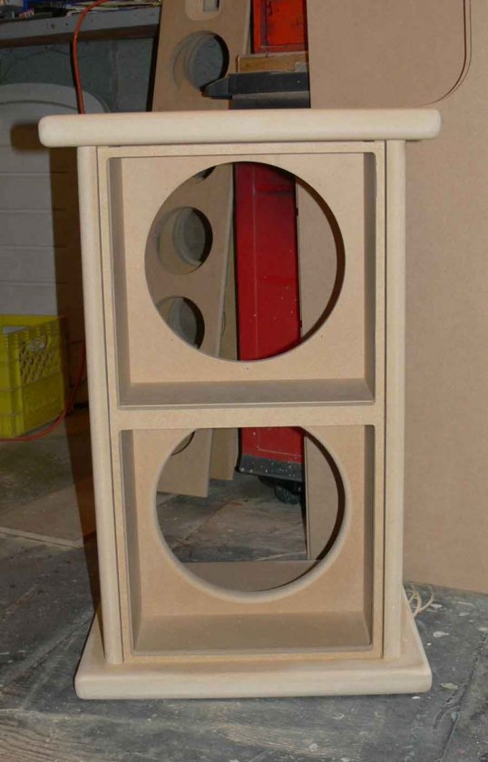

The duals measure  16" w x 14" d x 30" h.

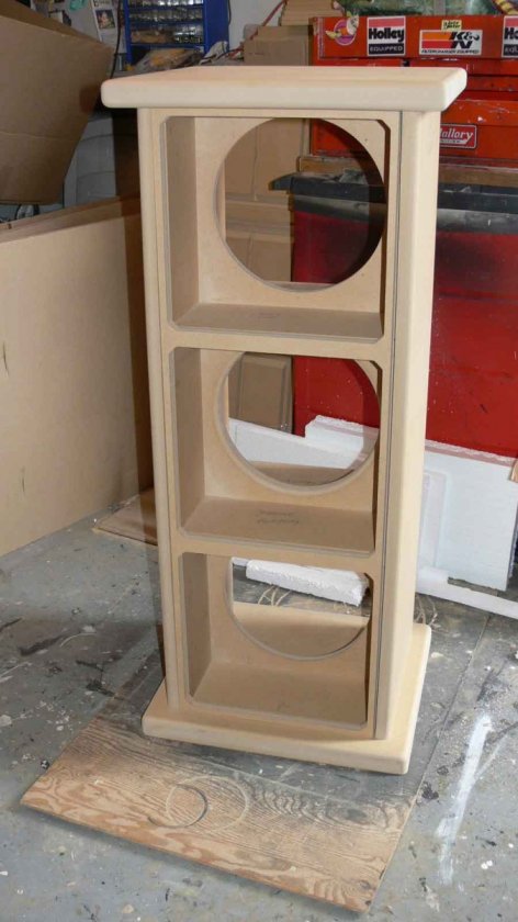

The triples measure 16' w x 14" d x 44" h.
Bases/ tops are 19" x 17", a smaller  overhanging top is also available.
The overhanging tops are much simpler for people to  prep (glue them up, give a light sanding, prime, and paint,), no seams to deal with.
The cabinets use both dadoes and  dowels to  make asembly very easy. Both the baffle and braces will fit into dados..
Each side panel  will have a pair of dowels in each end that will mate witht he top plate and  base also aiding alignment.

Cabinets:
1.5" MDF  side panels, tops, bases
1" MDF baffles & brases
Combination of dados / dowels for  side panel/baffle/base/top alignment. easy toassemble :beer:
Driver mounting screw holes pre drilled
Round-over on rear side of driver cutouts
CNC cut

Fantastic Jay! I know that one point of a flat pack is to be able to offer it at the lowest price possible by making a run of identical ones, keeping the number of table saw set-ups and cuts as low as possible. But since you just mentioned the frame may be offered with the choice of either an overhanging or flush top, let me ask you the following:
1- Would you consider making the same choice for the bottom, i.e. flush with the sides?
2- All that would be necessary for an inset front grill to be possible is for the horizontal middle brace to stop short of the front edge of the side panels by, say, an inch. Would you consider making a set of frames with the front brace one inch shallower? If not, it would be easy for the buyer to cut (or have cut) an inch off each brace. Then, little blocks could be glued into the four inner corners of the H-frame onto which the grill frames could be secured, for a clean finished look to the H-frame.
3- If the answer to question 2 is yes, would you consider making the grill frames themselves? Just a simple 3/4" MDF frame (picture frame style) with perhaps a strip across the middle (running horizontally, left to right) to prevent the long sides of the grill frame from bowing inward when the grill cloth is stretched tight across it. If not, it wouldn't be too difficult to put a set together by anyone desiring them, from strips of MDF.
4- Will you be offering a simple MDF box for the Rythmik plate amp?
Whether the answer to these questions is yes or no, the H-frame is very welcomed. Thanks for offering them!---Eric.
Re: H-Frame Flat Packs
« Reply #4 on: 18 Dec 2015, 11:53 pm »
Yup, no issue with that. I've actually made the base and top  panel interchangeable to simply
I'll try and answer the above 2 together and address  a bit of what you said  before question 1. These are not going to be hand cut on a table saw. They are going to be CNC routerd so alterations  require changes to the program (or adding optional  operations) requiring additional programming hence the desire to keep things simple but extremely accuate. Making the shorter brace to facilitate an inset  grill is not a big deal but that would in turn leave a bit  ( an inch) of the  horizontal dado(s) exposed. What  could probably be done is to  cut out a 1" notch from the outer edge of the braces leaving a "filler" on either edge for the dado making room  for the inset grill frame. Doing this wouild not be perfect...  the  inside  would not have a perfect 90, it would have a  samll radius  correspondig to the  radius of the cutting bit.  The end  user could easily chisel this out   without much trouble if he wanted a perfect 90 there.  Having an optional brace like this wouild not be too much trouble.
I'm a bit hesitant to start trying to ship grill frames, pretty fragile
Thought of this a while back but then it kind of got forgotten..  I'll find out about this.
No worries, hoping to do an initial run of a couple pairs of duals and a pair of triples fairly soon....  of course we are right in the middle of the  "silly season"  so things like this tend not to be the priority
jay
Jay, your response thankfully made me realize: With a grill frame fully inset into the H-frame, the entire length of the front edge of the two sides of the H-frame will then be visible, including the ends of the dado appearing at those front edges. I failed to realize and envision that. Duh! Yes, making the brace shallower will allow a grill frame to be inset, but that exposed dado would look like Hell! I guess the dado could be cut to end just shy of the front edge of the side, but cutting the dado thusly on a CNC machine may be cost prohibitive. Whatta ya think? Alternatively, I suppose a piece of MDF could be glued into the end of the dado to conceal it, but that would require then applying putty to conceal the resulting seam, leaving possible the seam becoming visible over time. Drat! Or, the top and bottom panels could be made to overhang the side panels by an inch, with the grill frame being inset behind the front edge of the top and bottom panels, but covering the front edges of the two side panels. I'll have to think about this!
Your decision to not make and ship grill frames in completely understandable---made of MDF, they are certainly easily broken into pieces. Luckily, they would be fairly easily made by anyone wanting them.
Yeah, after the New Year will be the time to start making and selling the H-frames. No hurry!
Thanks again---Eric.

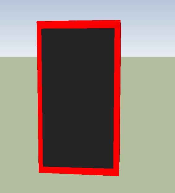

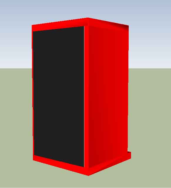

Another option we are working on for  these  packs is the flush mount grills (thanks Eric)
These would be .5" .75" grill frames with a cross brace  in the cneter that alignes with the center brace of the cabinet.
You could either use a small piece of velcro in each corner or a N52 magnet.
Probably looking at a $50/pr (#980 for all 4 sides) upgrade to do this ( a bit of time and material)
jay
« Last Edit: 6 Feb 2016, 03:29 am by Captainhemo »
These would be .5" grill frames with a cross brace  in the cneter that alignes with the center brace of the cabinet.
Probably looking at a $50 upgrade to do this ( a bit of time and material)
jay
Awesome! Exactly what I was thinking of Jay.

The grill implementation looks really good!
