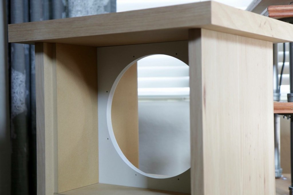

These are triple 12's, haven't done any 8's yet.  The center woofer is reversed and yes, there is a hole for wiring pass through, it's  in the  top  left corner  of the center woofer  "chamber",  just can't see it   at that angle I guess

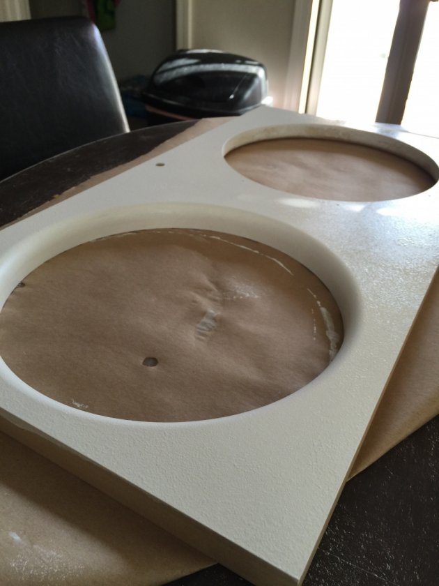

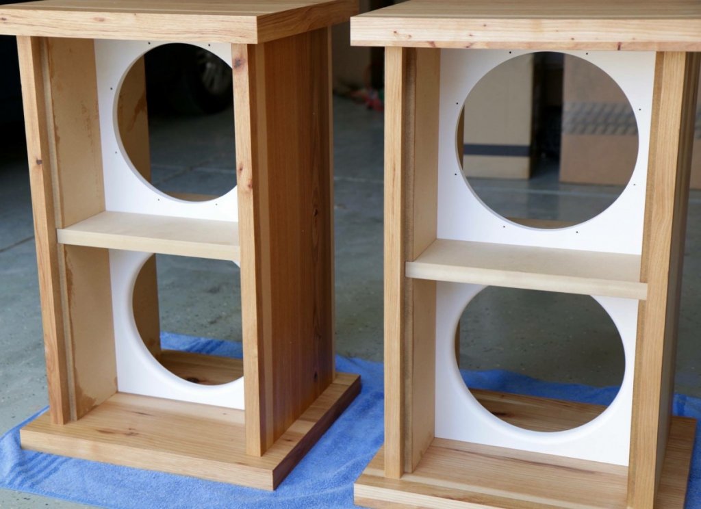

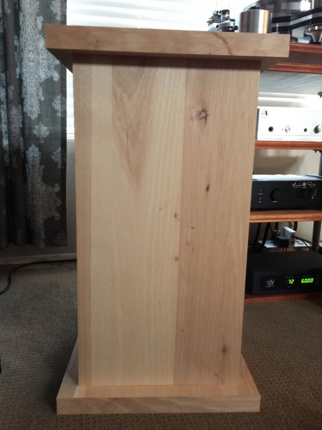

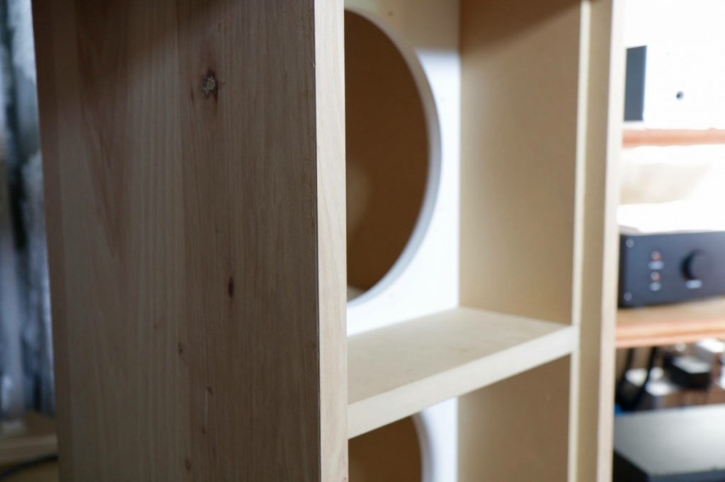

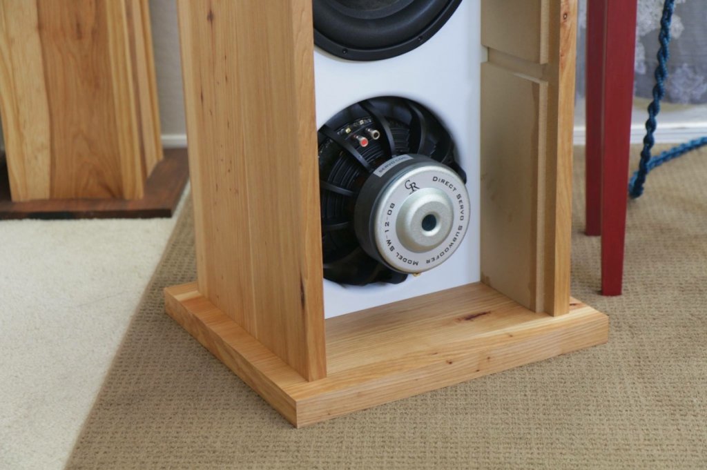

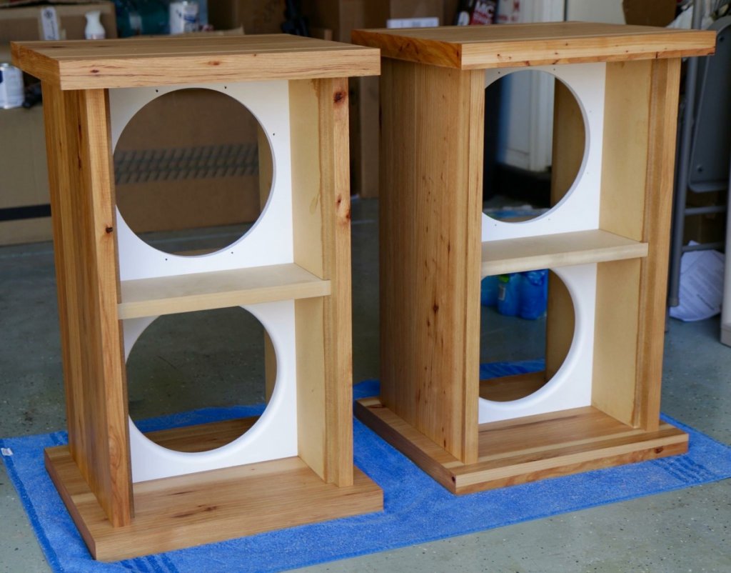

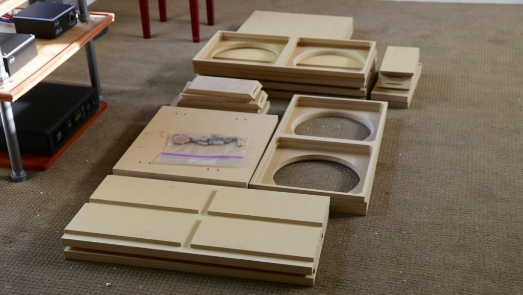

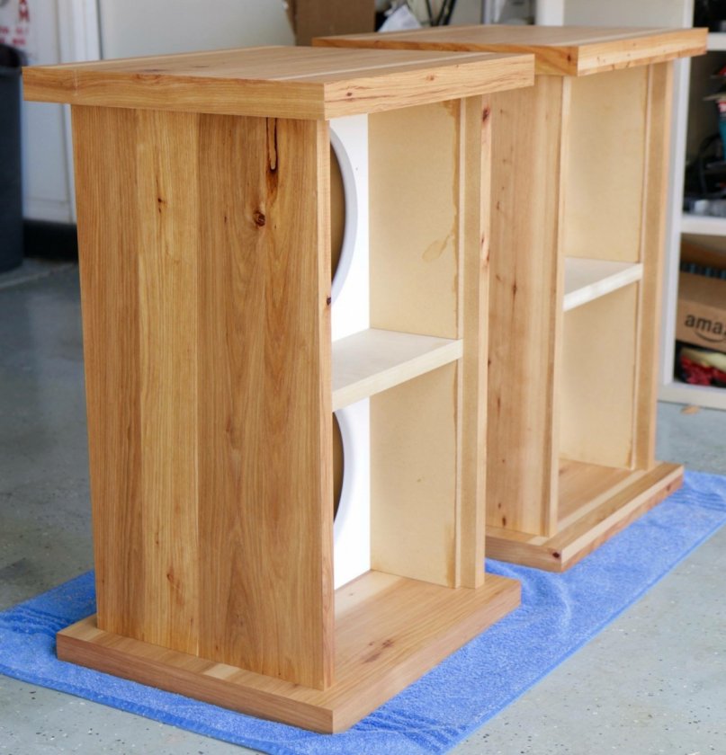

Hey folks!

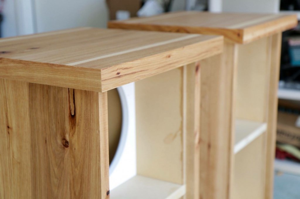

Wanted to give a shout out to Jay, Don and Danny. For those who dont know me, I am the owner and operator of www.newrecordday.com. I have knocked out a number of reviews and wanted to accept the challenge of jumping into DIY. I purchased the H-Frame Packs along with the goodies from Danny and will eventually knock out a video review chatting about my impressions. Anyway - for now, I gotta say the work being done by Jay and company is second to none. If anyone is questioning the quality, workmanship, active communication or anything else - DONT! These guys are doing a fantastic job!
Ill shutup now and let the images speak for themselves.
PS: Jay noticed I am missing the veneer trim on the center support piece so ill make sure I fix that...
Who doesnt like CNC'ed MDF?!
Dry fit looks great! Like a nice puzzle!

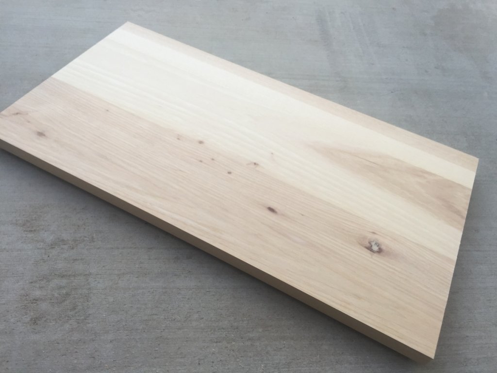

First veneer piece went down like a champ! Knotty Hickory!
Veneer knocked out on the first sub!
Choosing a color for the baffle was tough but I decided white looked nice! This is just flat Rustoleum enamel with a roller.
Yup, that worked!
What we need now is to make that wood POP!
And now for the second sub...
Thanks!
Tools used:
Veneer:
http://www.ebay.com/itm/121774686397?_trksid=p2060353.m2749.l2649&ssPageName=STRK%3AMEBIDX%3AIT
Router:
http://www.homedepot.com/p/Makita-1-1-4-HP-Compact-Router-RT0701C/204247210?cm_mmc=Shopping%7cTHD%7cG%7c0%7cG-BASE-PLA-D25T-PowerTools%7c&gclid=CJy0_4mN_csCFYeUfgodNukADw&gclsrc=aw.ds
Router bit:
http://www.homedepot.com/p/Diablo-1-2-in-3-Flute-Flush-Trim-Bit-DR44100/202585369
Wood Glue:
http://www.homedepot.com/p/Titebond-128-fl-oz-Original-Wood-Glue-5066/100184746
Feel free to ask any questions! I am happy to help...
With the Veneer, I simply used wood glue on the back of the Veneer and on the substrate (mdf). Let it dry...  get an iron and crank the heat. Get a paper bag to protect the veneer, press firmly and off you go...  just keep moving from one side to the other to avoid bubbles etc.

Looks great!!  :thumb:
I just heard from Jay that you were doing a pair; I was excited to see how you would choose to finish them.  I have a set on the way....
I've been running the duals in my own cabinets for awhile -- I look forward to your review, introducing them to folks who don't yet know about the wonders of open-baffle, servo-controlled bass.

They are looking great Ron  :thumb:

Ron, those are really nice looking.
I would have made then a little darker,
but that's me...
May I ask why you painted the inside white ????

Those look great!  I really like the white baffles.  :thumb:

Thanks Guy,
I went with the white baffle because I like the look and I dont see it all that often.
Everyone else: Thanks for comments! I will be doing matching NX-Oticas as well.

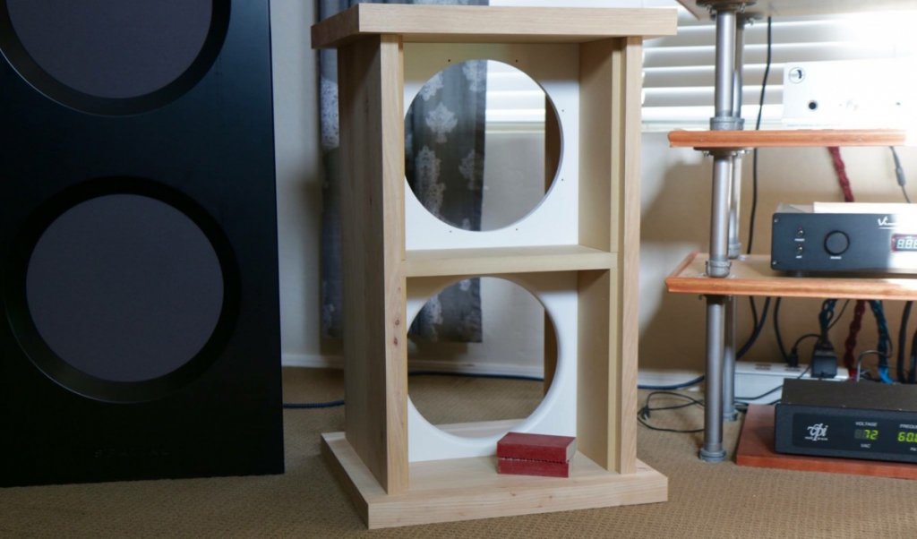

Great job Ron, those look fantastic.  You aren't kidding regarding Jay and Don's work, outstanding!
I too felt that there weren't enough white baffles when I built these:
Enjoy the bass, I know you will!  :thumb:

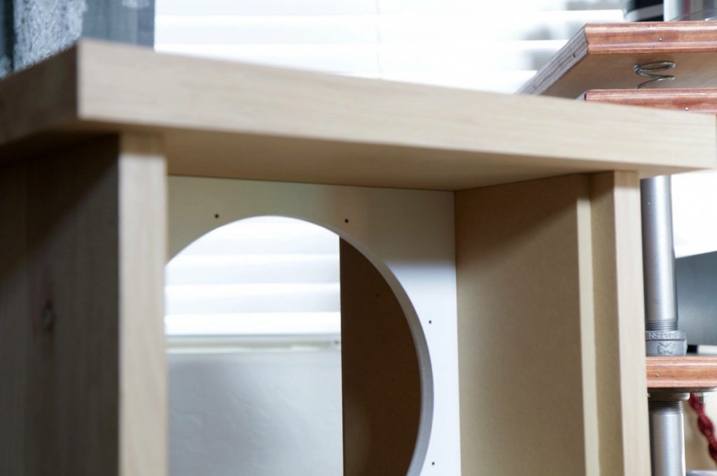

Ron, I'm not sure if I'm missing something in the photos, but it looks like you've still got some exposed MDF on the side panels and center braces.  If those areas are still unfinished, you probably want to do something there to seal up the MDF for moisture prevention.
I also have really enjoyed lighter colors on speakers.  The X-LS I've got right now are the original 'white shadow maple' from AV123, and the super-v cabinets I had (before they died) were clear birch ply.  Very hip look with midcentury modern still trending as a look people are after.  :thumb:

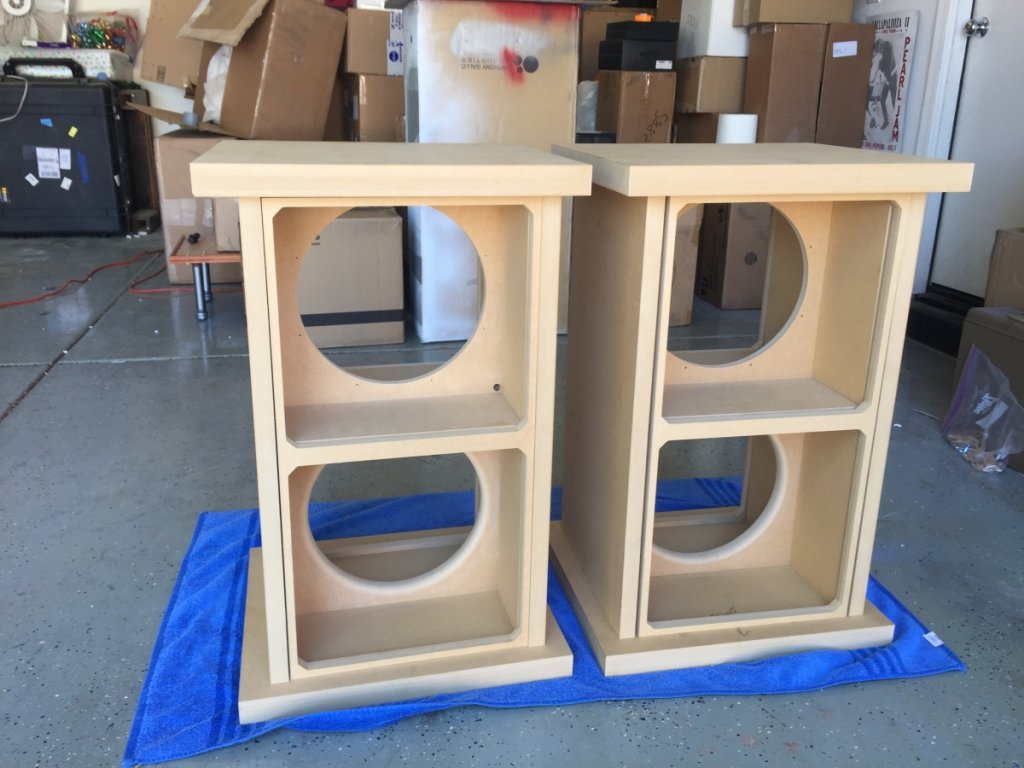

Not quite done...
No-res will line the exposed side panels

I'm going to do my baffles black because I'll be using grills, and the baffles showing through the cloth is not something I'll want to see (too cluttered looking---less is more). I'll also be putting a black felt cover on the backside of the woofer that faces the listener, so you won't see the driver either. I also don't want to see the front of the brace running across the width of the frame behind the grill cloth, breaking the rectangular frame into two square boxes and spoiling the elegant proportions of the frame, so it too will be painted. Black is beautiful, baby! But that's one of the great things about DIY---make yours how YOU want them.

   Your speakers look great Ron!  I really like the knotty hickory veneer that you used. The white baffles are nice contrast. You are right Ed.  Jay and Don's work is outstanding. Also, they are both very honest and straight forward in their business dealings with other people. I've been corresponding and working with Jay for a number of years on different speaker building project. Jay is a great guy and very passionate about speaker building and electronics.  It has been a real pleasure knowing and working with Jay.
  Thanks Ron for posting the nice pictures of your assembled H-Frame Flat Packs. Looking forward to seeing and reading your review.
